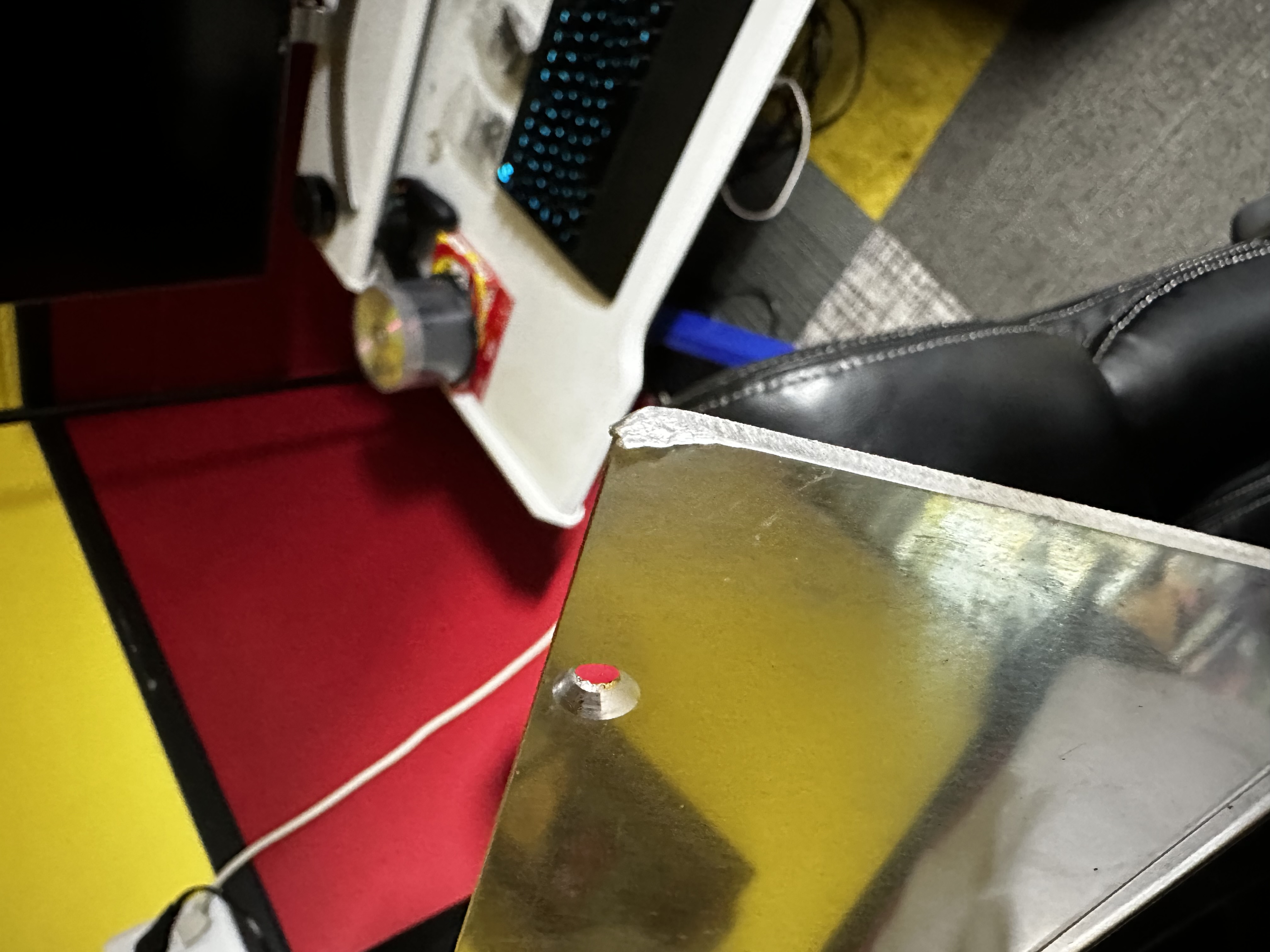

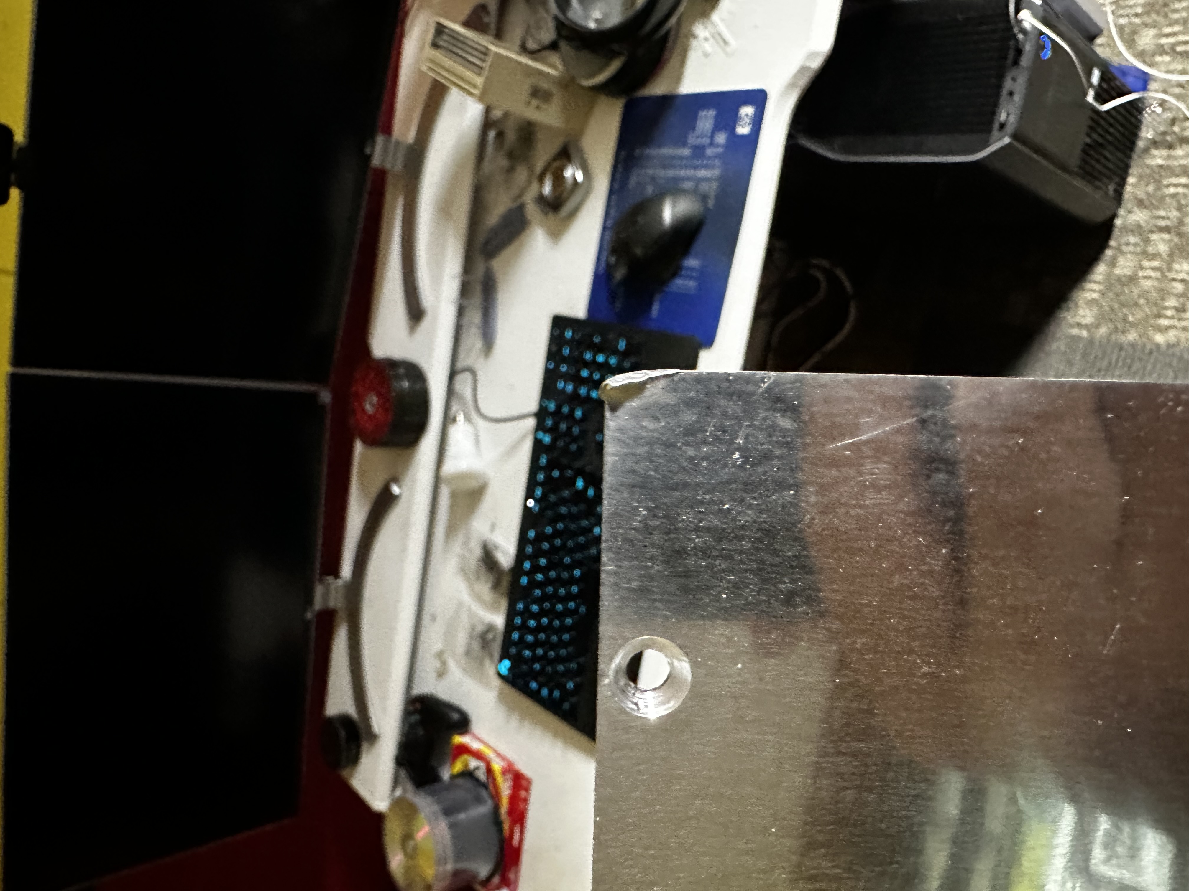

This being my first kit, I find myself wondering if I am being over-critical about the condition of some of the parts in my Tiger I kit. Here's a couple photos of some shipping damage I discovered tonight when I unwrapped the lower hull plate to get ready for the first steps in the manual.
Is it unreasonable to look into getting it replaced? Given the UK-US shipping, I could see this easily happening again also with a new part. What would you all do?
Thanks for the feedback/advice.
The way that corner has been crushed in and raised, I'm not sure how I'd ever get it back to square. How would you experienced builders handle that sort of thing? I guess it could be reformed as best as possible, then fair it in with bodywork?Is it unreasonable to look into getting it replaced? Given the UK-US shipping, I could see this easily happening again also with a new part. What would you all do?

That’s too bad. It’s a little heartbreaking but I don’t think I would ask for a replacement. Just bend it back into shape and move on!

Put it on a flat hard surface and peen it down with a hammer and then file the straight edge , It will be fine as you will fake weld over it all good .Dale

I don't know about being too critical but I'd also say if that's the worst that ever happens I'd count my blessings and run with it.
As the others said use a ball pein (peen) hammer and a steel plate/anvil to flatten it out and files it need be to dress it.
Don't have such a hammer? Buy a good quality one; in fact buy 2; a 12 oz and a 2 oz. Such hammers come in many weights- 2, 4, 8, 12, 16, 24oz and heavyweight 2 and 3 lb hammers.

Thanks guys! I know myself pretty well and I have a very strong perfectionist tendency, so I rather thought I might be overthinking it. I do have access to the tools at our local makerspace, so I'll haul it down there and take a whack at it, literally

I have straightened out many corners but usually my own fault for dropping a part, I usually put it on my basement floor and tap it back into place with my regular hammer, aluminum is easy to reshape and fix but it does suck to receive a part that was bent before you get it.

Like others have said place it on a nice hard flat surface and peen it down you can use a file or sandpaper to dress it up (lightly).......if you think about the real tanks and parts went through this the militaries fixed them and finished production. Real tanks have blemishes so don't stress about it.

Yeah, that's the one thing that's going to save me fretting about this too much. Tanks were. by nature, rough and tumble machines so I'm already primed that it doesn't have to be showroom perfect. In fact, you don't want that. I've already had a go at that corner and, while not nice and square like the others, it's OK and will look fine once bodywork and weld details are applied. Onward we go!
