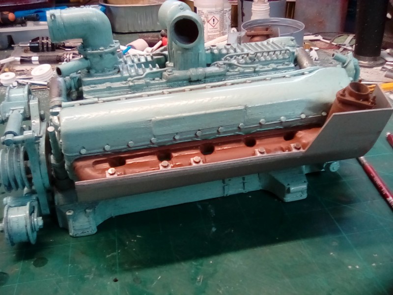

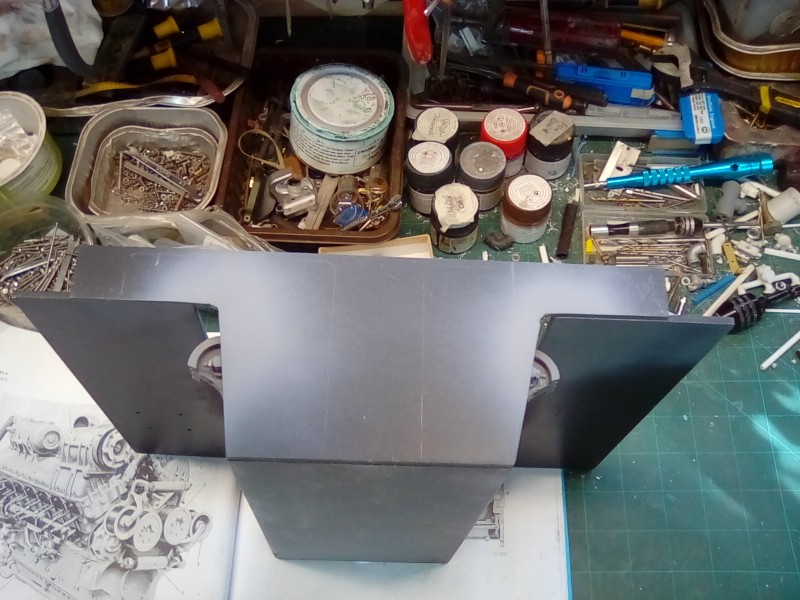

A good mornings work

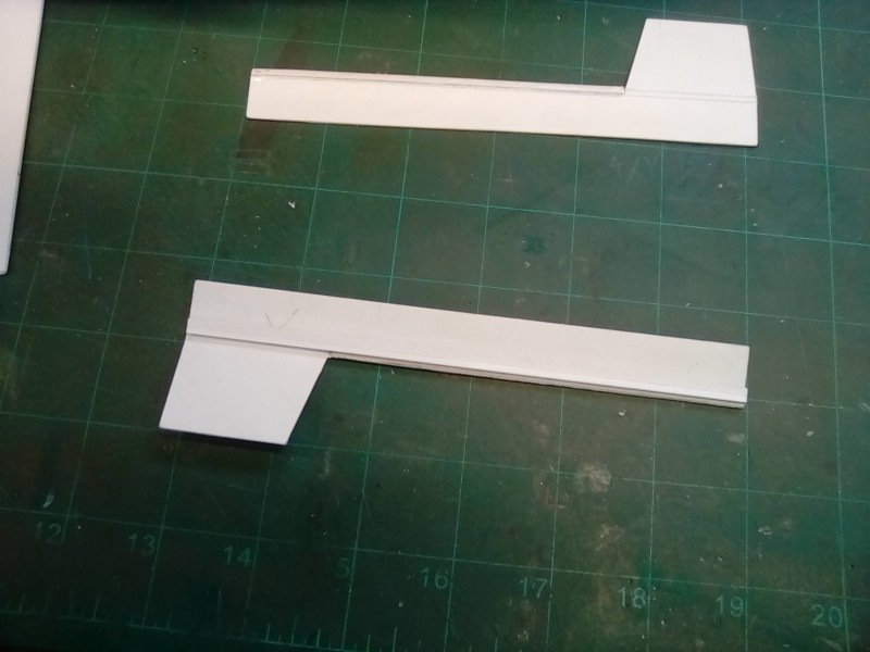

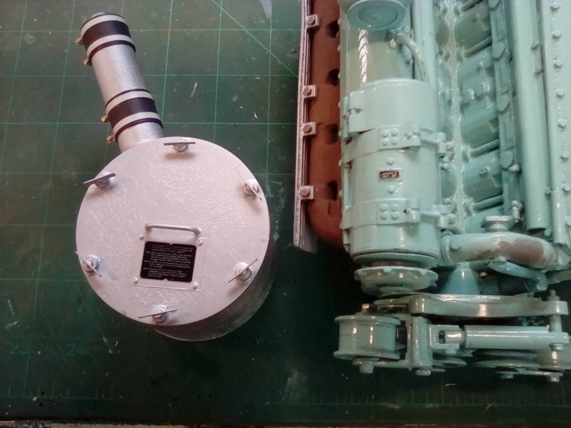

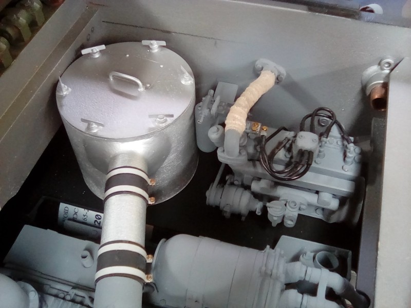

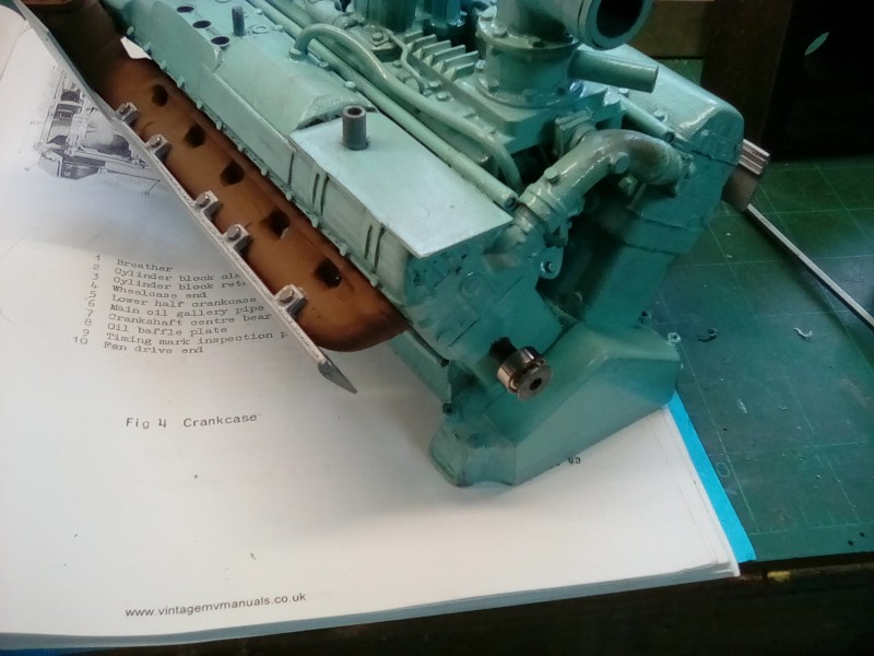

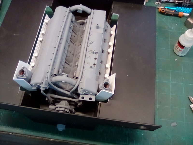

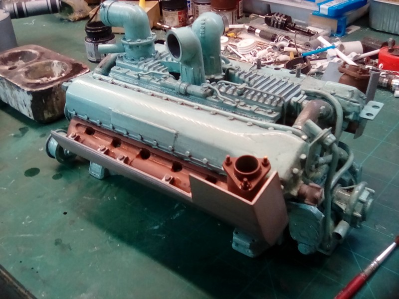

The exhaust heat shields, these need to be demountable and of scale thickness, I'm guessing the real things would have been around 16 gauge

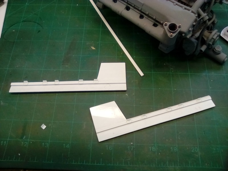

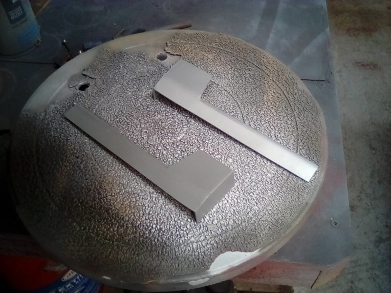

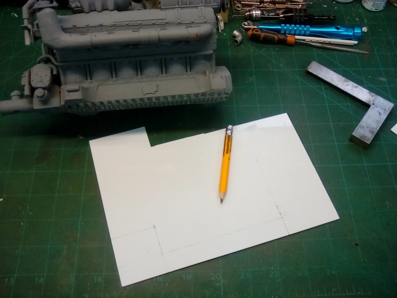

Measure and cut
Measure and cut
Rather than using heat to soften and bend the shields I'm using the score and bend and bond method, the material is relatively thin so heat could be a problem

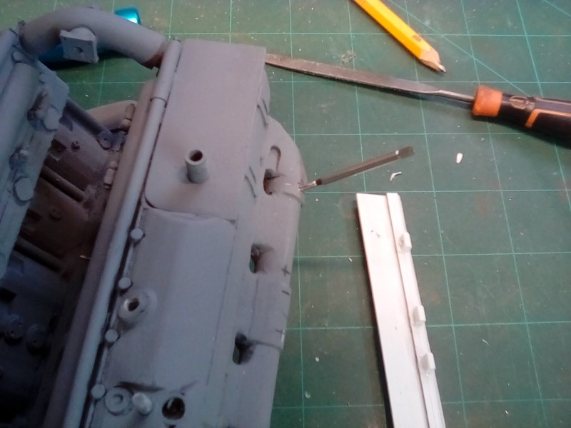

Bolt hole tab fixings, these need to be demountable for painting, I want to use rusty header paint effect
It's just a little to tight a fit, this is no big deal but if I don't get it right the paint will be damaged

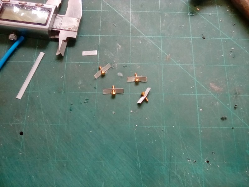

Tiny tap for the brass fixing bolts

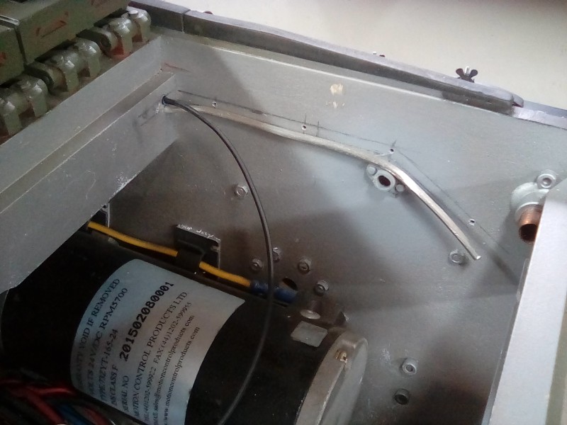

Another little adjustment was necessary to the tray opening

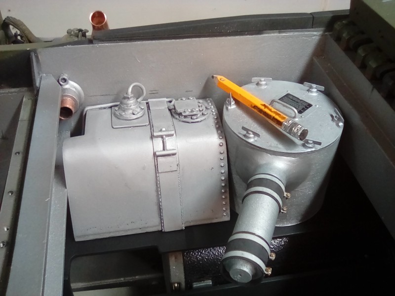

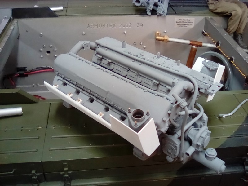

I'm happy with these two heat shields, the real shields would have been made of three sections / side, I've gone for one continuous piece as they are tucked away .

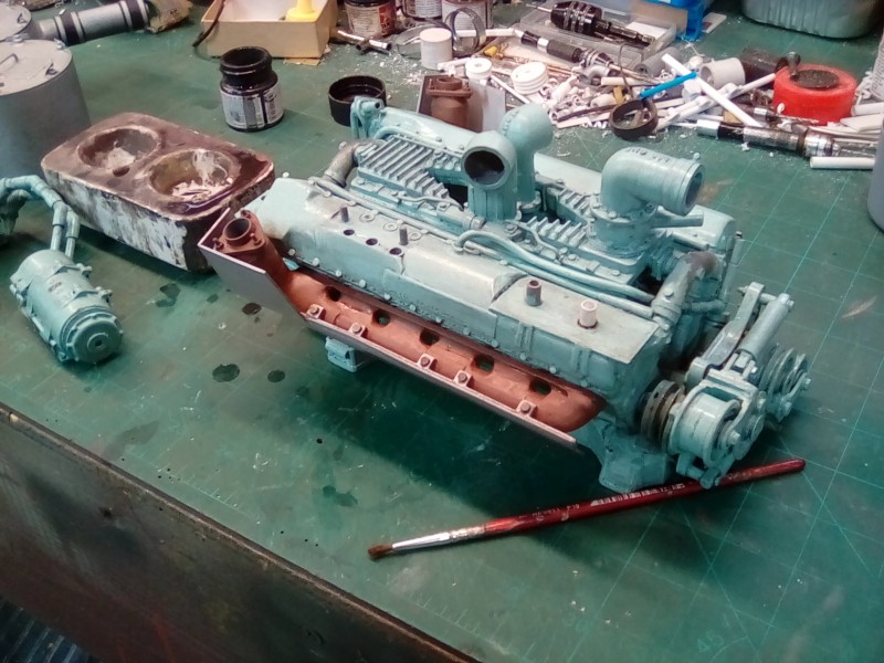

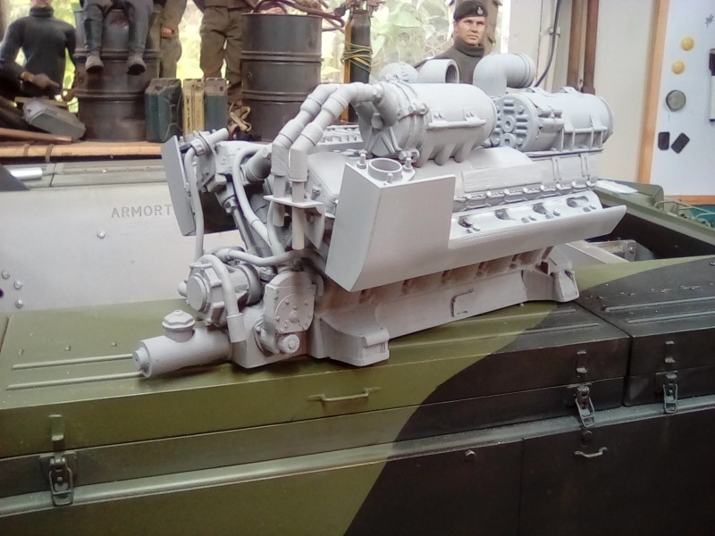

Going back to the V12 has engine, I'm thinking of using one of these in conjunction with the electric motors just for the noise and smoke signature , no sound card needed, no smoke module needed, just link it to the electric motor esc's control to sync
Phil Dawe
Posts: 295
Has liked: 757 times
Been liked: 300 times
Re: Mr Dawe's Centurion.
Post by Phil Dawe »
If you were to couple the V12 to a generator you could power the motors rather than using batteries..... 8) Didn't the Elephant have such a set up in real life?
It did indeed Mr Dawe, I hadn't considered that aspect. Anyone know what these model engines retail for?
Has liked: 794 times
https://m.aliexpress.com/store/11024425 ... lestoreNew
Cheapest bare engine is about 3000 euros.
They have a fast idling RPM.

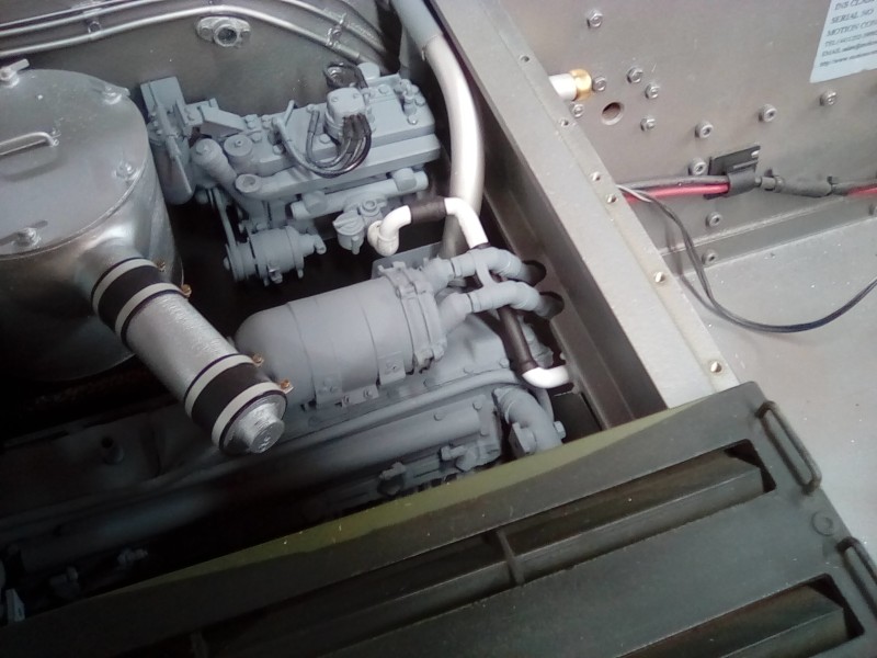

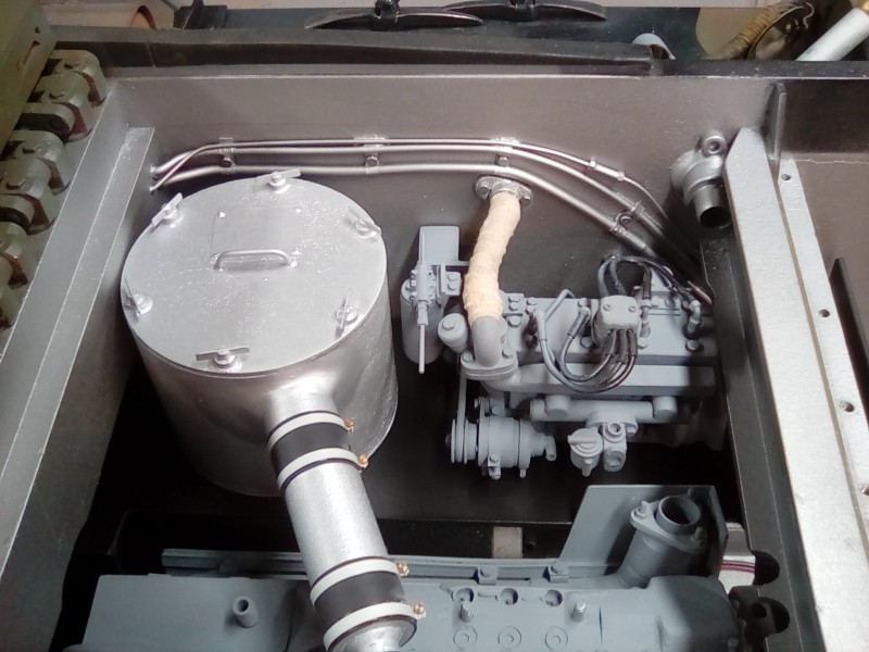

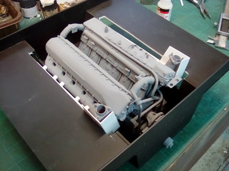

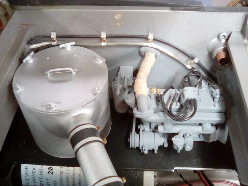

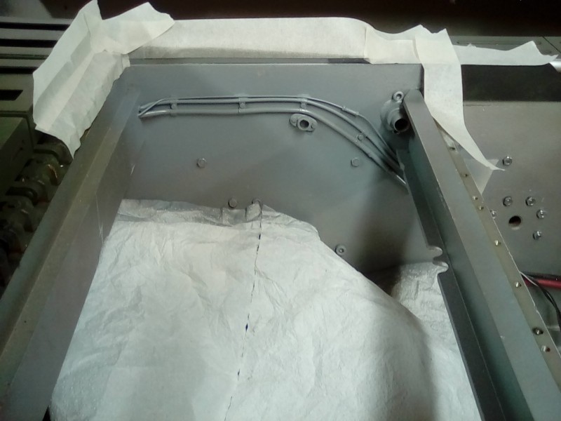

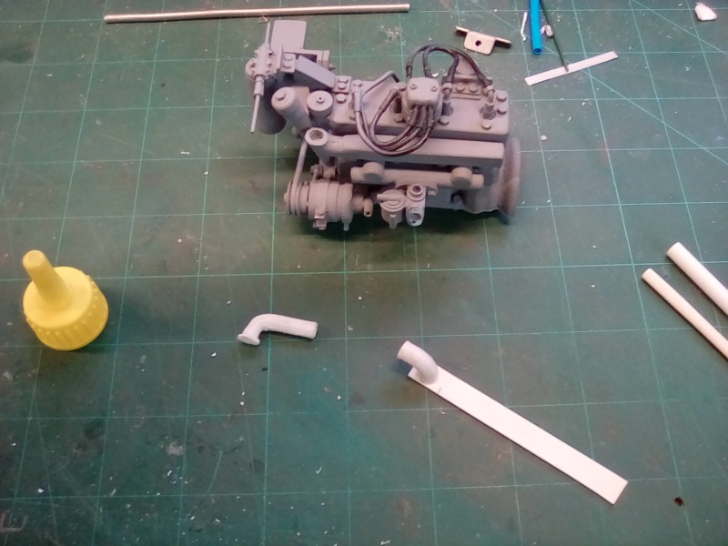

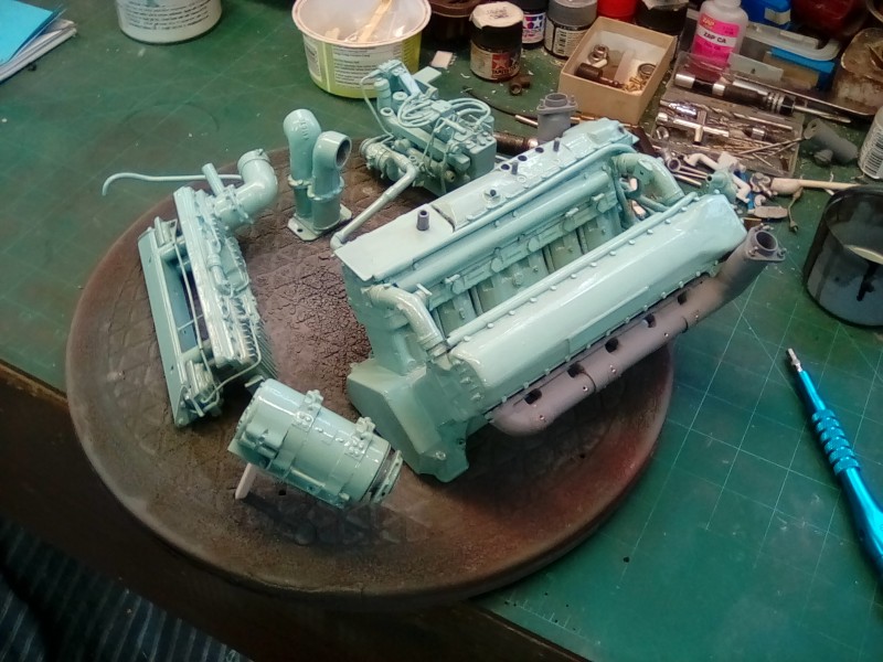

Engine bay plumbing, wiring, and fuel pipe for the gue, also the gue exhaust and hull fitting
Exhaust fittings
Exhaust fittings
Adjustable exhaust fittings until I'm happy, then I will bond

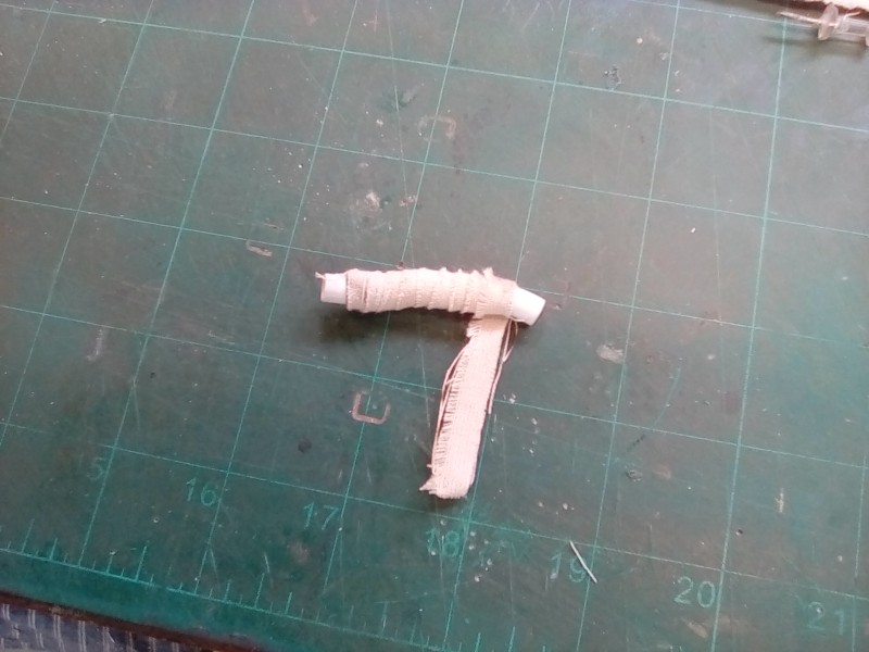

Exhaust wraping
Exhaust wraping

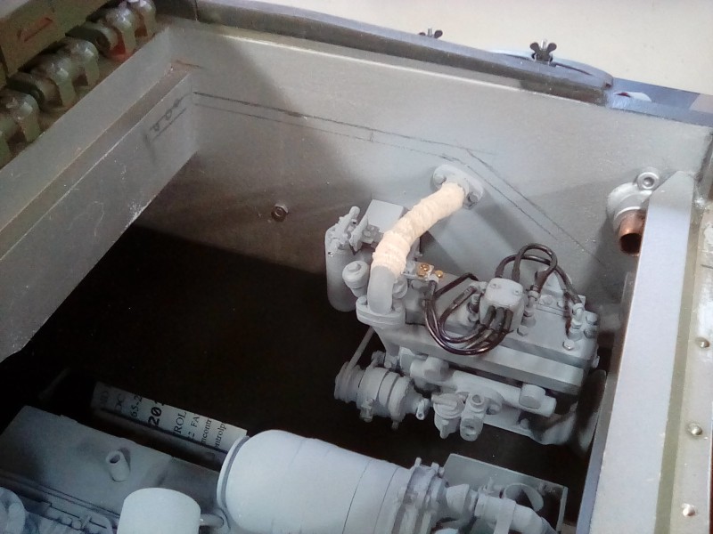

The asbestos exhaust wrap looks ok and is now fixed with wicking cyno
Tapping for the 12ba bolts
Good old plumbers solder is great for the larger pipe work
Pipe clamps this time
Oil pipe fittings are a plenty with loads more to make
Plumbing
Plumbing
Yet more engine tray adjustments
Some paint to the nether regions

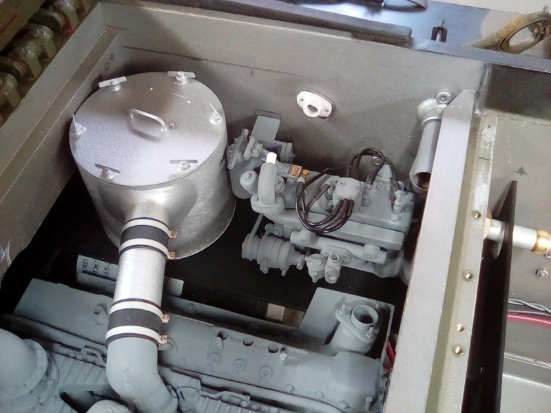

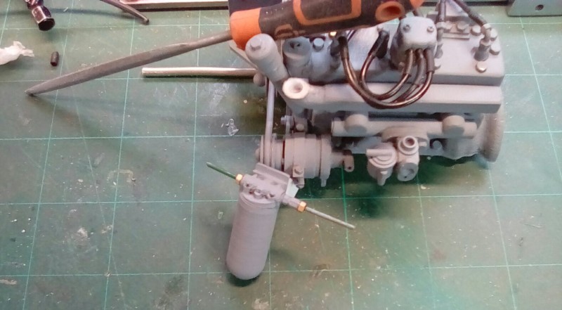

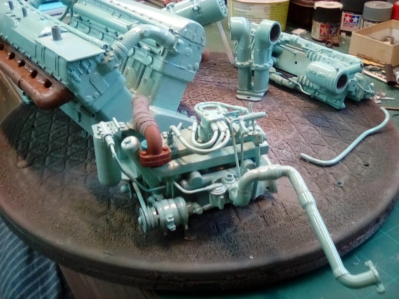

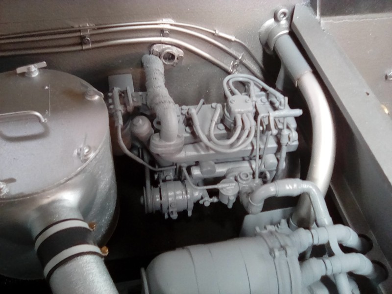

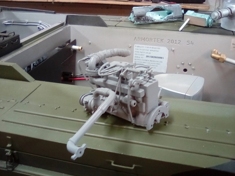

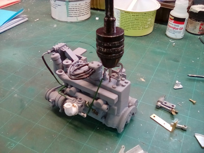

Gue carburetor work, fuel pipes, carb linkage and air pipe, also more oil lines.

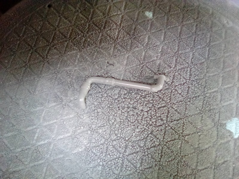

Lots of bent pipe fittings to get around everything

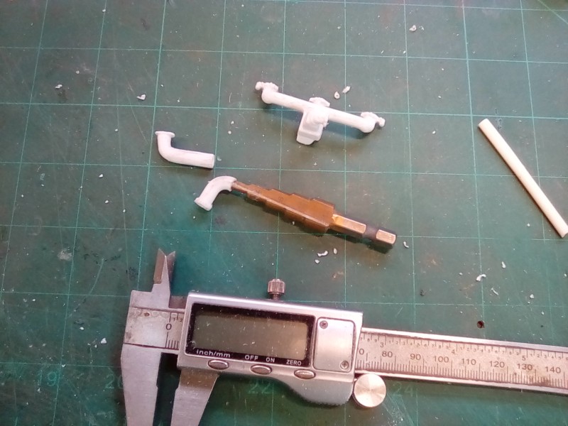

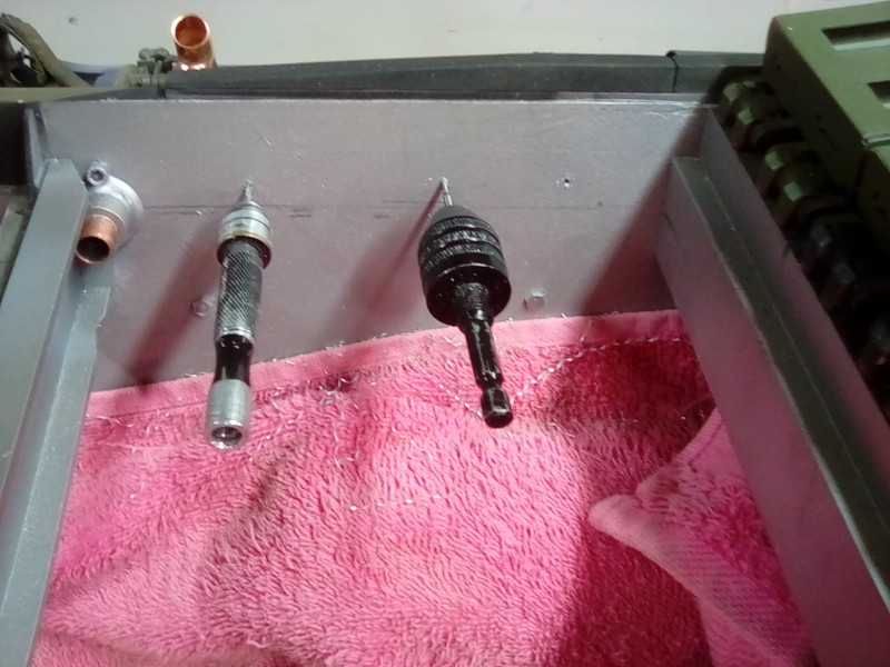

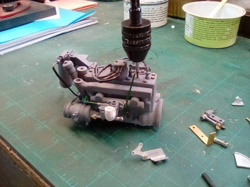

The step drill is great for this delicate work as it doesn't snatch
Pipe work knitting
Pipe work knitting
Air feed pipe for the carburetor
Throttle linkage it's quite complex as it has a governor
Brackets always with the brackets

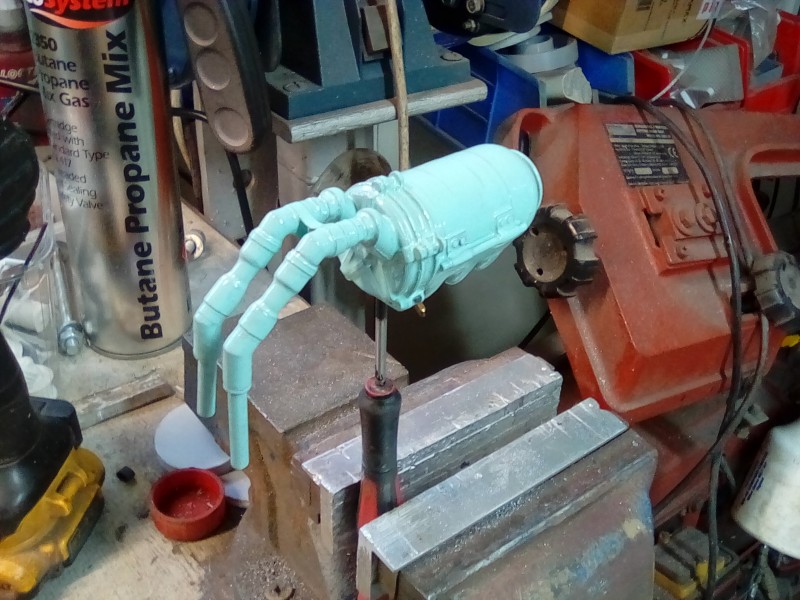

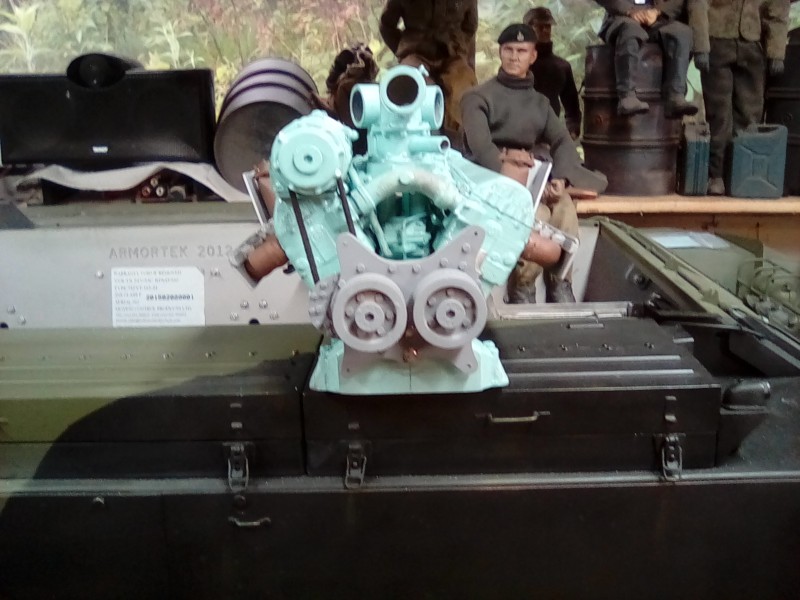

It's a busy little engine, you will need to zoom in to appreciate all the working carburetor linkages
Just a few electrical wires to run to the gue, paint it and it's done

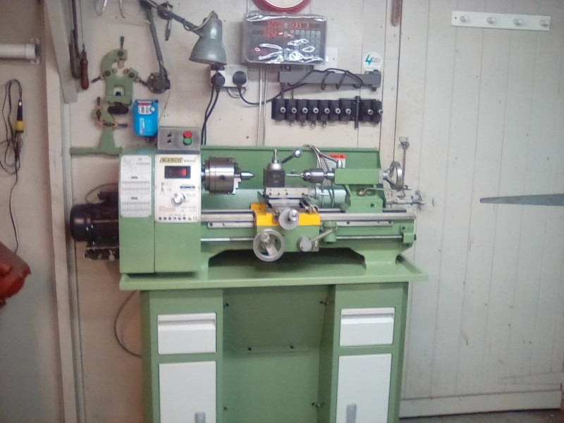

The workshops new edition, thanks Andy. This will speed up the turning side of things

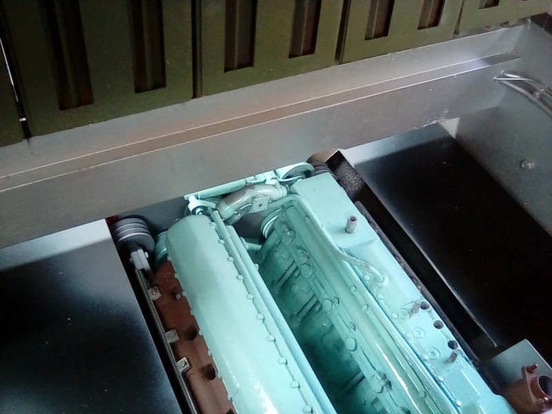

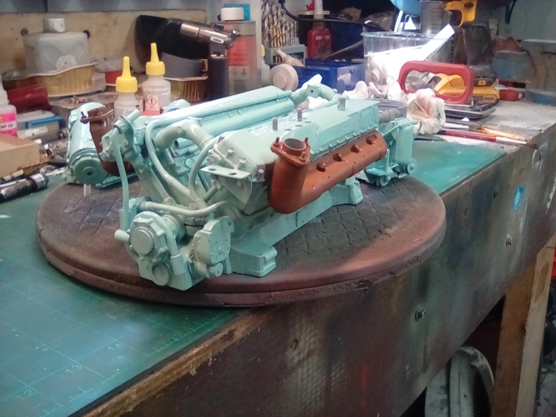

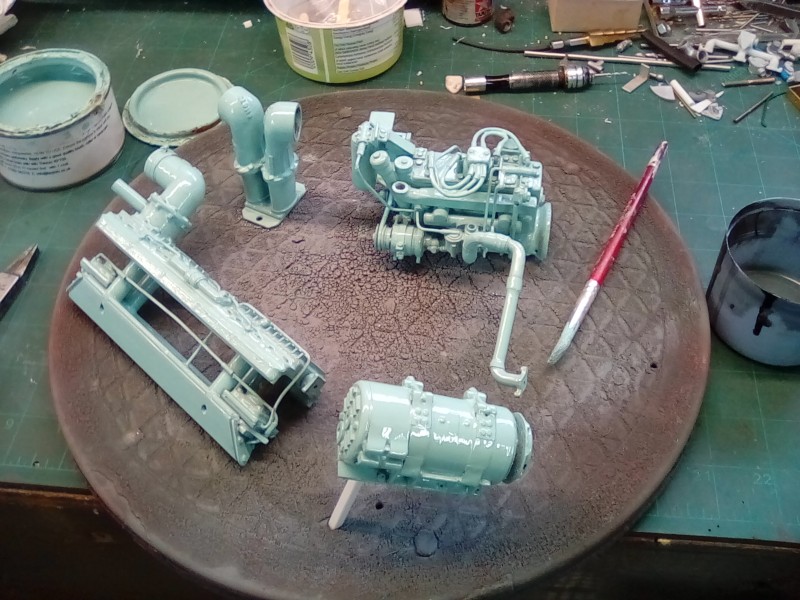

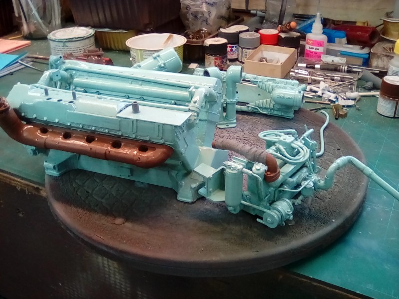

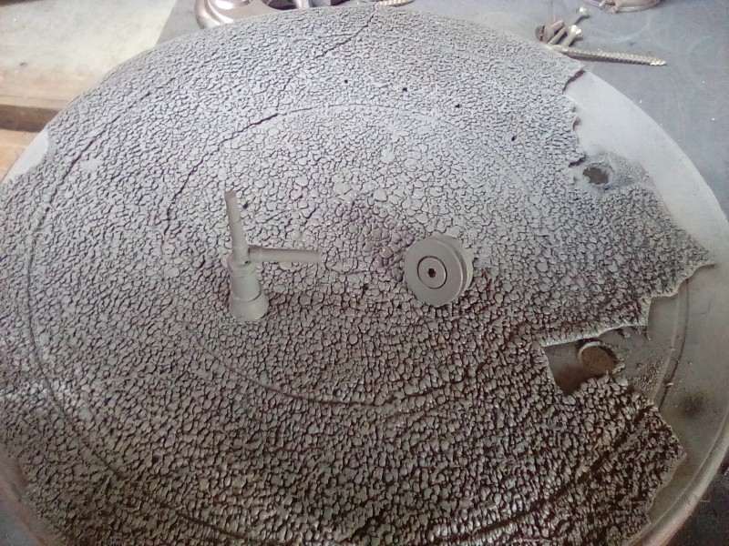

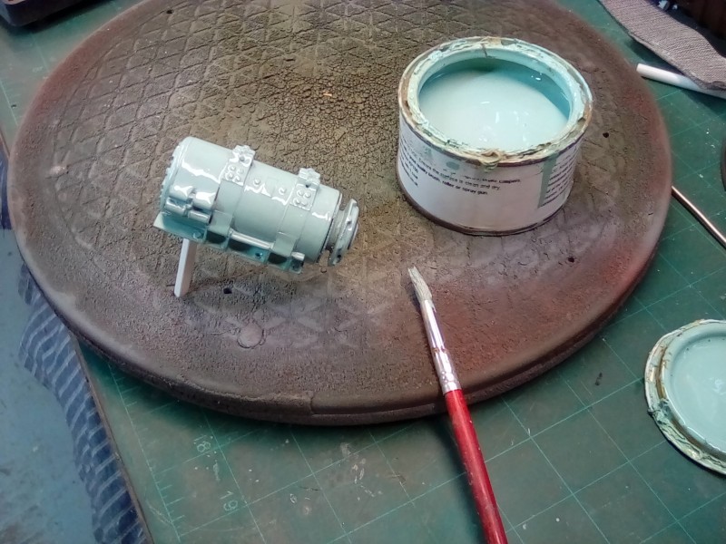

Just top coat painting today.
This duck egg enamel seems to take for ever to cure.
Another coat will be required

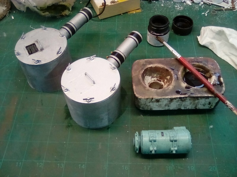

Exhaust heat shields HT silver
The exhausts have their first coat of red brown.
This lot will have the weekend to dry.

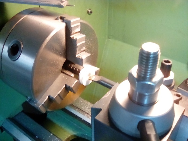

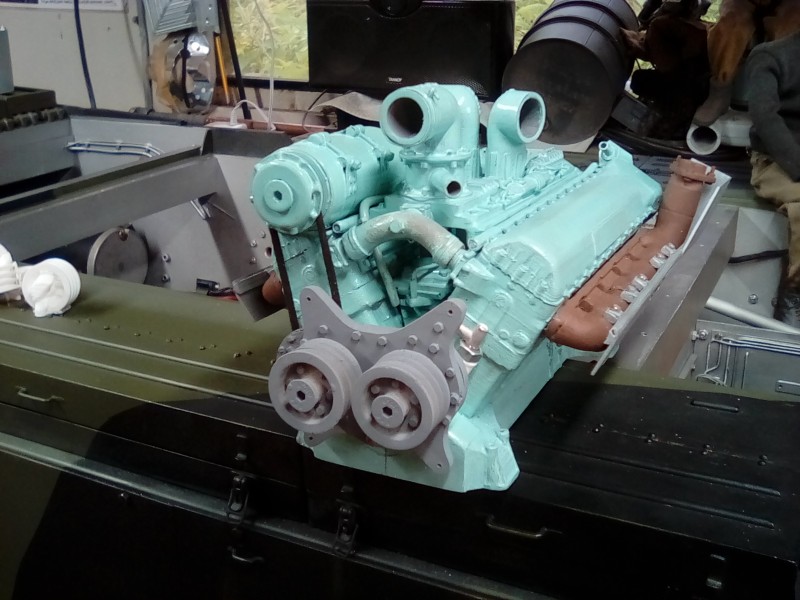

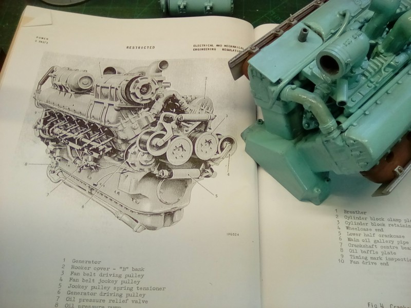

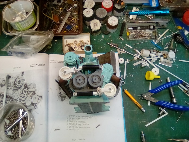

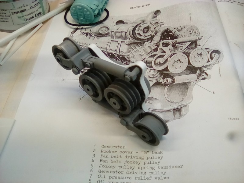

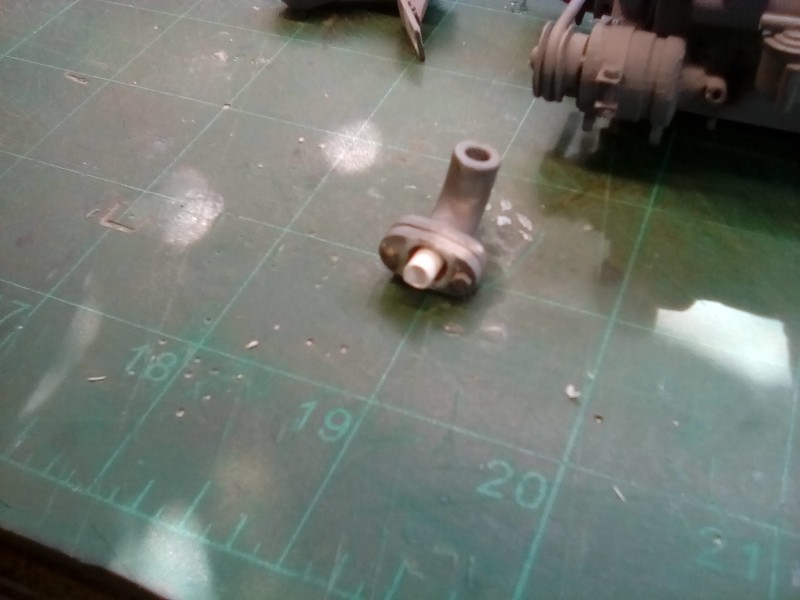

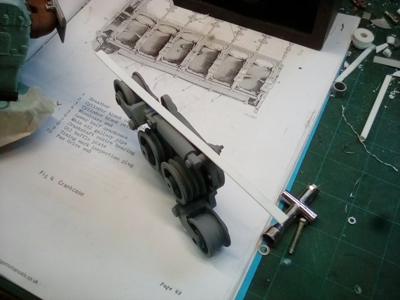

I've made a start on the radiator fan pulley assembly
This lot from scratch is a little tricky
I want the vees to be functional, the dro is great for this kind of work

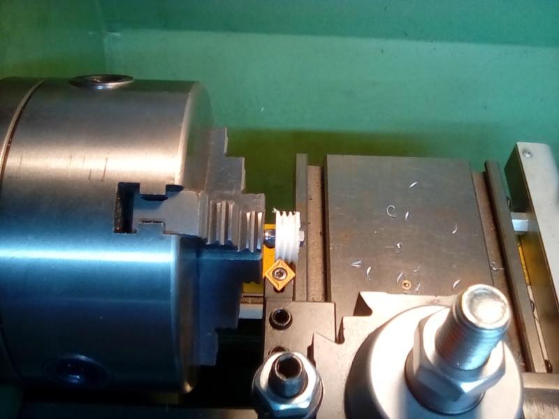

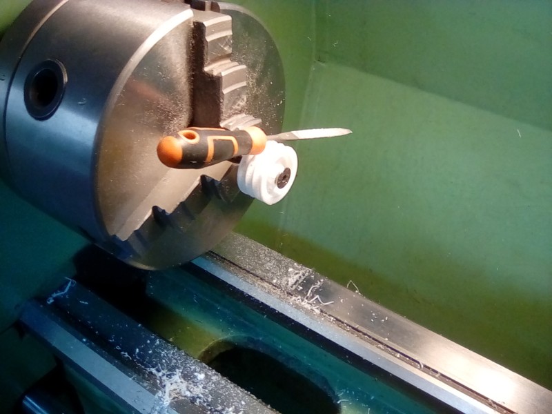

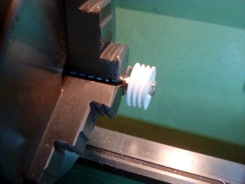

These printed pullies clean up well on the lathe

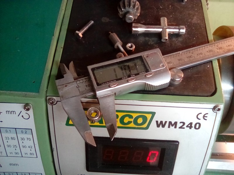

11 mm od with an 8 mm id sealed bearing

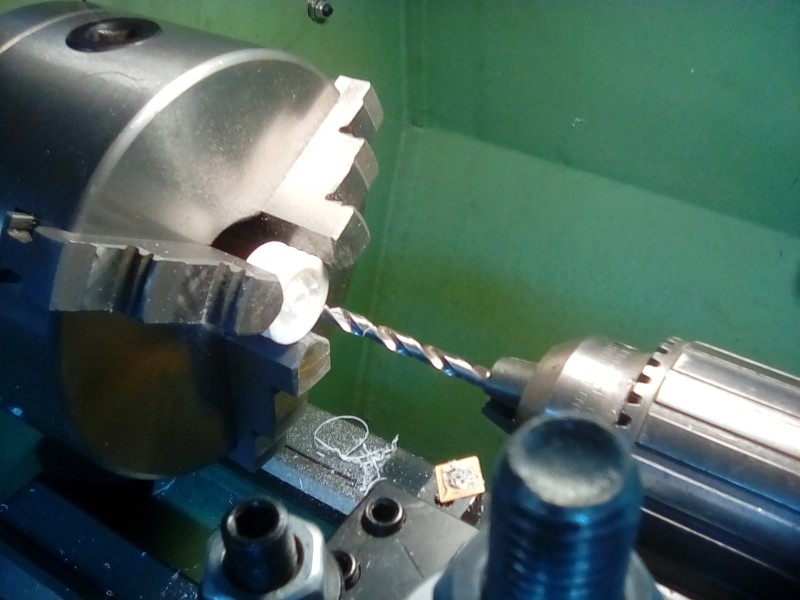

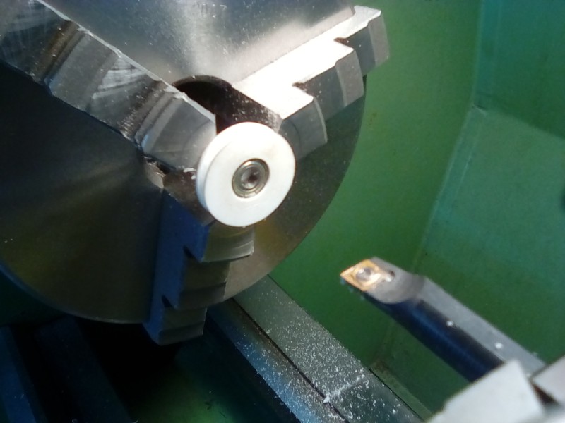

Using the boring bar to let in the tiny bearing
This is just a push fit
This mounts just here

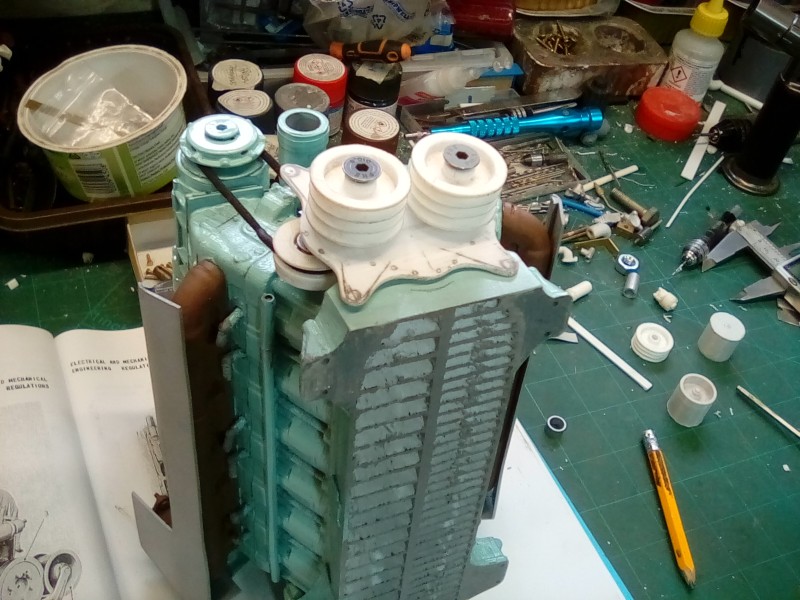

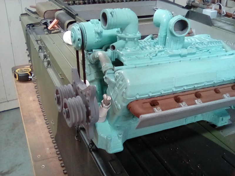

The dynamo bottom pulley done

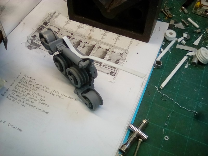

Roughing out the pulley mount rear plate

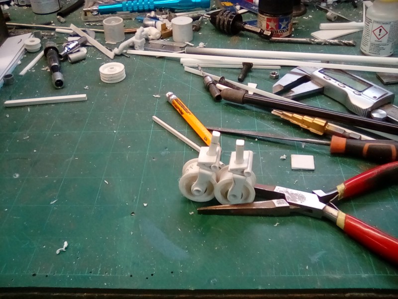

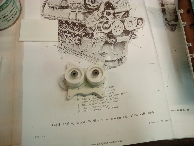

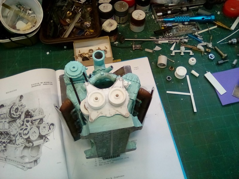

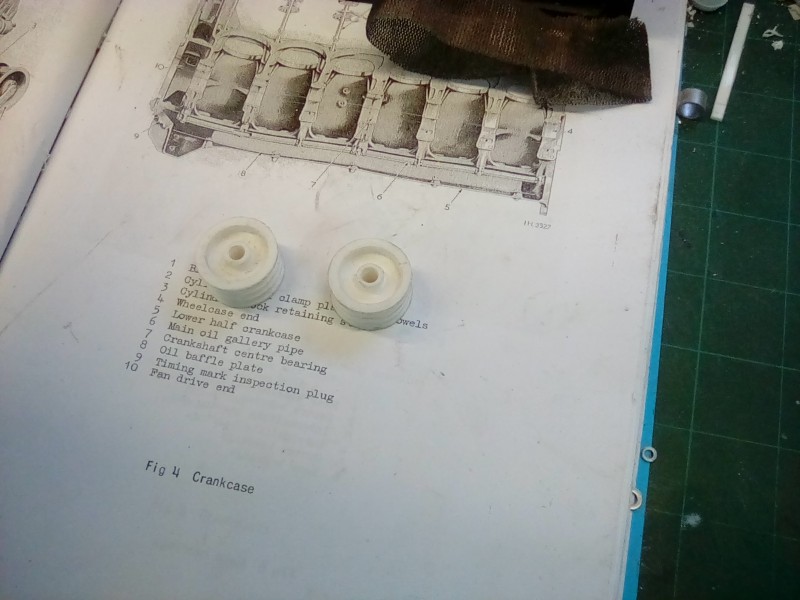

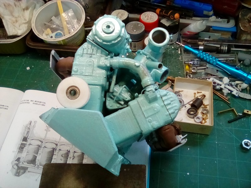

The pulleys, I've decided to print slightly larger.
That's a better size

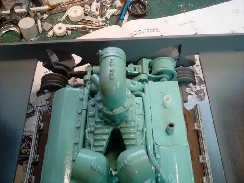

Just enough room in there, I have to somehow make and fit the fan end pulleys, not sure how I'm going to do that just yet.
I shall increase the pulley mount detail as I go
Important to get that center as true as possible

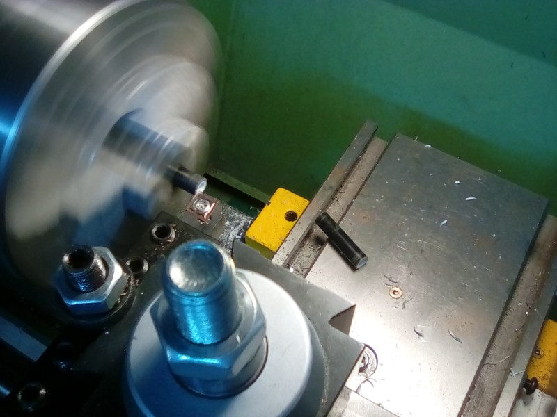

Strange medium to turn is PLA , it gets very warm very quickly so you have to stop for a minute or you will lose the piece

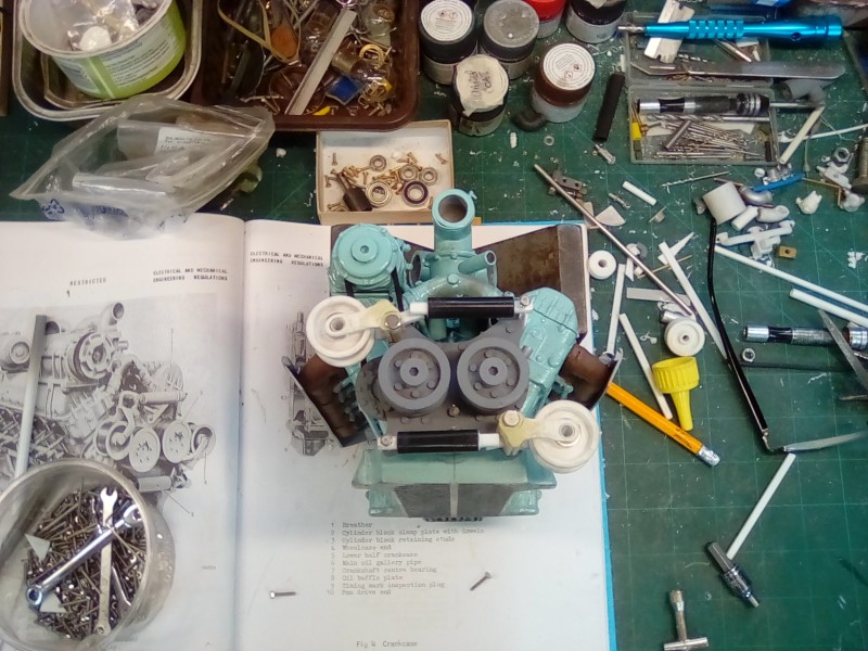

One goes here the other lives on the other side but underneath

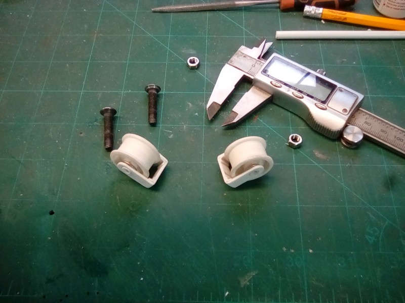

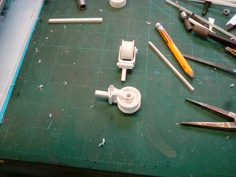

The two idler/ tensioner pulleys all done

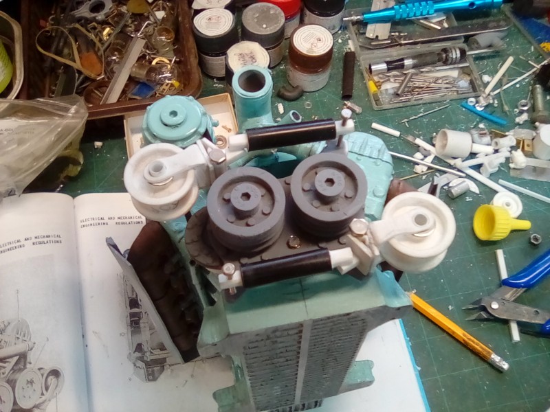

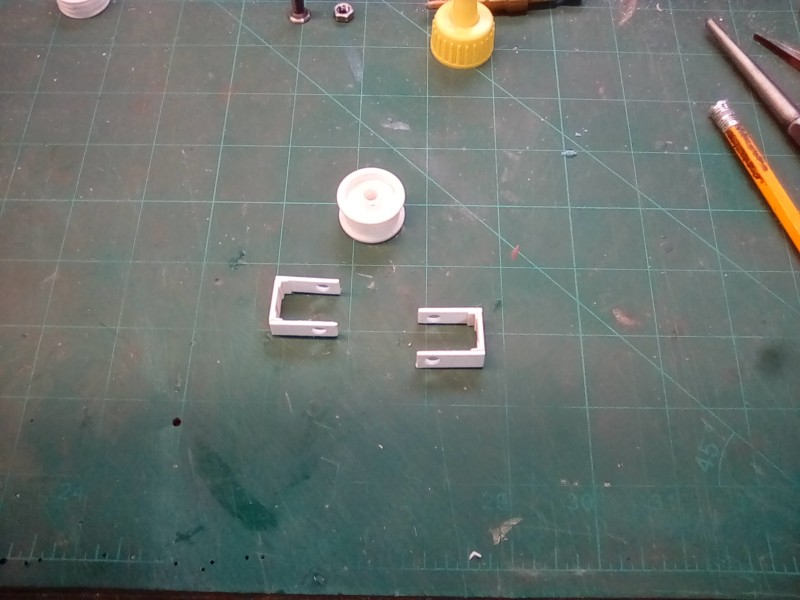

The fan drive pulleys tensioners .
The idler/ tensioner swing arms
I'm not going to mad on the hidden detail as these are tucked away
Setting the mount angles
Tricky little devils these
Each one is a mirror of the other, although the top assembly was a lot closer to the pulleys compared to the bottom assembly, maybe space lower down was at a premium
Turning the tensioner tubes
The tensioner tubes
The tensioner tubes
The next job is to file square pivoting joints so that they will function
Now I must leave it to cure

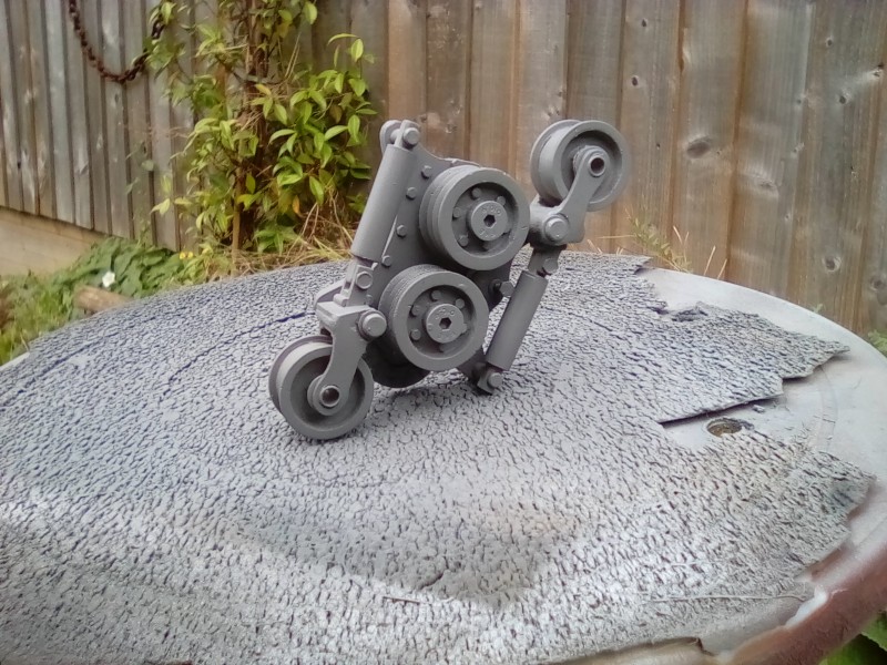

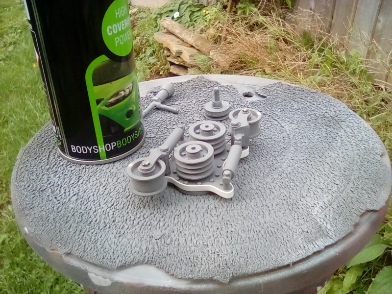

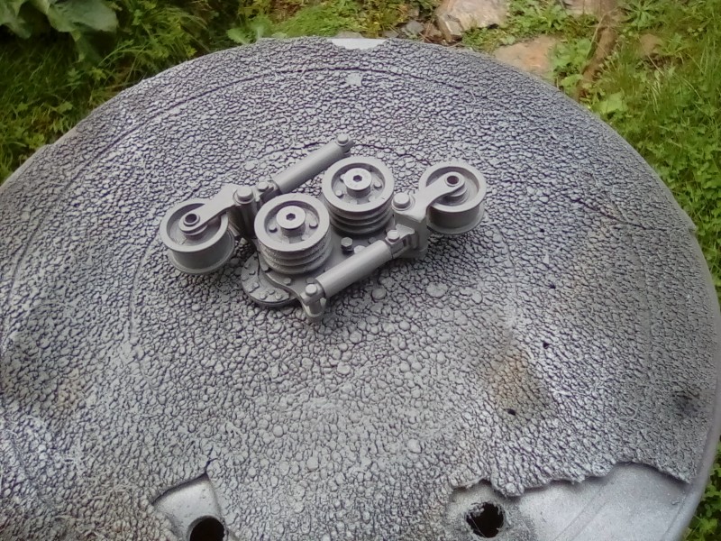

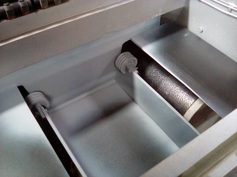

The tensioners are now done but for top coat.
There's enough heat in the sun to cure the paint today
Nearly there
Nearly there
Fittings
Fittings
Mounting plate reinforcing strip
Just bend and bond
Just bend and bond
Enough detail all ready as these are tucked away

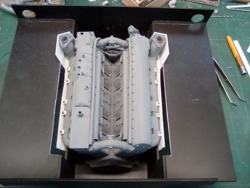

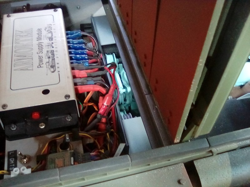

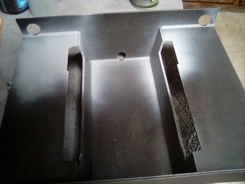

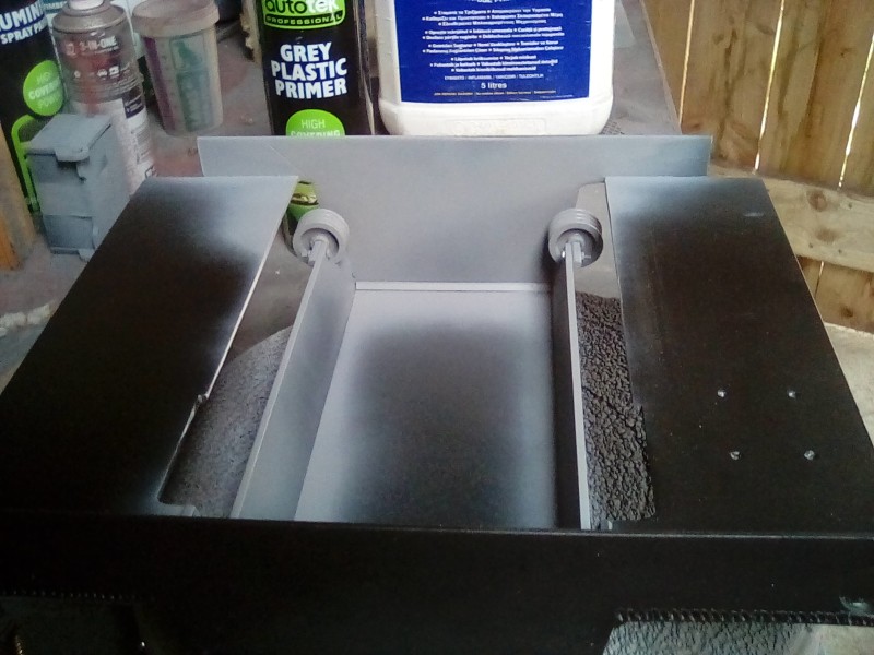

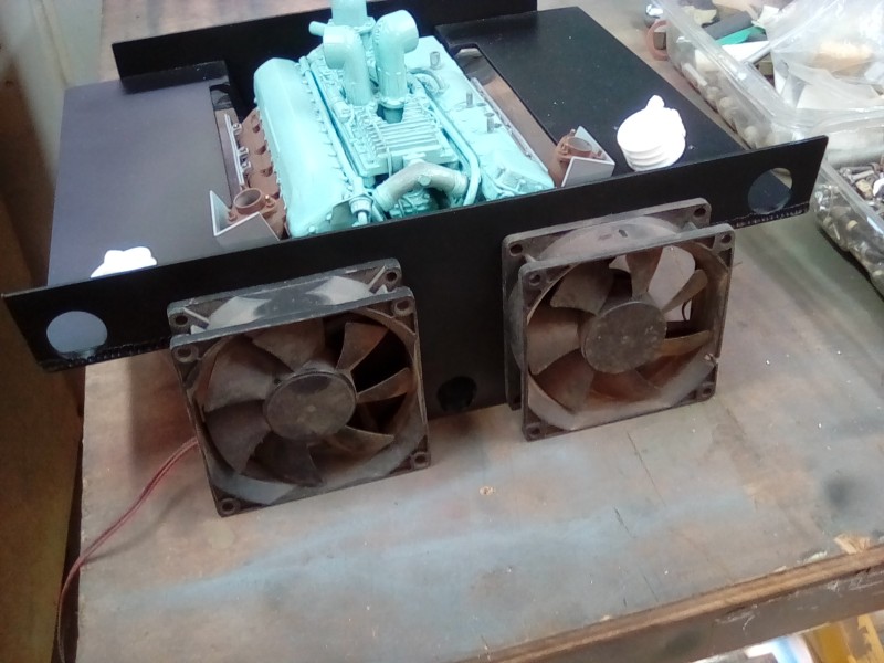

There is no room on this side of the tray, ideally I would let these into the tray and cut away maybe half the fan so they miss the drive motors

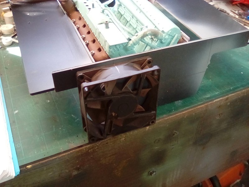

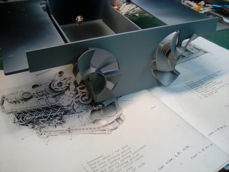

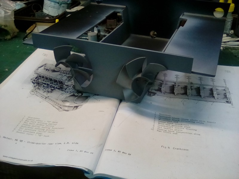

Pcb fans would make great fan units, good bearings and would turn the pulleys and belts nicely

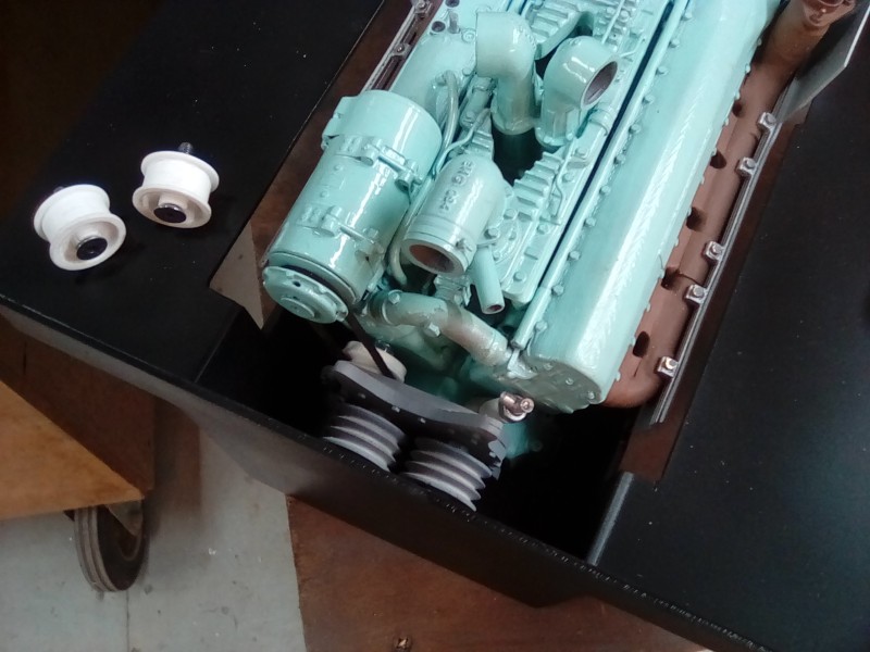

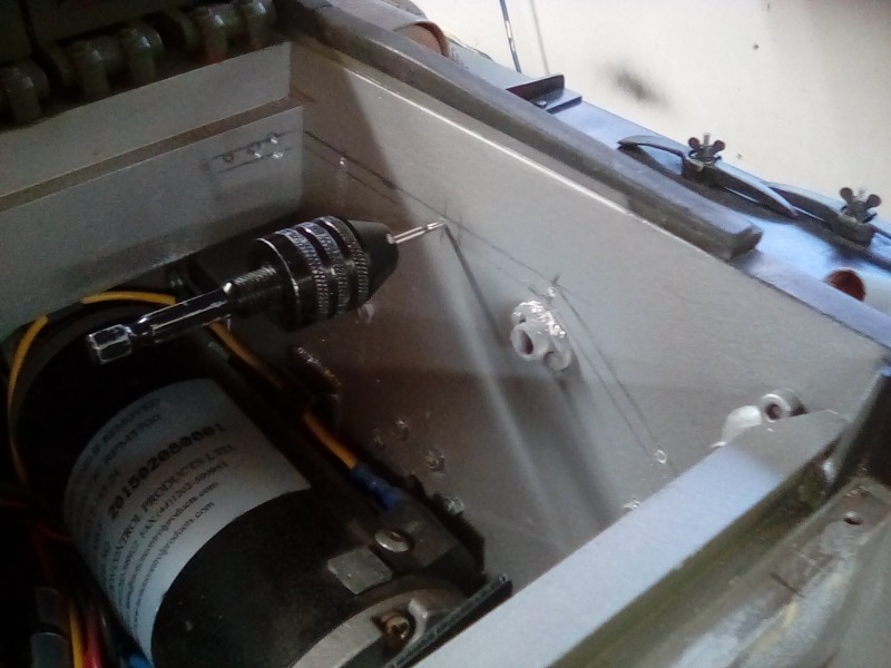

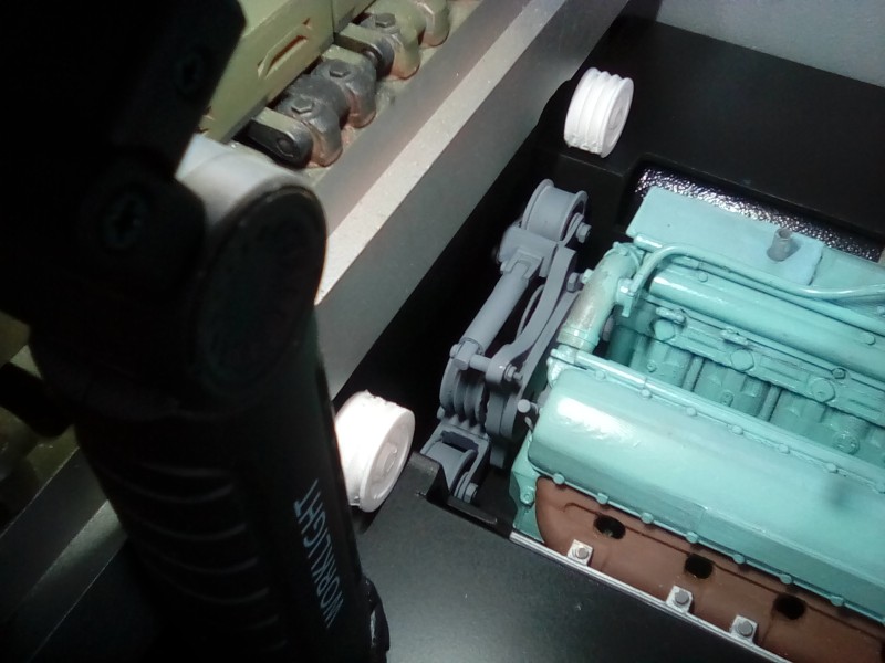

This is approximately where the fan pulleys need to go, you can see that the electric motors are in the way
Umm some head scratching is required here

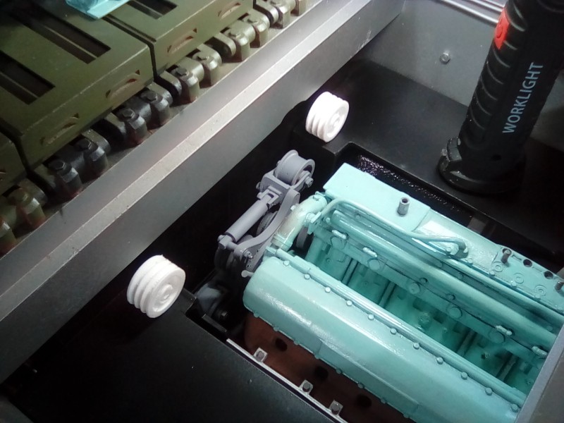

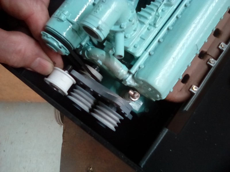

I scratched my head and came up with a simple solution.
For those that it may concern, I have washed my smart phone so email please until I source a new phone.
Another pair of pulleys cleaned up ready for the fan drives

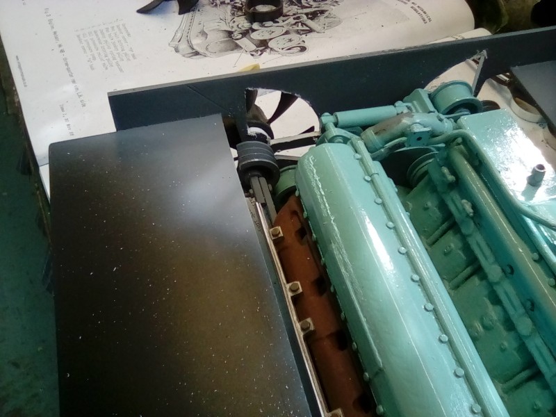

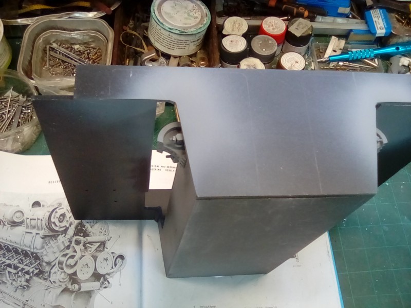

Simply bolted to a spindle so that I can fit the belts, I did have to adjust the tray openings once again
The fit looks ok but the tray is now way to high

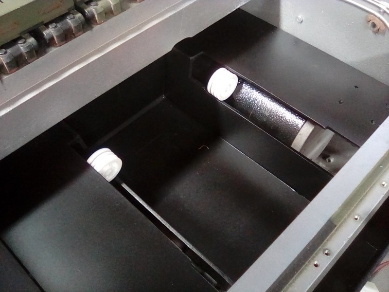

That's how much the pulleys needed to be sectioned
You can clearly see the scalloped pulleys

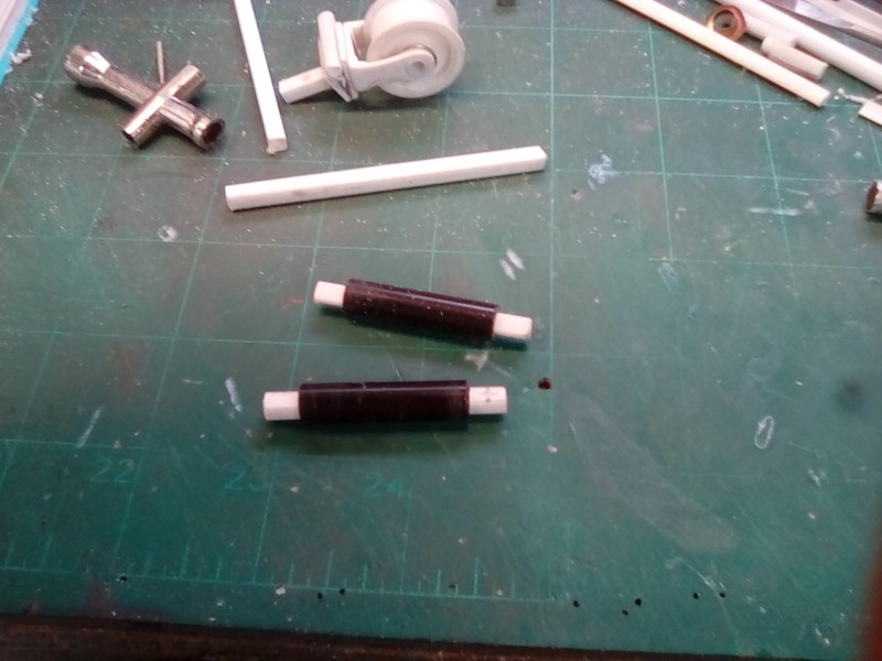

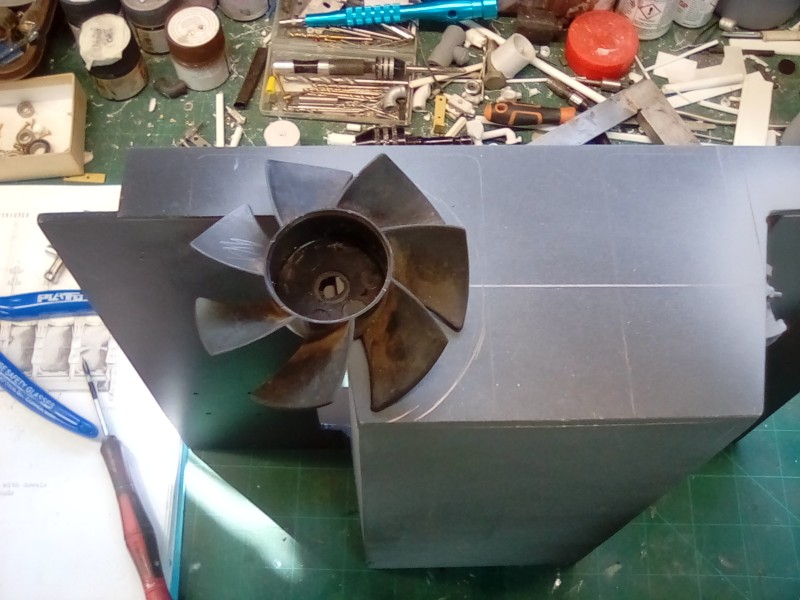

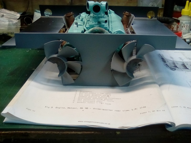

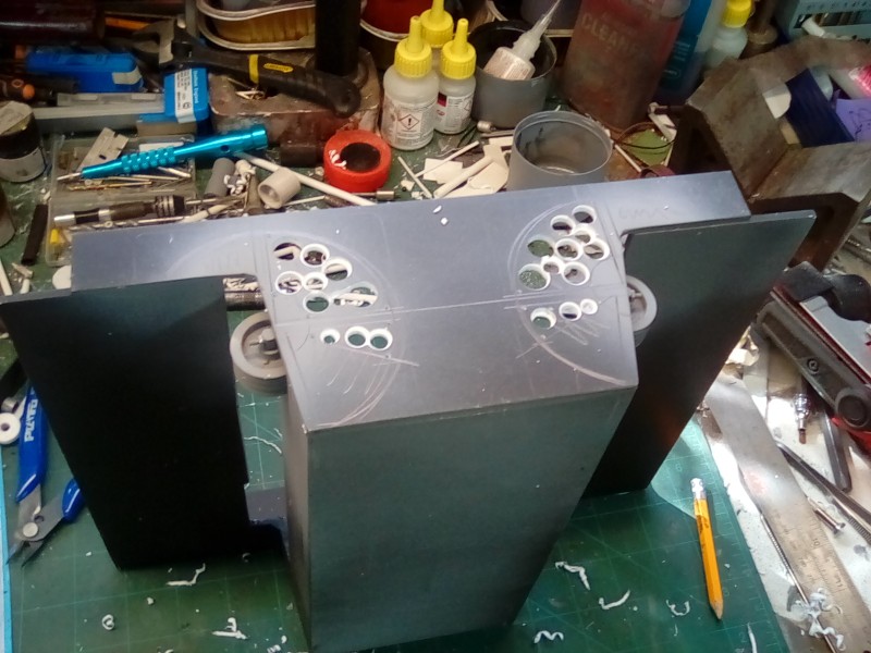

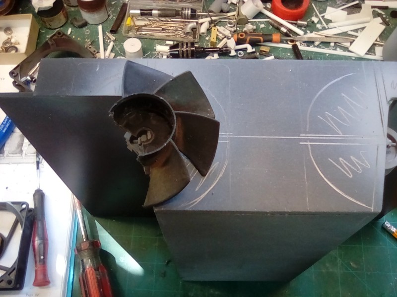

Marking out For The fan
Not much room in there

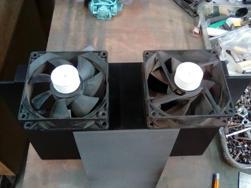

The fan before dissecting

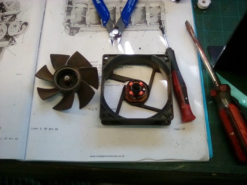

The pcb fans come apart relatively easily, the material used to mold the fans is very brittle
Dissected fan to miss the electric motors
The good old step drill is used to remove most of the material before filing
I may remove a little more material
Tucked away but they will help with the illusion.

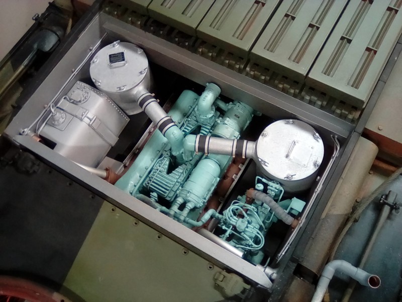

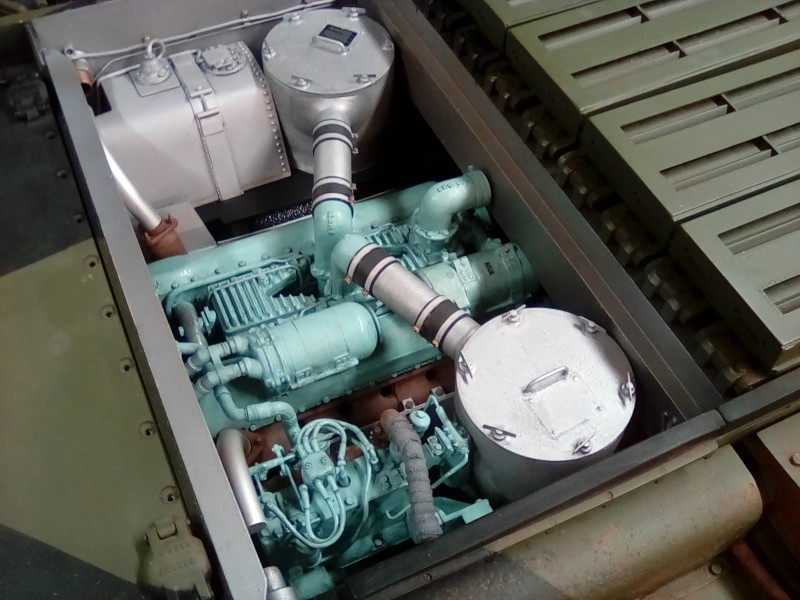

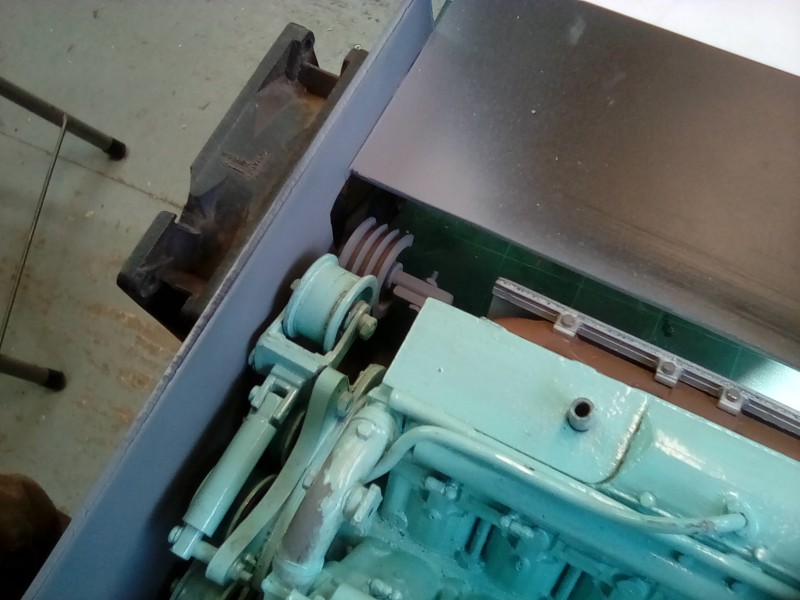

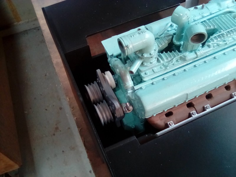

And I thought that the chieftain was tight for space
That's it , they are now bolted in place
It's going to be tight
Always test fitting or you get ahead of your self and then things don't fit
That will do nicely , just need to paint them silver
Air filter weathering wash
It all has to be wet at the same time or you will get " day work lines"
A good wash over this side
And this side
And this side

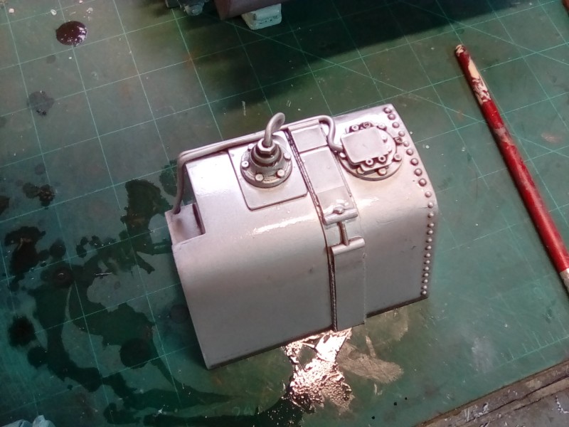

Weathering the fuel tank, I'm not going over the top as the engine bay's were fairly well looked after
Marking out for the last of the engine bay wiring
Drilling and tapping using just your thumb and trigger finger is the safest way when your using such small brass bolts
The quickest way to add wiring and plumbing detail
Final fit for today, we will soon be on to the oil cooler
