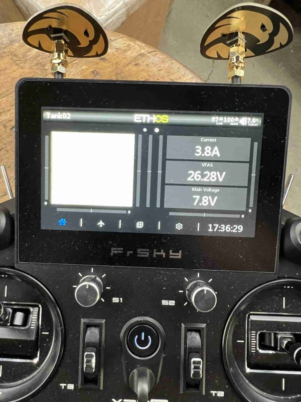

I've read somewhere here on the forum that either the motors or the ESCs are 'regenerative' meaning under some conditions power will be returned to the batteries.
How? Under what conditions? If I have a graphing or logging power measuring instrument inline with the battery during operation how will this
regenerative power manifest itself?
I ask because I've begun to use inline current and voltage telemetry sensors and 1) I don't want to cause damage to either the sensors
or other electronic components and 2) want 'pure' results - no skewing of readings.

I agree with all of the comments. The core reason I posed this question was not as much for the sensors but rather for another component.
While testing the fpv video I encountered a complete failure of the OSD (on screen display and attached vtx (video transmitter). I initially thought only the OSD was impacted but it seems the VTX was as well. The exact series of events is murky at this point but the OSD is an inline component which feeds
power to the VTX. During my last test the OSD failed at some point. I did increase and decrease the motor power as part of the test and saw current demands as high as 8+ amps while the motor were running up and then taper when top speed was reached. I may have cut power abruptly at one point.
It was so unexpected that trying to play the events back in my mind, who knows? I'll assume it was one of the things I did and not do it again.
Not being sure what caused this I'm going to power the video resources separately and avoid the inline aspect. The normal full 24 volt supply is within the capability of these components as per their specifications but I'm uncertain about any feedback or spikes so to proceed the cautious (and less costly) route, separate sources it will be. I really do like the video feed!
