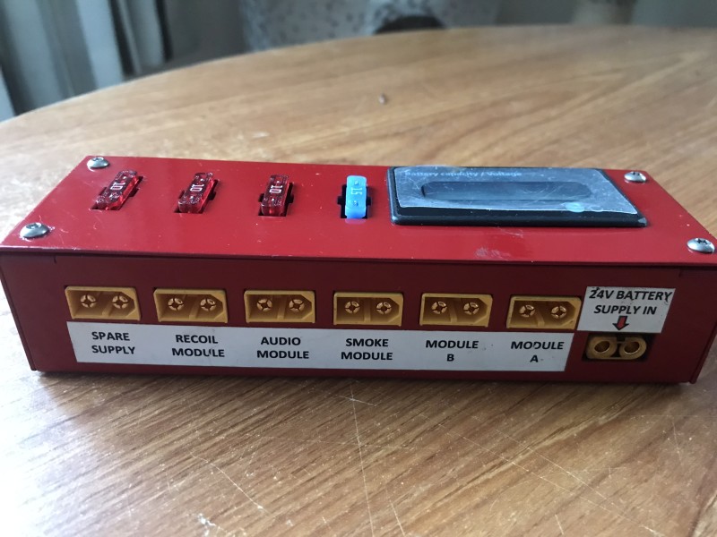

I am writing this post because I cannot contact Armortek due to their holiday shutdown AND as a warning to other builders who have the new power distribution module.
I had installed everything from the options packs and everything was working correctly….

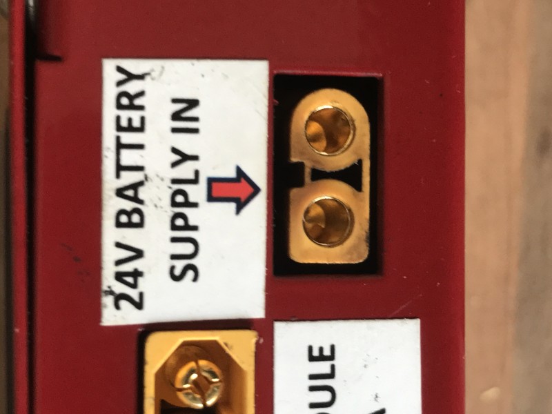

Yesterday I switched on the main power switch to activate all systems and there was a sudden sparking sound, followed by smoke, followed by FLAMES… all coming from the main 24 volt input socket into the power module.
Luckily, I was able the quickly switch off the main switch and blow out the flames . Once over this shocking experience, I could see all the burning had come from just inside the module main input socket which was all black and smelt of smoke which it still does.
I can only presume there was an internal short in the main socket. BUT I must ask… WHY IS THERE NO FUSE between the 24 volt batteries and the distribution module… in fact it states on its back that the 24 volt input is NOT fused.
Pending a response from Armortek, I would strongly advise all builders to install an inline fuse or circuit breaker, possibly 50 or 60 amp rated to protect you model. If I had not been present when this short occurred, I dread to think of the consequences.

Brian, so sorry to hear about the power issue. Putting a fuse in line with main power is certainly something I had already planned and have the parts on order. I am still bench testing since I don't have Module A yet, but it will be installed before everything goes in the tank. It is also just a protection should the battery leads touch while installing components. That is a lot of current on a direct short.
Since the Module A and B outputs are not fused, did you see any issue with either audio module or the motor controller? The motor controller especially, since it is capable of supplying 60 amps. Did anything start up before you saw sparks, or was it instantly when you powered up?
-Ray
-Ray

Hi Ray….. It was a direct short under the input socket within the power supply module…. Transmitter was on and all switches/controls were off or neutral. It was instant as I switched on the battery switch…nothing had been getting warm on previous operations… there is no evidence of any other shorts anywhere… the full wack of the 24 volts got as far as the socket and hence flames from the input socket .. the power module does not have a warranty seal on it so if Armortek will get in touch maybe I will look inside
Brian
Brian

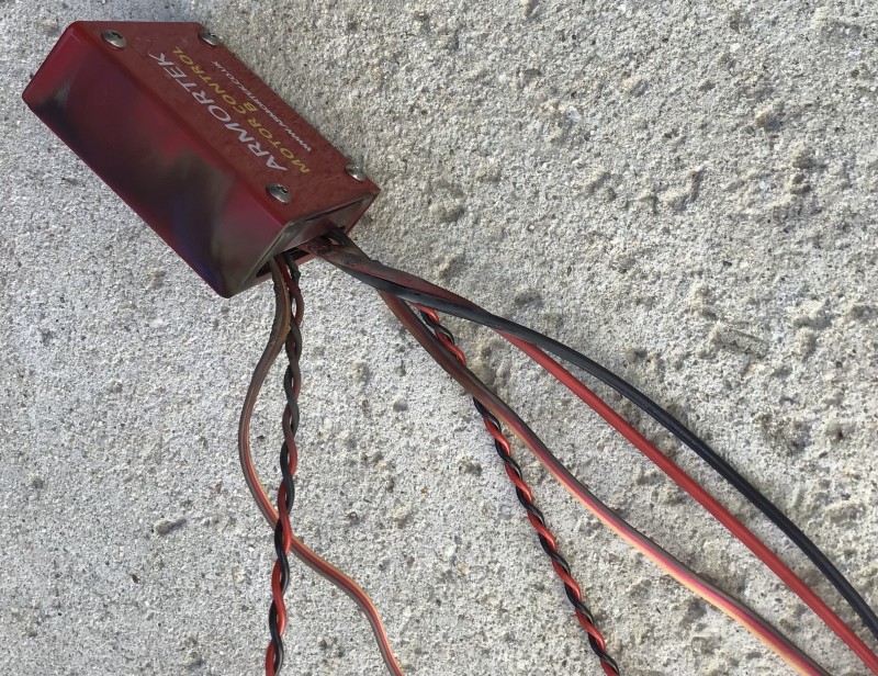

I guess I am not alone with motion packs on fire. I posted my recent experience in the motion pack forum.
Mine was just the motion B pack which is for connecting the turret turn and elevation motors.
It is very disconcerting having something burst into flames. At least mine happened when I was bench testing it. I can’t imagine what would have happened in the finished model.
Makes me wonder about continuing with it.

Again … module B is NOT protected by any fuse or circuit breaker…. My power supply module was inside the tank when it caught fire…. Lucky I was present and able to switch off almost instantly…. My heart was racing…
These modules NEED PROTECTION BY FUSE OR CIRCUIT BREAKER and in addition I would be happier if the terminals on the RELAY were not exposing bare terminals below the yellow spade connections
Brian

Re: FIRE in power module
I would think there is some defect in the design and construction of these units that has two recently purchased packs burst into flames.
It was quite scary having the unit burst into flames the smoke alarm going off and the scramble to shut off the switch and blow out the flames without spreading.
I guess I was under the assumption that the motion packs were “plug and play” without having to re engineer the wiring systems to incorporate protection measures into the system.
