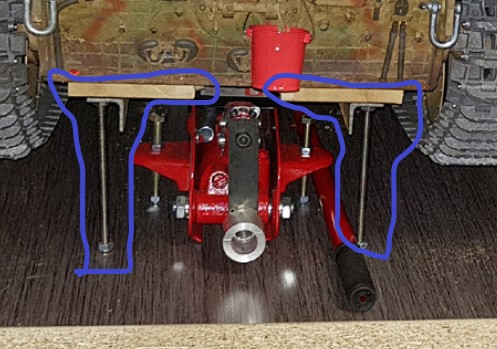

Hi Matt,
well, all my tanks are stored upon hydraulic car jacks to release pressure from the torsion system.
The car jacks are modified to allow the hydraulic system also to be in lowest positition. To use the tank the car jack lifts it until two planks can be moved under the track links.
Then the jack is released and the tank can roll on my moveable hydraulic lifting table.

Hallo Gerhard,
are the marked pieces insertable supports that take the weight of the tank so the jack is not constantly loaded during long-time storage or something else ?

Re: Tank storage
Very interesting. I may have to look into this.Gerhard Michel wrote: ↑Fri Jun 02, 2023 10:16 pmHi Matt,
