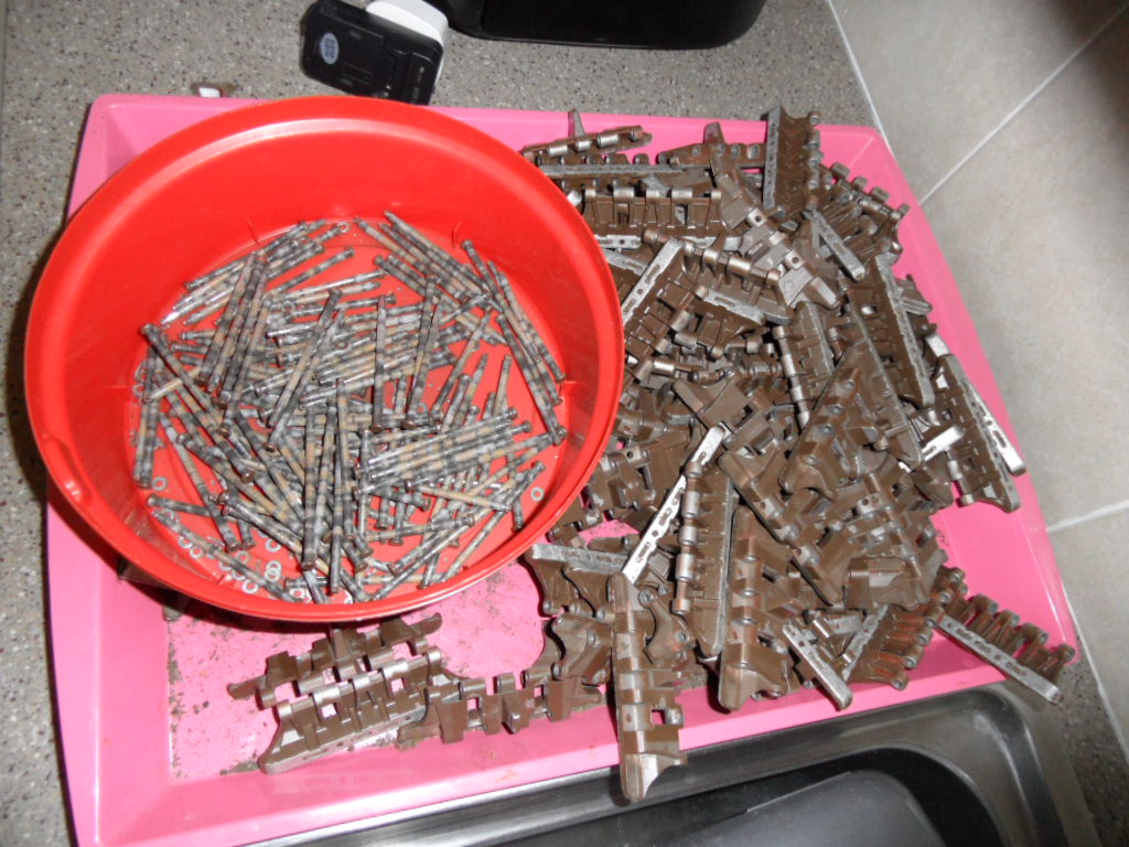

The gorgeous model has to be well over ten years old and I thought it would be nice to give the tracks a look over to see if there was any wear and tear on the links and pins. Some TLC.
This is what I found and what I did about it.

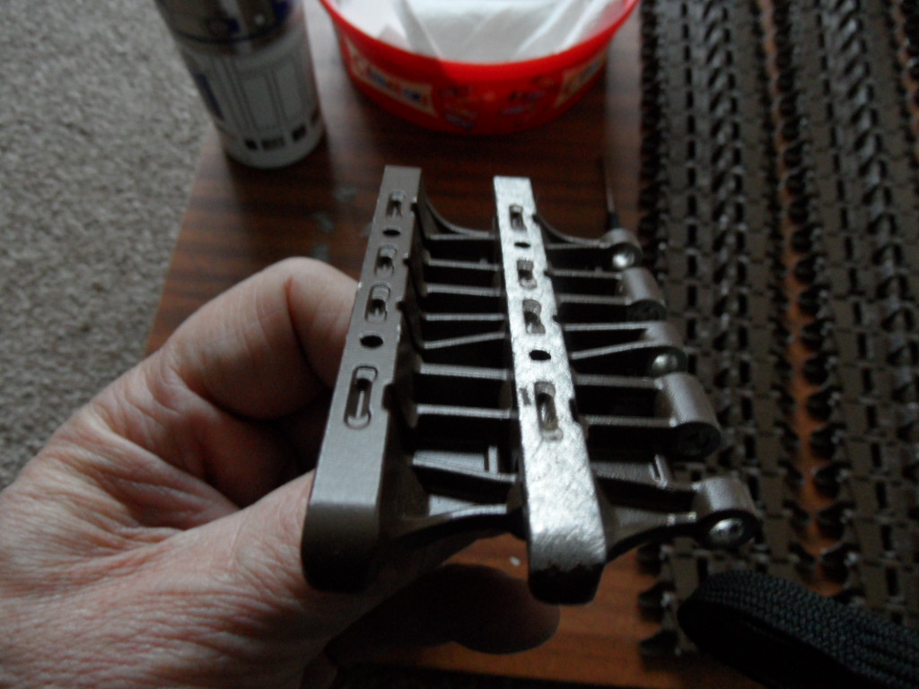

The tracks were originally painted by David to give them used look are still looking good. I didn't want to change that so they were striped as they were. Concrete, brick paving and tarmac will take it's toll, but I try to run on soft dry stuff to conserve them.
Pictures show rust and blackish debris slowly building up on the pins and a little corrosion in the track holes, comparing with a new track and pin, all in good condition. I dunked and cleaned the track and pins with white vinegar which removes any light rust and debris, rinsed with water. Dry lube applied to track pins, then rebuilt with dip of red and tacky and a brand new stainless split pin.

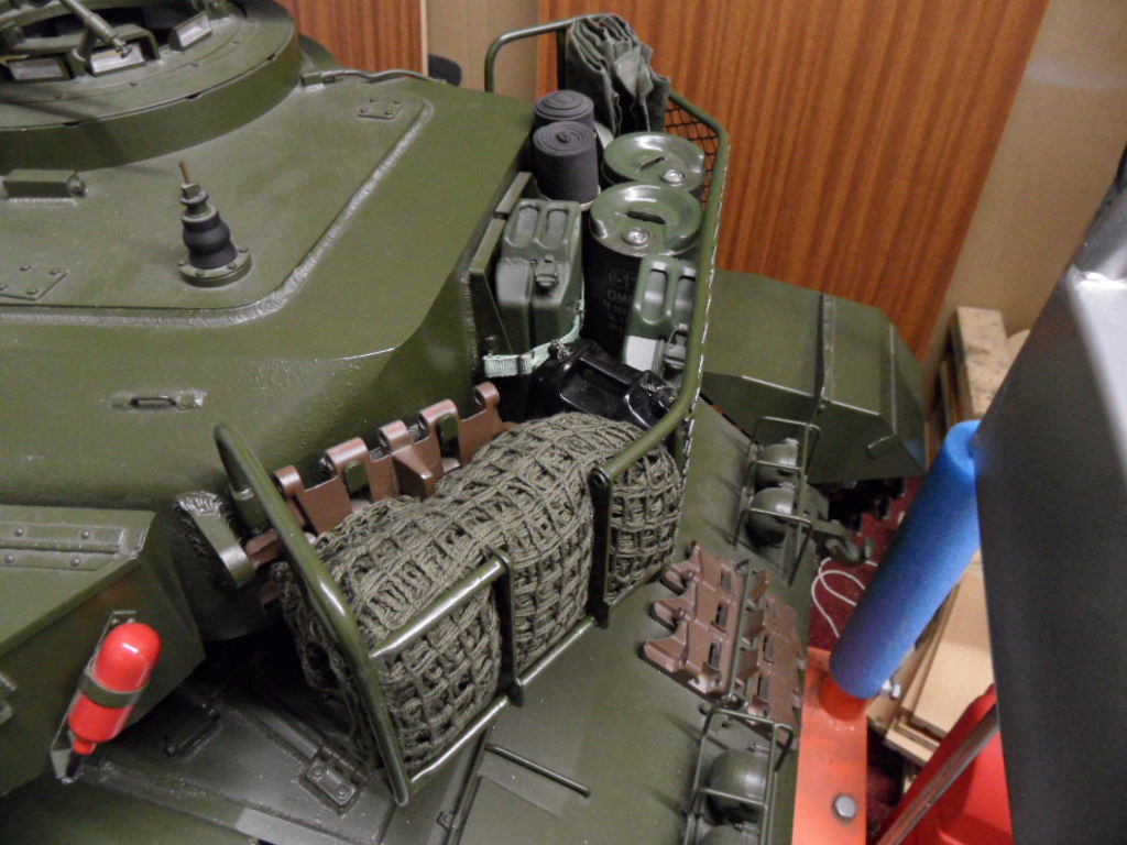

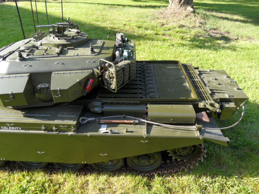

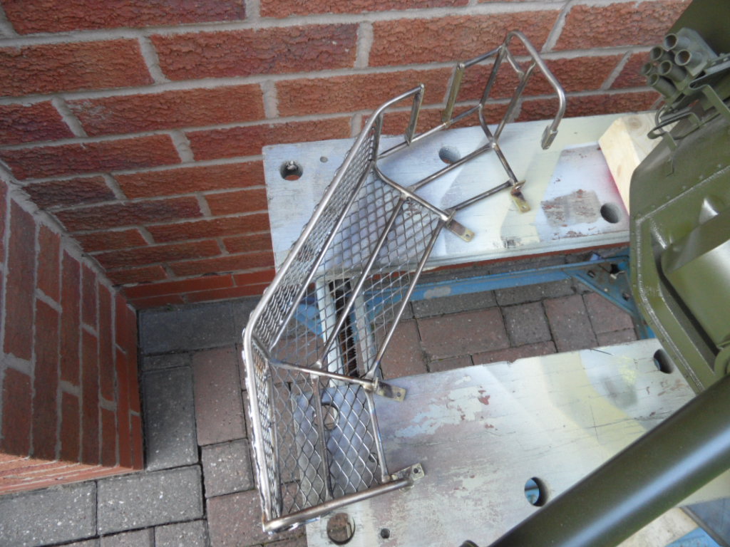

Whilst being on holiday I was regularly reading the daily AT forum as usual, when the opportunity came a knocking to buy Mr Dawes original Centurion turret basket. Phil couldn't get the Search light to fit in the original supplied basket so he decided to start with fresh new one. So the old one came up for grabs. :P
Money transfer made and the basket was winging it's way to me. 8)
Mr Wilkins Centurion being an upgraded version would probably been given a turret basket and it would not have looked out of place in it's day. It also offers the opportunity to add some detail parts from Armorpax to humanize the model with a few user items.
When I got back from holiday the parcel was waiting and after the round of usual jobs to do when you get back from holiday, started looking what was needed to get the basket on. The basket itself is very well made, so very pleased to get it.
Weathers been ok, (just today turned nasty) so I could hump the turret outside onto the old workmate, thank goodness it's not Chieftains turret!

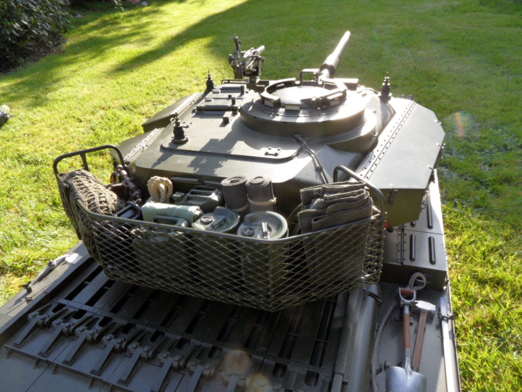

First the support L brackets had to be silver soldered back on then aligned to the turret. Fortunately it just fitted within the detail parts Mr Wilkins had already fitted, holes drilled and tapped, Basket painted and bolted on.

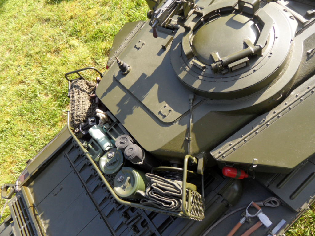

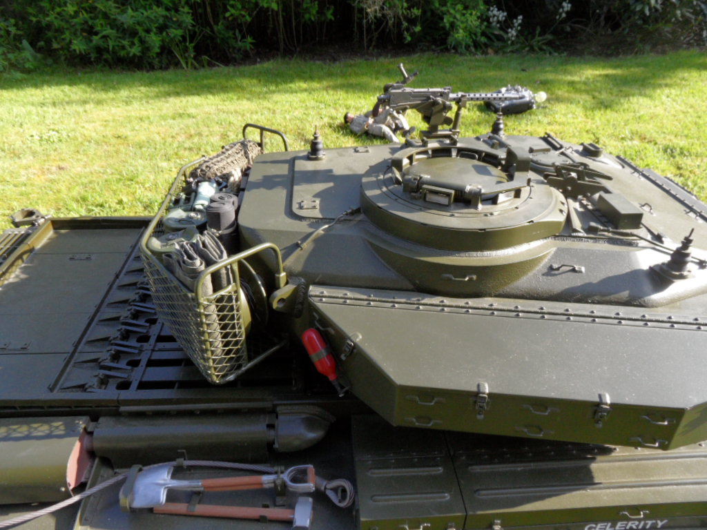

Since I'm not going to fit a search light (there's no bracket on the front of the turret) I've filled the big gap where the search light would go with a bundled camo net, (Actually a scrim scarf, does the job) added a second metal jerry can, water canister, two oil cans, two bed rolls and a tarpaulin made from a paint soaked men's handkerchief, folded up it looks the part. :o

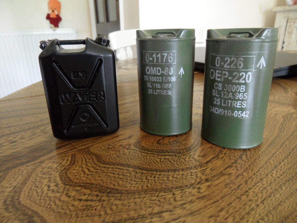

The Armorpax oil cans were were painted and with a smear of "weathering" paint to look like oily stuff across the label, not too much, an oil rag wipe amount I think looks the part.
They may not be the right oil labels as they were brought for Chieftain. (I won't tell if you don't) :D
There's still a little space in the basket, so I'll be looking around for some smaller items of interest. (A coil of rope maybe)
I'll now be waiting for some really nice weather to get outside for some shots like this. :|

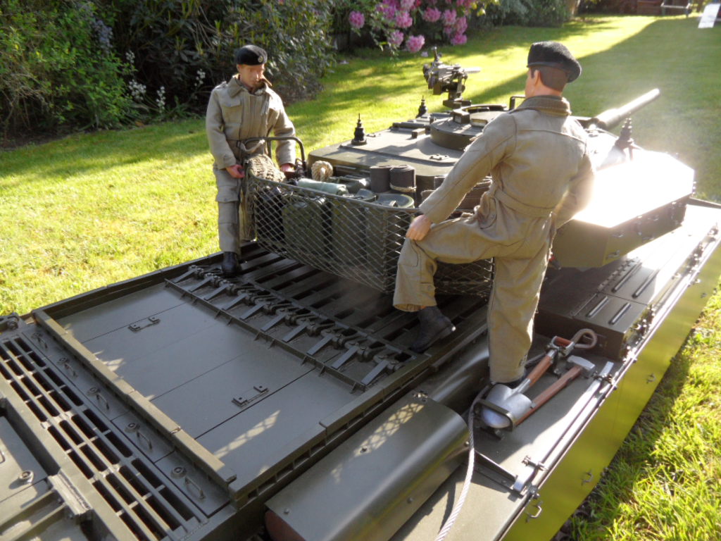

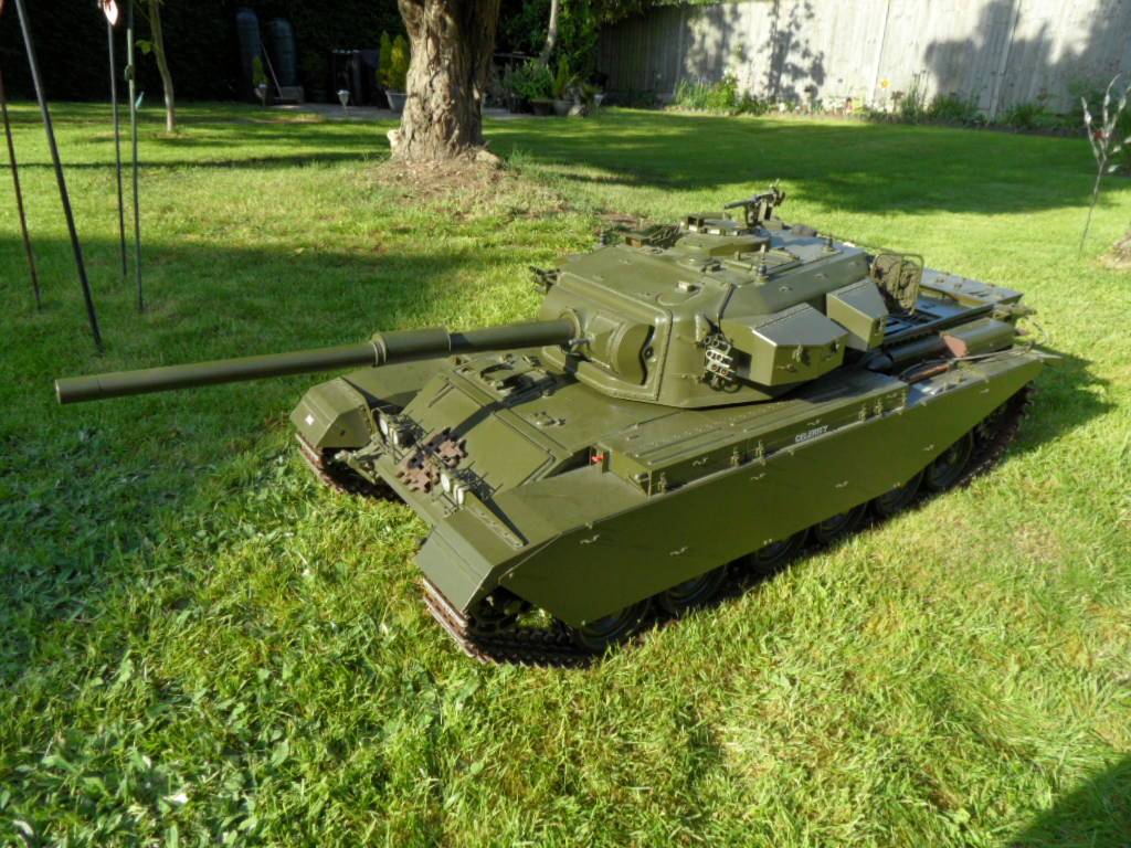

Hi David, hope you are well, your right it's time the Cent came off its winter storage blocks, weathers glorious grass cut, so good chance for a photo shoot.
Trying the cleaned up lubed tracks too and checking out that nice new (to me) basket from the two Phil's on the Cents turret.
The Cent is now all connected up and she just waffs along quietly into a position in the garden for a sunshine scene.
And the action shots.
