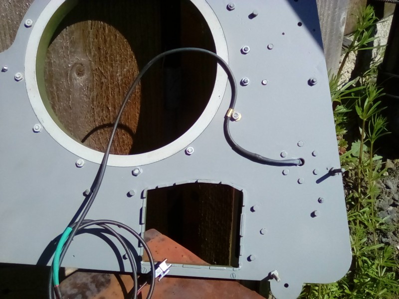

Vince the led is illuminating the bulb through its base, I ground back the glass bulb trunk being careful not to crack the delicate sphere, the bulb is dead .

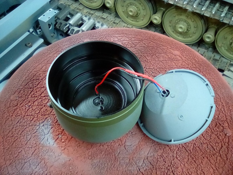

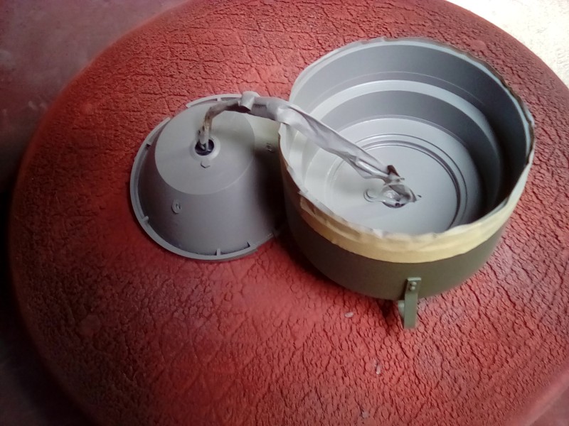

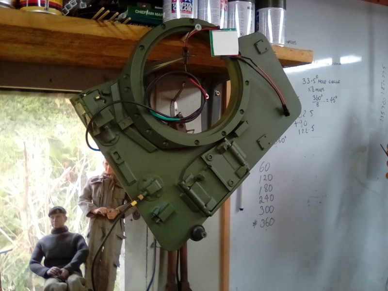

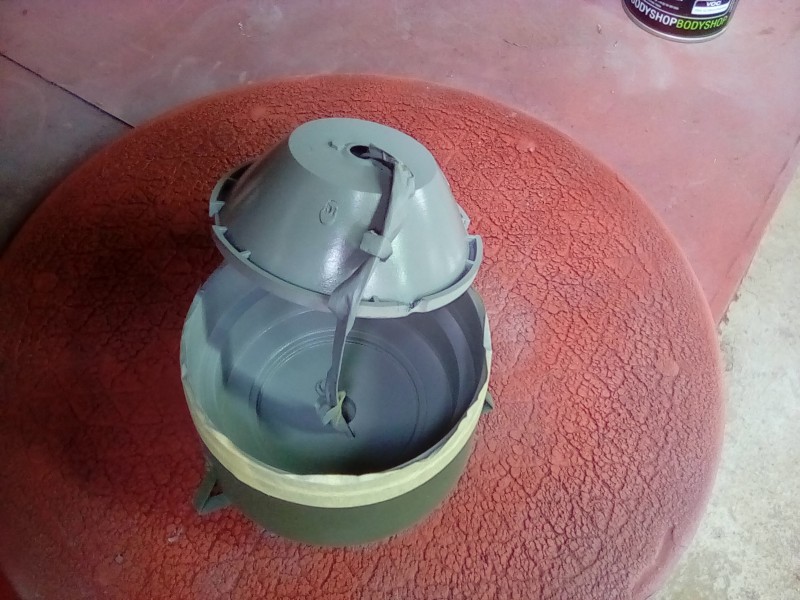

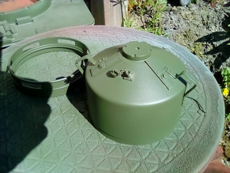

Just a little wiring and painting of the interior of the searchlight, we are now waiting for the lens piece catches and the makers id plate to finish.
Earth bolt in
Earth bolt in
Lots of primer
Lots of primer
Matt black to finish

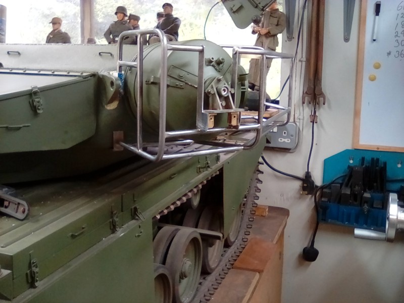

To the turret basket.
Ummm, nicely made but not for the searchlight, Mr Dawe may flog the basket if anyone is interested?

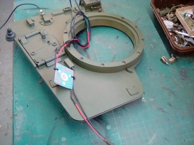

Wiring for the turret is now complete
The best way to store this piece whilst it's not in place

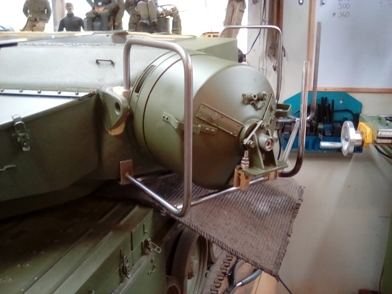

One last attempt to make the basket fit
I'm trying very hard to use the basket but it's just not going to happen

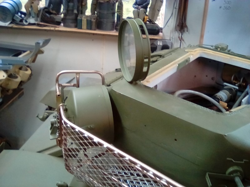

It fits without the end piece
Shame we can't use the basket as it's just a little to narrow for the scale searchlight

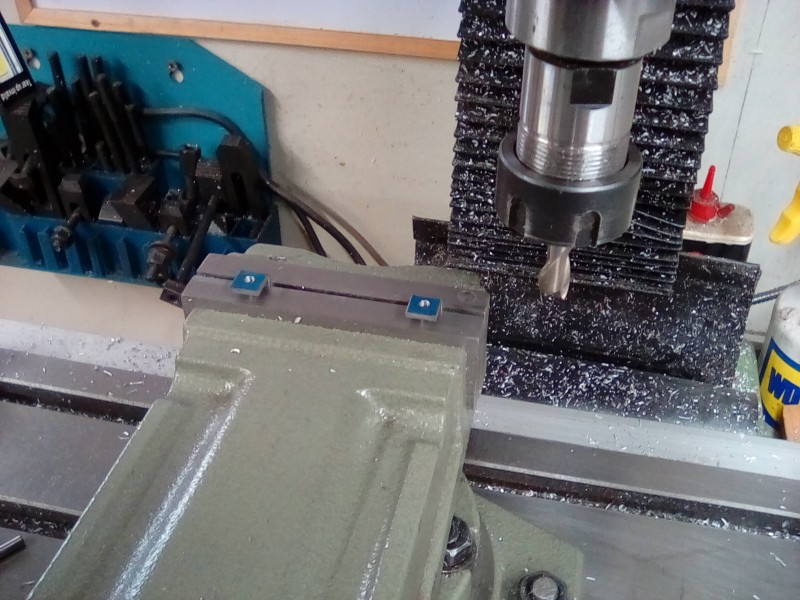

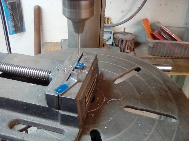

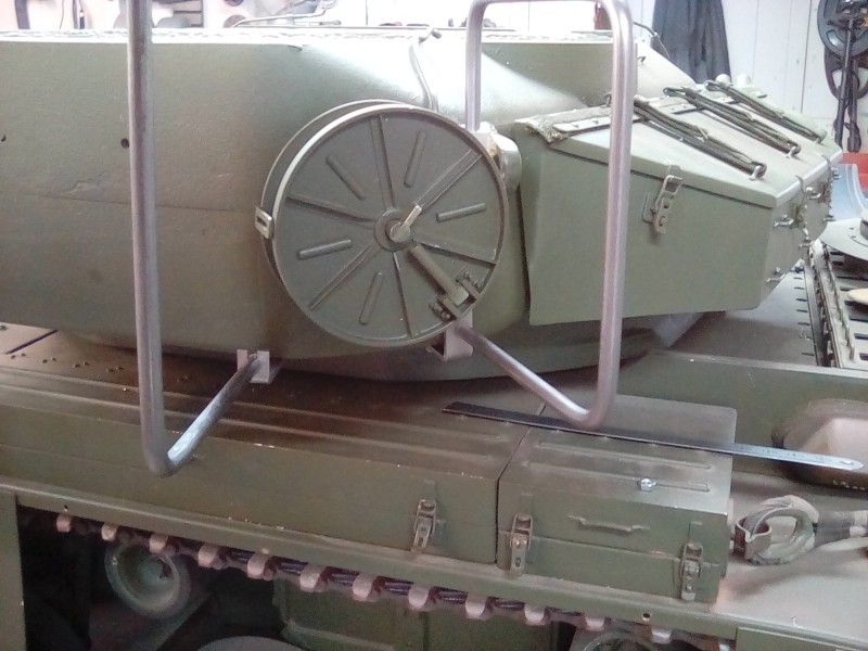

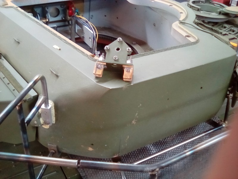

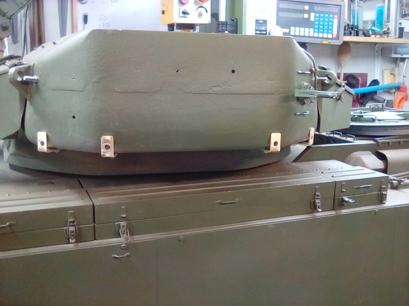

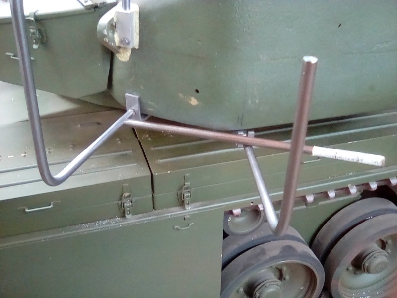

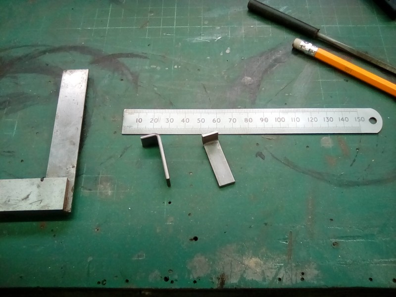

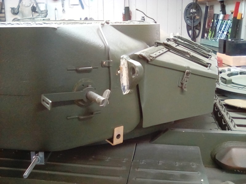

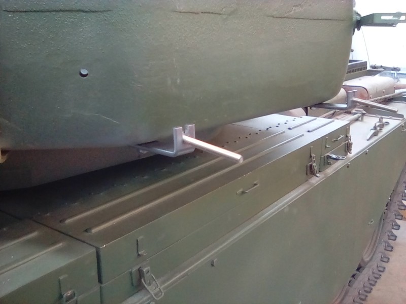

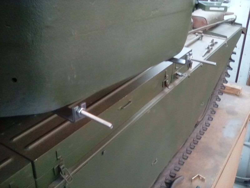

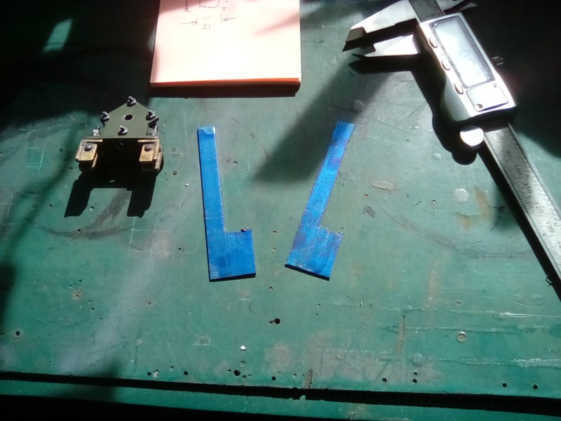

I need to make new brakets

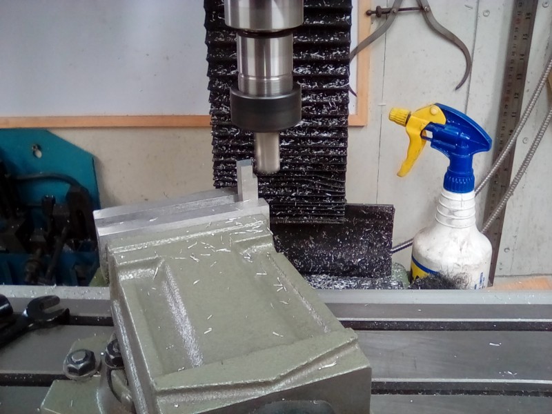

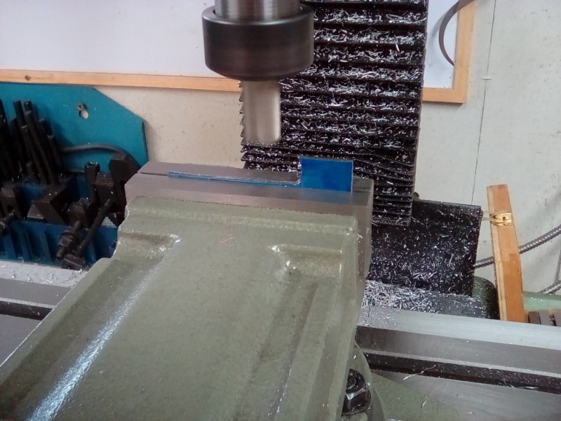

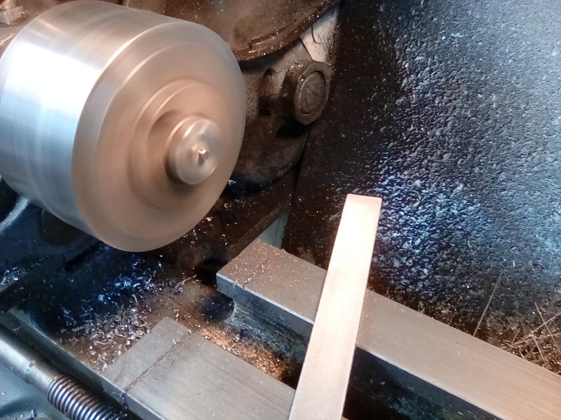

Milling the slots in the bottom turret basket fixings
Adjustable bottom fixings

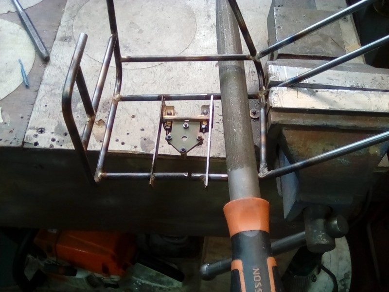

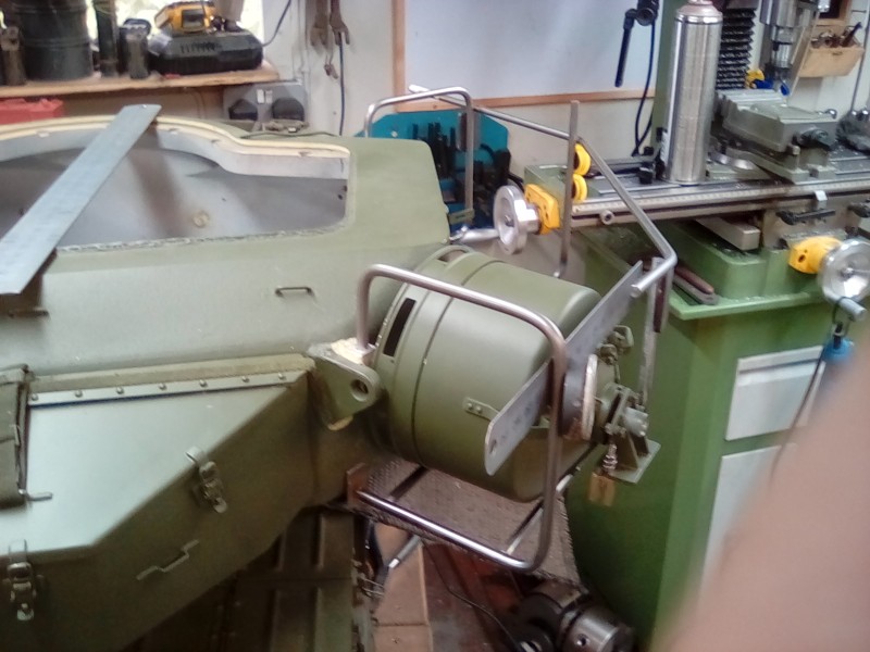

Baskets. I'm going to build the frame in place rather like using a "jig"
The frame ends need center drilling now.

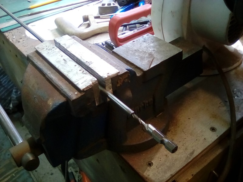

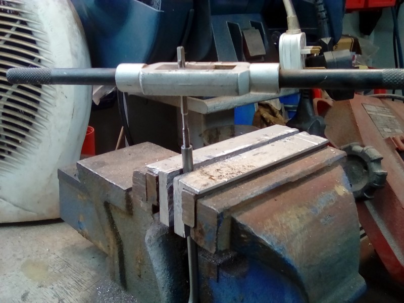

Tapping the basket frame ends while the steel is still straight

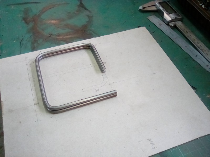

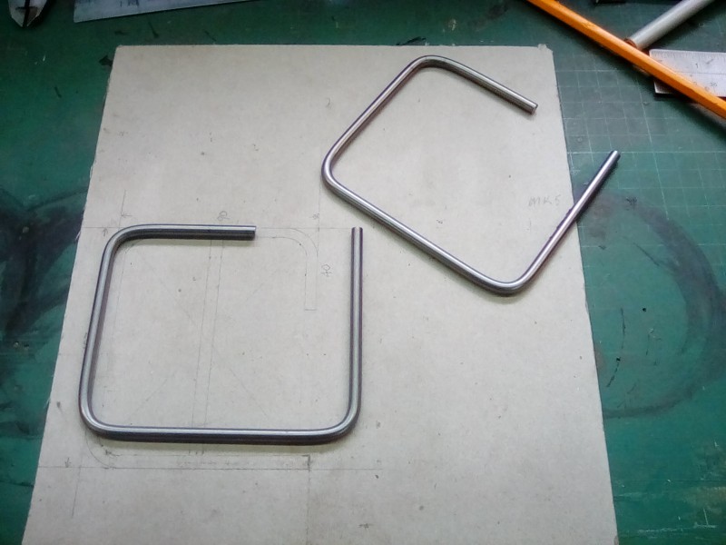

Just following the lines, I'm cold bending the steel and it's just about all my fingers can cope with

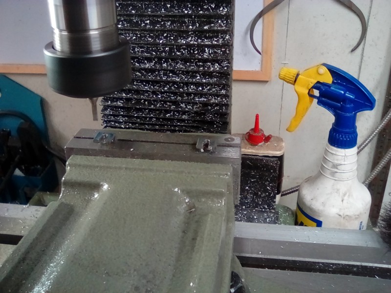

Ready for milling
Ready for milling
Awkward angles to mill
Chipping away the weld bead as it's in the way
The compromise is the m2 fixing
Weld beads done
Weld beads done
Some hand filing is required
Removing my nice weld beads

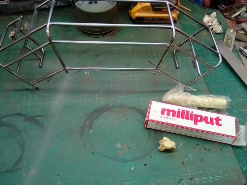

The milliput can cure overnight, I can then drill the basket frame holes in the top

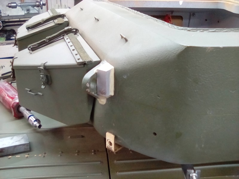

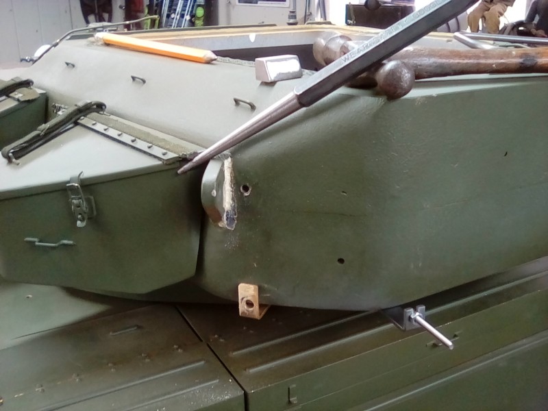

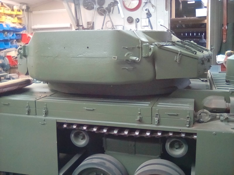

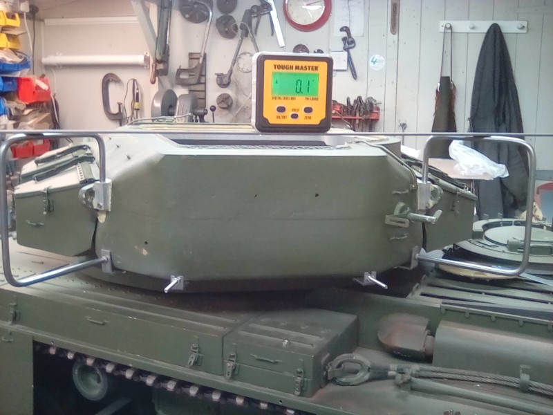

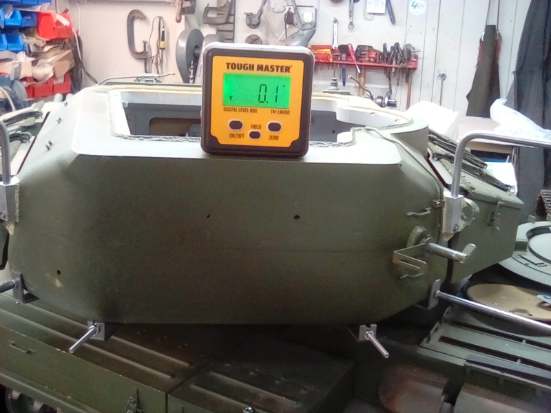

More turret basket framing, I'm not going to rush it as we want it just so.
I really want to leave the turret on for this work
Just remove material untill it's all level
Handy bit of equipment this
More of this
More of this
And this
And this
I'm happy with that tolerance

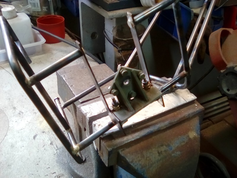

Once the first brace is soldered in place things will get a little easier
I need to scallop the joints but also need to create the squashed pipe welded look

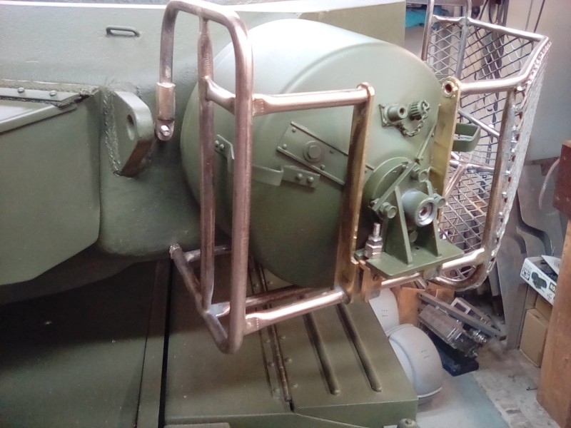

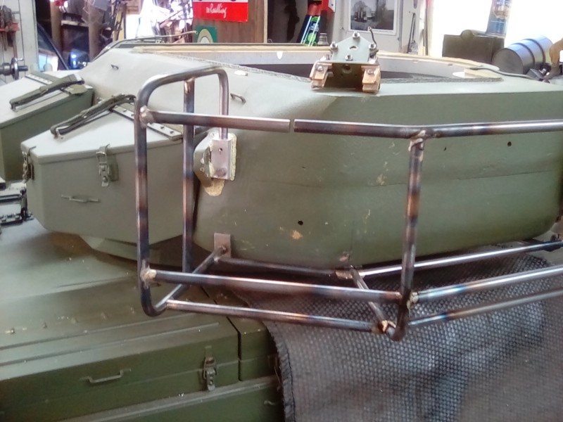

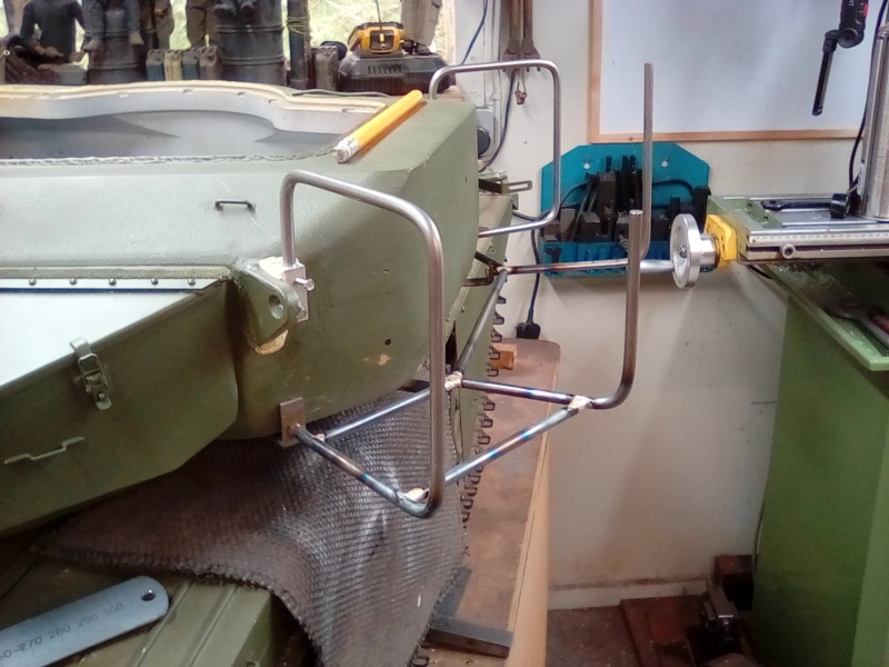

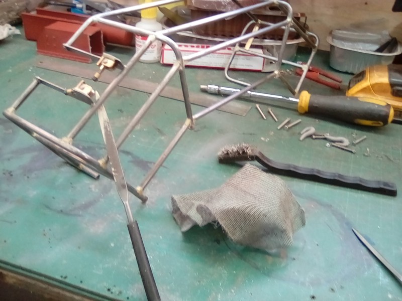

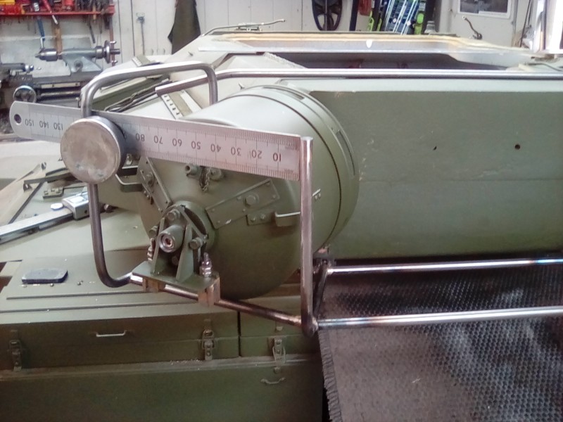

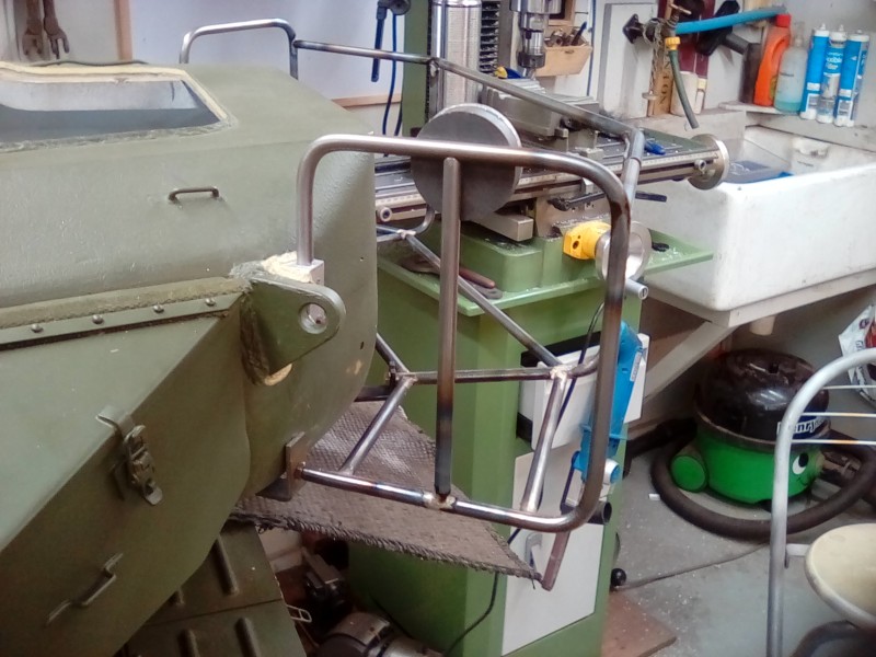

Lots more basket construction photos .
Lots of angles to follow, it's not really possible to completely follow the drawings we have as the Armortek turret is slightly different

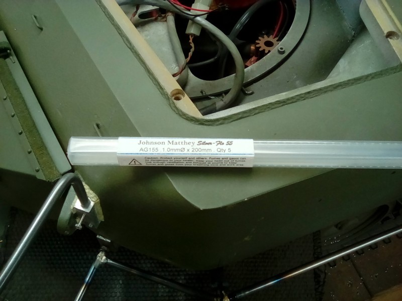

55% silver solder
55% silver solder
That glass fibre mat is a must

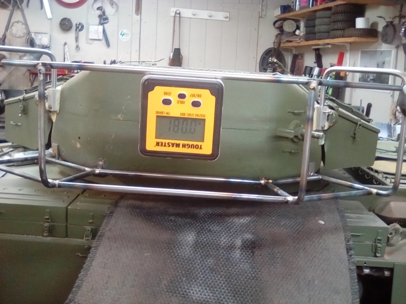

It fits, well it will with a bracket

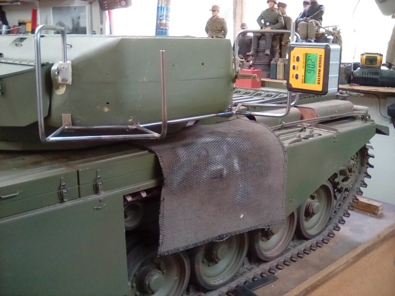

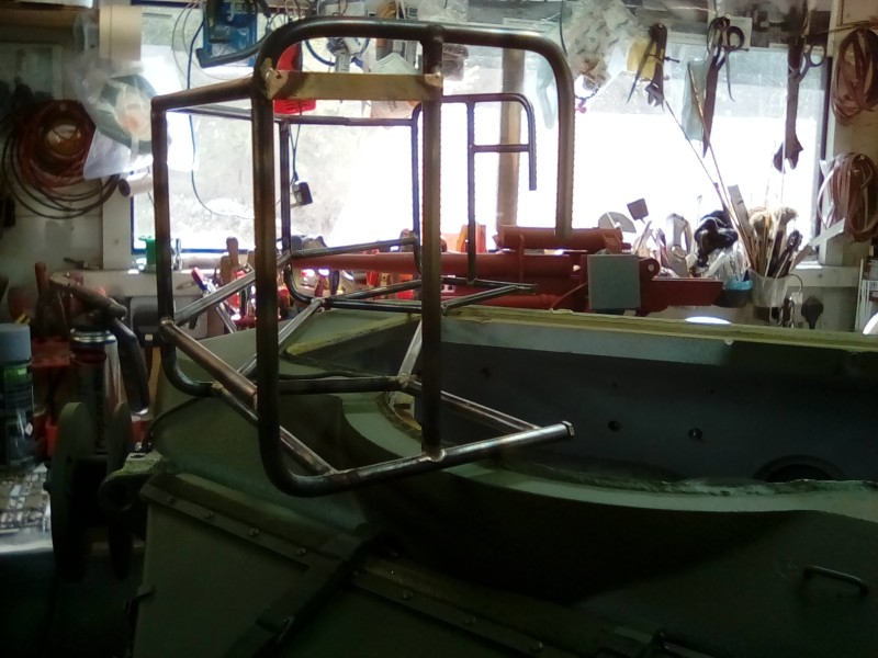

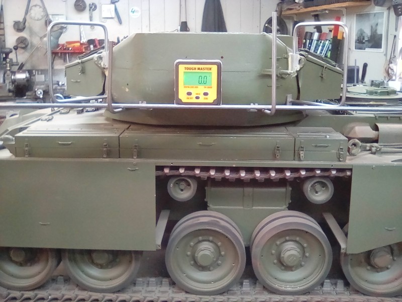

Constantly check for plumb

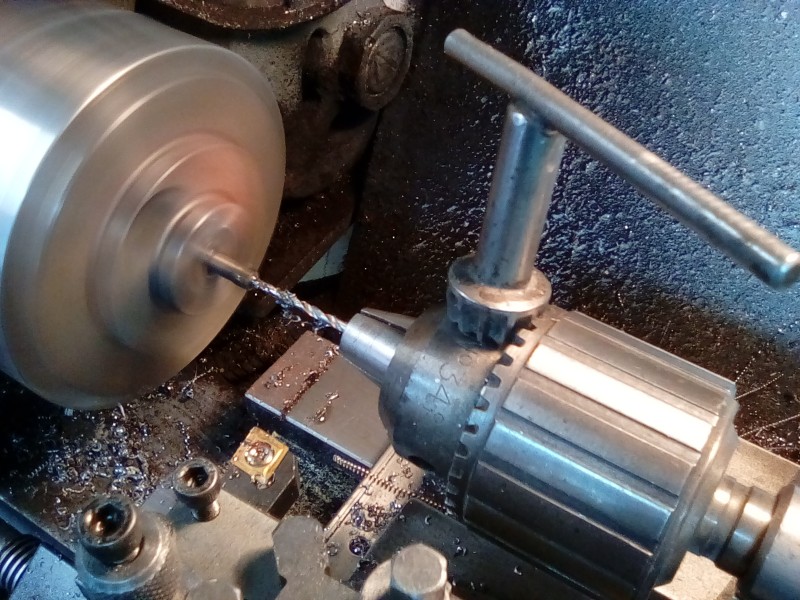

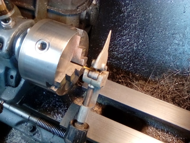

All the brace ends are turned true before scalloping
Always with the magnets

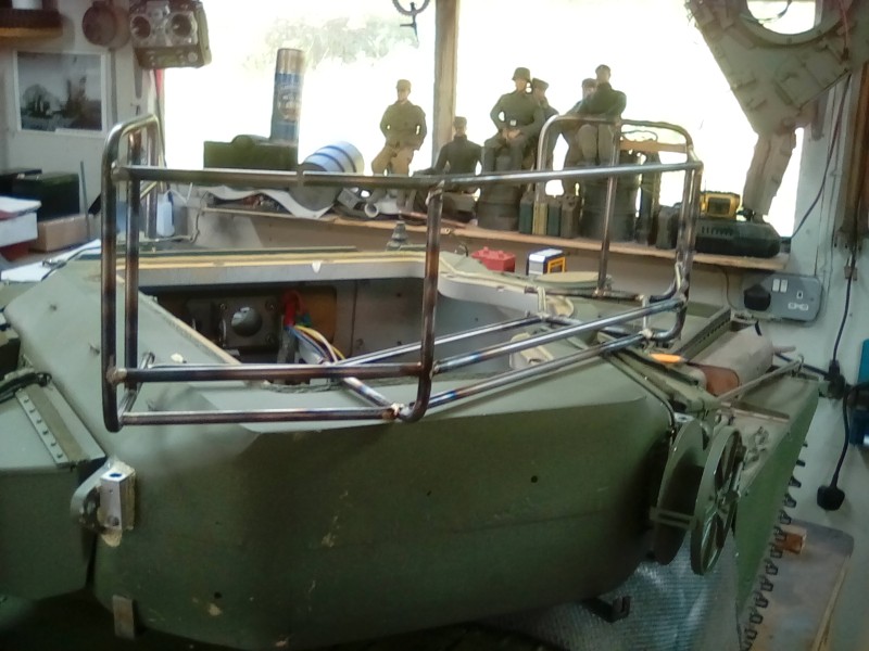

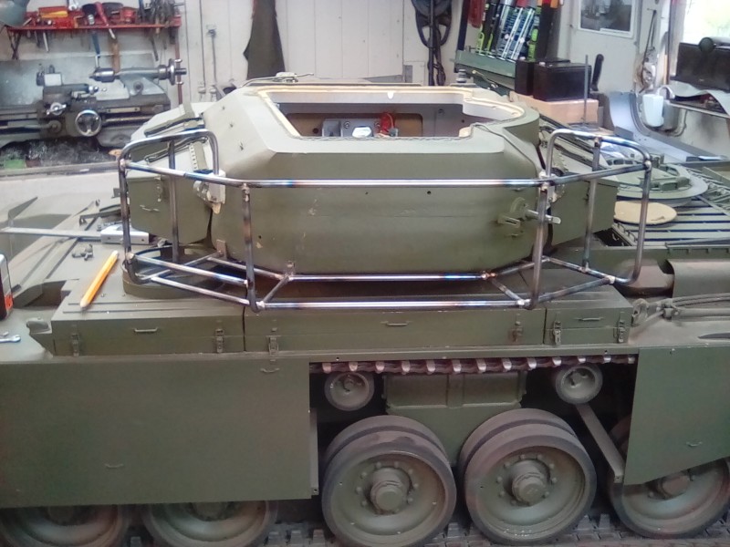

Getting there with just a few more braces then onto the searchlight mount

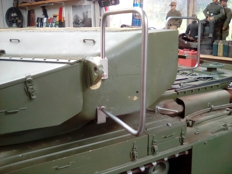

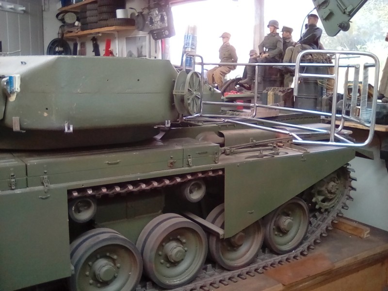

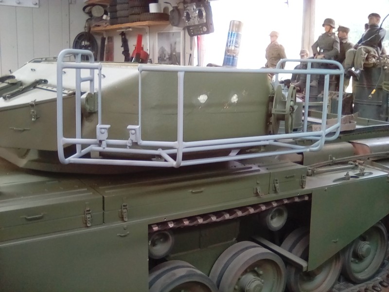

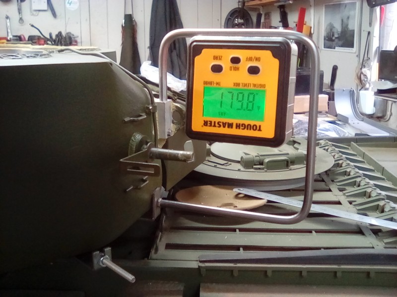

Checking the swing over the decks
Fully removable and fully adjustable just like the real thing?
Posts: 4268

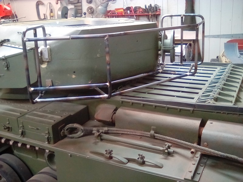

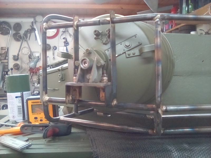

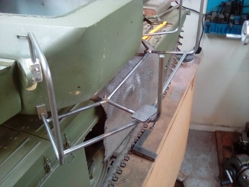

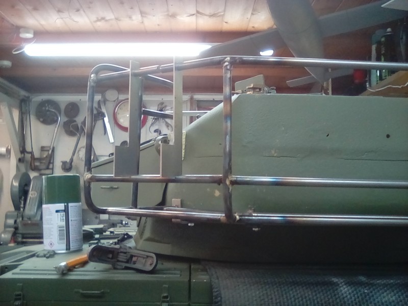

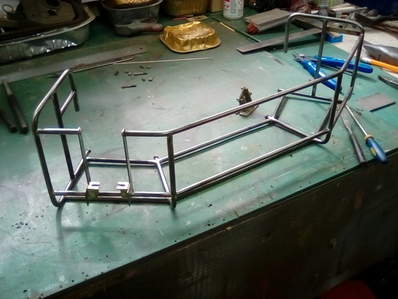

Lots done but it's tricky work for sure.
All the braces now cut and silver soldered in place
It all lifts out
It all lifts out
Tricky part now
Tricky part now

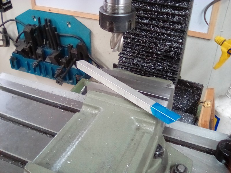

Roughing out.....
Roughing out.....
......the brackets
......the brackets
Just as well use the mill to square it all up
I won't cut the top tubes until I'm happy
I like to leave it all square for now as it helps to true everything up, the angles can be cut once it's all in place
Some juggling to line it all up
Next job is to get the searchlight bracket fixed, that will require some careful silver soldering
I'm very happy so far
Posts: 4268
Has liked: 2259 times
Been liked: 7147 times
Re: Mr Dawe's Centurion.

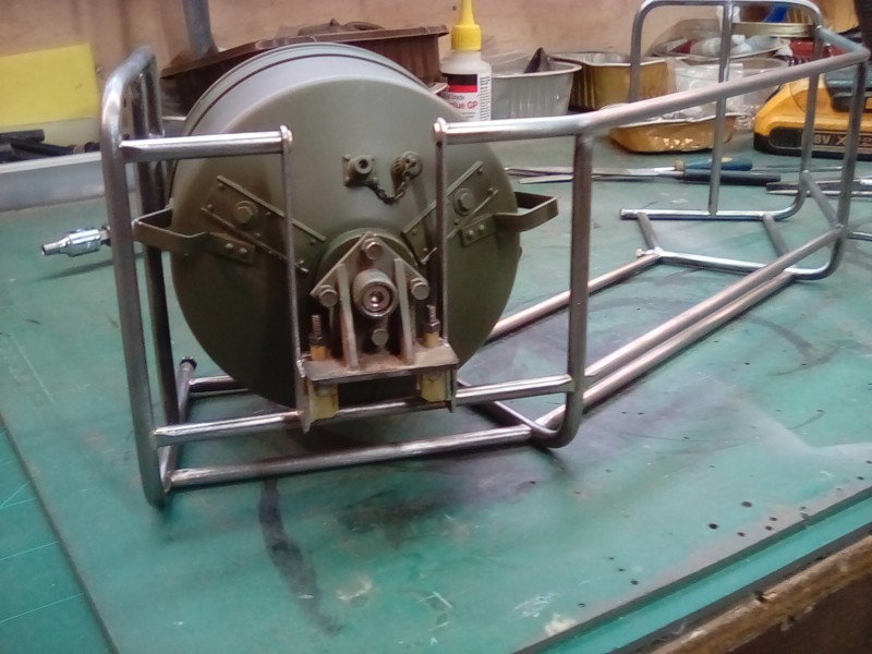

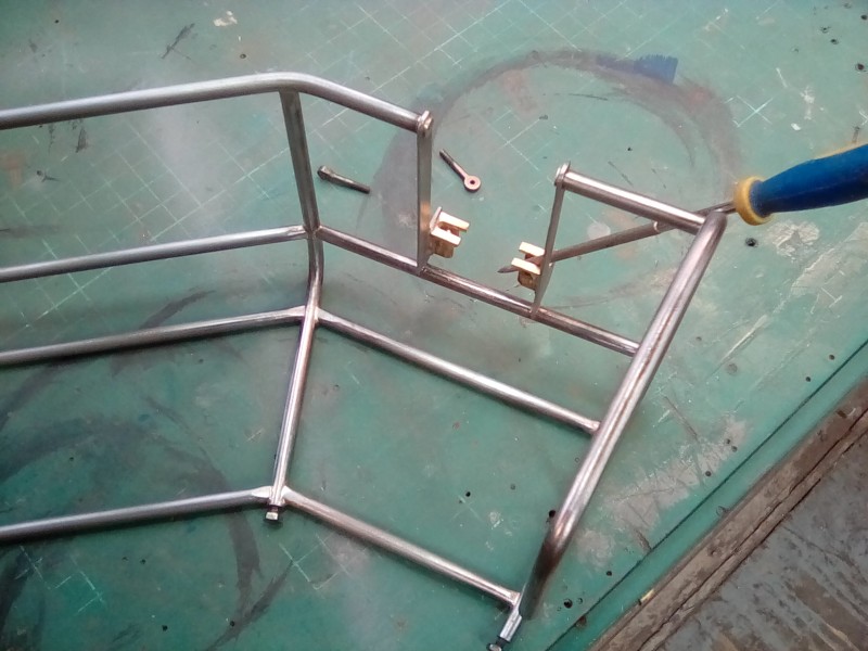

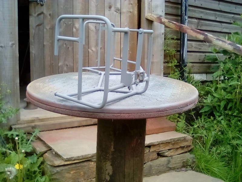

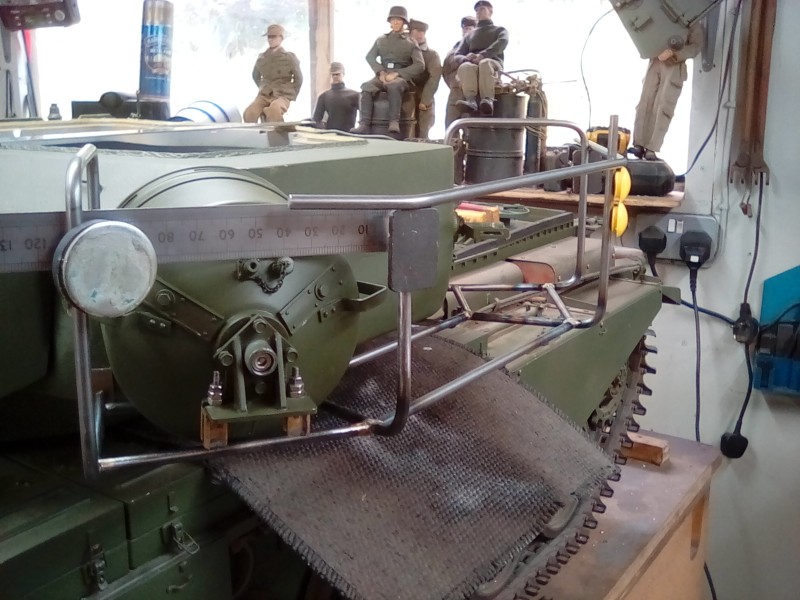

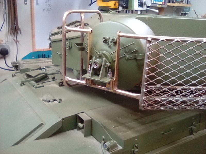

All the pipe work is done so now to the cleaning up, forming the crushed joint look and shaping the searchlight bracket.
Carefully does it
Carefully does it
I have now cut off the long tubes so the searchlight and the bracket slides in nicely
It's an awkward shape to work on

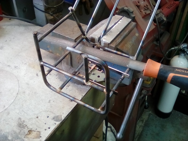

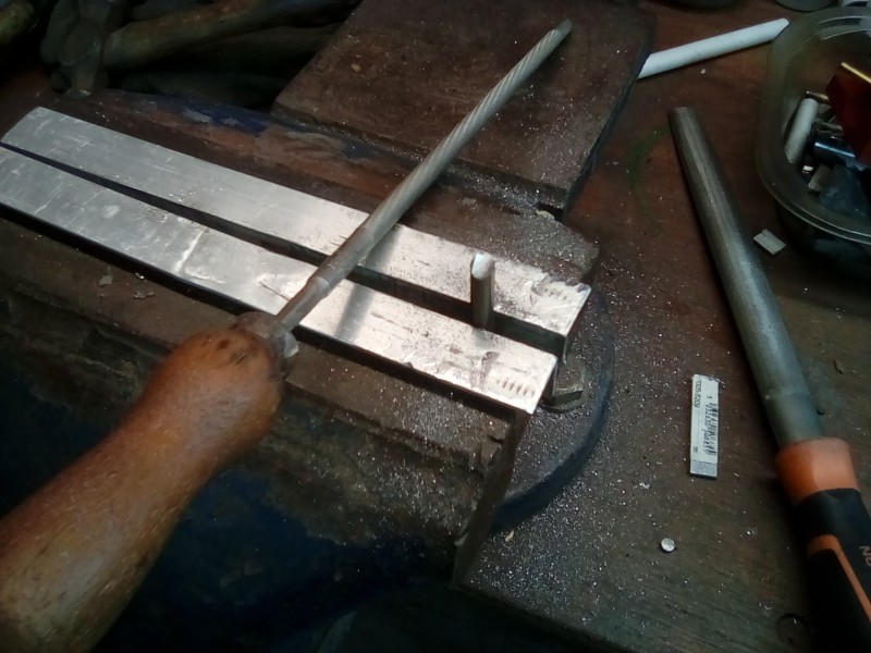

Lots of needle filing, lots and lots.
Difficult to see in this photo but the squashed pipe joints are now all done inside and out.

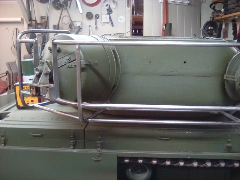

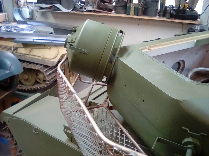

The searchlight is a snug fit but it does fit
Handy swing out function

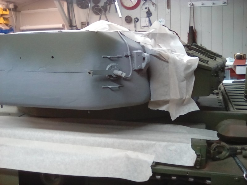

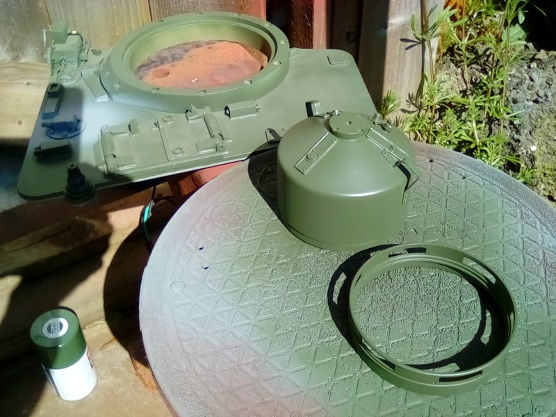

Priming the new parts and tidying the knocked about existing paintwork
Ready for top coat
Ready for top coat

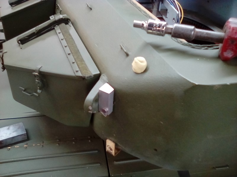

These hinges need some fetling to allow the searchlight mount to slide in
Painting where I can as I go
All this touching up helps with the overall patina

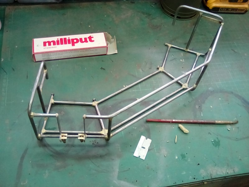

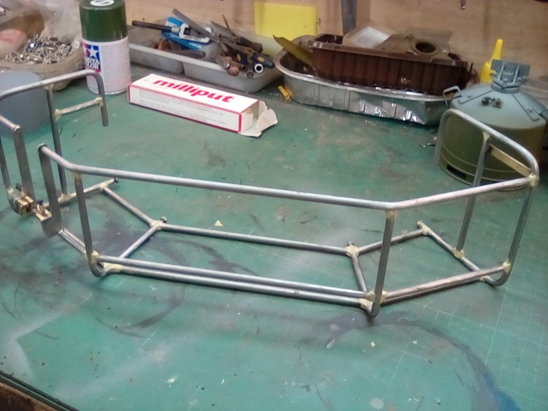

I've added a fair amount of milliput to the joints so I have enough to play with.
All roughly filled with lots of awkward work to follow
Now to let the milliput cure ready for profiling

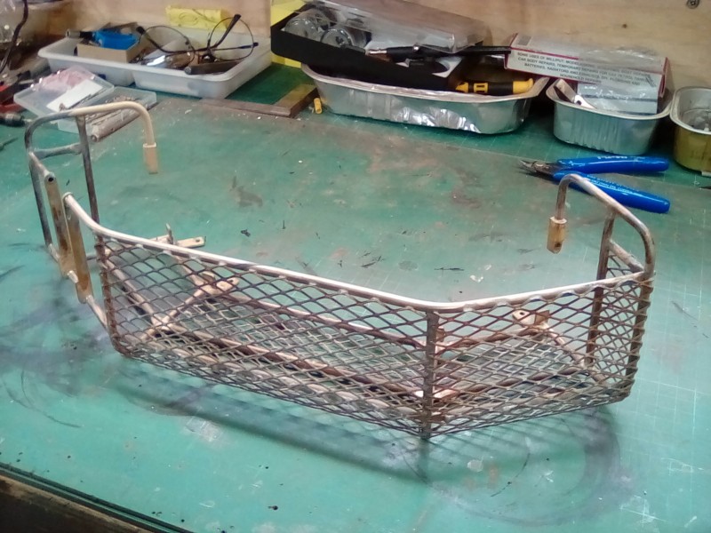

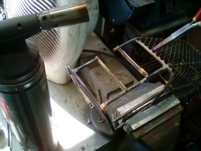

The turret basket is now ready for the expanding metal.
Lots of very awkward and tricky needle filing to get the joints to look more convincing, the files get bunged up very quickly and need constant cleaning using the rotary wire brush.
The primer is not such a good idea as we have the soft soldering to apply to fix the expanding metal but some wire wool on those areas will suffice
I'm happy with the look so far
