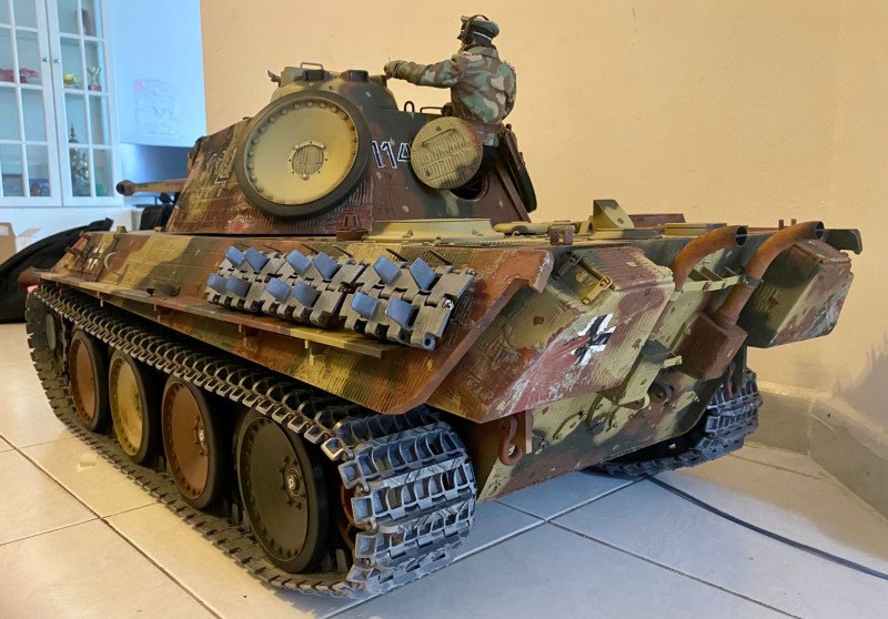

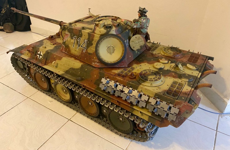

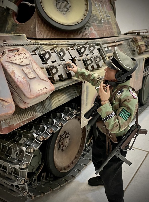

Post by Chris Singer »
Got the tracks muddy at last!! :D

Brian Ostlind
Posts: 1466
Location: Oregon, USA
Has liked: 976 times
Been liked: 2068 times
Re: Panther G No.24 just landed in Singapore!...
Post by Brian Ostlind »
Very beautiful.
Posts: 2355
Has liked: 163 times
Been liked: 849 times
Saw your post on FB - outstanding paint job! Looks great!
