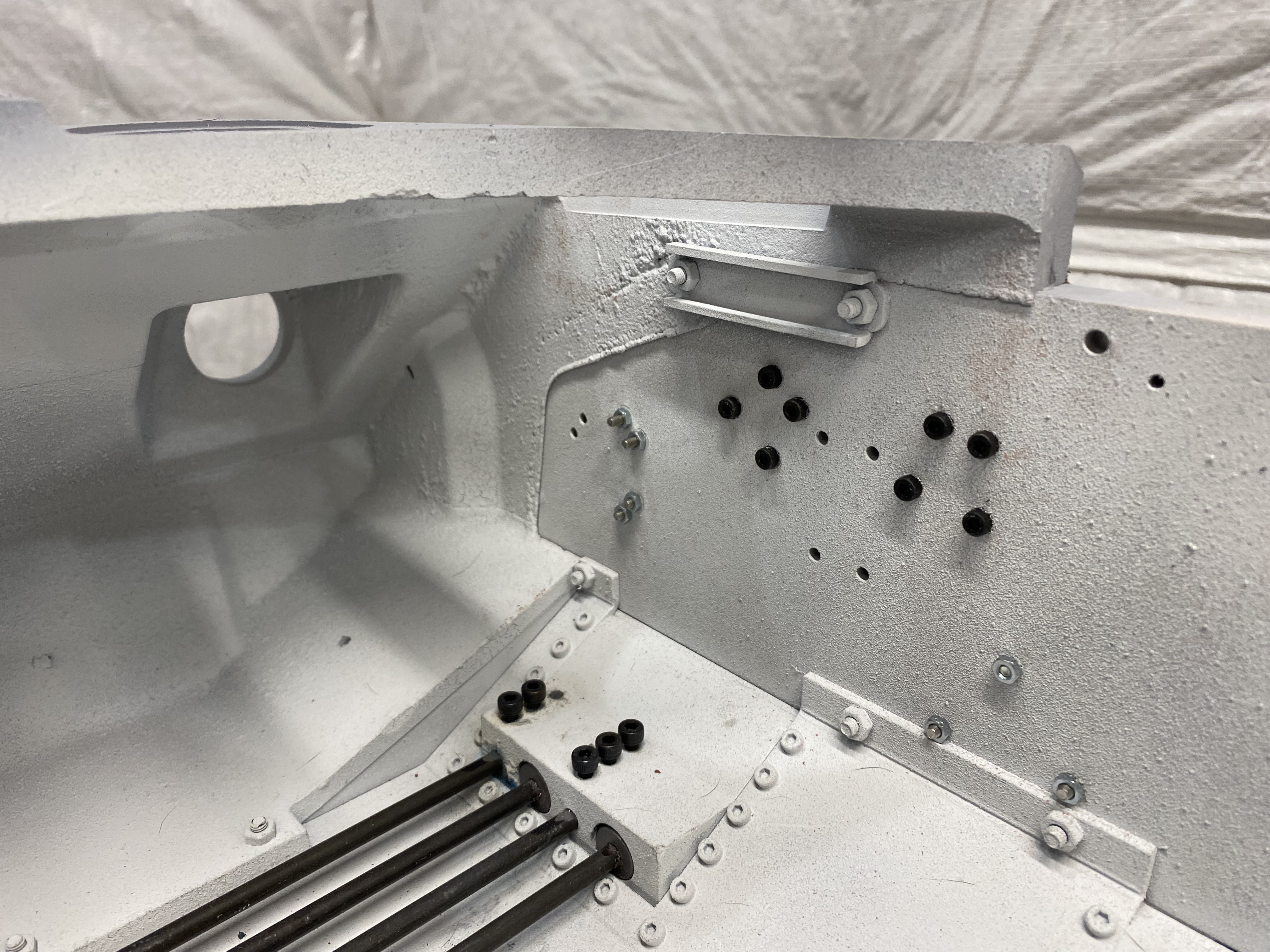

On part EVO111 and EVO111M, the three vertical holes that are to attach to EVO102 and EVO113 (side plates), these holes on mine are not threaded, but are called out to use M4 x 16 CSK screws. Anybody else having this issue?
One more minor issue, when trying to attach Side brace EVO121 to the side plate EVO114 using M4 x 20 screws, the screws are too short to grab onto the nut. Only a couple threads make it through. Just need to source a few longer M4's.
Thanks.
-Ray

I have the same issue with EVO111 and EVO111M, holes are not tapped and I can't find my M4 tap! Looks like a trip to the hardware store. I didn't have a problem with the brace, the screws come out of the nut. Maybe you picked up a 4 X 16 by mistake?

Nick, I see why you did not have the same issue with the braces. I mounted mine 180 degrees from the way you did. I looked at the drawings several times and looked at the braces on different pages, and it looks like they want the braces with the ridges toward the side hull. I did think about doing it as you did, but i figured since the drawing showed it the other way I would conform. Not a big deal, I just used a couple 8-32 x 1" screws, since I could not find a metric size handy.
Weird that some of the side plates were not threaded since they are CNC'ed programmatically I assume. I did tap them with an M4 tap. It was a fairly easy job.

On the bracket install, I don't know if it makes a difference, but looking at the instruction pics, it clearly shows (to me) the bracket goes 180 degrees from what you have. Maybe it does not matter, and maybe Armortek can chime in to let us know if it makes a difference, or if you have it correct, then the instruction pics should be changed. Your install seems more logical, but I just went according to the pictures. This is my first Armortek, so I am still learning.

I too tried with it 180 on the rear brackets and saw that there was not enough thread for the 4 mm nut but the CAD shows the front bracket the other direction. This is build #10 for me and I can see that this directional issue is moot point-the brackets with flat side up against the hull section vs the ridges against are not going to make any difference. I used two nuts on mine as the fastener stripped on tightening. The exterior will be getting a miliput weld applied also then you will not see the vertical split.

I agree, probably makes no difference. I will check the CAD on the front bracket. I thought they looked the same to me.
