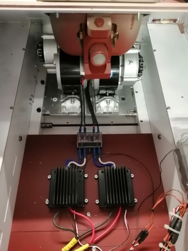

Twin Robbe 40 Amp speed controllers feeding through 40 Amp fuses

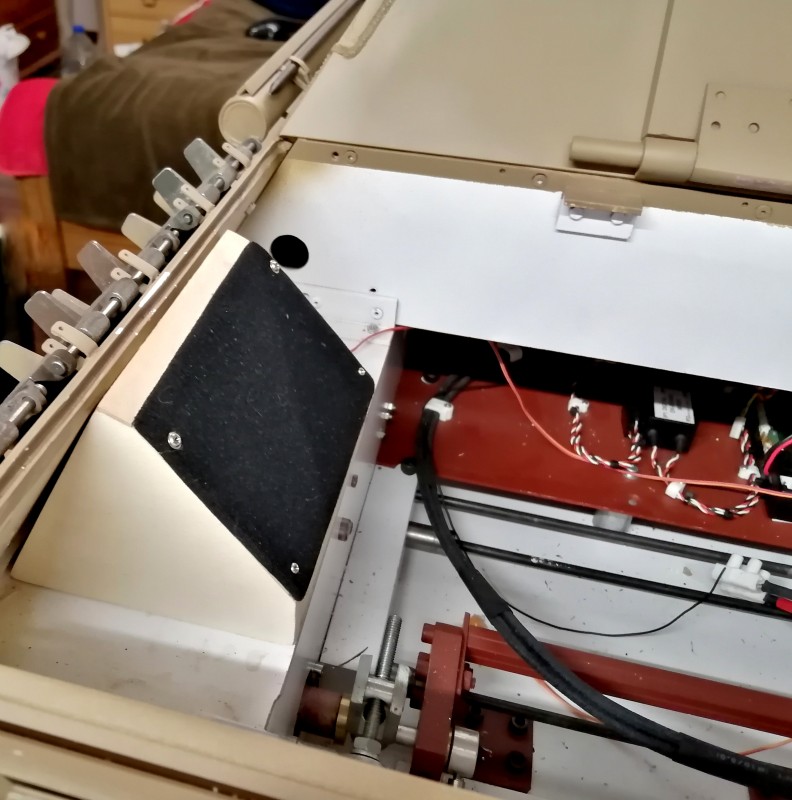

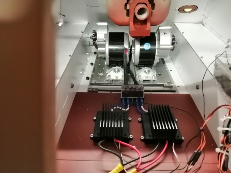

View through the loading hatch

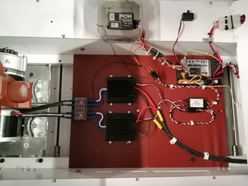

Twin speed controllers and a mixer unit is all that's  needed - the Tamiya DMD unit supplies sound only and  servo output for gun recoil
Simple 8mm ply boxes with vent holes and acoustic foam packing inside

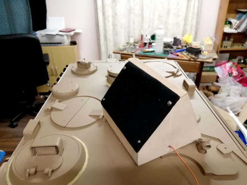

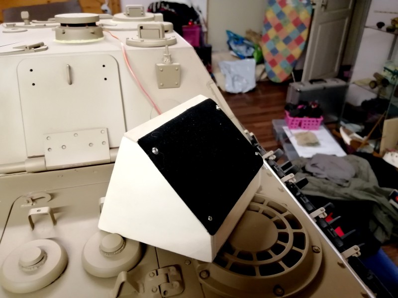

Speaker boxes direct sound up and through the cooling fan vents
