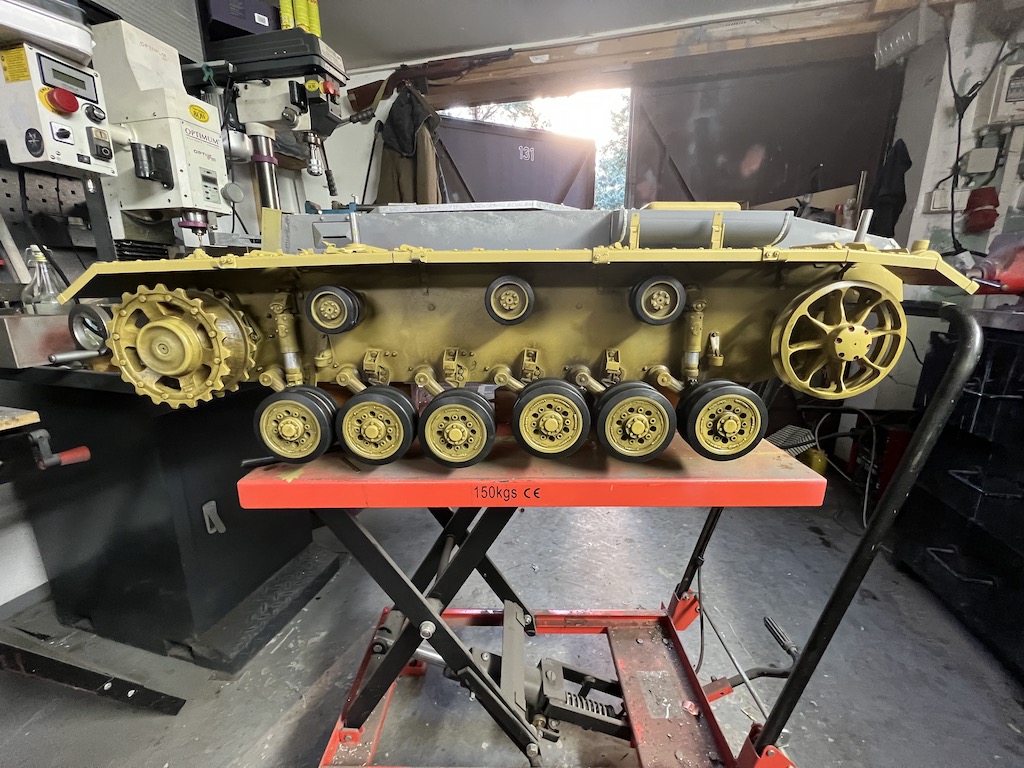

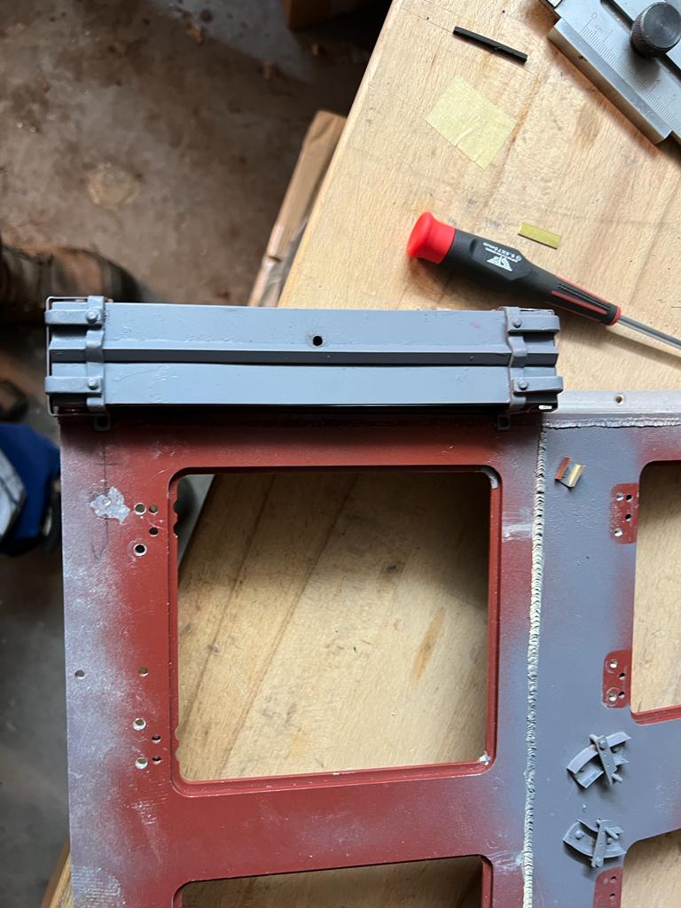

Front view

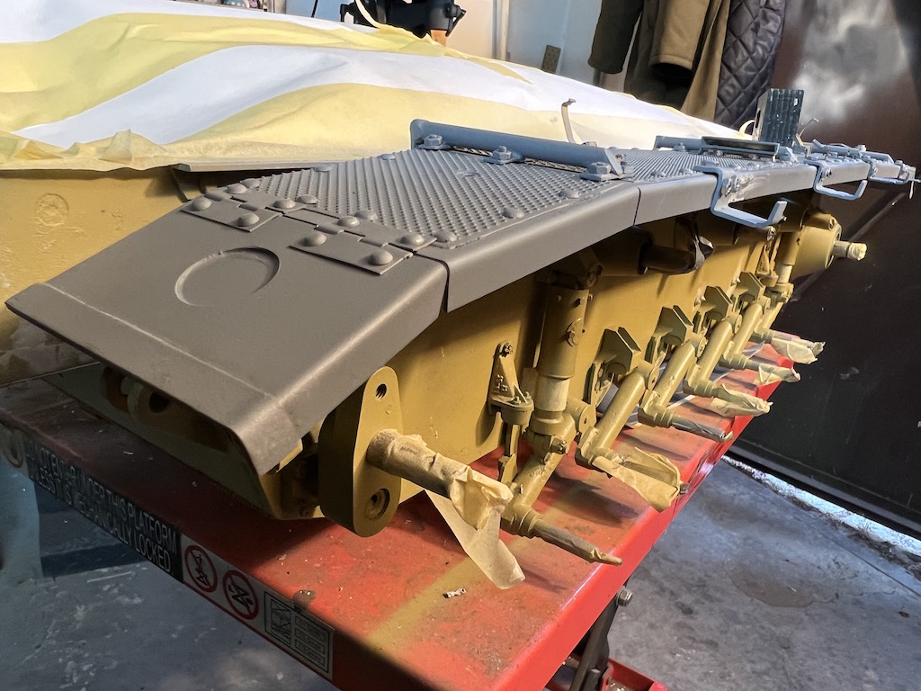

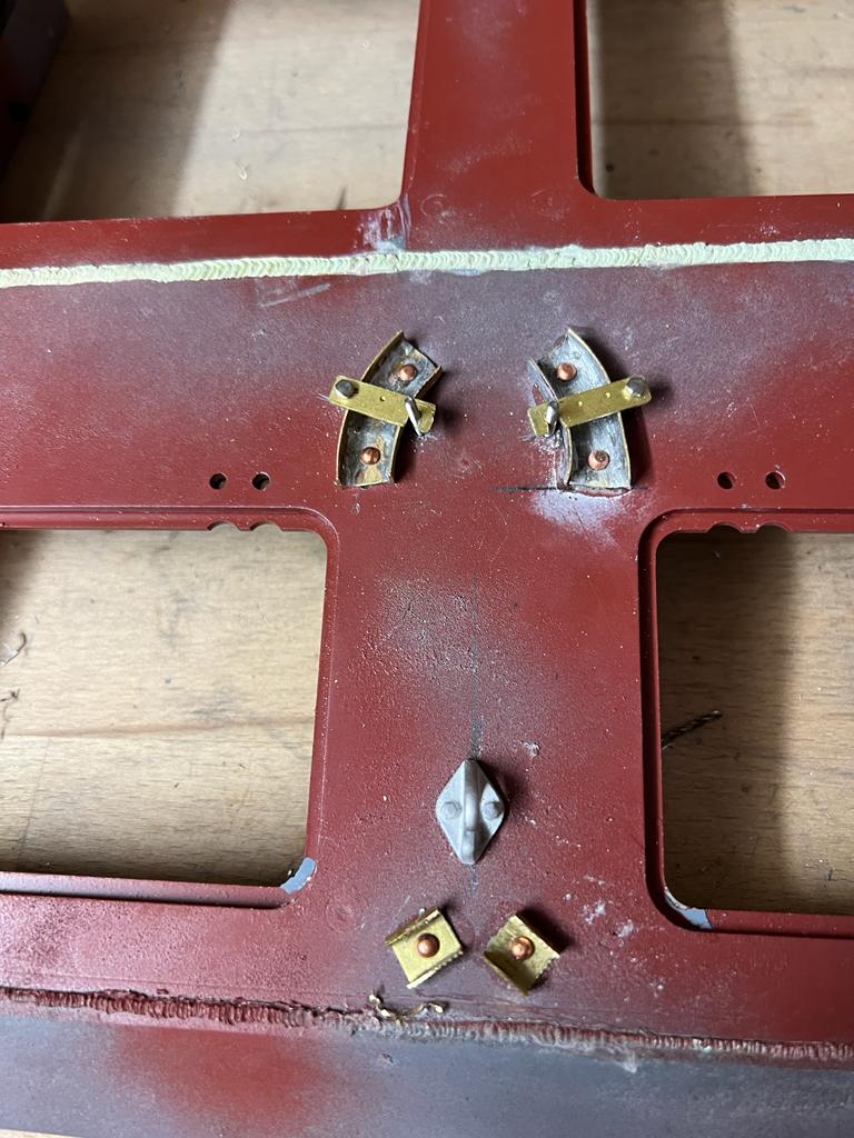

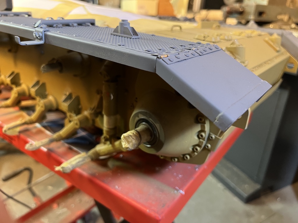

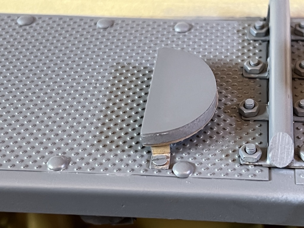

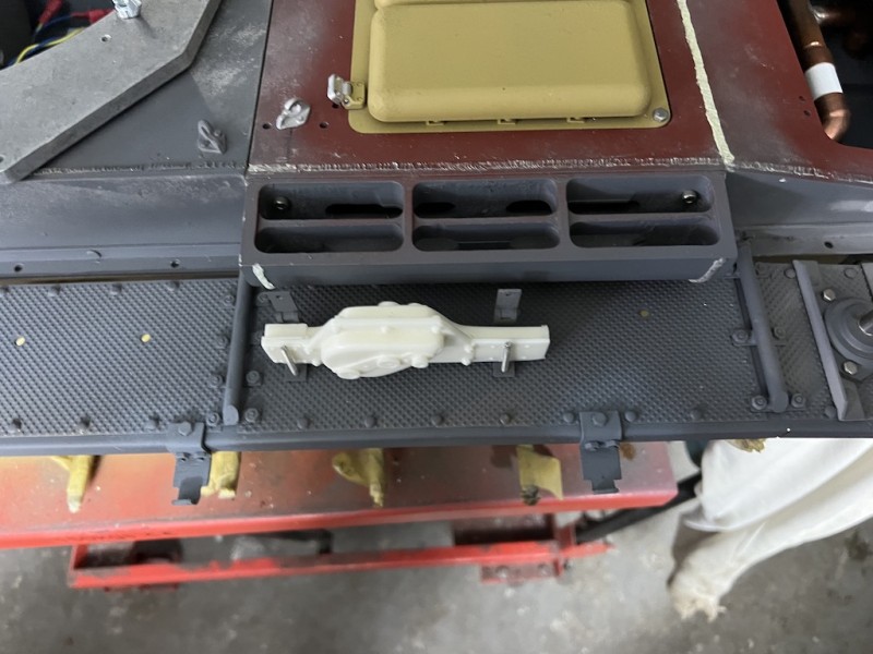

result my work on fender details
/Users/lubomirtoman/Desktop/IMG_20190804_2025391.jpeg

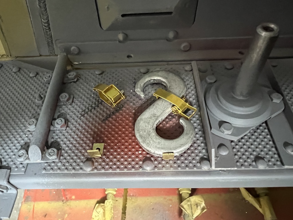

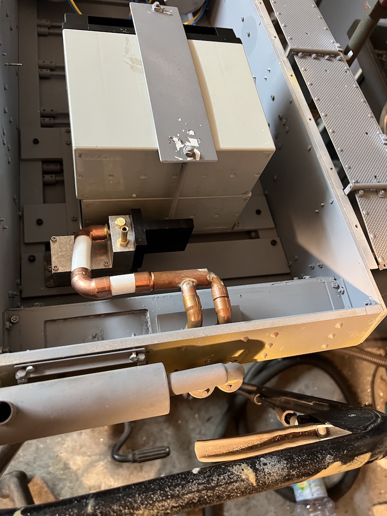

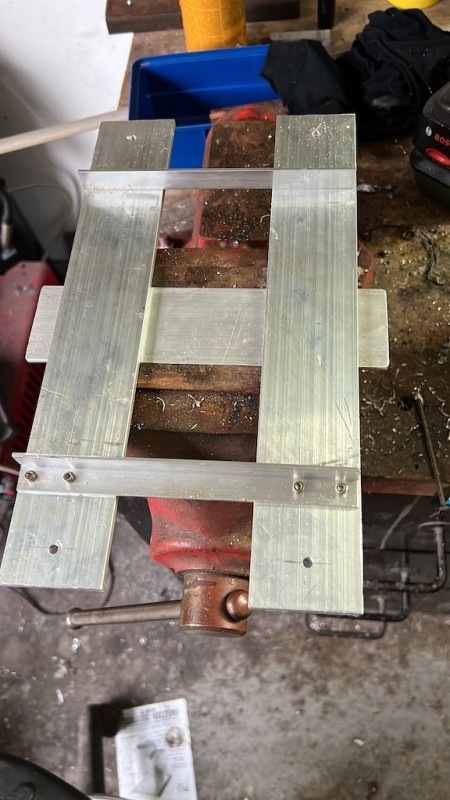

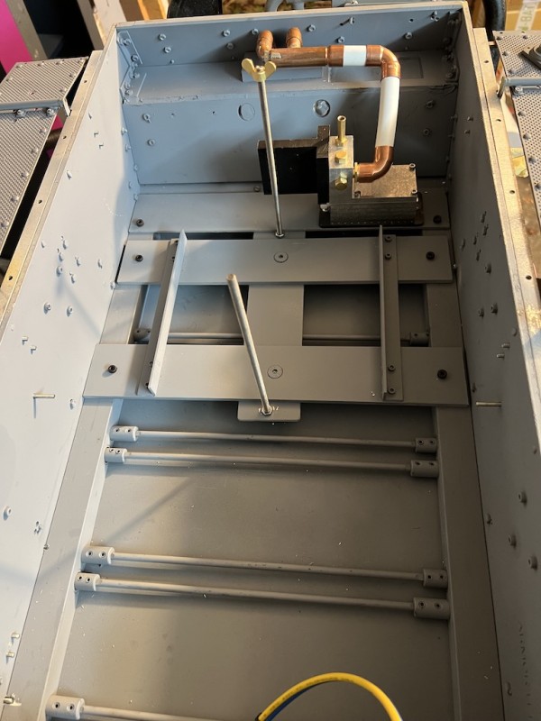

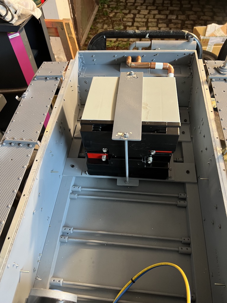

I also made a battery compartment. Fitting smoke options, pipe for exhaust and installing sound speaker.

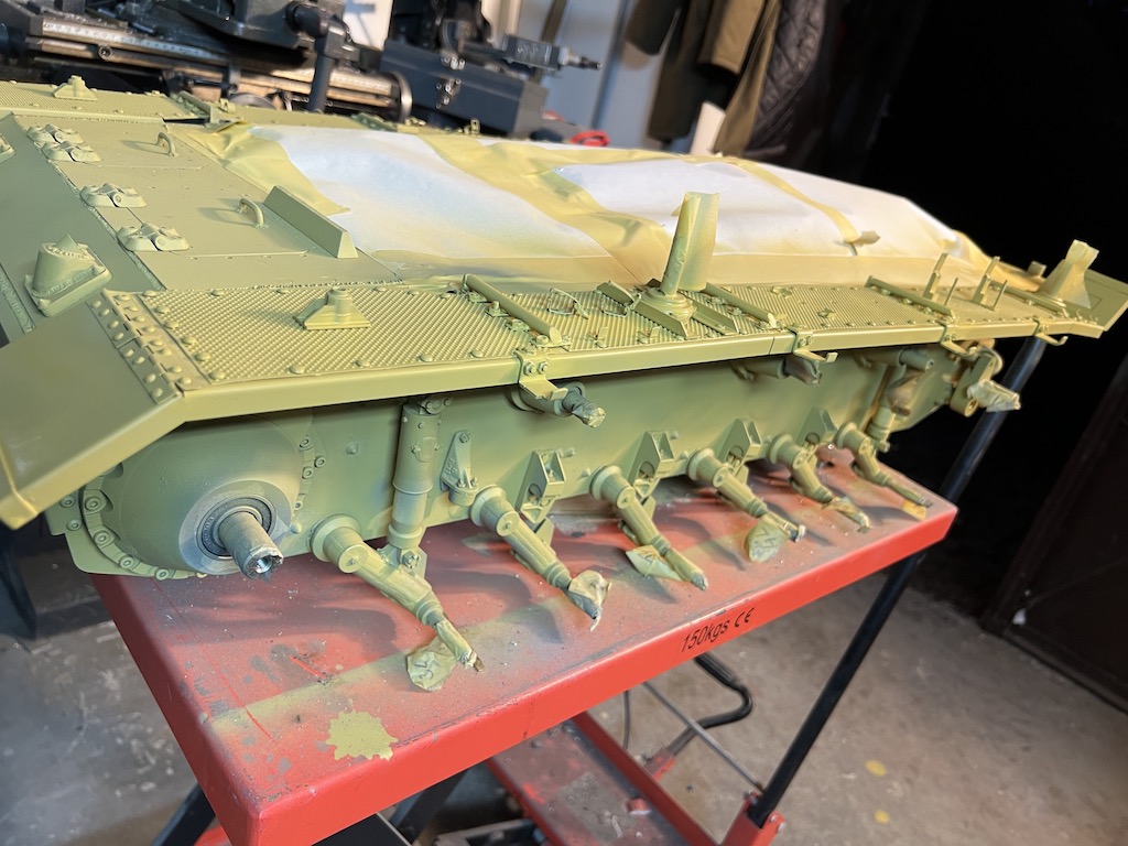

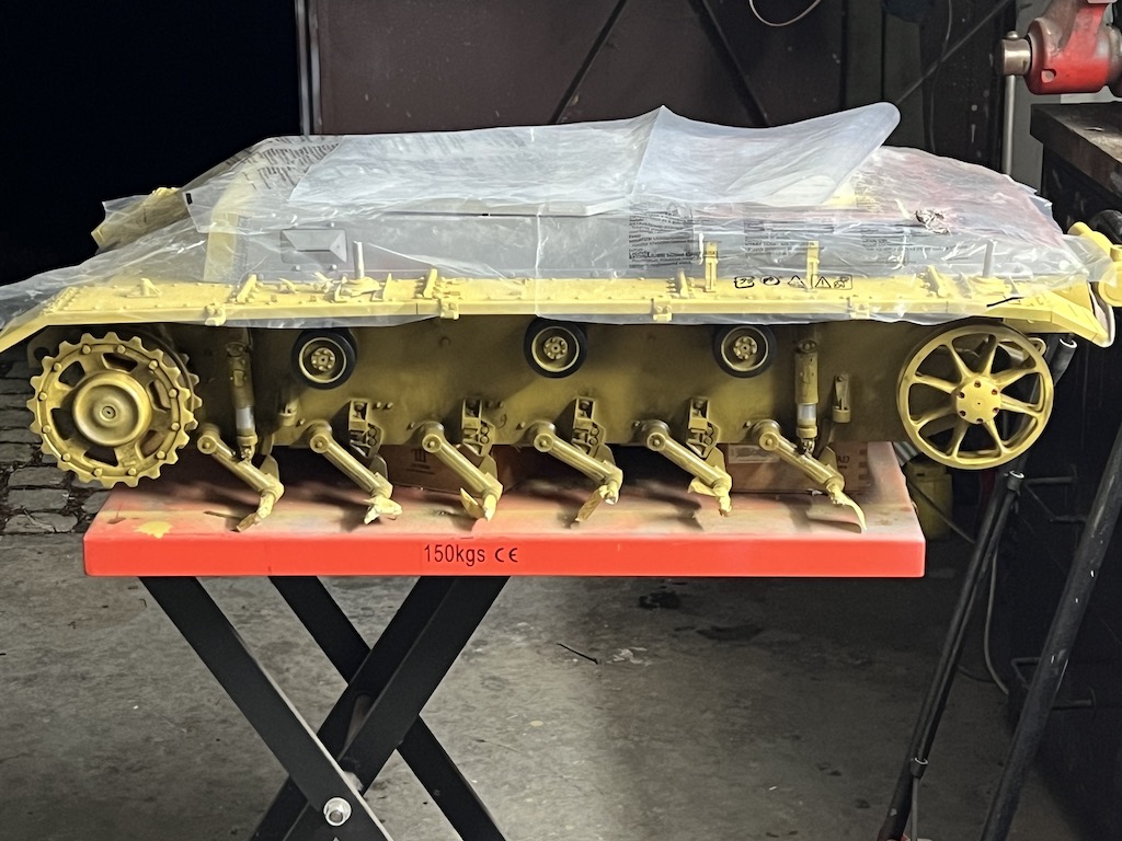

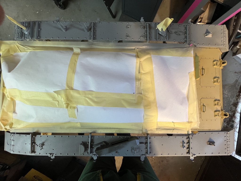

I make the first spray paint

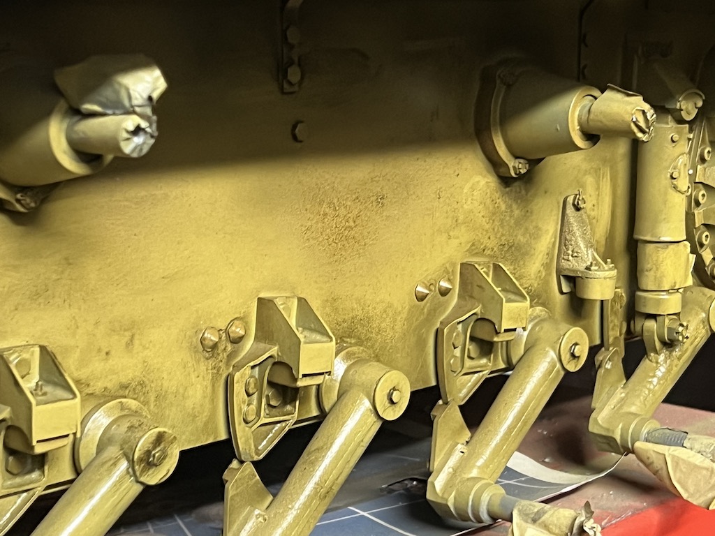

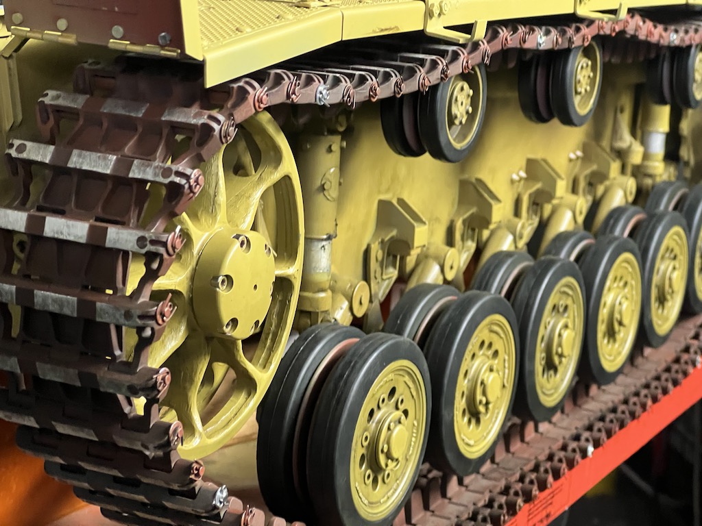

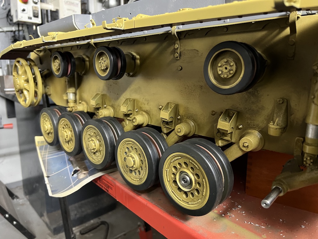

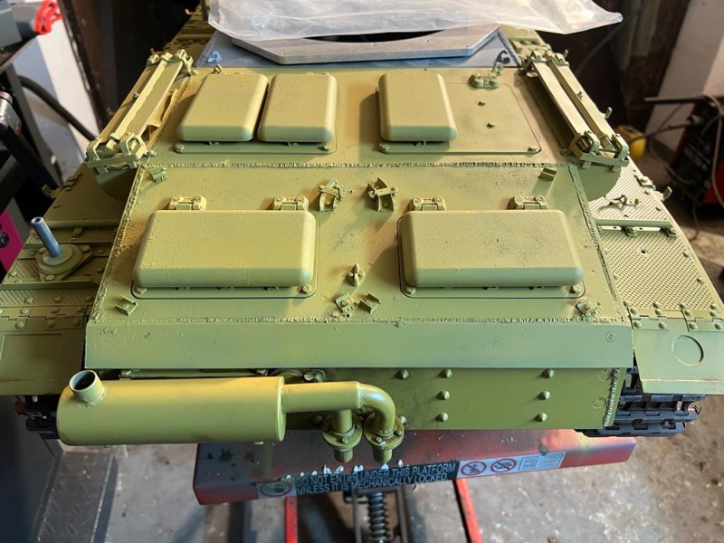

imitation patina on the tank chassis: in the first step I applied gloss varnish, in the second step I made a patina and finally I locked it with matt varnish.

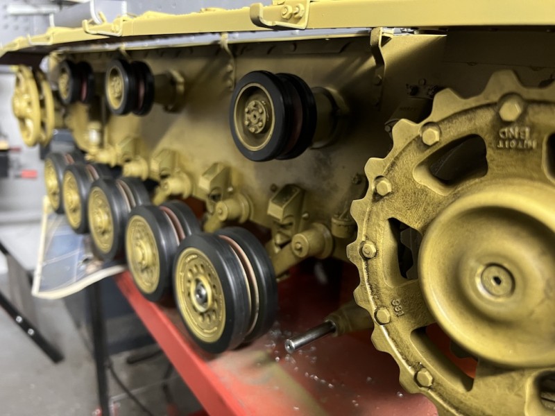

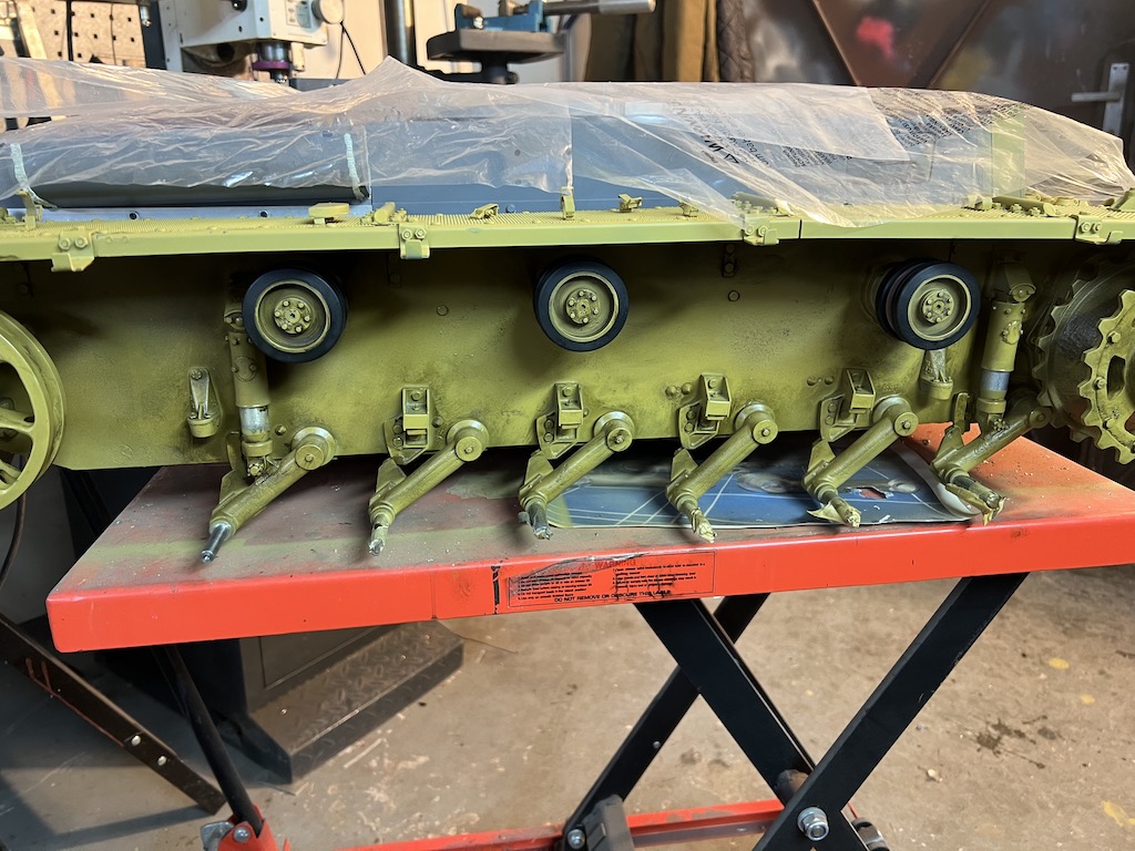

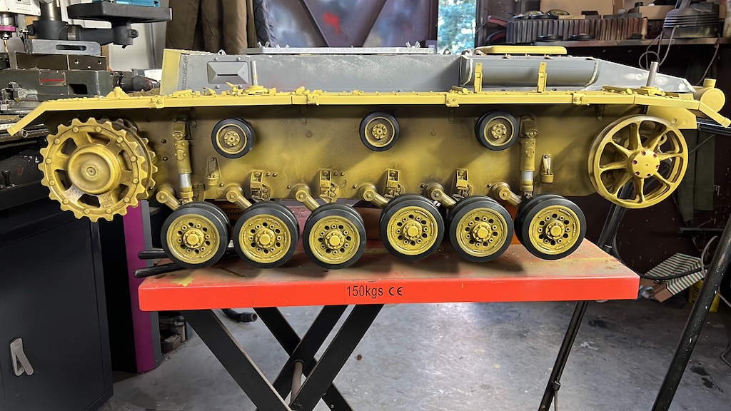

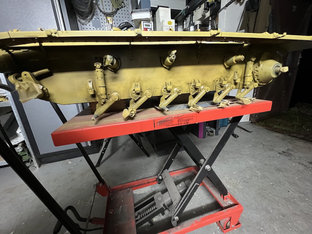

I proceeded to install wheels, wheels are also fitted with patina paint

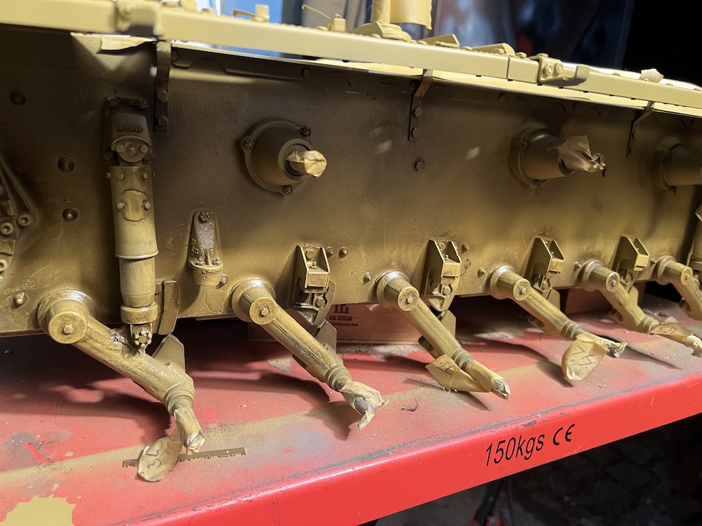

next wheel picture

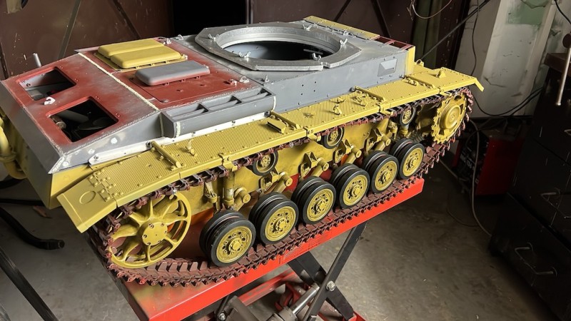

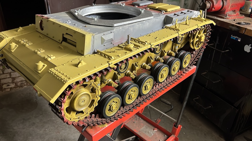

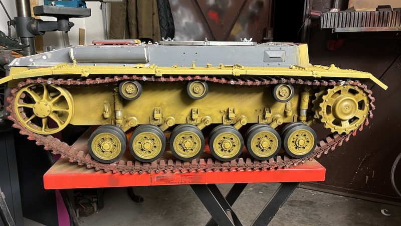

and for a complete assembly with belts. Michael, your shoulders and bump stops look great.

Re: My Pz.Kpfw.III Ausf.M mit Schürzen / Kursk Battle
Post by Michal Matata »
Hi Lubos,
Super work, nice details... it looks perfectly with weathering
BR
Michal
Posts: 2331
Has liked: 137 times
Been liked: 803 times
Very nice details - Michal's parts are top drawer.

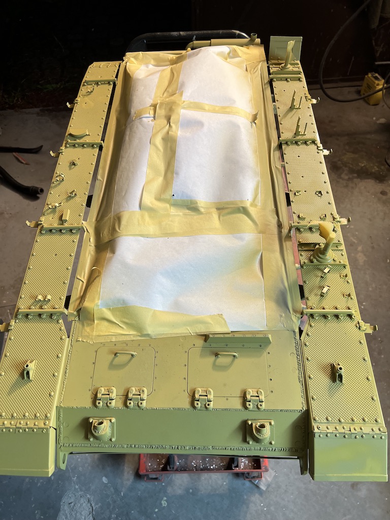

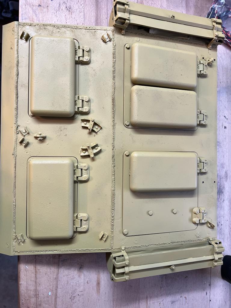

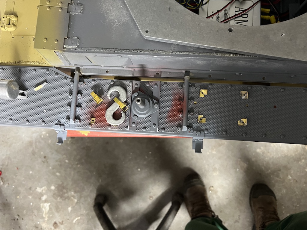

hello, i continue to work on details of the rear my panzer
