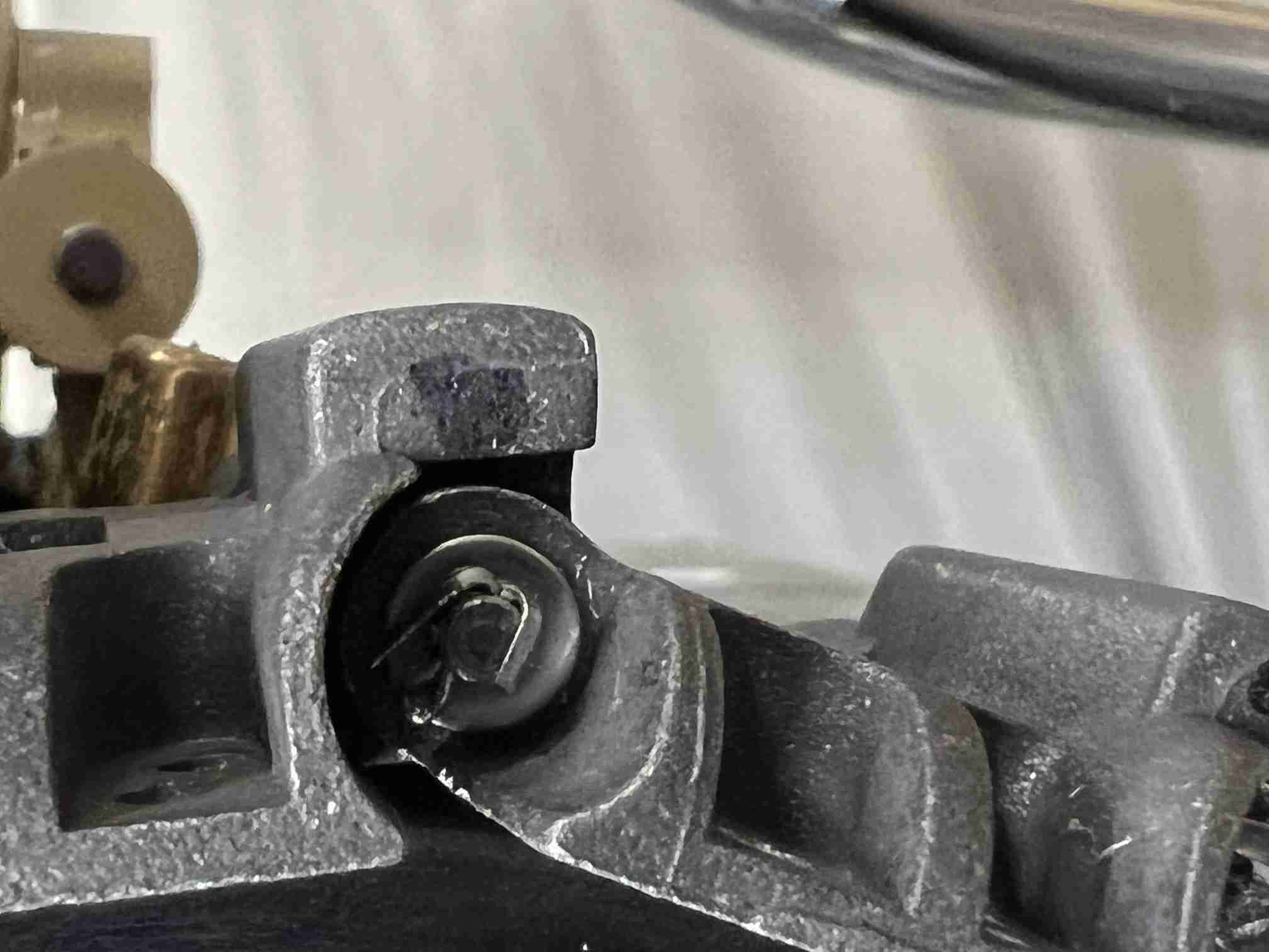

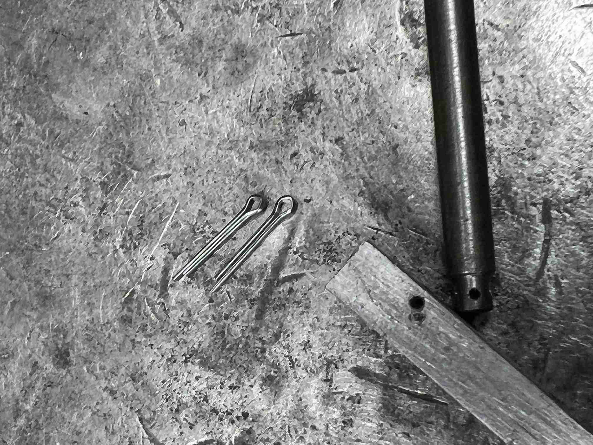

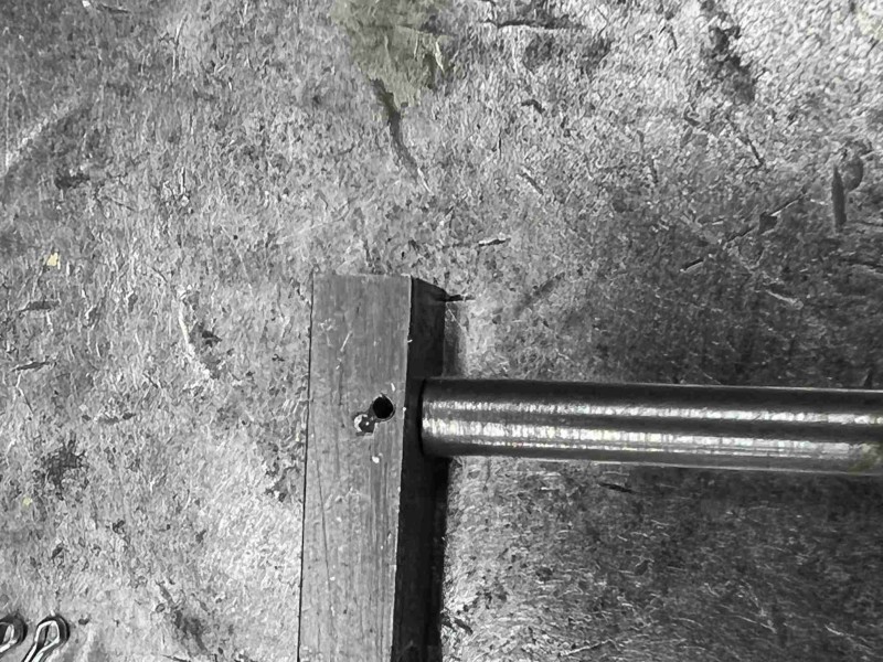

I implemented what I was referring to with regards to a master pin.
I made a simple drilling fixture to ensure all the holes made were in the same position.
Used a tiny cotter pin and washer to retain the track pin.
Should work ok.
Should work ok.

Re: Master track pin, anyone?
I had to make my own track pins too, and I used a track link to fix it for drilling the hole for the cotter. I also used a further chuck to clamp the drill nearly at its peak to avoid bending:
