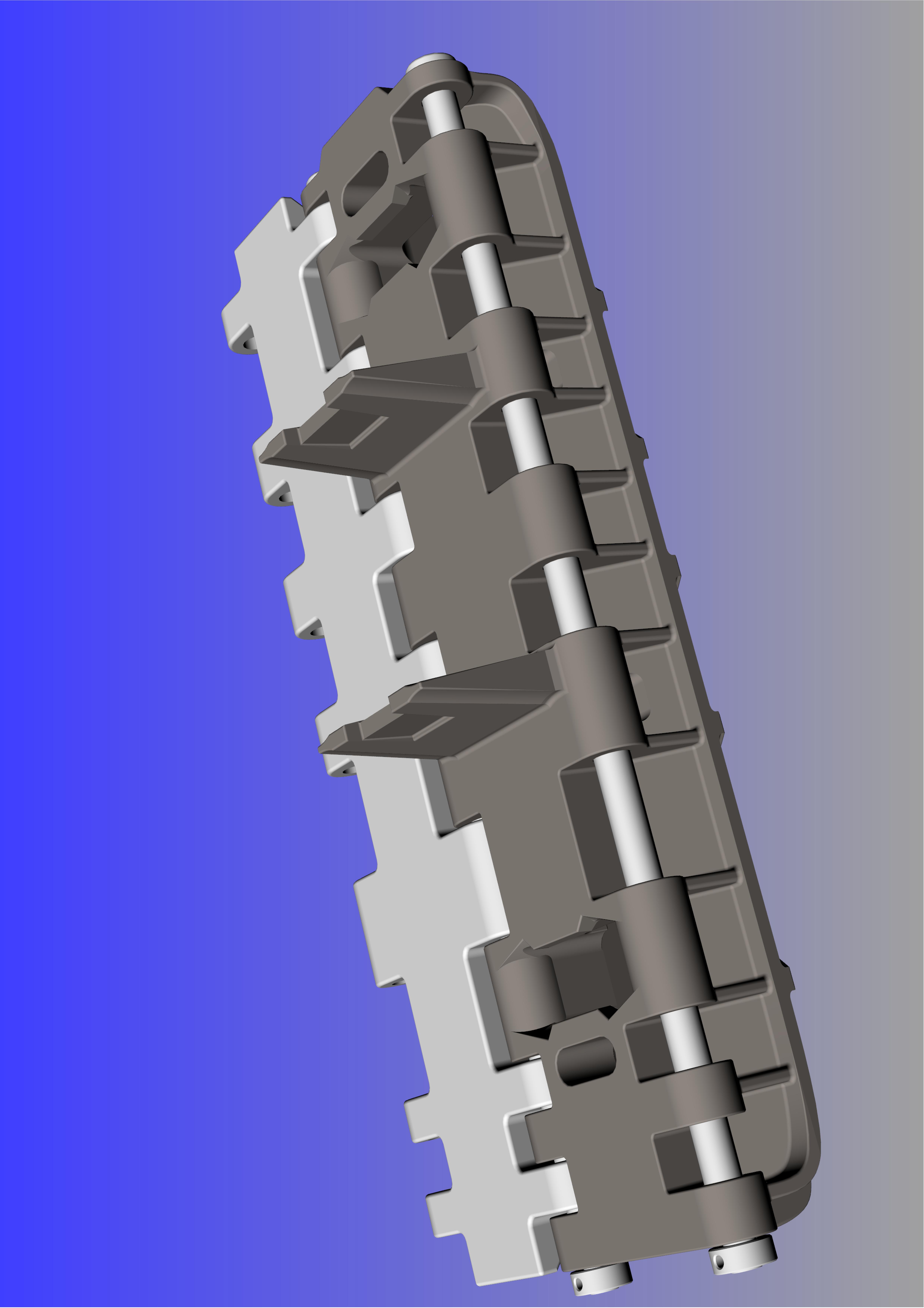

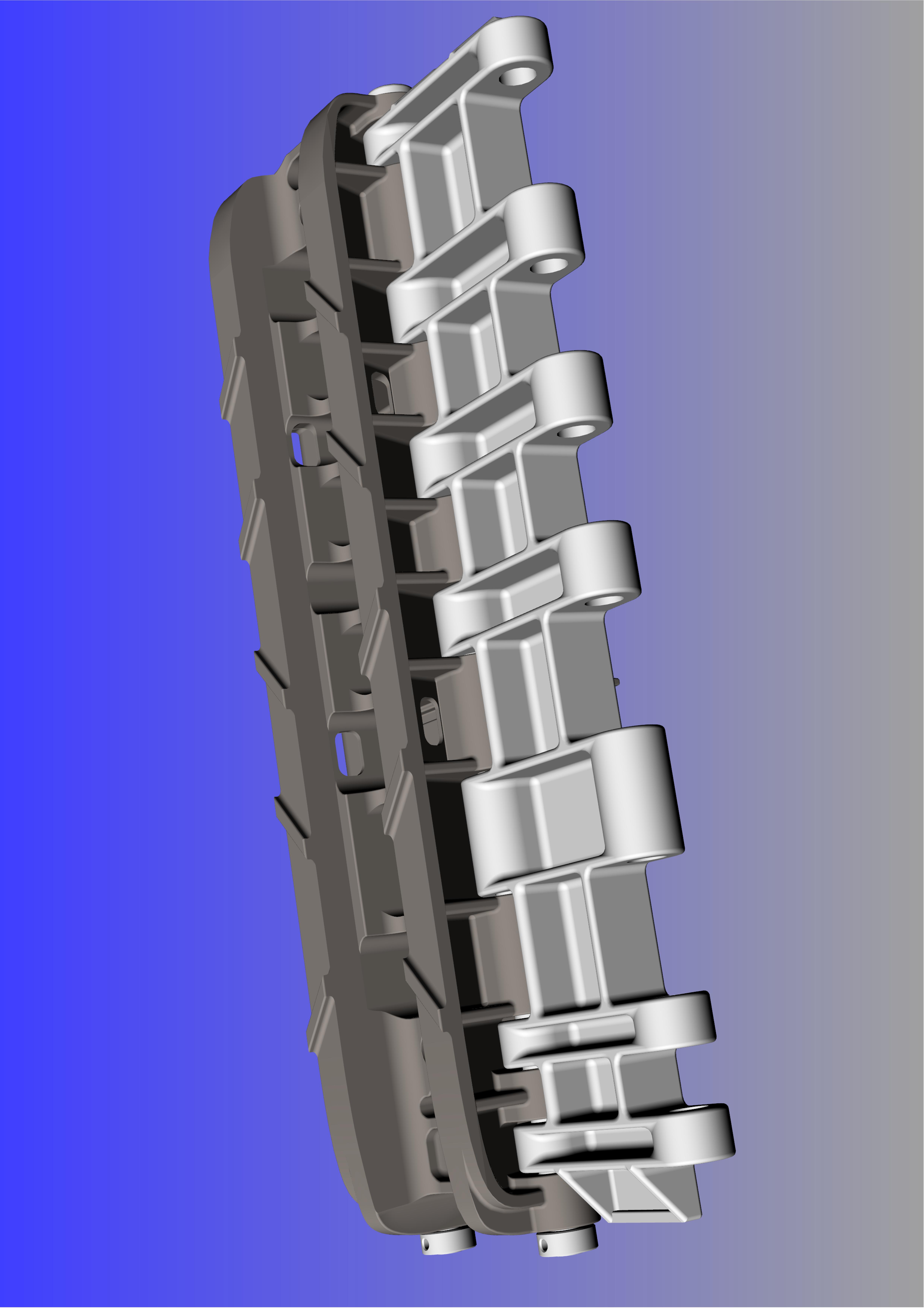

A quick up date on the steel links for the King Tiger and Jagdtiger, after much back and forth and many changes to the CAD, thanks to Christoffer, I have finally ordered the links from a local casting company.
They will produce dies and the first 10 pair for testing and accuracy confirmation, this will take 6-8 weeks, once they are checked and if they pass it would be another 4-6 weeks for the first set.
Once I have the first set I will test them on my tank for a minimum of 15 hours running and if all goes well the remaining 6 sets will be made.
If everything runs to plan I should be able to ship before Christmas…
At this point all 6 sets are sold if anyone else is interested I may be able to increase the initial order.

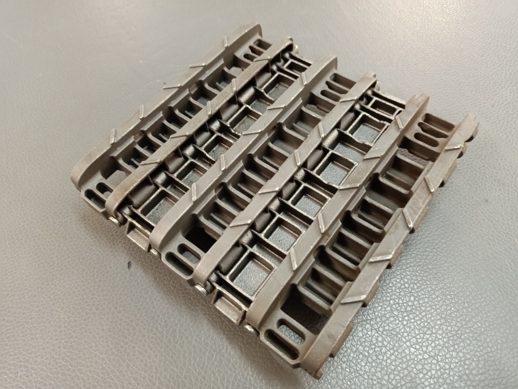

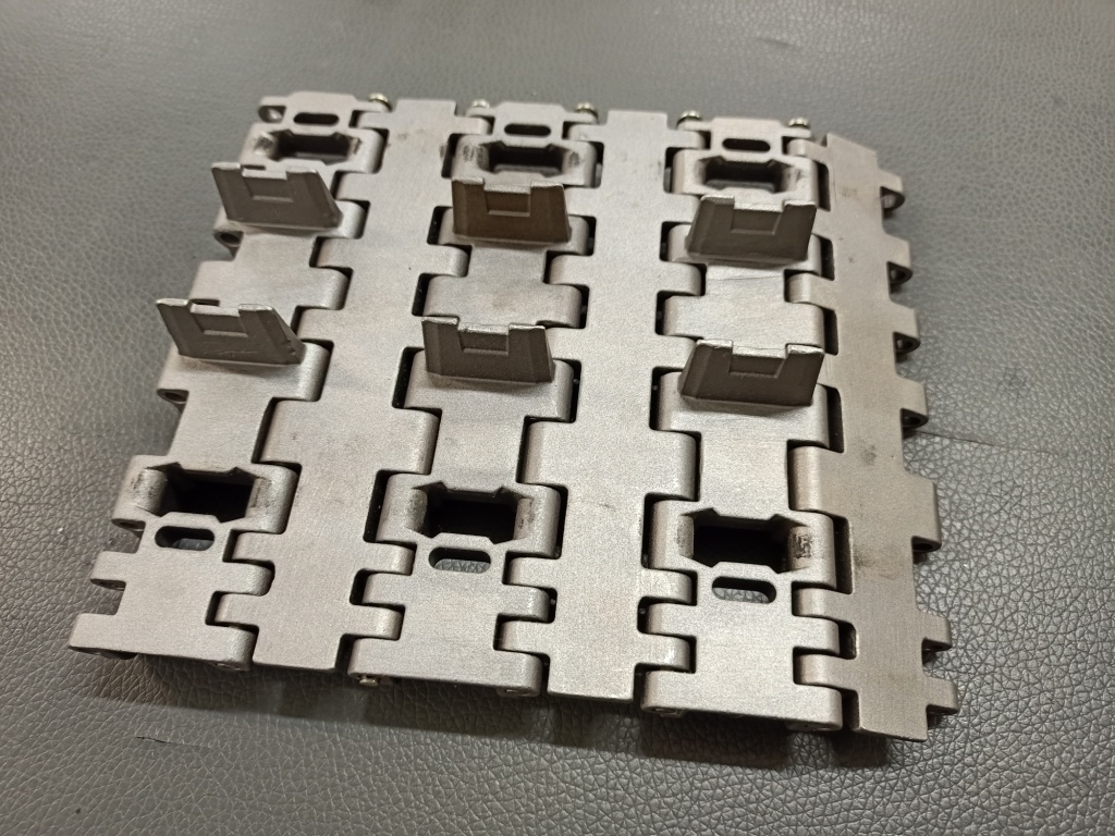

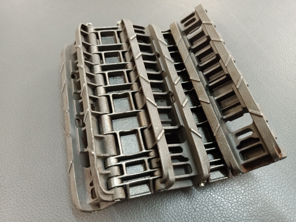

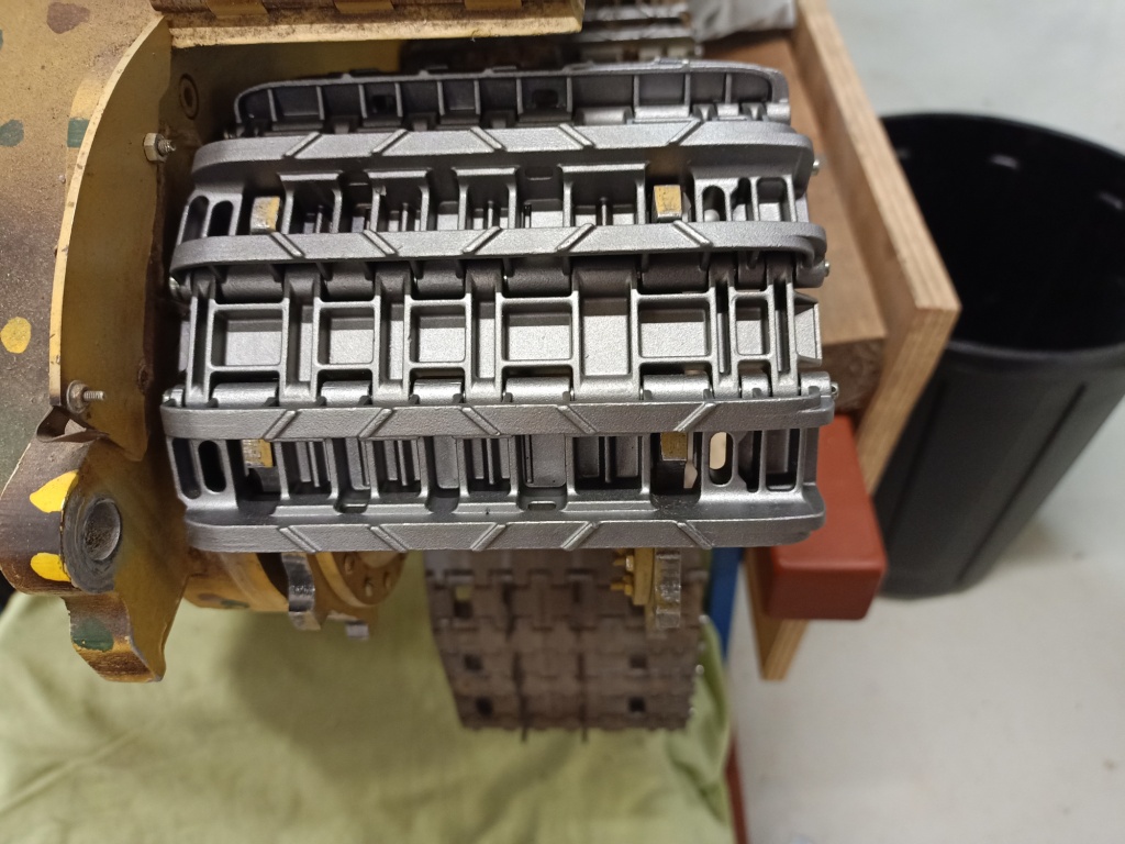

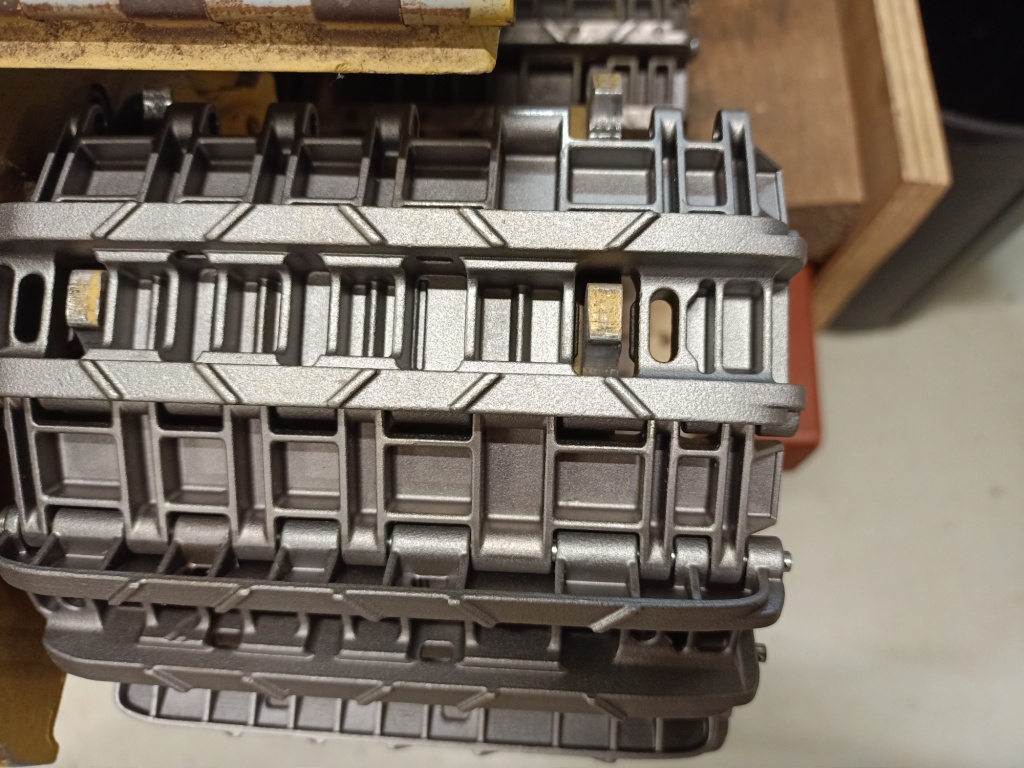

Well after what can only be described as a major headache I finally have the prototype/sample King Tiger track links. There are still a few issues to sort out but overall are quite nice, and these 2, 1/2 link set weigh in at 793grams very nice.
You can see the cold runs on the B link this is due to the very small section of the webs. I was trying to be as close to scale as possible and have paid the penalty, so these will be thickened by 0.1mm each side at the top and 0.2mm at the bottom to help with the metal flow. Once this is done and the inspection passes I will order the first 2 test run sets which I will run for 20 hours to be sure that there are no issues. So all going well (which is almost impossible these days) I should be able to order production sets late May early June with a 6-8 week delivery?
I am hoping to keep the price the same but it seems that everything is costing so much more, the covid tax is constantly increasing. One issue that has arisen is that the links have ended up 0.5mm longer than designed and the standard pins are now just short. Therefore I will have to supply pins and locking bushes to suit, the A link can be filed and the standard pin fit but that would be up to the customer if they do want to use the standard pins and bushes.
I have enquires for 8 sets anyone interested please PM me.

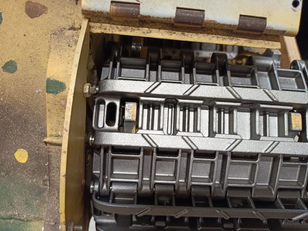

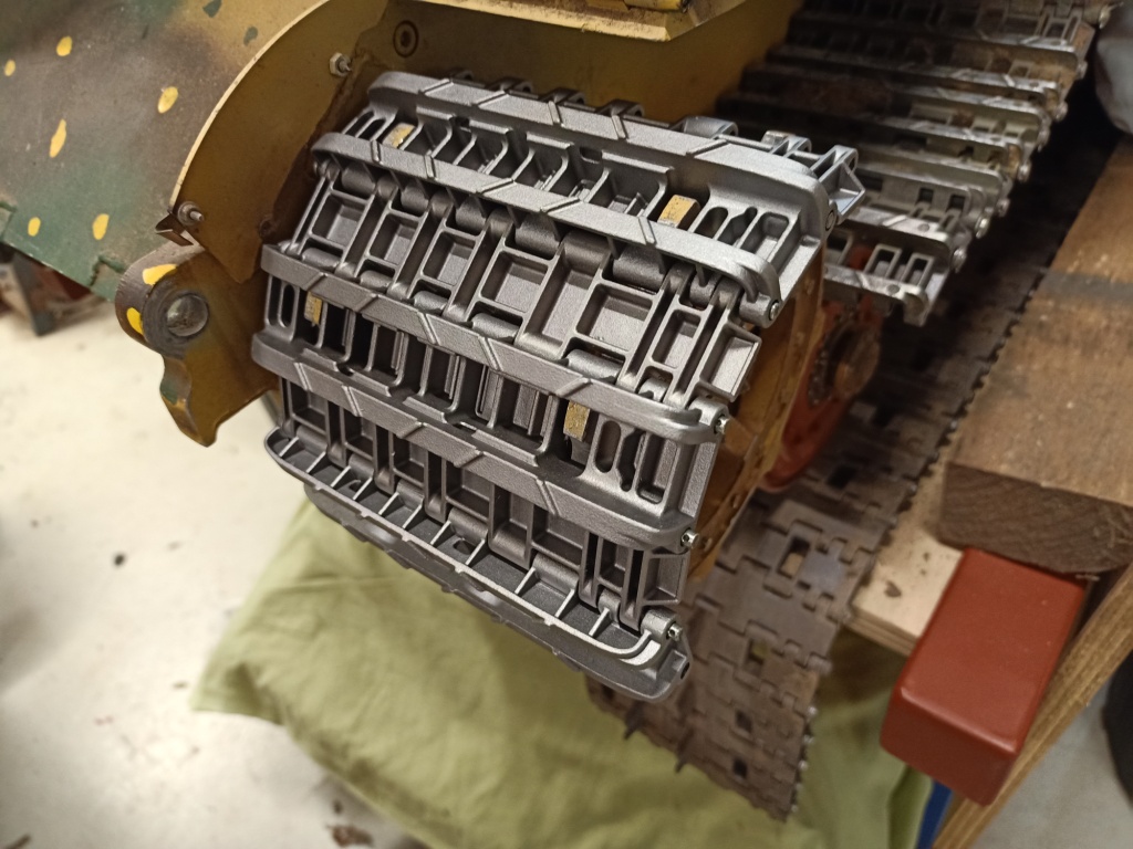

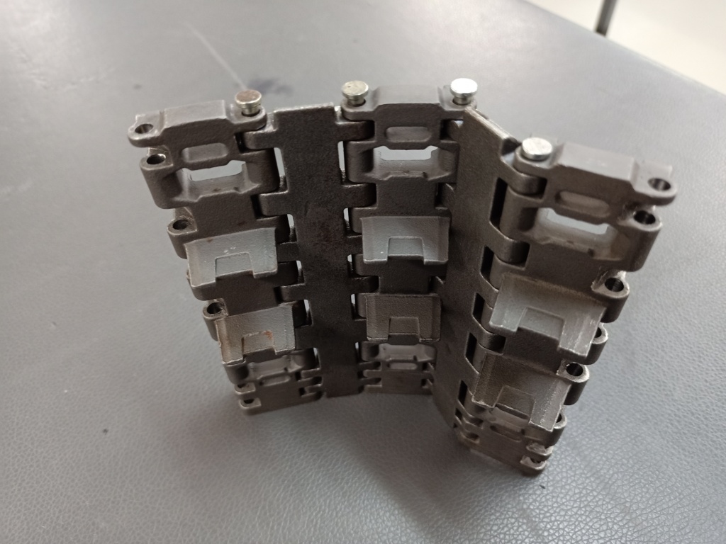

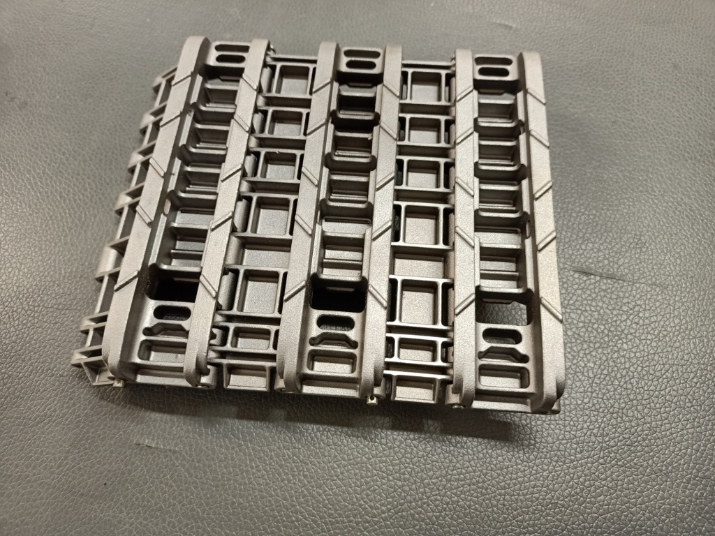

It appears that I may be having a win... the new casting company has supplied the first of the samples for inspection prior to production, and they are very impressive if anything a little too shinny but that will soon change once they see the dirt. I have approved production and will have the first complete set for drive testing in 5-6 weeks, once tested I will place an order for 8 sets.
If a get firm commitment for the 8 sets I can keep the price as listed above, with the same option for the pins, AU$2,275 links and AU$655 pins, collars and locking pins (total AU$2930) plus freight and fees. The new castings are also slightly longer so the standard pin will not fit without lightly filing the flat side of the A link.
Could all those that expressed an interest (yes back in the before time) please confirm they still would like to order.
As I am now getting more links cast I will start a dedicate page on steel track links.
