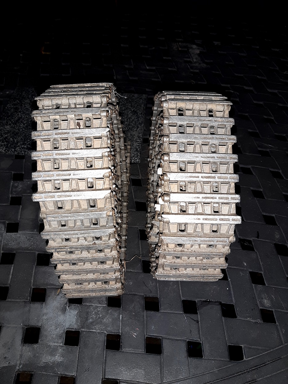

A question for those who run their Comets regularly.
What's the track wear like ?
Looks like mine needs some work on the toe-in...
The wear is so bad that the inner ends have broken off most of the track links.
I'm assuming this means the wheels are splayed out, so all the weight is on the inside of the track links.
I'll get it out of the workshop and spin it over to check the angles of the axles.
I know both sprockets are rubbing badly and there's something funky going on with the idler.

I've never seen the ends break off like that before, the material is getting very thin I suppose and it just fractures. You need new tracks Adrian.
The comet is one of the best runners and lots of hard surface use at shows is going to wear them out.
I've seen this type of wear on well used full size Tiger 1 and many of my own Tigers, the mechanics of heavy engineering. You will need to replace the road wheel axle bushes, the wheel bearings and that idler issue needs addressing to in a similar way , or just replace the tracks and carry on!

Very similar to the 1/1 Vimoutier Tiger track wear

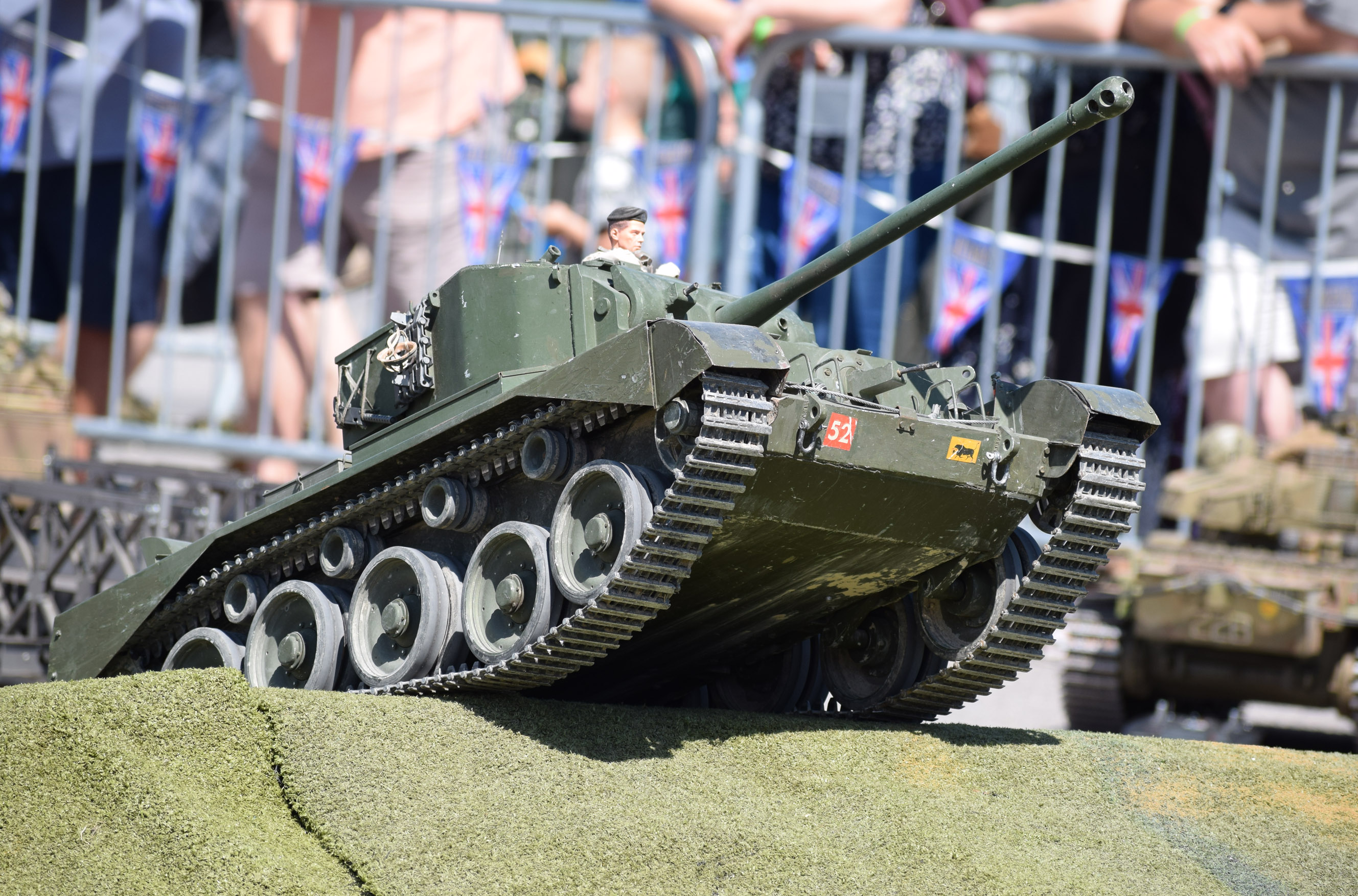

Interesting that this Comet (Dennis Jones ?) from TankFest 2019 has exactly the same track wear pattern as mine.

Hi adrian
The tracks on my comet are starting to look the same.
I'll try to switch the left to right and right to left, so they wear off the other side two.

even if not running regularly i have not that kind of wear, but checking the wheels, i found some of the screws holding the suspension arm on chassis to be loosened, and kept in place by the cover on outer hull.
inner nut (big one) was wandering in the chassis
this allow the suspension arm as well as the roadwheel to rotate a bit left to right
