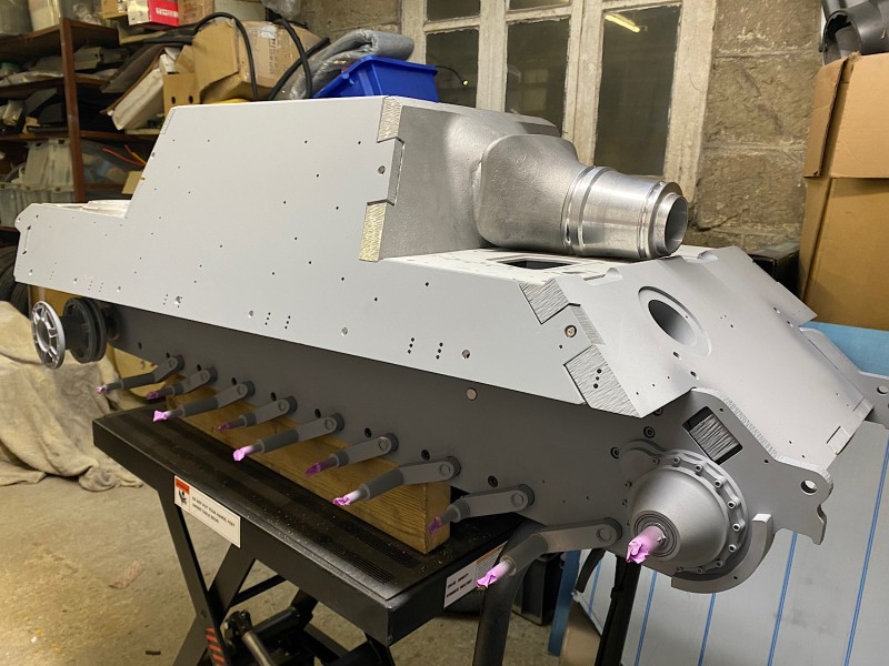

Jagdtiger upper hull
Think I’ve worked it out now.

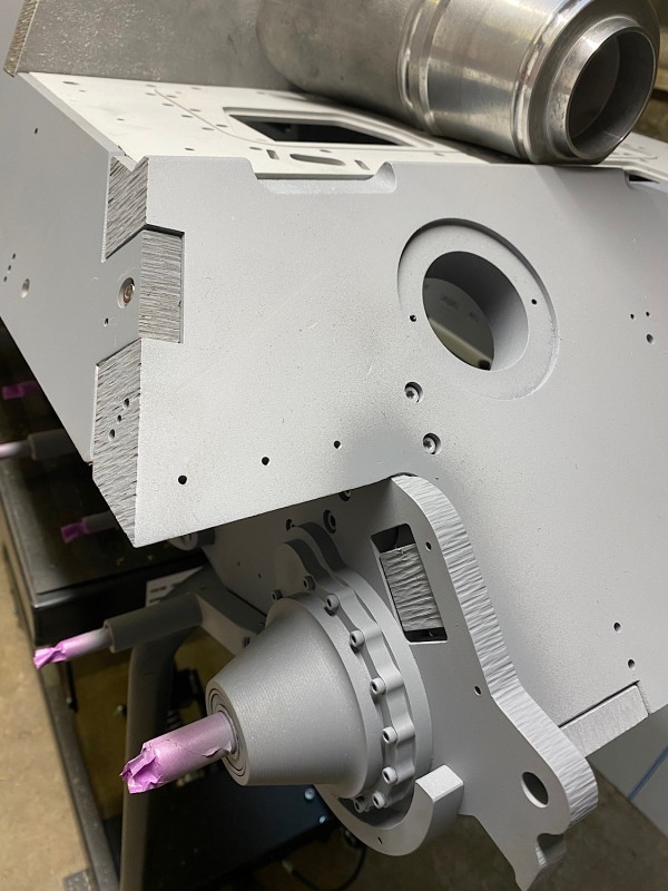

Some progress pics, all suspension is in and set, lower hull almost complete.
First attempt at weld seams but my milliput was hard so didn’t go so great, will get more and try again.
Lots of work on the gun and pigs head today, I’ll update with pictures of what I’ve done to achieve good gun movement as it was very limited especially when elevated.
I’m really happy so far.

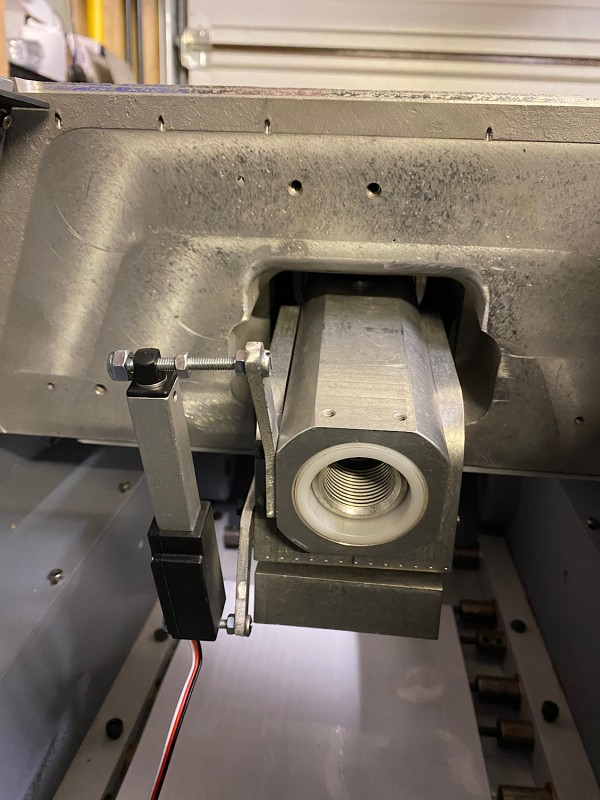

Mock-up of gun elevation and depression. I’m now have the full 4 degree depression (yes I know the original has 5 but the model gun will crash into the front plate if I do that)and 15 degree elevation using the full 50mm travel of the linear servo. It’s nice and slow and really powerful, 200nm.
Remember it’s just the mock-up to show principle of operation stronger and nicer brackets will be made next.
Slew next on the list then recoil alterations.
The mechanism
The mechanism

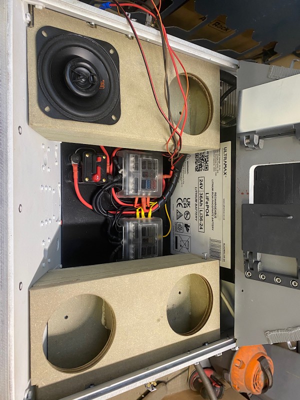

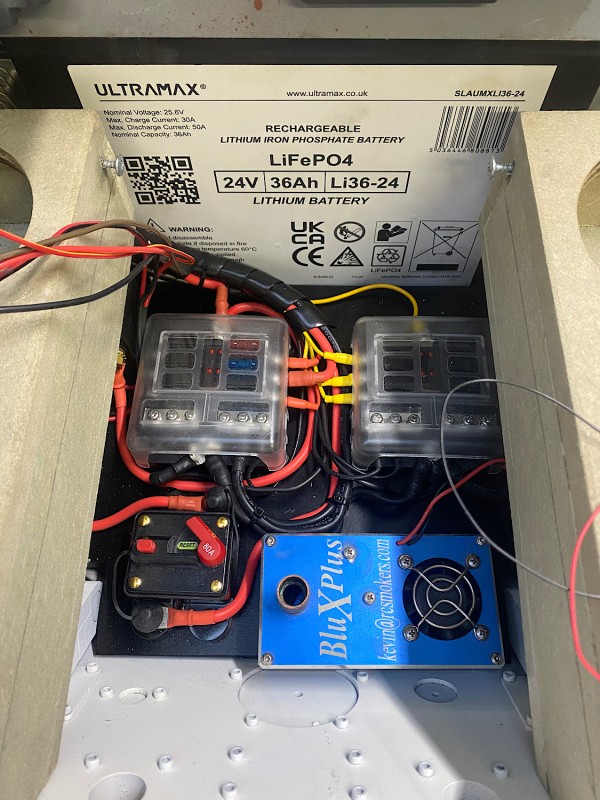

Lots of progress on the wiring, in the rear lower section I have the main power distribution with circuit breaker, relay and fuse boxes, the left is for 24v and the right is 12v from a 24v to 12v converter.
Power distribution
Power distribution
Speaker boxes then fill the sides, each holding 2x4” speakers.

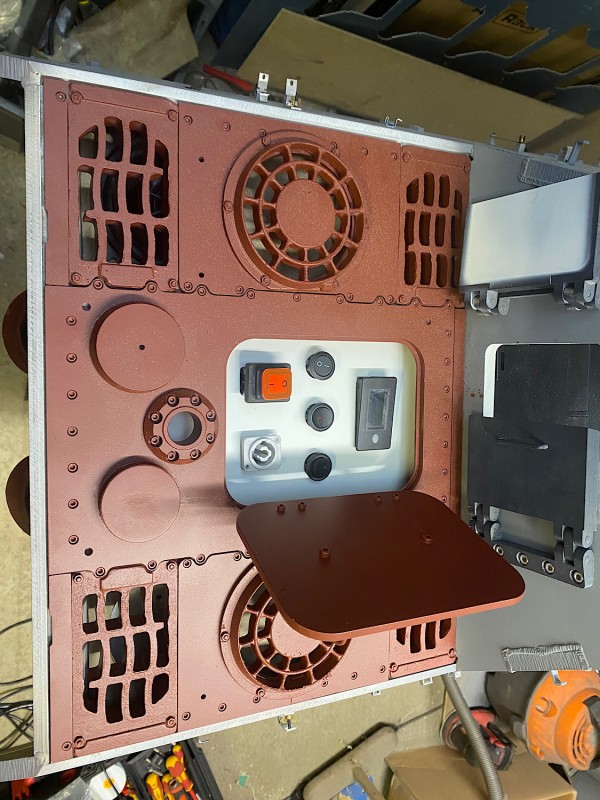

In between will be the main switch panel that hinges to reveal the fuses and smoker etc
Switch panel
Switch panel
All accessible through the rear hatch for everyday use.
Rear panel in place
Rear panel in place
