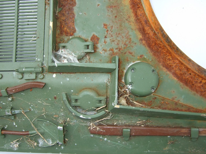

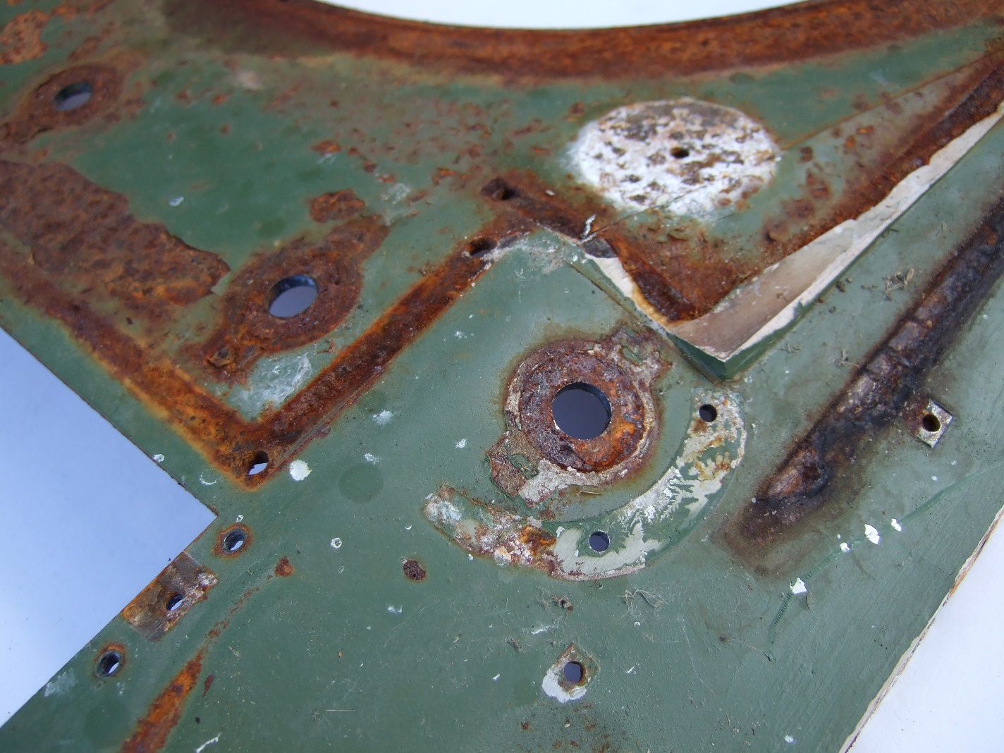

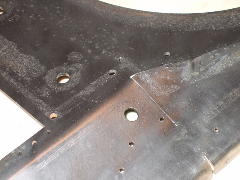

This is an extreme example as the inside of the tank was not primed or painted, and was then left outside for several months.
I always prime where disparate metals will be in contact, as moisture will always wick in between any gaps it can find.
These pics show what happened to the outside, which was not primed but was painted.
You can clearly see where the water has sat between the two metals.

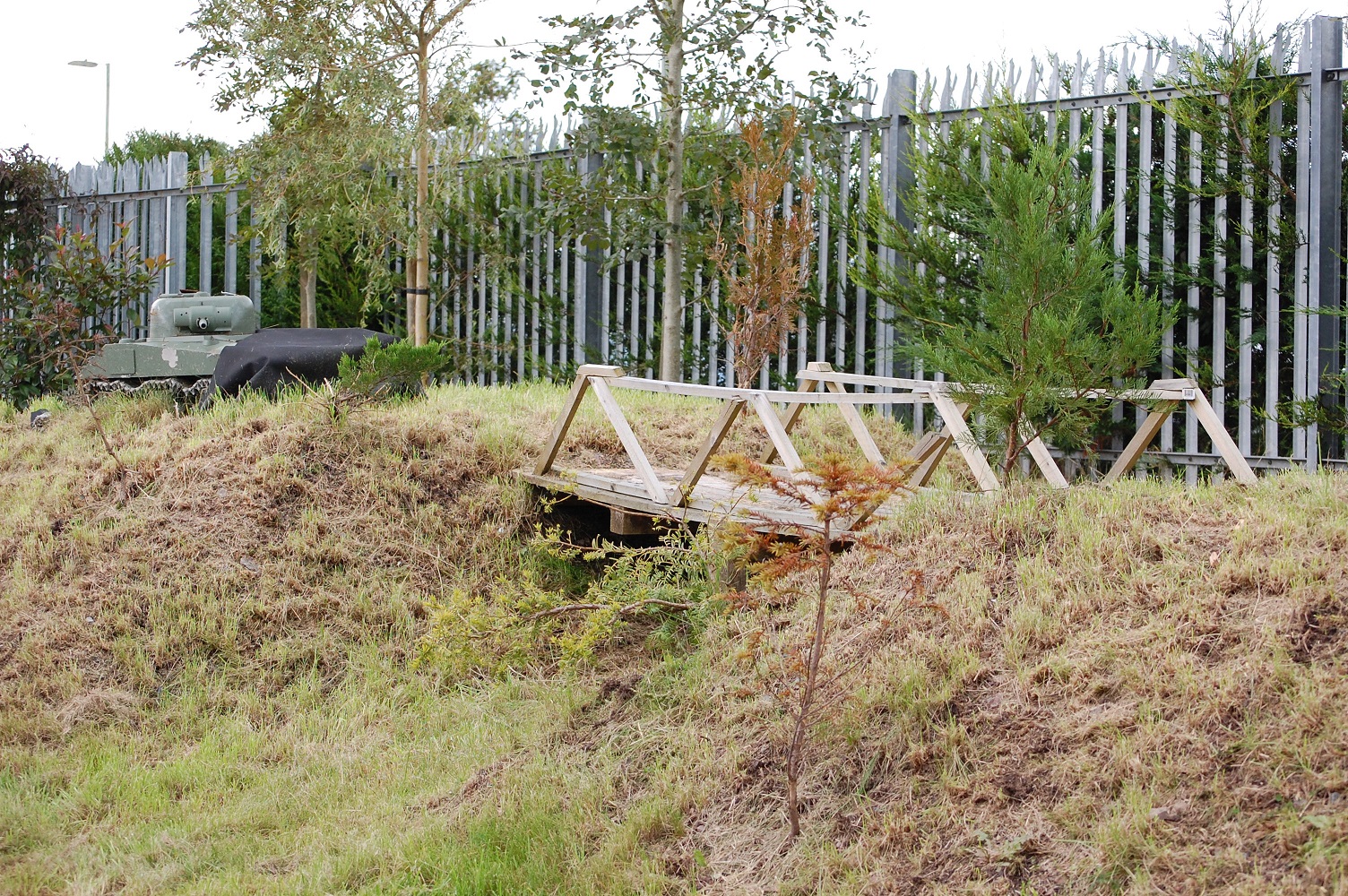

> Good grief - is it normal to leave them outside in the rain?
It was the original Sherman prototype. The previous owners of Armortek put it on their proving ground outside the Dunkeswell factory as a range wreck.
To my knowledge it spent at least nine months sitting there, probably longer.
Hopefully this year I'll get it running again.
