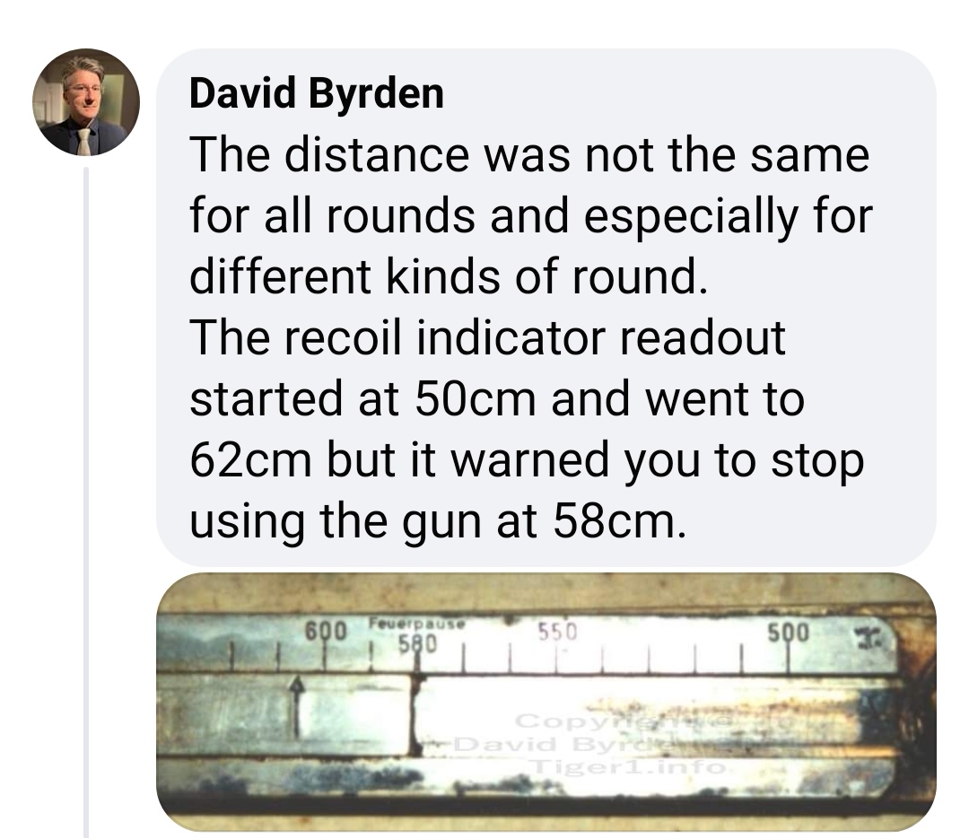

Anyone have a number on how far the gun would recoil on a Tiger 1?
Need this info before ordering parts for my recoil design😉

When I was working on the recoil system in 2011, I had the travel distance as 93mm in 1/6th, but I have idea now of where that came from.

To answer my own question, I got this from David Byrden. Posted with his consent.
