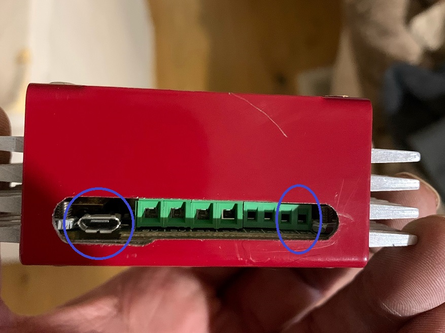

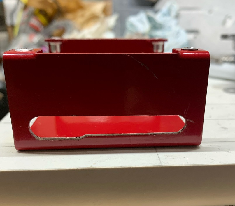

Unit A was opened an all the wiring was removed from the terminals (this facilitates removal of the controller from the bottom of the case) followed by undoing and removing the nuts and bolts holding the controller to the bottom of the case. The controller can then be slid sideways out of the casing. That's the warranty gone
The slot at the RC end was then elongated either end as shown below; anyone know the paint code
Unit A was then reassembled. Elongating the slot allows access to the USB port on the controller and the terminals P1 and P2 to which resistor networks will be connected to (one for each terminal) to allow the regen current to be dissipated as heat: The value of each resistor network is calculated using the lesser of the nominal motor current or 8A!
The USB port will allow access to the advanced Options menu via a software package. This allows us to set up things like battery type, voltage and current limits as to when the controller shuts down as well as enabling the voltage clamping on terminals P1 and P2. It also has a diagnostics tab where real-time data from the controller can be obtained and recorded. That only leaves one thing to do and that is to change the DIP switch Position 3 switch to on (Power Supply). Any regen current from the track motors should now be dissipated through the resistor networks on P1 and P2. Should more information come to light that makes regen more favourable, its a simple matter to reprogram and disconnect the resistor networks.
Unfortunately, unit B isn't as flexible and I don't think that the regen can be shut off. There is no USB port to connect too. That said, it is I believe most unlikely to exceed 1C so could be left as is or replaced with a controller that doesn't have regen. If its left, then DIP switch Position 3 will need to be set to Lithium.
