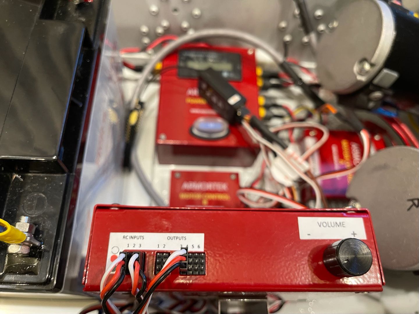

Controller A: Not sending a signal to main motors left or right; getting power to the module but no output 25V. I have a signal in the receiver when attached servos to empty slots but motors not responding to transmitter input. Is the controller bad?
Do you mean when you put a servo into the channels used by the motors it moves as expected ?
It may be a bad module or it may not be in the right configuration mode.

yulun.chang - something to try.
Does the tank drive correctly if you have all the RC inputs connected on the Audio Module as per the manual but the Output 3 to Recoil Module disconnected (I know the recoil won't work) ?

Fernando - have you tried it with just the Module A connected ?

Adrian,
Thank you. You are right I needed to connect my audio system. It is working now. This is my first build... Also, Mixing on the radio. I'm using Spectrum 7Ch. I got it moving forward and backward; I got it going left with one side of the track going forward and the other back to turn. Any suggestions?
Do you mean it goes in the wrong direction ? Stick to the left, tank goes right ?
If so, swap over the two leads in the receiver which go to Module A.
