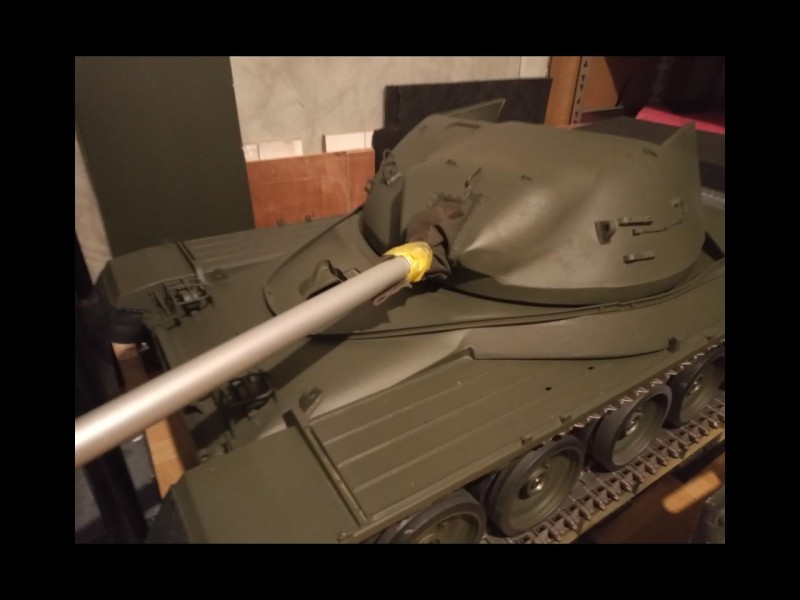

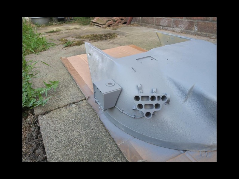

It's been a year already since I finished my chieftain built,I though I will give it a go at adding more details to the model and give it a colour change as I'm a bit bored with the desert sand. It will be good old BAOR NATO green and black!

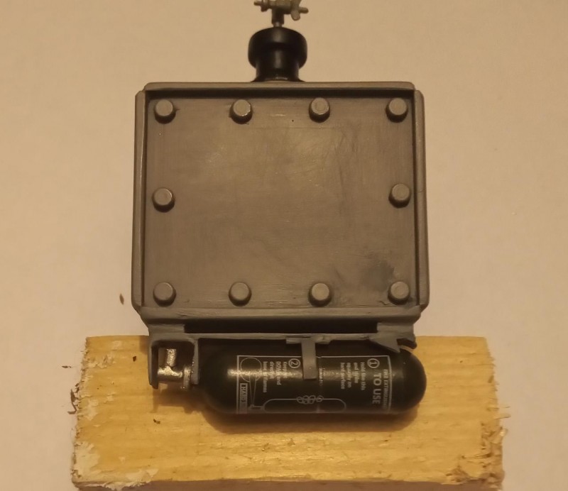

Antenna box with Armorpax extinguisher

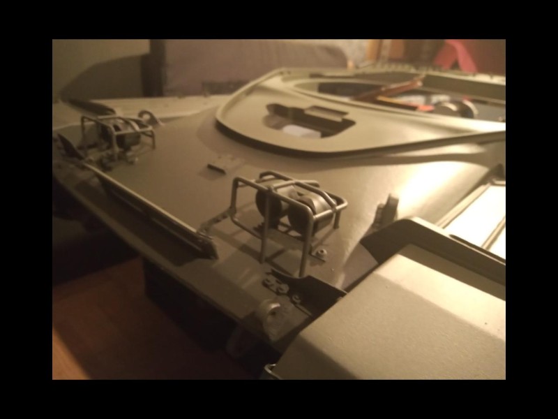

Trying to get my head around those smoke discharger mounts!

ATU certainly looks the part.
Do the smoke dispensers use the originally supplied rear flat brackets?

Hi John ,the ATU needs to be a bit wider,but I'm going to leave it for now,anyway I'm just a CAT2 person😆.
I'm using the kit supplied brackets for the smoke discharger,as I'm trying to make it look reasonably accurate without too much alterations.cheers

The reason for asking about the bracket plate is, a lot of my parts are buried in a box somewhere, others scattered here and there, I was just interest about the brackets because of the mounting lugs and how they would look.
Though the turret at my rate of build is year away.
There's a lot of detail that's been pointed out to me on the smoke dispenser brackets that could be done, hinges etc, but the mod you've made looks pretty good to me. So thanks for the heads up.

Managed to mount the smoke dischargers after much butchering of the turret casting!
For the CAT 3 or 4 brigade the smoke dischargers need to be set lower than the stock position unless you're doing a Stillbrew.

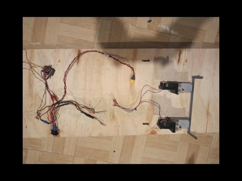

After taken the Chieftain apart and put into storage for the last year or so I've finally found the courage to dig it up and start rebuilding it.
Everything went well except when I tried to reinstall the smoker unit I forgot where to connect the fan units as there's no connections to the smoker module as described in the wiring diagram.

Looking good, nice bit of canvas covering, tongue in cheek, but has your Chieftain gone green? :shock:

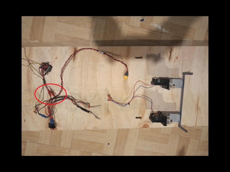

The connectors I've ringed in red shouldn't be connected together like that.

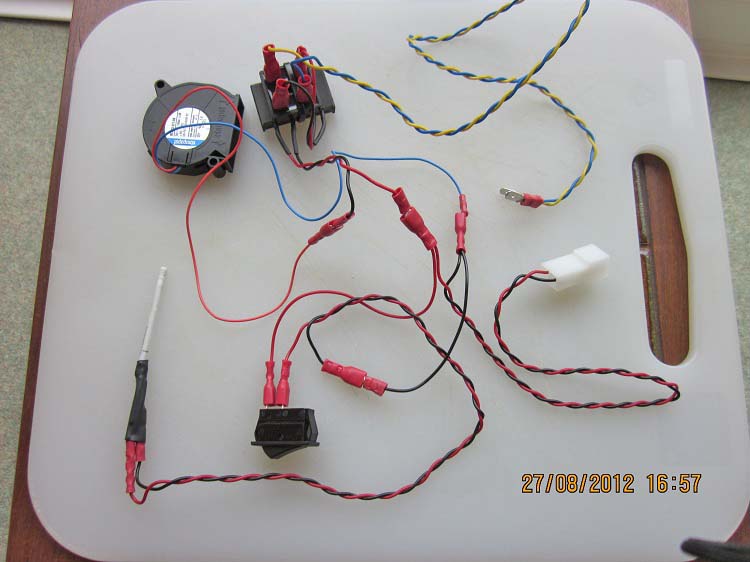

Use the picture below to follow through where the wires to the fans go.
There's only one fan and element in this picture but everything else should be the same.

Hi John indeed I've changed the colour from desert sand to NATO green😉
Thanks Adrian for the picture👍
