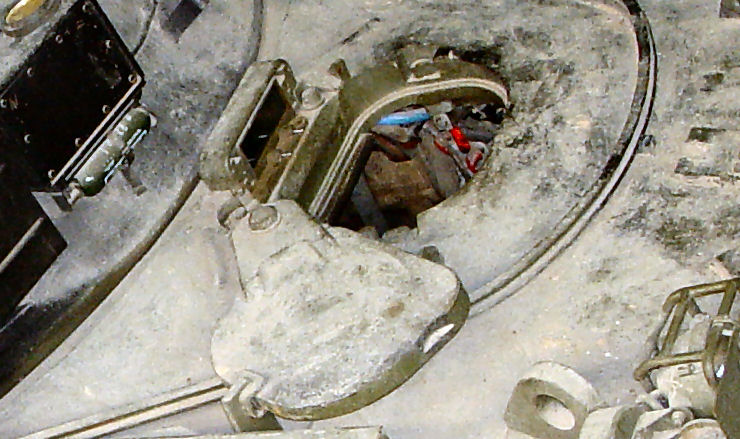

Considering the number of photos I took and notes I made on my last visit to a Chieftain I should know the answer to this question but for some reason I don’t.
Can anyone tell me what fills the gap between the wading rail and the front casting? I don’t think it’s a weld, is it some sort of mastic? Does anyone have close up photo’s they are willing to share?
Also, how thick is the driver hatch is? I have a figure of 60mm but the hatch was closed on the Chieftain I looked at so now doubt its accuracy.
Thanks in advance for any help given.

Hi Greg.
Thin sheet metal on the inside, seems to seal the wading rail to the glacis plate, but beware the given shape is not correct, it took me a couple of hours to get it something like. If you go that way, be careful not to crease the rail.
My hatch is 6mm thick now, (Hacksaw job) it looks ok open or closed, if you make the open slotted "parking post" you'll have to do a Banksy to clear all the other items on the glacis plate.

I stand by to be corrected by more knowledgable people but I believe the wading rail did have gaps to allow water out.
The rail acted as a bow-wave deflector when fording to divert water away from the drivers hatch, an attached screen would have allowed deeper waters to be forded. Chieftain was not a DD tank

The driver's hatch is 2.25 inches, 57.15mm thick on Chieftain. The cast armour around the driver's hatch was a lot thicker.
The wading rail had a port at the front to allow water to drain. Our drivers always kept a piece of wire in their cabs and at every opportunity they poked any debris through to keep it open. The hole might have been intended for water but for that it was wholly inadequate. The real reason they kept it clear was to avoid a neck full of diesel in the not uncommon event that there was spillage on the back decks, which would find its way forward.
Mark, the wading rail was again wholly inadequate to act as a bow-wave deflector. For that reason, a more substantial plate was introduced, fitted between the headlight clusters, probably around the time the Mk 3 was introduced although my memory is a bit hazy on timescales.
The wading rail was welded to the hull structure. Where a gap would have been formed, a fillet plate was added, as can be seen in this photo of the transition plate at the rear of the glacis casting.
This photo shows the drainage hole and how the wading rail was raised above the glacis casting with a small fillet piece. That is going to be a challenge to replicate.
