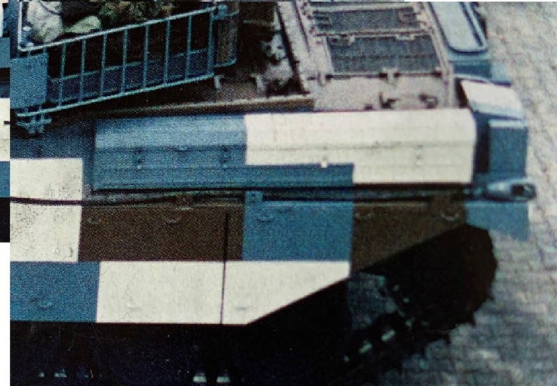

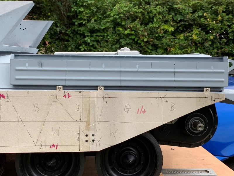

So today was spent doing some of that position and alignment thing I've been on about using my skirting template. So your probably asking how is that going to help me? The answer is quite simple; it allows me to match the Berlin pattern to the model accurately and identifies if any changes are needed. It is important that the tie downs, the skirting plate mounting points, and even the sizes and positions of everything above the mudguards aligns in perfect harmony with the pattern on the skirting plates. For example, take the following picture of 03 EB 20 in her heyday showing the left side large box and skirting plate.......
Concentrate on the grey/blue area on the top part of the skirting plate which is sandwiched between the two brown blocks. The left side of it is in line with the left side of the mounting piont and further up the box, the white area also aligns with it. Note the position of the catches of the long box also! The right side of the grey blue block transfers up onto the long box; again, note its position relative to the bin catches! If we now see the template in action, you'll hopefully see what I mean....
With the pattern accurately transferred from a picture to the template it becomes plain to see that the bin catches are in the wrong position. In addition, one of the skirting mounting points needs to be moved. This also allows you to fine tune the position of the tie downs as well to ensure they fit in with the pattern and align to things like the mounting points.
So what issues did I find on the left side, well these ones....
1. All side mounted boxes need their catches repositioning
2. 2 skirting mounting points need relocating
3. the triangular box needs extending
4. Tie downs need to be relocated
5. the slope of the top row of tie downs needs to be changed
So not only has my template checked alignment and positioning, I now also have a painting template for my left side skirting plates as well as a drilling template for the tie downs!

The position of the catches along the bin look perfect to me.
The mounting of your bin on your model does not however match to the photo of the tank you are trying to depict so you cannot use the bin or any parts of it as a reference point. You need to use the mounting points for the side skirts as reference points
The Chiefy long bin had no mounting points, you drilled holes through it where you needed them. They were such a useful item we had them fitted to every armoured first line REME vehicle when I was serving, ARV, ARRV, 432, 434, Warrior 512. They even got fitted to the wheeled vehicles.
Whenever we had to send a vehicle back for base overhaul, we always removed the long bins from it before doing so, then we could fit it to the new vehicle.
8 years after Chieftain left service, one of our bins rusted through. We put in a spares demand and within a week we had a brand new replacement.

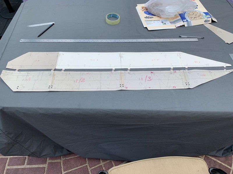

So after raiding the larder again for more cereal boxes, the right side template was constructed. Relevant measurements were transferred from the left to the right template but not the pattern.........
With it affixed to the hull, the pattern was carefully measured from the photo and transferred to the template, then the fun began!!

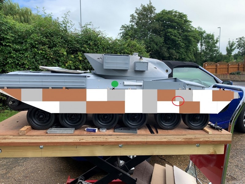

Now compare that information with how the model looks below........
right side electrical conduit red circle.jpg (111.2 KiB) Viewed 5187 times
Note the red circle denotes where the access point should be!
Not right is it? :cry: So is there a way to resolve it? :shock: YES, THERE IS!! : :twisted:

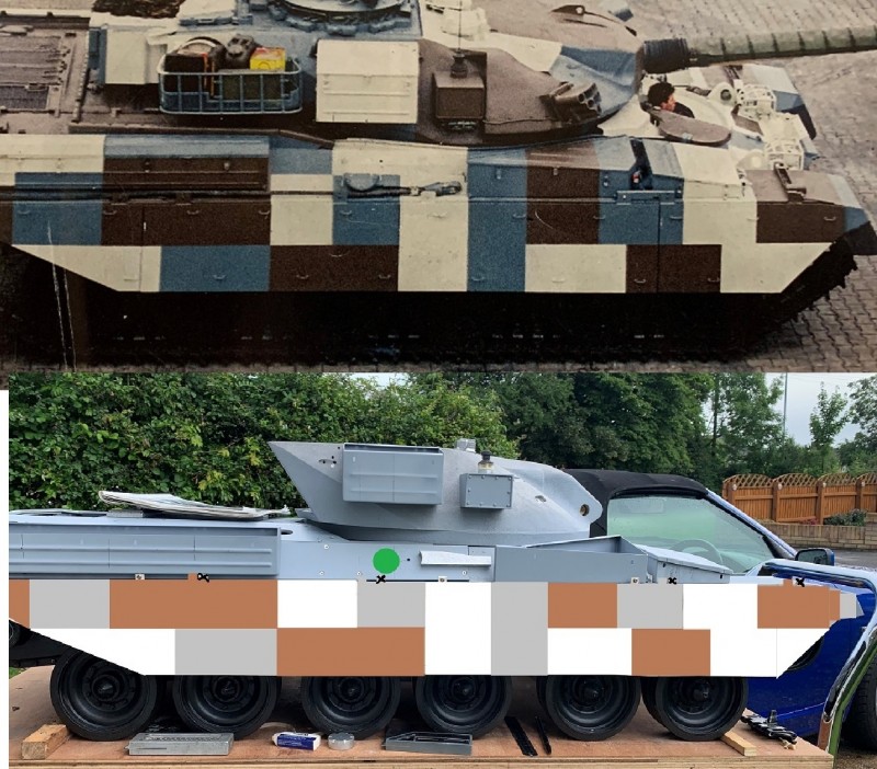

Moving the access point 30mm to the left brings it into the correct position relative to the turret box centre line. Note that the conduit should also move which then brings the right hand end to the join between the casting and side plate. Then move the mounting point so that its positioned correctly relative to the turret box then finally, adjust the whole paint pattern from the right edge of the long box to the very front taking into account the other area's of interest.
By doing this, you'll end up with this......
right side electrical conduit green circle.jpg (112.62 KiB) Viewed 5187 times
Now look at the 4 issues identified above and see if they are resolved?
Whilst a good line diagram gives you a good idea, nothing beats actual adding colour and filling in those blocks to give a good visual result. To that end, I used Microsoft Paint (badly I hasten to add) to do this and would highly recommend its use for others doing the Berlin scheme. Here's the comparison between the reference picture used and the coloured in template.....
Not bad for a first pass I think you'd agree although more than happy to take both positive and negative comments!

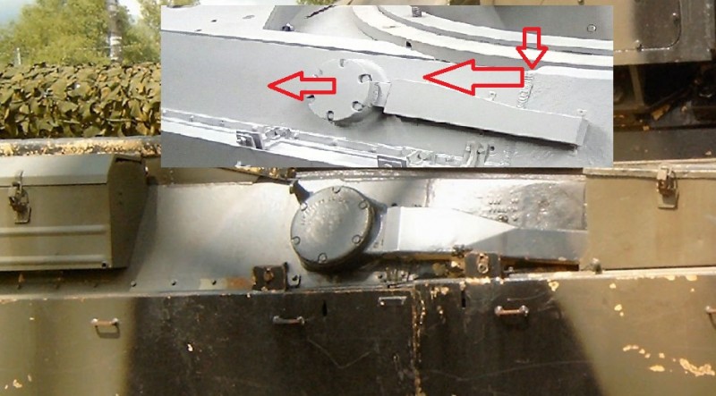

Richard, you're close. It's an armoured cable outlet which allows heavy duty cables to be routed from the main vehicle harness inside the hull to the external power pack for the tank dozer blade, via an unarmoured conduit. For tanks fitted with the dozer blade (1 per squadron), the hydraulics power pack was fitted to the right front catwalk in lieu of the front right bin. The cables were routed along the outside of the hull right side. The armoured cover maintained pressurisation within the fighting compartment, up to a point. The NBC system maintained an over-pressure to exclude contaminants.
The dozer blade was a pain in the ..... if you were the unfortunate whose tank was lumbered with it. It was generally on the second in command's tank in squadron HQ. Some sage advice given to me by a respected general: "never be second in command of anything". He was so right.

Super info Stephen,
Great detail work Richard, (more petrol on the fire.......no more please Arghhh) :lol:
Check out the angles on the conduit 8)
and I suppose now it's faking weld lines here we come time....again

The Dozer power output junction box has to be moved towards the rear to be in the correct position, a minor change, but bigger changes like the exhaust box had to be reduced in size otherwise other components looked out of scale. My telephone box is still a bit small even though I enlarged it.
Richard will have to move/expand on detail to achieve his ambition, as you'll find out when you build your Chieftain depending on the level you want to achieve.

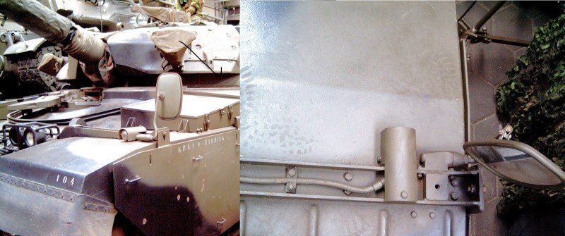

To demonstrate my approximation statement, look at the pictures below regarding the front mudguard support bracket and the the first skirting mounting point......
See how the support and the mounting point are combined. On the model however, its this......
Two separate parts! As a maintainer of many years experience on Chieftains, perhaps you can advise which is correctly positioned; the mounting point or the support bracket?
As already established, the Berlin pattern is a clearly well defined pattern with little room for adjustment if it is to be representative. That's why all Berlin Chieftains looked exactly the same. My problem is to try and fit a well defined pattern to an approximation of a model; a task that is fraught with danger as Youngjae found out and effectively demonstrated on his model. This isn't a criticism of Youngjae's build, far from it, he did the best he could with an out of the box build but quite clearly, it doesn't look right and the Berlin pattern will do that! The only way to beat this is to ensure everything is to scale and correctly positioned where possible, then adjust the pattern slightly to make it fit, further adjusting parts as required . That said, if you have a better way of doing it and can demonstrate it, then I'll certainly listen and judge its merits?
