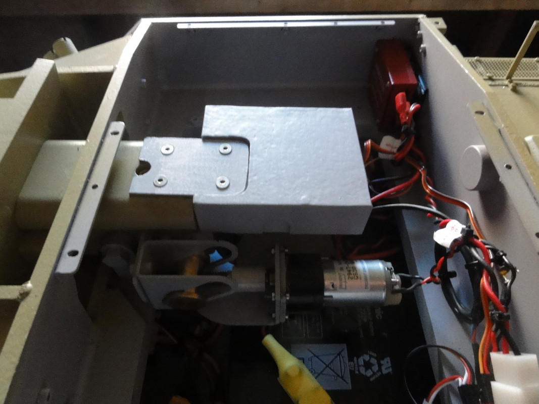

In my stug i use a counterweight ( 1,688 kg ) to make the barrel goes up and down better.
Best regards Yves
