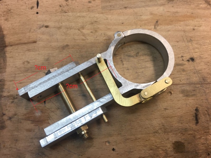

Dear Sascha,
Regarding the details of the gun barrel clamp and rack, maybe the wonderful (but sadly unfinished) works of the late Per Sonnervik are helpful:
https://tanks.lindak.se/#collection/ee9 ... b1142f25d2
Lerh Chang
Lerh Chang

Did you weld the lower half to the legs or machine it out of one part?

Hi Sascha,
This is an awesome mod. Would you mind sharing the length of the gun barrel lock rack, both inner and outer one? Thank you.
Stay safe.
Stay safe.

Thanks Sascha for the detailed line drawing. So far it is more than I could hope.
In the time comes, I will PM you. Thanks again.
Lerh Chang
