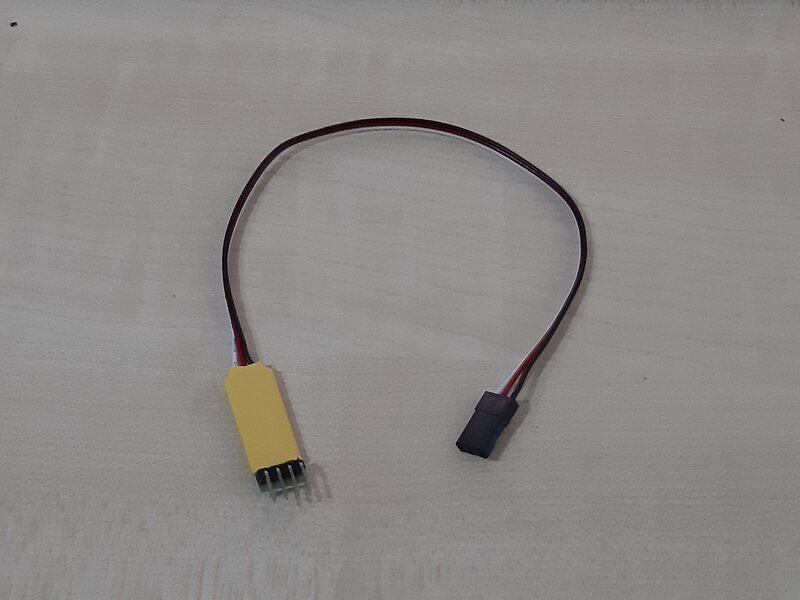

I wanted something to turn lights on and off on the UC and everything I found seemed to have far too many functions, so I have built one myself.
It has two modes, selected at power on by the position of a three way switch.
If the switch is off (Pos 1) at power on then it behaves like this:
Switch Pos 1 LED1 Off LED2 Off
Switch Pos 2 LED1 On LED2 Off
Switch Pos 3 LED1 On LED2 On
If the switch is in the centre position (Pos 2) at power on it works in toggle mode, so if you click from Pos 2 to Pos 1 and back again LED1 comes on. If you do it again, it goes off. And the same for Pos 2 to Pos 3 for LED 2.
It has FET output drivers, so can handle 1A per channel, though most LEDs only use a few milliamps.
Price is £10 plus postage.

Dear Adrian,
My Dad has bought one of these and I don't think we have the pin out description. Sorry if he has lost it or I'm being slow.
So the PCB header seems to have two outer pins marked (+) and two inner marked (-). Do these provide power (direct to the LEDs) from the rx lead into the unit or (less likely I guess) just the connections across the FET (although more like a switch)?
I think my Dad has bought LEDs with resistors calculated for 7.4v for the battery pack rather than the 6v from the BEC but shouldn't make much difference.
btw Is very neat and tidy unit.
Sam
Sam
- Posts: 5131
- Has liked: 1484 times
- Been liked: 1690 times
Re: Simple LED Light Switch
Yes, they are raw supplies for the LEDs, without series resistors.
The absolute maximum voltage of the PIC is 6.5V, though there is a series diode on the power input of the board, but watch the supply voltage.
I was short of a 4 pin shell for the standard servo connections output so printed one. Openscad source if anyone is in the same position and has a 3d printer...
Dad very happy with working lights.
Sam
pitch = 2.54; // 0.1" w = [0, 0.6, 0.6]; // wall thickness b = [14, pitch, pitch]; n = 4; for (j = [0: n - 1]) translate([0, j * pitch, 0]) difference() { cube(b + w, center = true); cube(b - w, center = true); }openscad is free to turn it into STL... I just printed on cheap FDM printer 0.4 nozzle and 0.2 layer.
