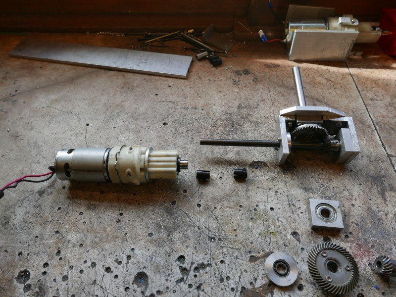

I got lucky in obtaining sets of gears that give me a 90 degree change in direction and about a 3:1 reduction. I bought a pair of Wickes 18V cordless drills that give me a 16:1 reduction and a nice quality motor in one simple package (the batteries, chargers etc are a bonus). I have started fabricating a gear assembly that will mount onto the existing bell housing that carries the drive shaft bearings in place of the differential axle. The major surgery to existing parts will be in chopping the existing drive shafts to length.
The photos show the motor and gearbox along with some of the bits and a partially assembled drive for one side. The motors will mount longitudinally and I have some ex-RC 1/8th scale drive shafts to couple things together. I think that with some covers made for the motors the changes should be fairly invisible.
The hope is that with around 4 times the torque and steering that doesn't rely on brakes the off-road performance should be improved. Yes, I know it is getting away from the originality of the design but to be honest I'm prepared to make that change for the potential improvement in performance and anyway the ambulance is already modified!

Some progress on the twin motor setup in the UC ambulance. Having carefully measured the space around the rear axle and made the 90 degree gears to fit I found that I couldn't actually install them! As they are currently configured it is impossible to fit them in one piece or assemble them in situ. It will require a largish chunk to be cut away from the vertical plate at the back of the chassis or the removal of the rear drawbar plate, neither of which I particularly wanted to do at this stage.
I have therefore gone to plan B which is to pick up on Graham's idea above and have the motors crosswise in the chassis driving the axles via chains (I had the chains and sprockets from a previous project). This means I can try out the performance relatively easily without major surgery on the chassis. If all looks good I can then decide on how to fit the gears which is still my ultimately preferred route. Hopefully I will get some photos uploaded over the weekend.
In the meantime I have to say that the Wickes own brand 18V drill motors and gearboxes are remarkably smooth and quiet. For £45 you get a motor, 2 speed gearbox, battery and charger and a simple speed controller!
