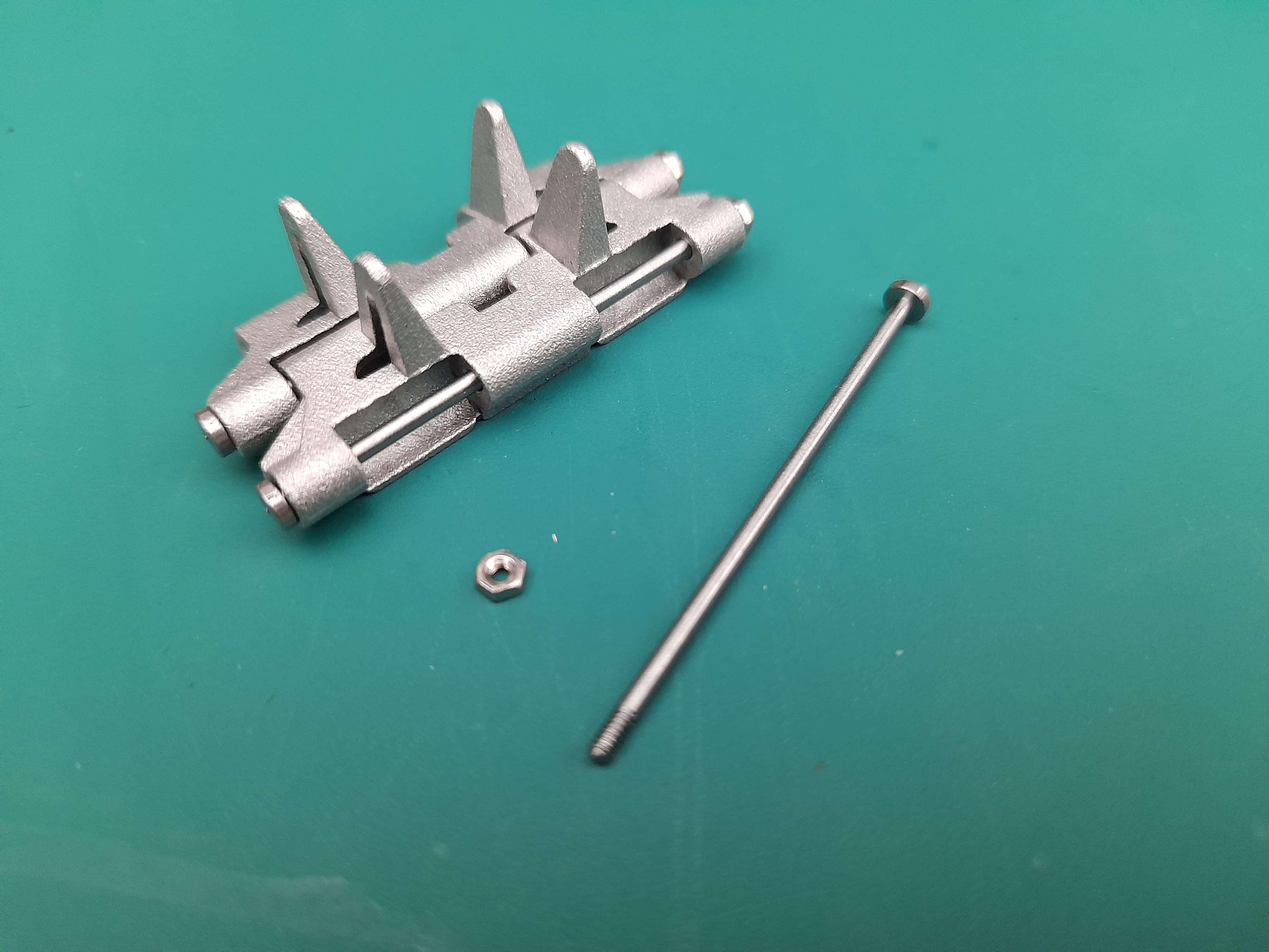

It looks like we have enough interest to warrant a decent batch of these. Sets can therefore comprise 350 pins in steel with stainless steel nuts rather than the 500 I had to buy initially. Set will be £300.00 + p&p. Delivery to me from placing the order is likely to be 3-4 weeks. We won't be able to offer single orders at this price and would need to get sufficient orders together each time to make the price work.

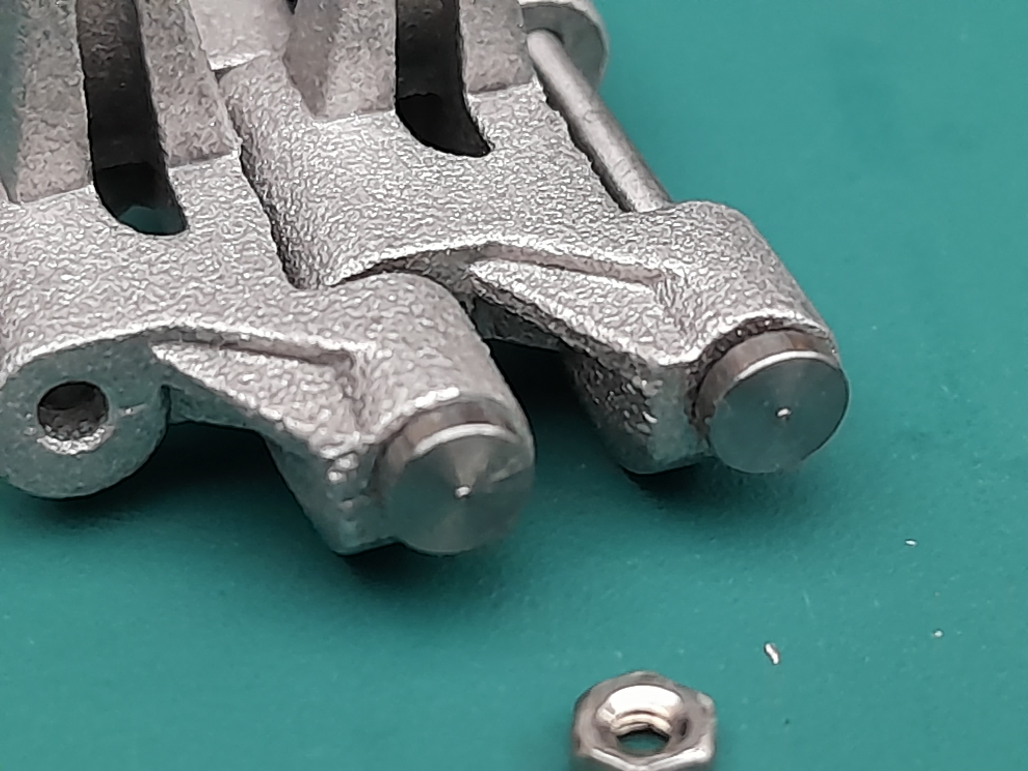

I have been asked about Stainless pins and had initially inquired with the supplier before buying steel for myself. With costs in excess of 3 times the steel ones and a reluctance by the supplier to machine in SS we binned the idea. The Pin head is a little larger than I would have liked but again process limitations with the supplier.

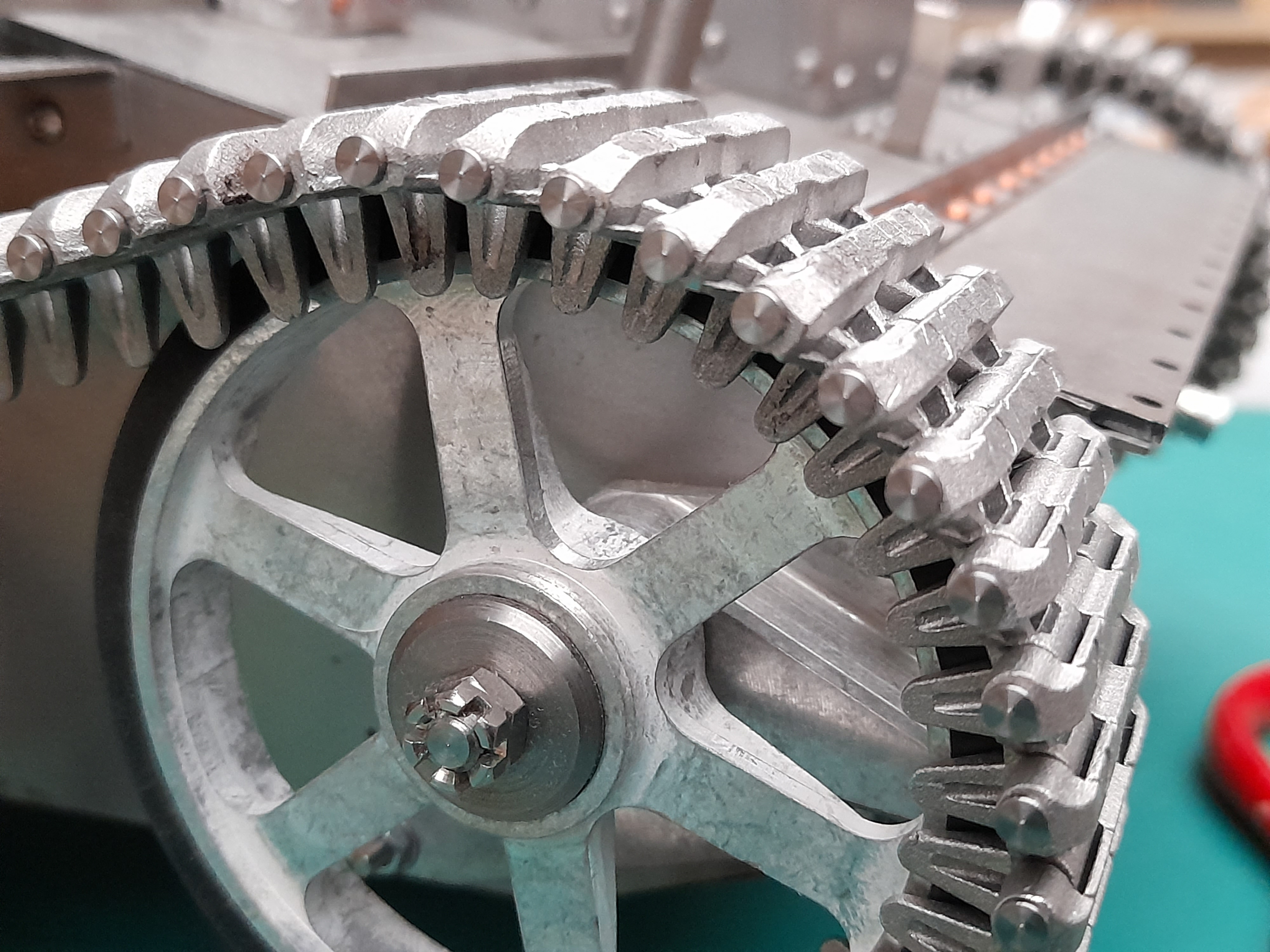

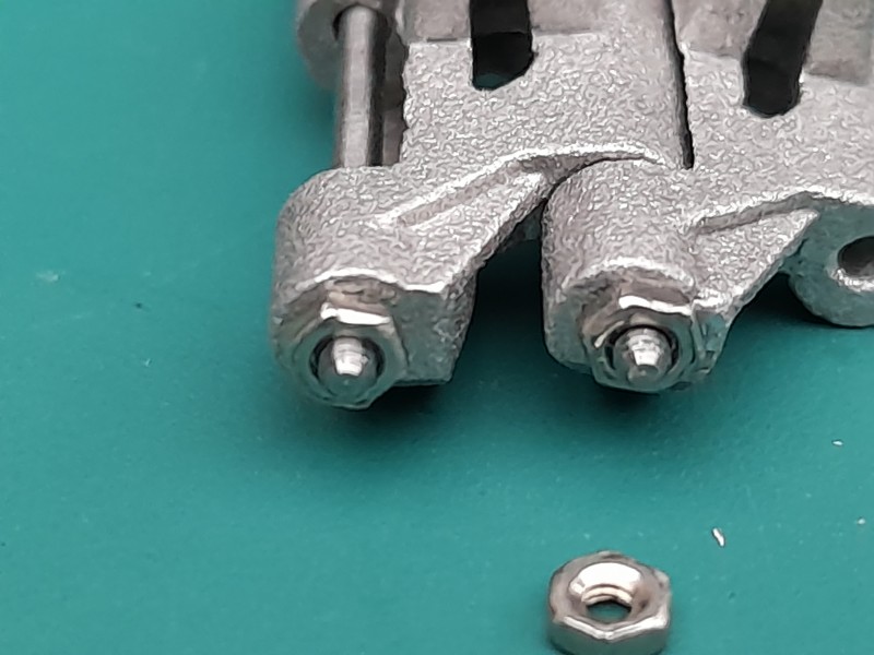

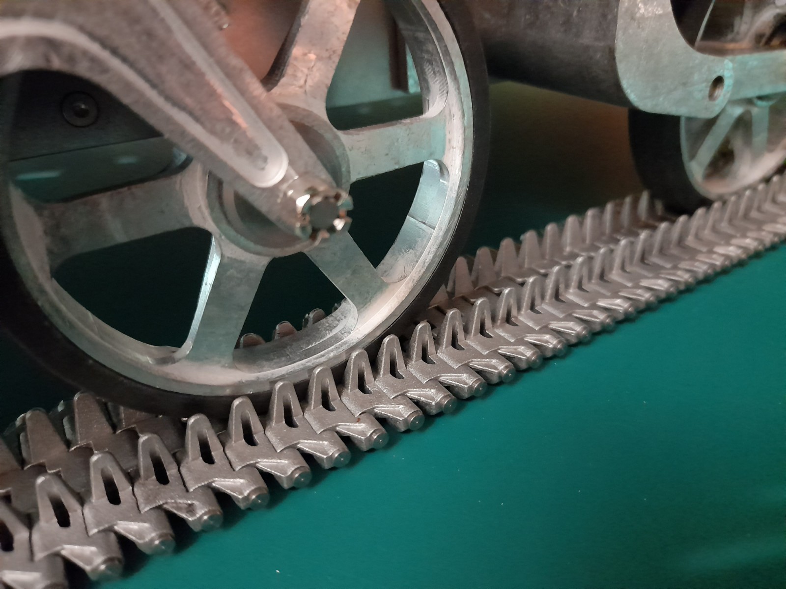

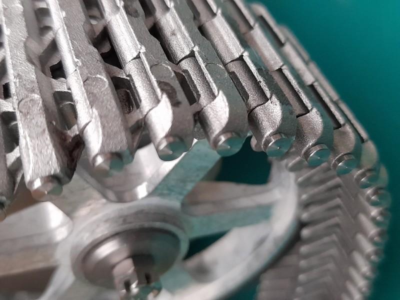

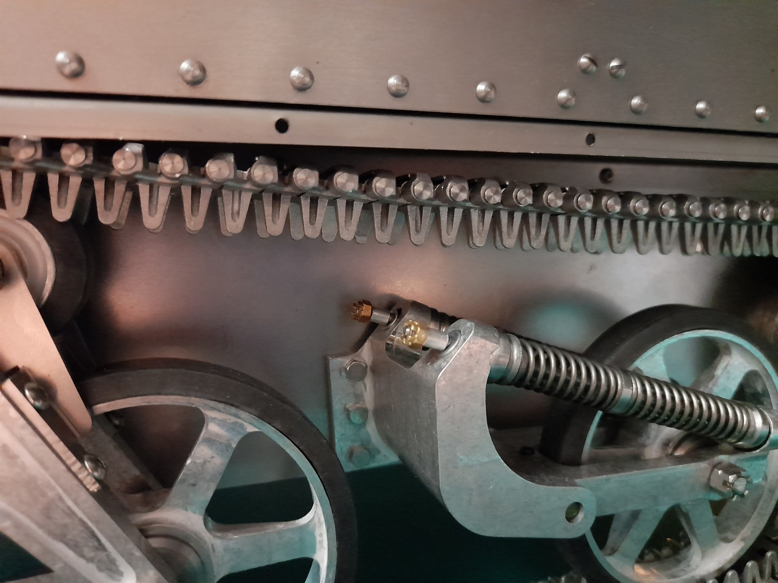

Just finished fully replacing the split pins in the first track and I have had to use all 165 links supplied for each side. Before modifying I had 163 in but they were still slack. Full diameter pins have definitely tightened up the tracks and I had to nip up the joint to get the last pin in. Fit round the sprocket looks Ok and there is still plenty of bend in the tracks. I would expect the tracks to slacken a little once I have run them for a while and they bed, especially as the odd one was a little stiff after first putting the pins in. Before I go ahead and order these please take note of this and let me know if you are still happy to proceed with your orders.
