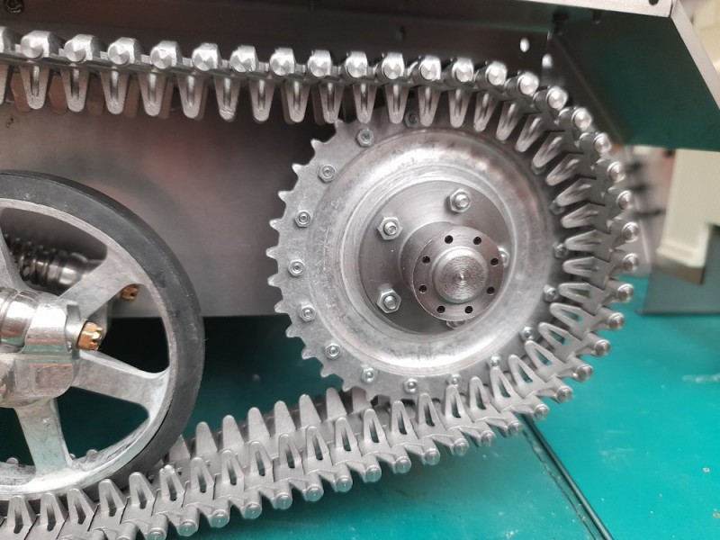

Re: Universal Carrier 15 - a first kit
I'm having some difficulty getting the tracks on my UC. I have exactly the number of tracks listed in the kit. I've put them together using the Armorpax pins (which are quite nice looking!). Using exactly half the number of tracks on each side, I seem to be short a track or two to easily connect them. At first I thought I had the Front Idler Assembly installed too far forward. To correct that, I loosened the bolts to push the Assembly as far back as possible. It still seems like the tracks are not long enough. Anyone else have a problem with this or any suggestions?
I too have used Dave's pins and I have used all the links and completed the tracks each side. How much play/sag have you in the track, you may have to rob the other track.
I have also found that the pins fit so well in the tracks that they have acerbated any slight miss alignment in the track castings resulting in the track curving or twisting in places. The bonus is that the tracks fit the sprocket well.
Hope this helps.
Hope this helps.
Hi John,
I have 165 on each side and the gap once all set up was just over a track link which when pulled up has the tracks sitting as I would have expected. After being on for a few weeks now they have stretched a little. I have not modified the mechanical build and all is straight out of the box. The slight right hand curve of the track has also now gone. Not sure why your gap would be bigger. I also fitted the track sitting on the bogies so not sure if that helps where it naturally pre compresses the suspension with the model weight?
As Graham has stated the fit round the sprocket looks right. Another builder used cable ties to pull the links together on his tracks (using split pins not ours initially) which is a tip that may help?
Took this the other day for another customer and shows the track after a few weeks on the model. I would expect with regular running to eventually drop a link which is quite normal.
https://1drv.ms/v/s!AiWgFgOctns_g5xYB0u ... A?e=pdVqvm
Thanks for the quick replies. I'll keep at it and, hopefully with the UC on the tracks, it will help set it. If not, I'll try the cable ties.
