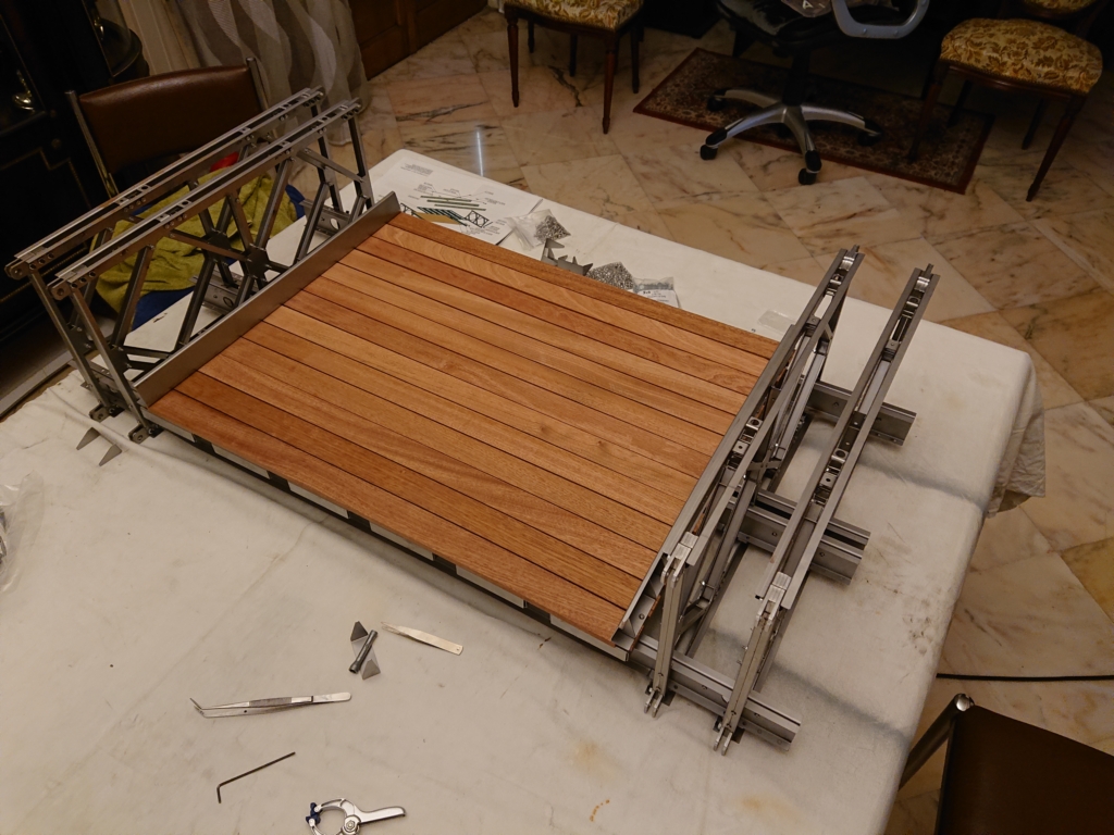

Having bought a kit some months ago, i started the built of it some days ago, thanks to holidays.
After a day work with a friend ( it's easier being 2 when it comes to bolt the component of the ramps !) a good part of the assembly is done, thanks to the good fititng of parts
anyway, still some job to be done to fully assemble it before disassembling and priming

Some progress in the building, quite all elements fitted together now (was 2 weeks ago)
As said in other posts some adjustement needed with transom shoes (hole adjustement) to fit fixation holes in transom
same for all parts receiving the EN 120 pin using a step drill.
assembly of bridge elements is now smooth, with no gap
next is to disassemble everythng, remove light rust on elements, apply etch primer and paint.
double single for assembly check
full single - need to create a support for the bearing plate so ramps can lay in correct position

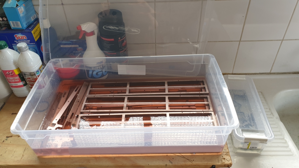

As built was started in summer 2019, and parts carfully degreased at that time to avoid issues with paint, some corrosion starts to appear.
I've used acid + phosphating primer to protect the parts
then primed /assembled /painted the parts that would not be easy to paint later on (i know, using etch primer was useless, but had it in stock)
then reassembly of the panels, floor sections + paint to hide the screws
To finally discover that i was short of paint.. (need to order some more cans?)
Many thanks to Laurent Rosset for the information on the paint ! :wink:
june/july 2020
i've used a pvc pipe to dip the long parts in acid
acid then water to stop the reaction
priming part areas that , once assembled, could not be painted
all the stuff nedeed for 1 section....
a section quite finished (some paint touch up to be done once averything ready)

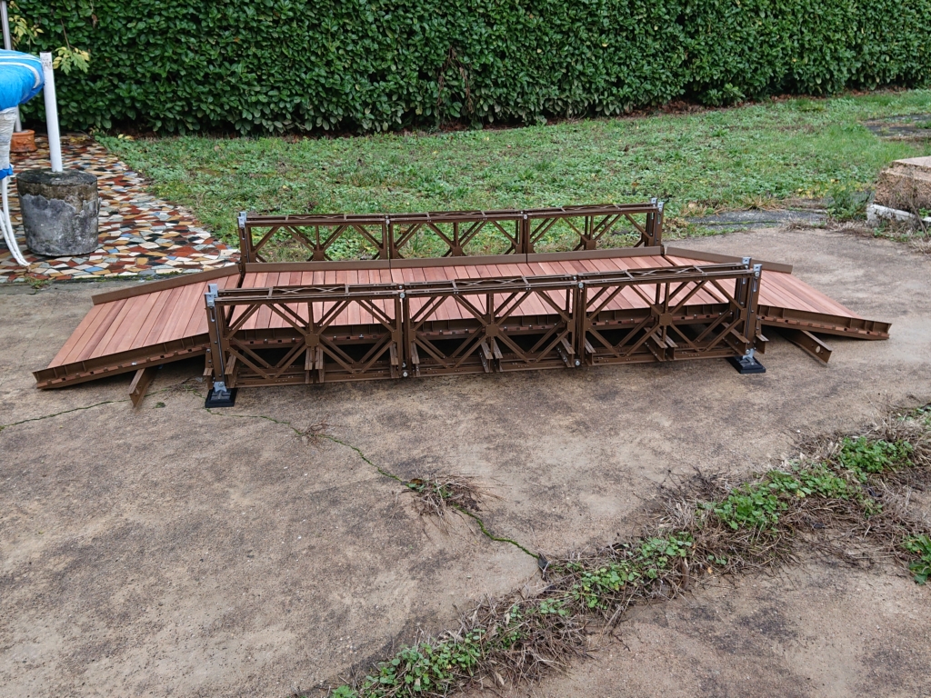

after a 2months stop, work restarted a bit, just got time to assemble the 2 ramps
and lateley, week before Chritsmas final assembly of the last section, plus adjustements to be able to fit the pins between all section (untightening some elements to allow them to move a bit)
priority to medical teams..
By now just a few more checks /paint job to be sure everything is tightened / painted..
the fitting of the part was a pleasure, even if sometimes i was wondering how i would be able to fit a screw or a nut in some places ! :D :D
regards
Didier

Each span is 50cm, so 1.5m large between ramps, 2.5 m total length.
