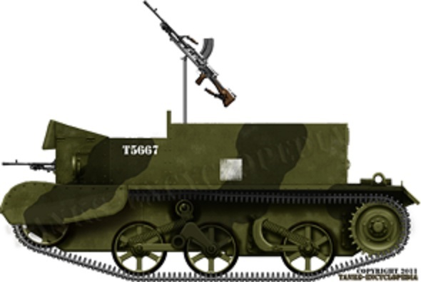

Was the Armortek type of carrier with the BEF 1939-40? I'd like to do two tone camo such as this.
But the problem is this, I have not found any clear pictures of this type of carrier. the only carrier type seen with the BEF to be sure is the "Scout".
I found one picture that could be the Armortek type at Southampton docks before embarkation, but the picture is hazy to say the least, the left side square armor plate seems present. Maybe, maybe not?
Any help would be appreciated. :|

Well it seems the Universal Carrier Mk2 debuted around 1942 so the BEF idea has to be rethought.

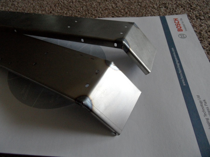

To tighten up things I thought I'd get the box joints welded up. Some of the steel is very thin, mud guards etc, so I'm going to have to find someone with a good steady hand and needs a fast food meal, which will be sometime next year now.
I did get these bits done, a bit rough but nothing a good session with the hand sander won't sort.

I managed to get the last of the welding done on the UC, If I'd done it we'd have had an accurate model of a vehicle left behind by Micheal Whittman on Cean Road with the rest of Brigadier William "Loony" Hinde, the 22nd Armoured Brigade group :shock:
Even a good friend who is a great welder turned the job down because metal is so thin.
But another coded welder I know, well it's like watching magic being performed.
The welds will need a bit of fettling and painting for storage.

Excellent welds. Was it MIG or TIG?
Re: Universal Carrier No32
They are pretty good, I would say tungsten inert gas? 8)

Tig it was, with stainless rods, I did ask why not use ordinary steel rods and the chap said the stainless steel rods are usually a much higher quality.
Who am I to argue.
I hold my breath while welding so I have about a minutes worth of welding in me, if it's thin metal, its all over in seconds :cry:
