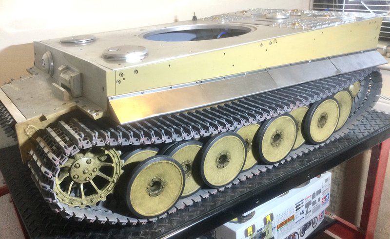

Road wheels fitted. Sanded tyres and lightly weathered the wheels.

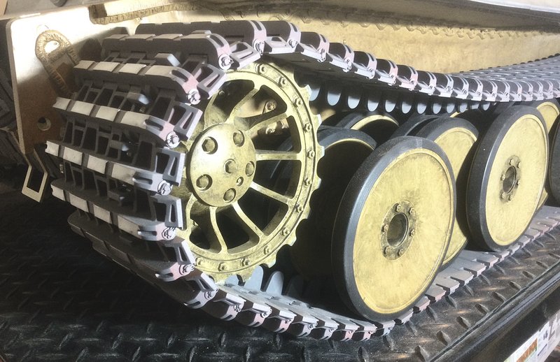

Sprockets assembled and weathered. Button head bolts replaced with hex head bolts. CNC marks ground off. Hubs modified with the sunken oiling / grease ? plugs. Centre bolt recess filled as the centre domed bolt wasn’t recessed.
Idler wheels have had the CNC marks ground off. Still need to sort out the hub mounting bolts.

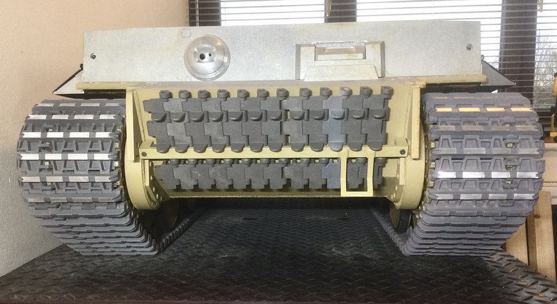

Tracks assembled and fitted.

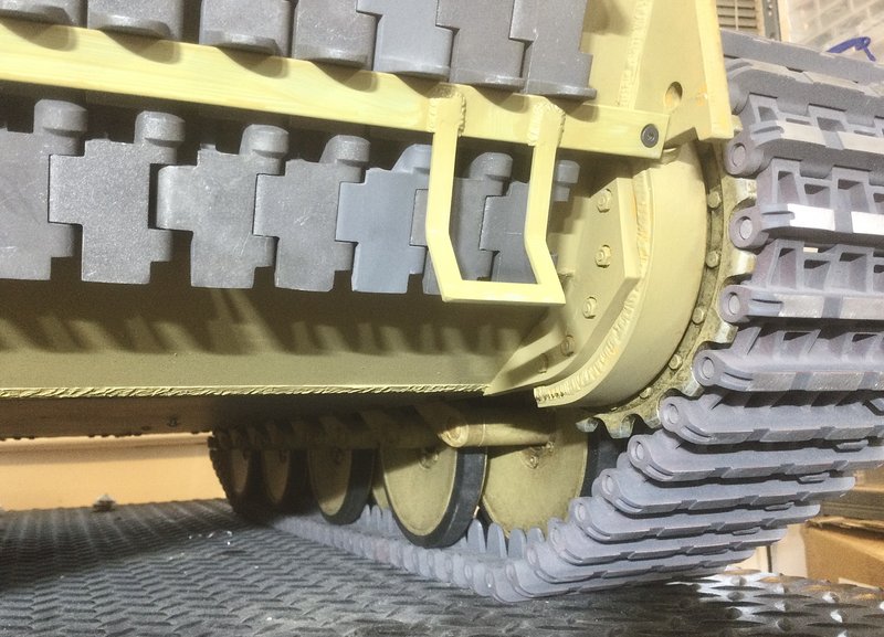

Spare track mounting bar on the front test fitted and step added. The step was welded on not bolted so countersunk the mounting holes and ground the heads of the screws flush and a bit of filler and then the weld detail added.
