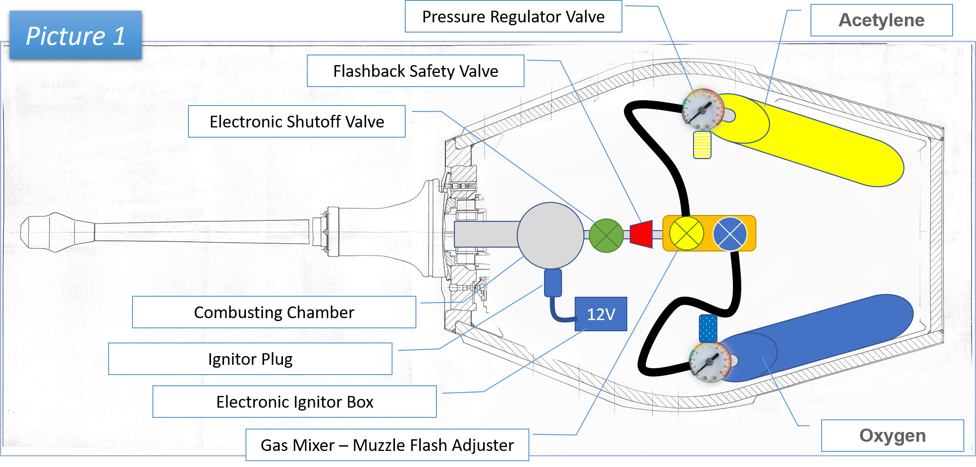

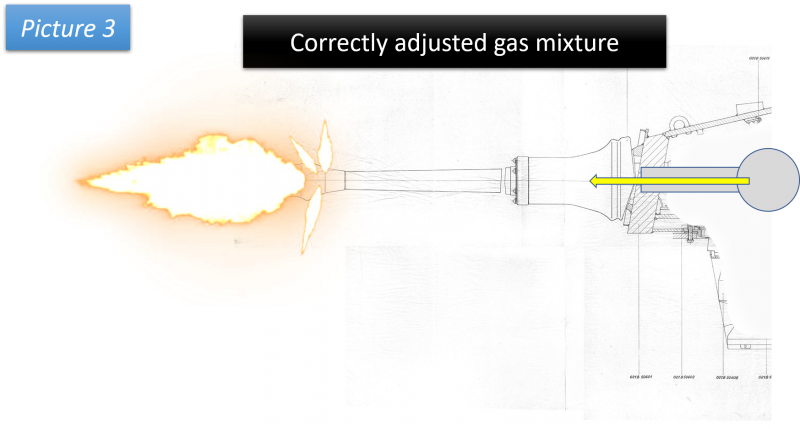

Dear Armortek community,
I am looking into building a device to create a realistic Muzzle Flash.
To stay within the regulation of Armortek and other authorities, I am not looking into building a Blanc Firing device or ammunition device with some kind of Black powder propellant!
I would like to present my idea to this forum hoping to get some feedback, your thoughts, or experience gained on similar devices, before investing time and money into building a prototype.
The objective is to create a realistic muzzle flash by combing the features of Armortek recoil and sound option packs. All details in the following pictures and descriptions are only for illustration purposes and do not take account of accurate size or measurements etc. (Picture 1)
The muzzle flash will be created by mixing burnable gas, in my demo I propose an oxygen with acetylene mixture, but any gas combination better suited could or should be used.
The advantages of a Gas Muzzle Flash feature:
1) Should be Safe when correctly build and used.
2) No burning residue or soot will damage the interior or exterior of the tank.
3) Resources for many gun shots (no reloading with shells required).
4) Compatible with the recoil function.
5) Allows 360o turret rotation. (as the feature will fit completely into the turret)
6) Customized muzzle flash possible (short, long, bright, reddish etc.)
Description of operation
Both of the gas cylinders, the oxygen and acetylene are opened to provide the correct gas pressure for the “Gas mixer – Muzzle Flash adjuster”
The “Gas mixer – Muzzle Flash adjuster” is used to regulate the desired gas mixture for a customized muzzle flash. (bright, reddish etc.)
The Flash Back Valve is a standard required safety equipment.
The electronic Shutoff Valve is used to meter the required amount of mixed gas in into the combustion chamber. (short, long, large etc. flash flame). The opening time is depending on the size of the combustion chamber and is expected to stay open between 1 and 5 seconds.
The ignition is done with an electronic ignition device.
Timing sequence
I looking into an automatic pre-programmed timing and sequencing, upon pushing the firing button on the RC transmitter;
1) The Shutoff valve opens
2) The Shutoff valve closes (after the programmed time interval)
3) At the same time following events will take place:
- The Ignitor is activated
- The Armortek Recoil
- The Armortek canon sound
4) As per your tank, a waiting time before next firing is possible

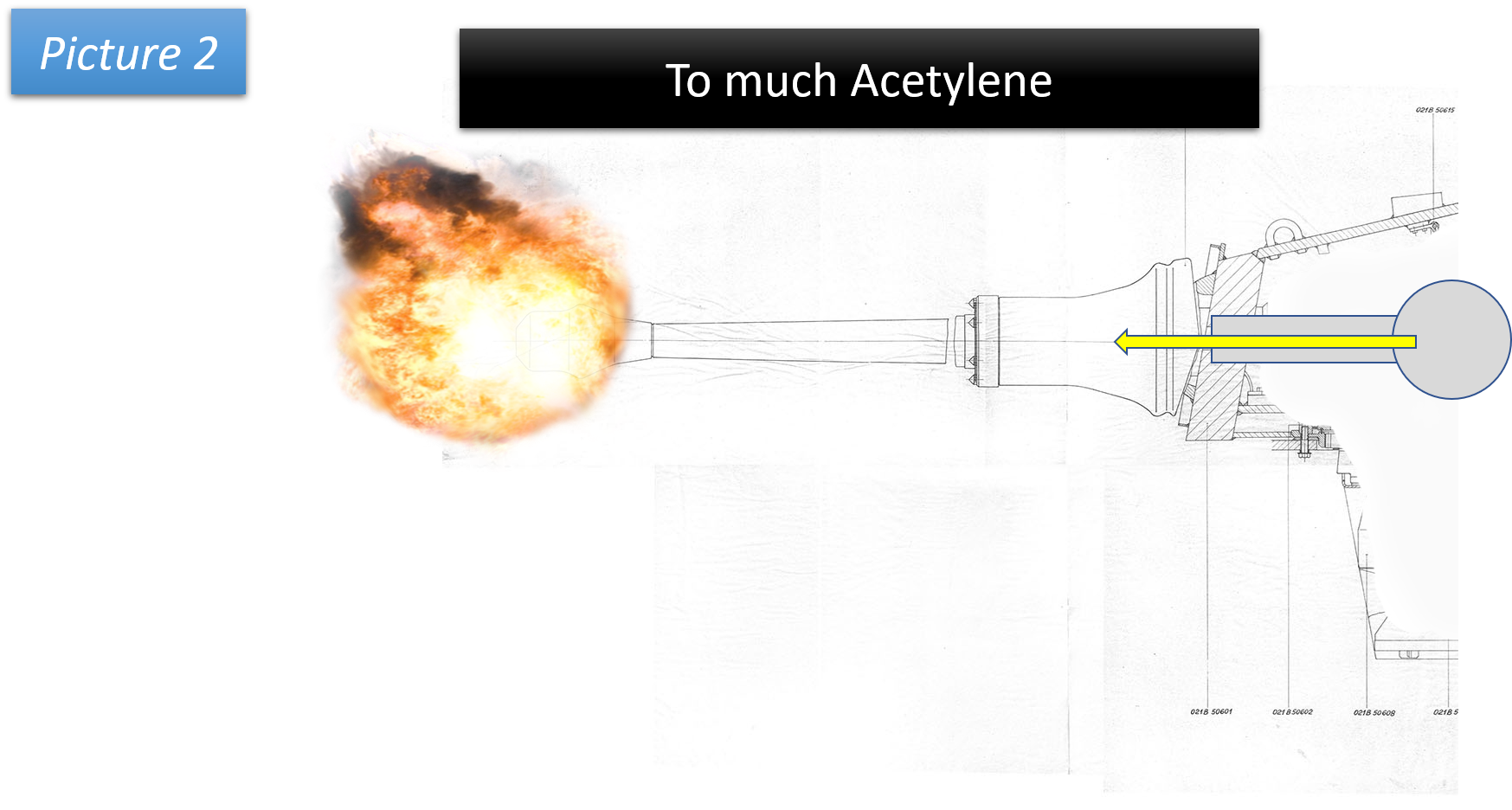

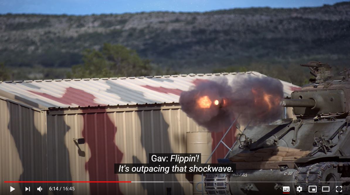

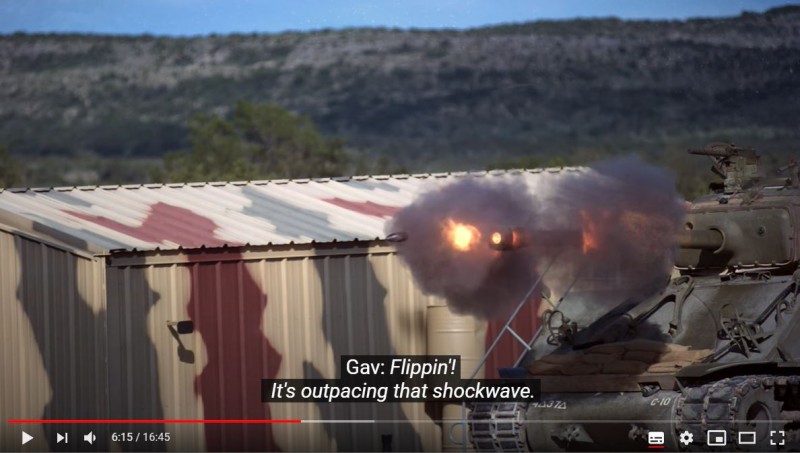

Picture 2 shows the expected Muzzle Flush with not enough Oxygen to speed up the combustion, resulting in a reddish bowl.

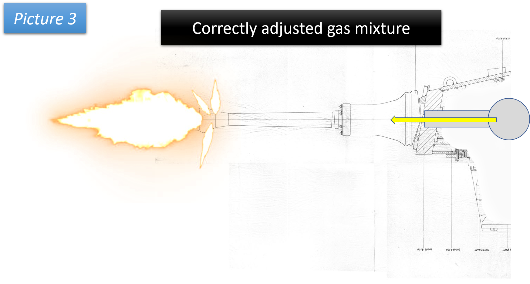

Picture 3 shows the flash with a properly adjusted mixture of Oxygen / Acetylene with the correct amount of gas in the combustion chamber.
As such, numerous adjustment combinations are possible to obtain your desired Muzzle Flash result.

Reenactors use a pro-pain gas system for machine guns as its cheap and effective, some people have used this in RC tanks, if the system had a small leak which in a combined space such as a tank turret could be disastrous, the use of oxygen and acetylene potentially could be far worse should there be a leak in the turret. Firstly I would get as much advise from companies who have installed similar systems for reenactors.

Then i prefer the Armortek blankfire system ( for the older tank models )
it is a lot safer if you know what your doing.
The gas system is a great setup but i dont trust gas ( leaking )

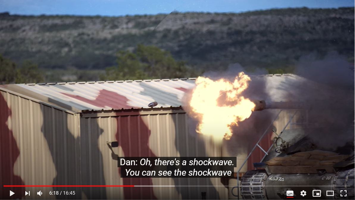

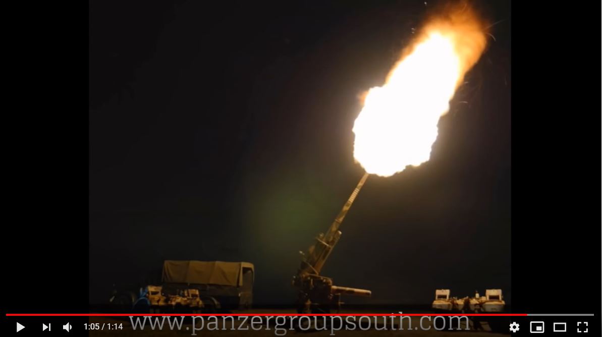

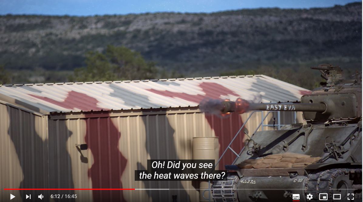

I fully agree with your comment and do not want to question your expertise. What I meant to achieve is a more realistic muzzle flash than a light bulb in the canon.
Although I did not find original picture or video of a King Tiger firing, I derived my assumption based on a Sherman super slow-motion firing and a restored Flak 36 88 mm firing. I assume the real KT muzzle flash should be somewhere between those extremes.
Sherman firing
[Flak 8.8 firing
Gerard

I am also scared of combustible gasses. Not even sure if we are allowed to store them in our homes any more here. To me, the smoke effect is more important.

We've seen the effect of a catastrophic failure in a home-made pyrotechnic solution at a public show, so, as you say, the first consideration is safety. Could you assure yourself that this system could be operated without risk to yourself, the public and the model? Although it would make for a very realistic model, the risk probably outweighs the gain.
As Christopher says, a smoke effect is more important and we have solutions already developed, in my Centurion system for example based on a vape box, which is very effective.
The bigger remaining challenge is to simulate the percussive sound, recoil and platform rock associated with firing the main armament. Some solutions have come close but the explosive effect of firing is hard to replicate. A compressed but inert gas solution may well be the answer.
