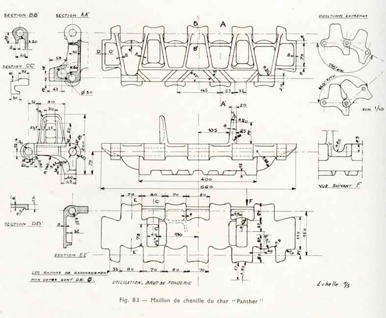

Hello,
In looking for full size (battle) track width, I came up with 660mm on this excellent site: Panther144.de
I'm here to double check his dimension for scaling. Thank you.

Hi Carlos
Yes 660 it is.
Kind regards
Kent

Thank you Kent for your verification, and for the excellent drawing!
Kind Regards,
Carlos
