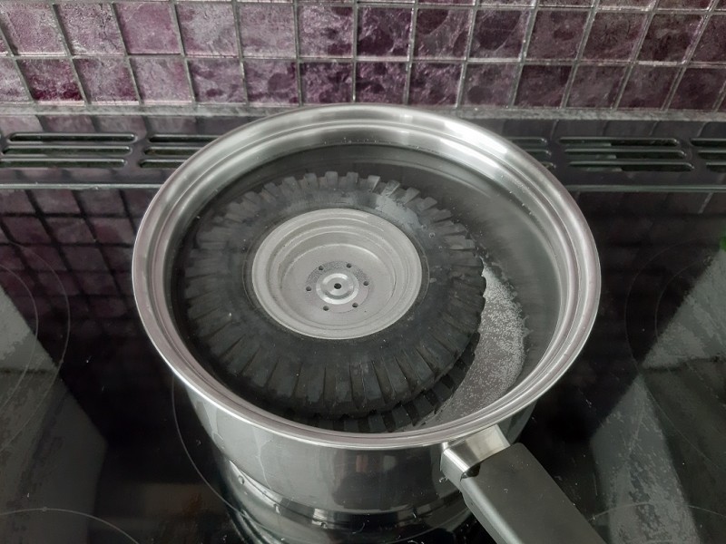

This was me boiling a set of Sd.Kfz 222 tyres to get them to sit back on the rims correctly.
It might be obvious but wear gloves when you get them out of the water!!

My grateful thanks to those who gave advice , four wheels done this morning, tyres into pan of water ,one at a time , heated to boiling and kept at that for 15 minutes , using an egg timer , and tyres went on with the help of a mallet , needed a bit of a thump but not much force , All seated great
Will do the other four tomoorrow
