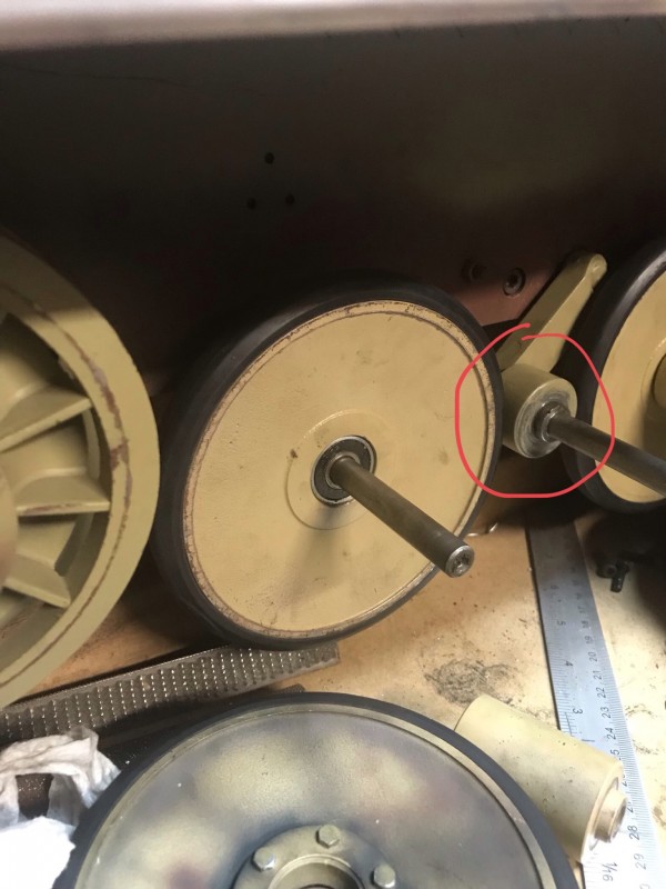

Re: Tiger 1 tracks slipping and comming off sprockets
Pete,
Here is the image I referred to in the pm. And here is my question for anyone’s future reference
I have another question with regards to the spacers/flanges on part of the axle shaft. Please see pic for more clarification. Does this also get machined down? The reason I’m asking is two fold. One, I drilled and inserted a pin to prevent the axle from ever leaving the swing arm. Second, I am currently working on installing all the suspension parts and wanted to know if I am getting a head of myself. Getting those pins out will be a nightmare. The diameter of this spacer clearly leaves lots of room to be machined and giving the inside single wheel more room. Please let me know what you think.
Wael, one model I had did have a considerable amount of wear on these parts due to wheels rubbing. If you have partly assembled I would check to see if you will have this problem. If so (and on the basis that you have already pinned the axles) I would be tempted to grind narrow flats on the boss to give clearance. I have seen this done on models and you can't really see the modification when the tank is fully assembled. The alternative would be to drill out the pins and machine the boss down but you will have to leave a flange to support the wheel.Wael Hazin wrote: ↑Thu Jan 02, 2020 1:56 pmPete,
Pete,
Again, thank you for the great advice. I have aligned the axles perfectly at 45 degrees and there just isn’t much room. I know machining would be much cleaner, but I may have to consider the grinding option. I will keep you posted on my progress.
Regards,
Wael
