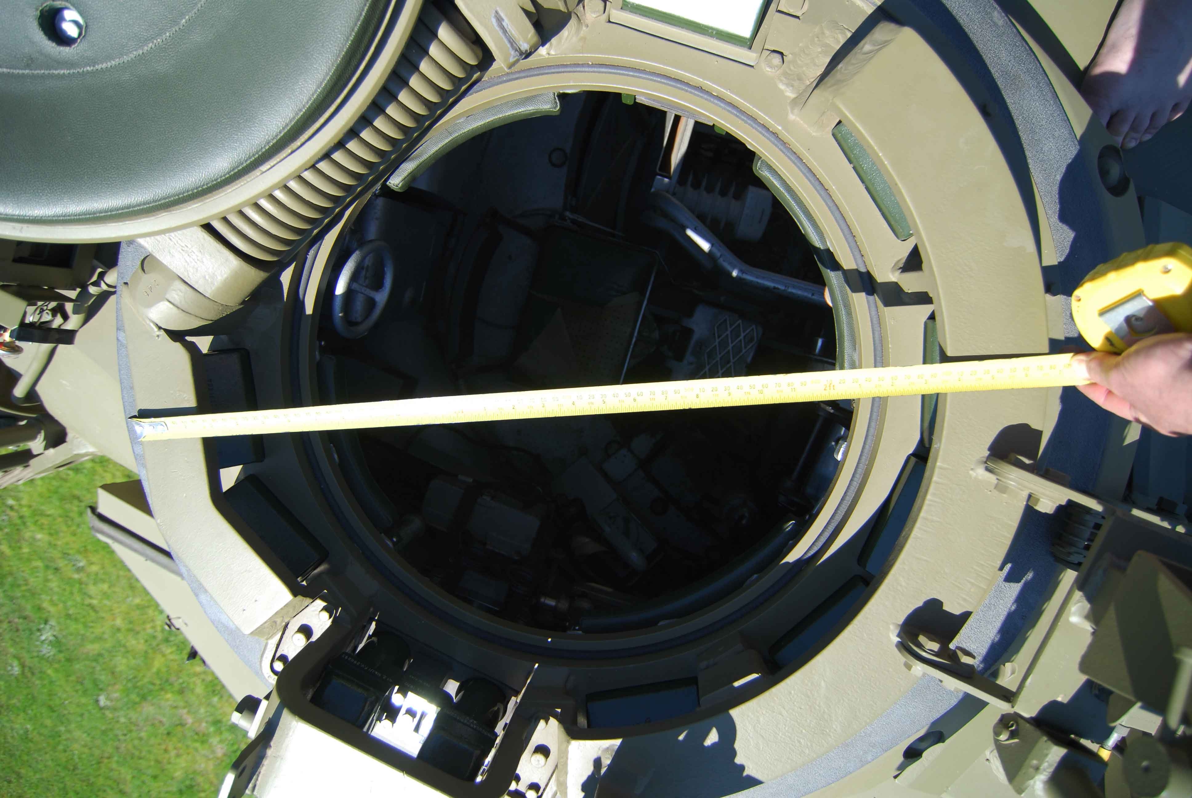

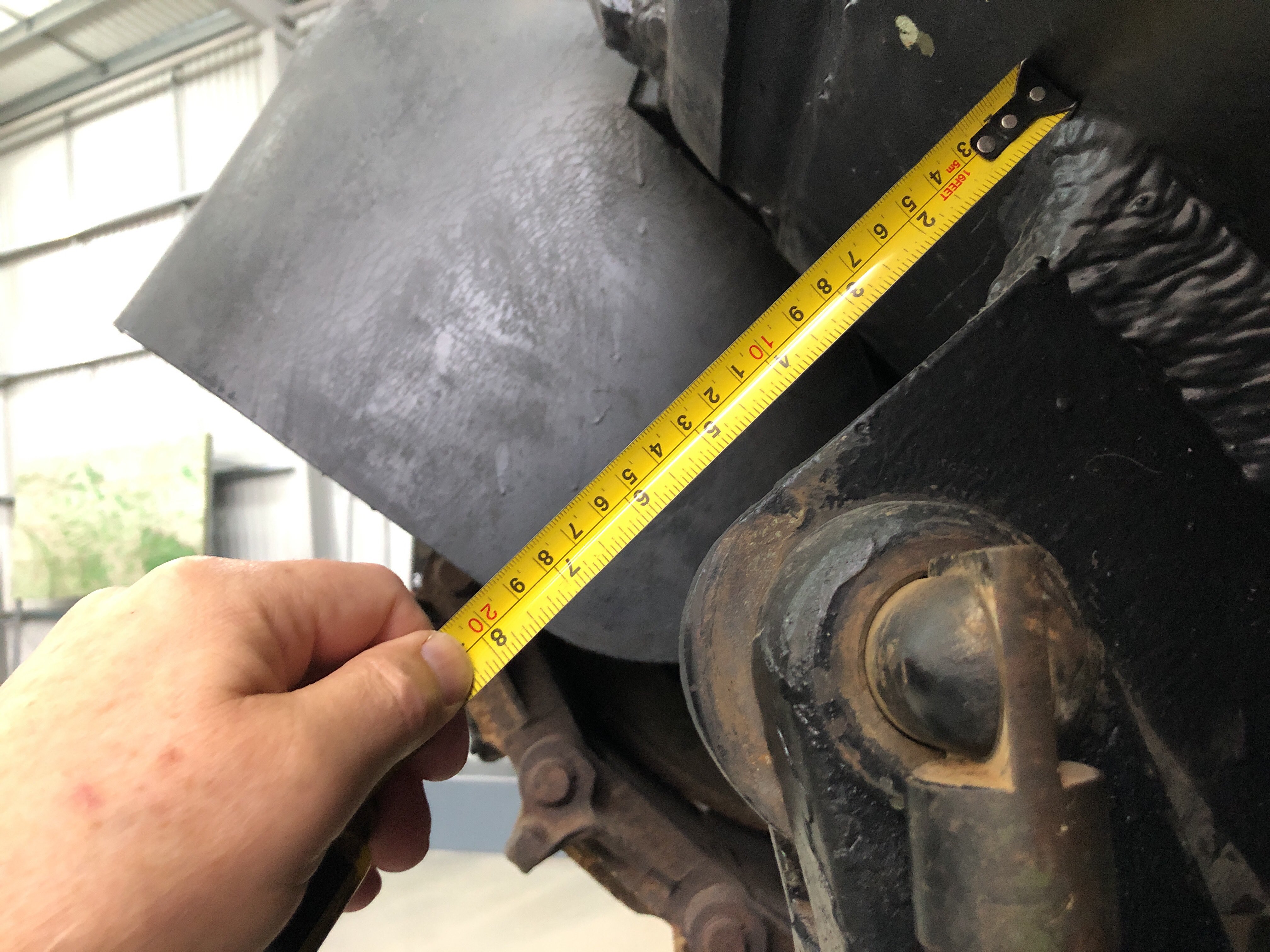

Measuring the real thing ought to be the most reliable method but is actually not easy. The problem is to record what the measurement represents, particularly on a curved surface.

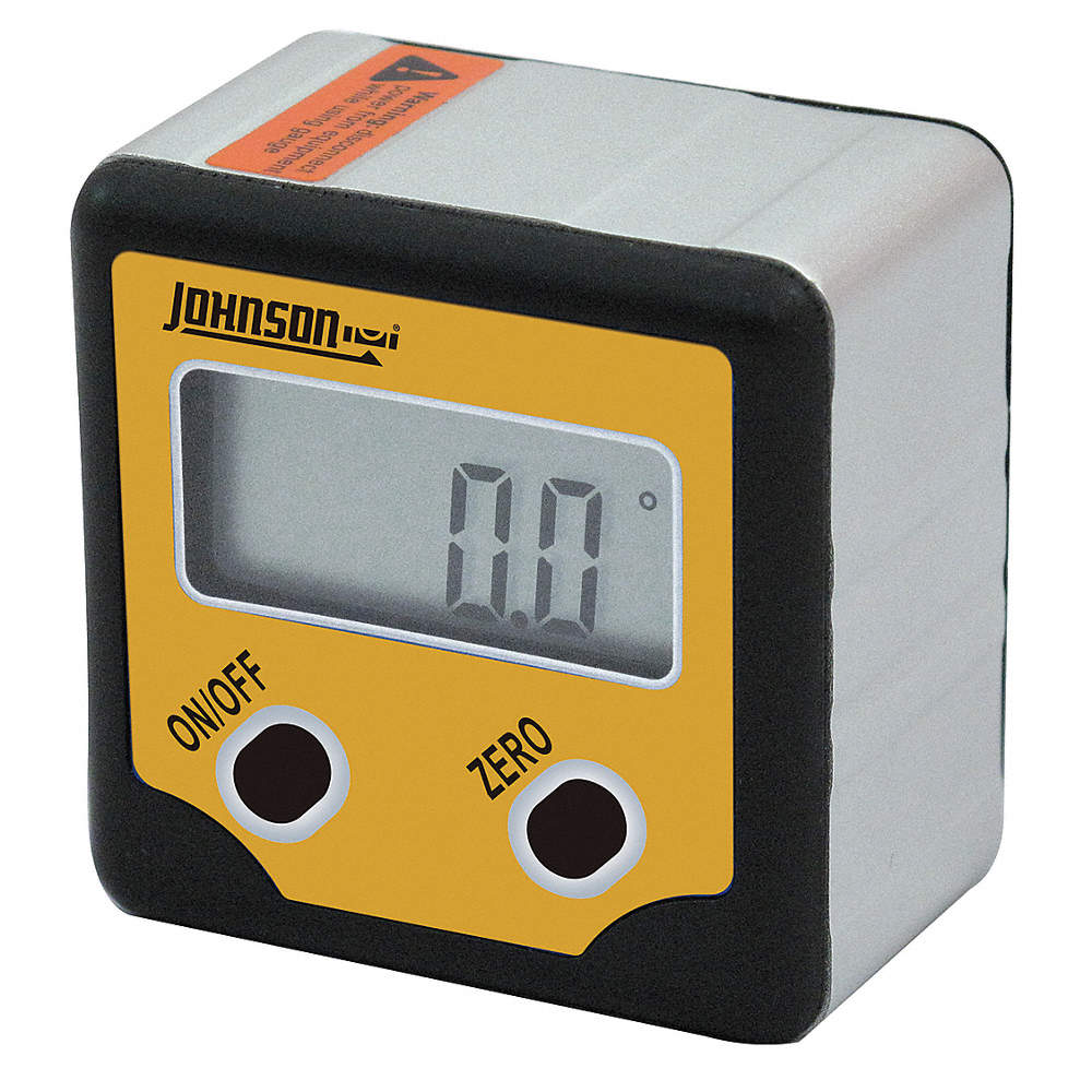

Measurements of angles tends to be easier to quantify than dimensions, using a digital angle finder or angle guage:
