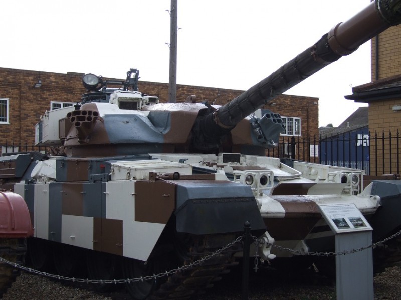

03 EB 20 as she is today with a new lick of paint but still a few details to be added

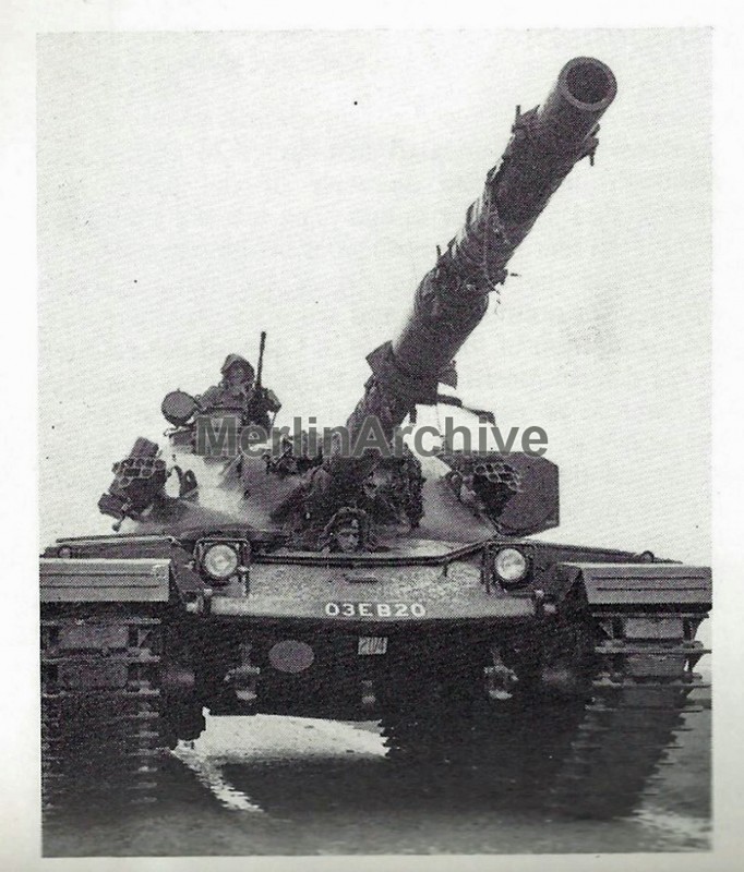

03EB20 was built by ROF Leeds as a Mk 2 under contract KL/A/217, which produced 355 Mk 2s between Apr 66 - Aug 69. It then underwent the TOTEM POLE upgrades. The X/Y mods (essentially TLS and MRS) made it a Mk 2(Y)L, Mk 2(Y)1 and finally a Mk 2(Y)2. It then subsequently went back to 23 Base Workshops Wetter, to complete the Z mods, which resulted in it becoming a Mk 6(L through to Mk6/4(C). This work would have been done in the late 1970s but you'd have to find the record card to establish exact dates. In the 80s, it went back to Base Workshops for installation of IFCS and APFSDS ammunition stowage, after which it was a Mk 9. Final major upgrade to install STILLBREW would have happened between 1982-84, after which it became a Mk 10.
I've put a lot more detail on the development history of Chieftain on other threads, so I won't repeat here.
It's not easy to tell at what stage this photo was taken but it looks like pre MRS, ie as a Mk 2 and the tac sign 20/4 refers to 20 Armd Bde which was stationed in Paderborn/Sennelager (possibly the worst lager in the world....). I'm struggling to make out the cap badge but if I had to guess, I'd say 16th/5th Lancers.
