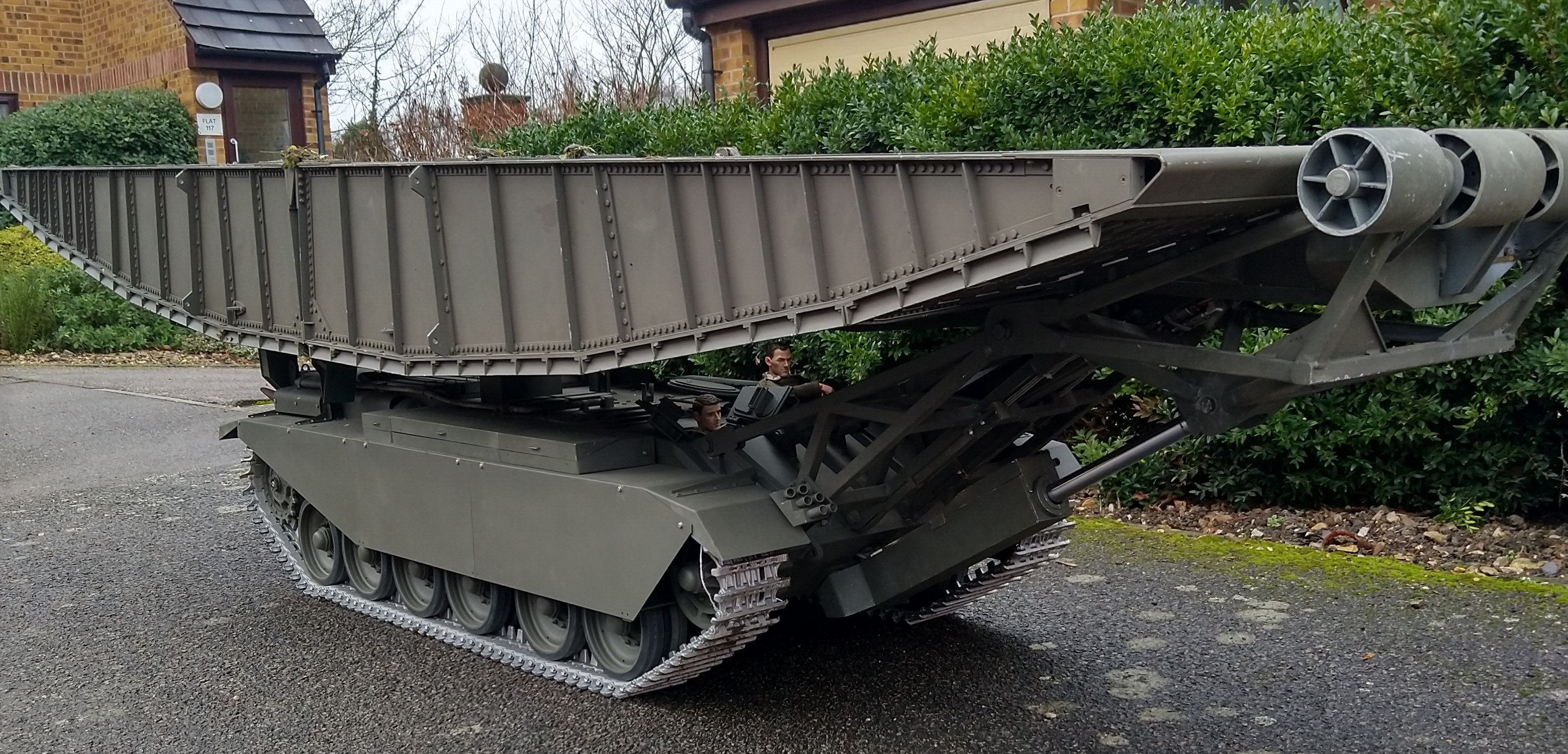

It's sooo big! I love it, keep the pics coming David. If you briefly edit the photos they should end up the right way up!

Dang that is huge! Love the picture - really puts it into perspective how tall that is! Fantastic work!

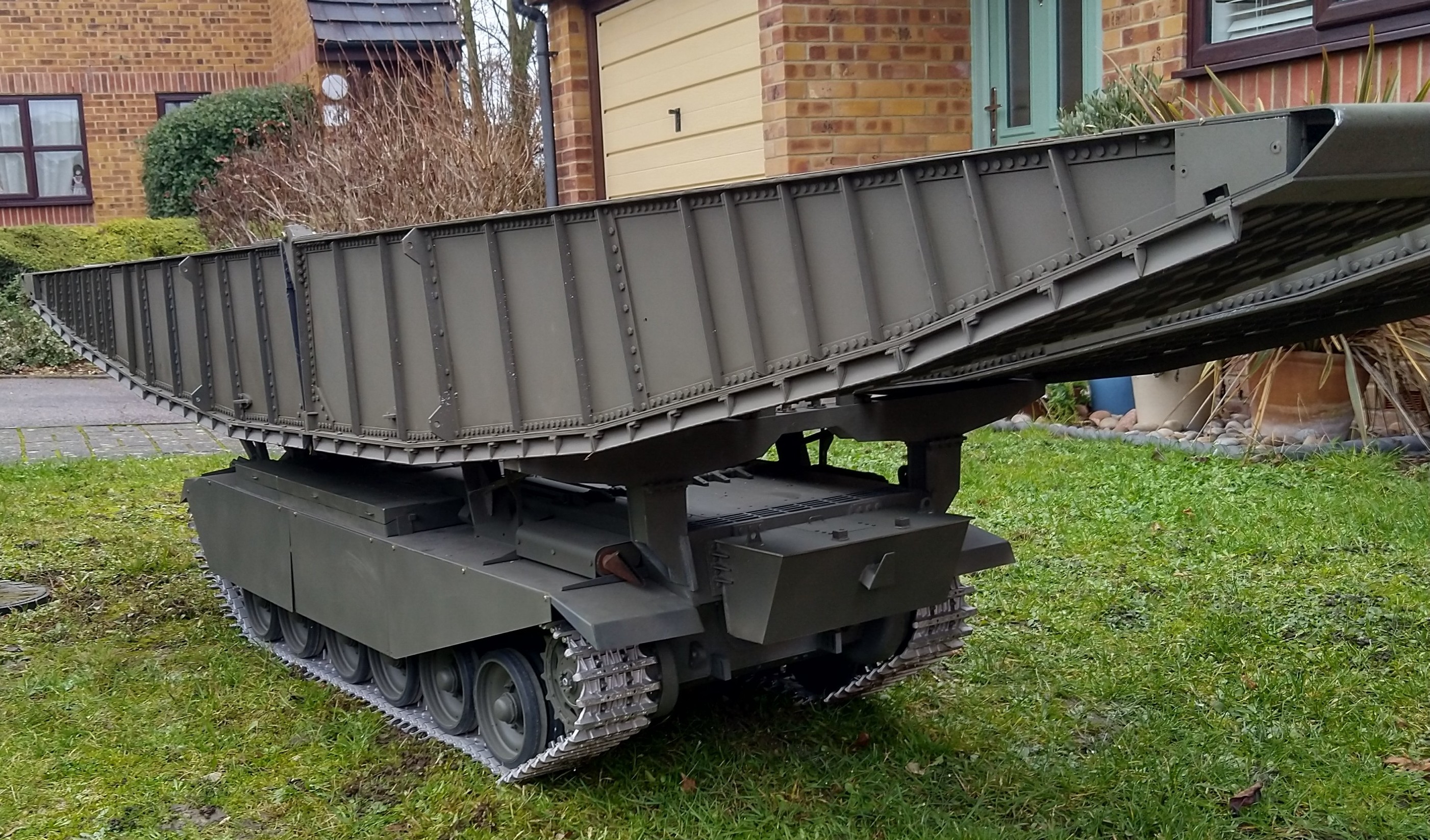

Looks super smooth.
More lead acid batteries needed in the hull at 3:30 though !!

Yes i need to stop the back end lifting so much. I am using smaller batterys this time so not so much internal weight. When i do the external fuel tank i will probably put some weights in it.

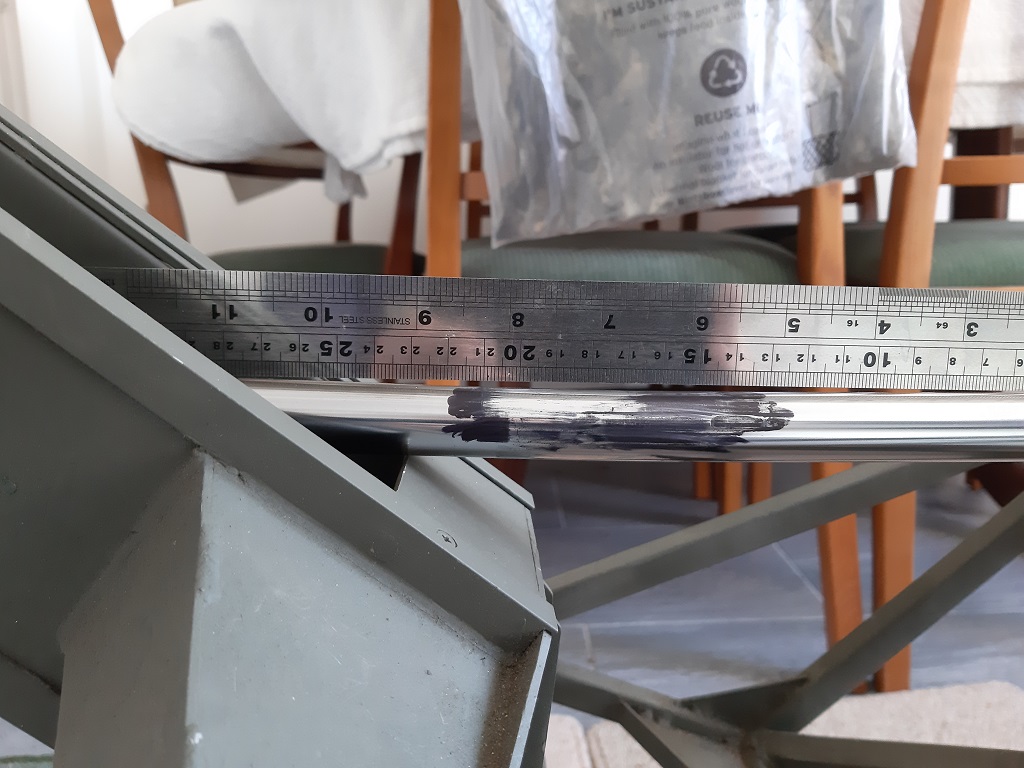

So, at the South West Model Show at Bovington, I had some performance issues
and wasn't able to get the bridge up to more than half mast (45 degrees). Cue the usual jokes about 'semis' and comments as to where to insert the viagra
After running through all the electronics, hydraulics and anything else we could think of, Chris Fry spotted that one of the ram shafts was bent:
Even though the ram would extend and retract without the bridge attached, it was audibly struggling as the bend passed through the end seal, and the added weight of the bridge meant the system stalled at the point that the ram tightened up.
I attempted to straighten the ram in situ using some angle iron, 3d printed spacers and a large G clamp, but only succeeded in bending the tommy bar on the clamp. Today I gave up trying to fix it in situ and removed the ram from the cylinder, thinking I could use my 1 ton bench vice to ease it straight.
No dice; once I started adding significant force, something in the work holding gave way and the whole thing sprang apart.
So, given that Plan B was to buy a complete replacement cylinder, I decided to trust in the power of the Norse gods...
So, working up from gentle taps to something somewhat more violent, I succeeded in straightening the ram, without marking the shaft.
Having reinstalled everything, the ram seems to move freely, without the juddering which was happening before.
Unfortunately, the weather is too dismal for me to build the bridge and test it.
As with some jobs on these tanks, it fought back:
But seeing as there is hydraulic fluid all over the floor, I think this match ended as a one all draw.
The irony is not lost on me that, now the ram has been out of the cylinder, I need to bleed the whole system

Who says we don't suffer for our hobby? Looking forward to seeing another erection raising of the bridge at Abingdon. Glad you were able to get the ram to see sense. It proves the old engineering adage that when in doubt, select a bigger tool. Works in all sorts of contexts........
