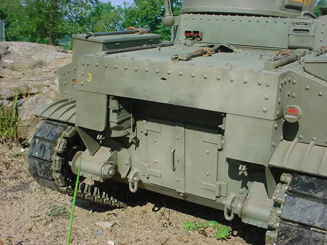

I've been making the leather straps but ran out of strips (only had one to begin with). It still needs 6 more little straps for the tools and I'll get'em done as soon as my order gets here. I've been weathering it but the scuffs, wear, streaks, etc. don't show up too good on here. I figure this M3 is about 98% done (but you know detailing NEVER finishes!) so I decided to take some pics.
Now that this build is complete I suddenly realized I'm OUT OF A JOB! After coffee and the news I usually head out to the garage and get busy! I better think of something or my little sweet MSgt (ret.) wife will DEFINATELY think of stuff for me to do!!…
I have this Panzer IV I built about 3 years ago and it still only has the base color... I think I'll get busy marking/weathering IT!
Anyway, with my simple skills (and LOTS of BEEER!) I did my best on this M3 Lee build and tried to make it look halfway decent...

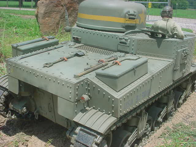

Here's a few more I took this morning. This early sun helps show more of the weathering and 'wear' I tried to do and if I had a better camera you could see more.

Thanks So Much for the kind words, you don't know how much I was worried about painting it. I enjoy building'em but the painting, marking, weathering, wear, is what I absolutely dread because I'm an IDIOT when it comes to paint details.
On the colors, I used Testers 1265 Flat Olive Drab for the overall spray but that's what I used on the Sherman. I didn't like how they were 'twins' in color so I somewhat figured out how to use this airbrush and sprayed less than one bottle of the 'Faded Olive Drab' (mixed 50/50) all over this M3.
For markings I didn't like all the BRIGHT yellows I could find but then remembered I DID have half can of CAT yellow, which is a deep, dark yellow. So after I had everything taped off, I sprayed. It's gloss but a later spray of tan spray 'dust' gets rid of the gloss. (I know I should hit the turret markings one more time but I'm lazy!)
Then it still looked like a CLEAN, new, faded M3... SO I had a 'few' cold ones out of the garage fridge (just to loosen up my spray arm ya understand), then held the can of tan camo spray about 18"-24" away and made fast side sweeping sprays, mostly low. When that was practically dry I used a wide house paint brush to make downward sweeps for streaks. That tan makes pretty good permanent 'dust'!
For the 'wear' I dipped my finger in a little dirty black thinner, rub it between my thumb & finger, then when it's almost dry rub it around where the crew would walk. Any shiney parts like the corner of the turret corners, commander MG turret rim, and tool box edges came from just rubbing them a LOT with my clean bare hands. In the mornings and every time I walked by it I'd just rub my fingers and palm against it for a second. That shines up the corners great and it looks like they've been worn. (and I still do that with the Sherman. Can't have too much 'wear'.)
Just wanted to share about how I stumbled along and painted this M3. Again, THANKS for the encouraging words on this build!
