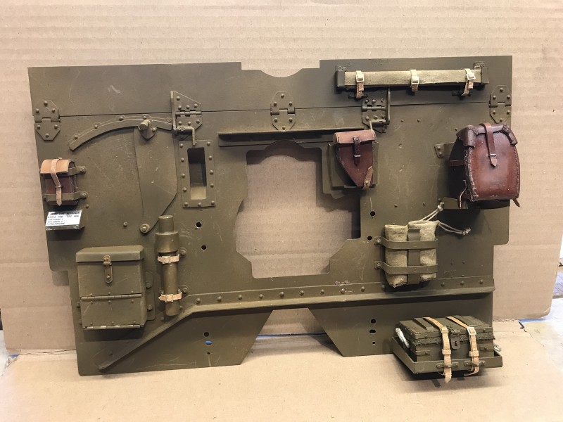

Post by Jeffrey Goff »
last of the brackets for the rear of the shield made and fitted, fuse indicator represented by a piece of brass strip, and housed in its canvas case, still have lots of leather straps to make, then on to the front of the shield
regards Jeff

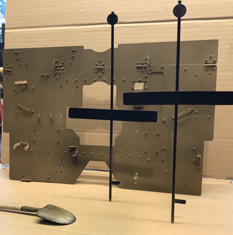

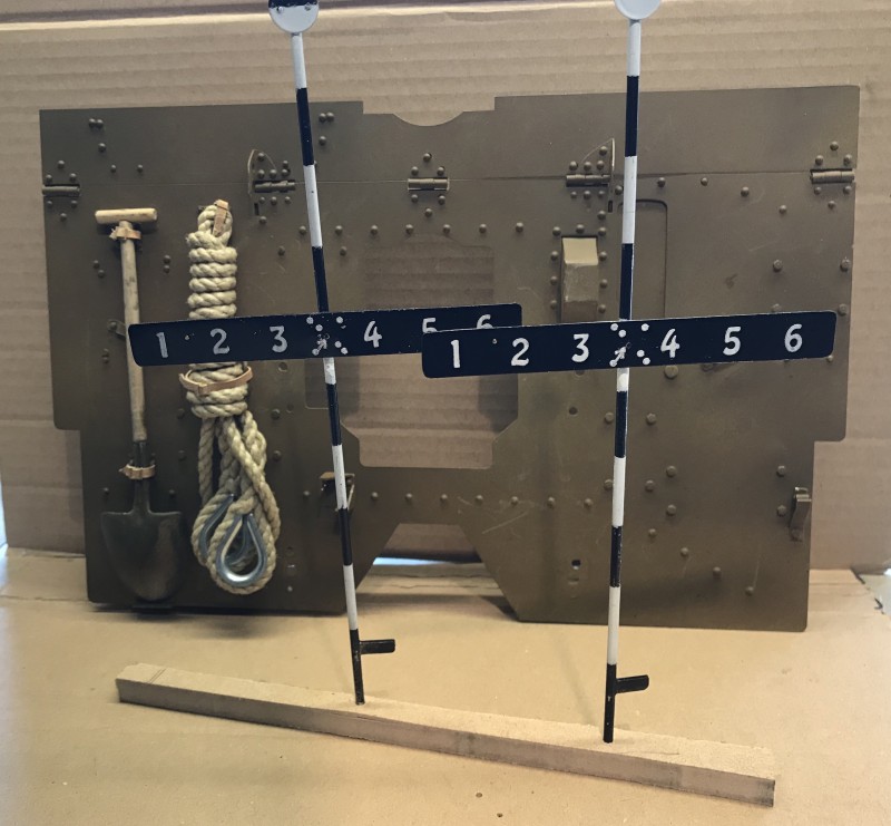

finished detailing rear of the shield, and made a start on the front, the aiming poles and brackets took a bit of head scratching, to get them to be functional, just the white numbers and banding to do, also made some of the tools, and remade the brackets for the pickaxe head
regards Jeff

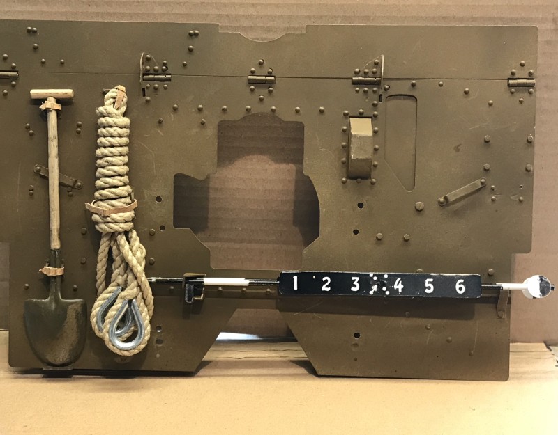

Thanks Stephen, not many updates to come, all the main elements completed, just straps and a couple of tie downs to do, finished the aiming poles, these have steel shafts and arms, used the kit shovel head but with a wooden handle, and fitted one of Dave's drag ropes
regards Jeff

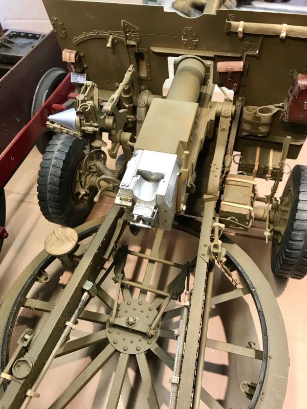

The 25 pounder is now finished, although there might be an update if an ongoing project comes to fruition, its has been a very enjoyable build, light and easy to work on, and plenty of scope for detailing, plus plenty of help and encouragement from the forum.

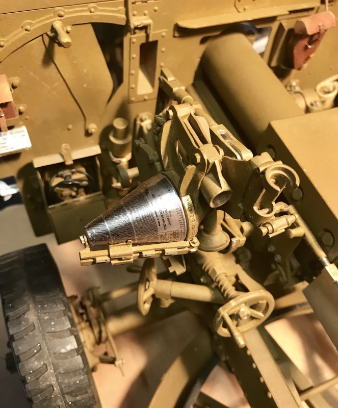

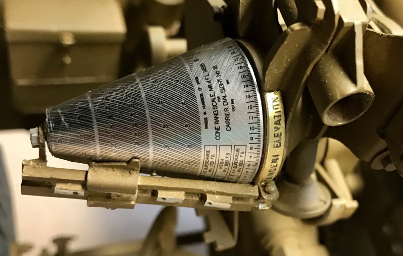

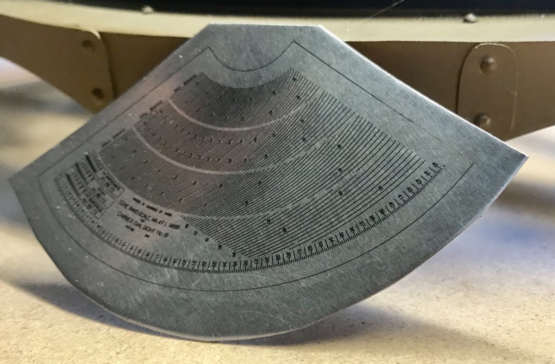

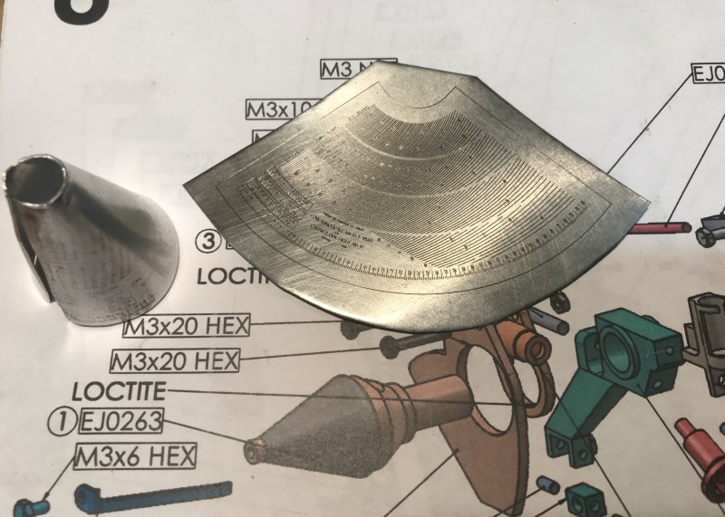

in my last post I mentioned there might be an update, during the build of the ranging apparatus I asked if anyone knew how to add the ranging scale to the cone, well one of our furum members from the other side of the world, Liam Mahoney took up the challange, and today I received the first sample, and it is fantastic, it will be laser engraved on steel shim, and will need to be trimmed to size and fixed, I am very pleased with mine, if anyone is interested in one let me know, cost will be approx £16 plus postage
regards Jeff

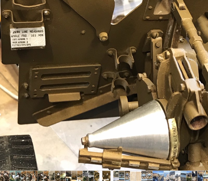

Thanks Vince but Liam takes the credit, I thought I would add some more detail for whats on offer, the range scale will be produced by laser onto steel shim, this will need to be trimmed to size and rolled around the plain alloy cone on the Armortek part EJ0263 and fixed in place, the sample that I tested had a spelling mistake, ( no E in range) this will be corrected and slightly thinner shim used to make it easier to roll
a couple of pictures of my 25 pounder before and after fitting the range scale
postage will be from the UK
regards Jeff

Jeffrey Goff wrote:
Fri Apr 05, 2019 4:39 pm
Hi Michael, thanks for the information, I had missed making the sight clinometer pouch, do you have a picture of the pouch or container for the fuse indicators, that was stored on the top right rear of the shield, above the dial sight.
a bit more completed, made the Apparatus, Illuminating, sights No5, that bolts to the slotted bracket on the bottom left rear of shield, made from steel with brass hinges, also made the two canvas bags that hold the barrel pull through' s
regards Jeff
Hey Jeff.... what is 'in' this box? Looks like a wiring harness of some kind? Something to do with trailering? Hydraulic lines for recharging the cylinders? Communications equipment?
Going to make up the box on my Thursday 'day off.'
Also, what does the plaque above it say?
