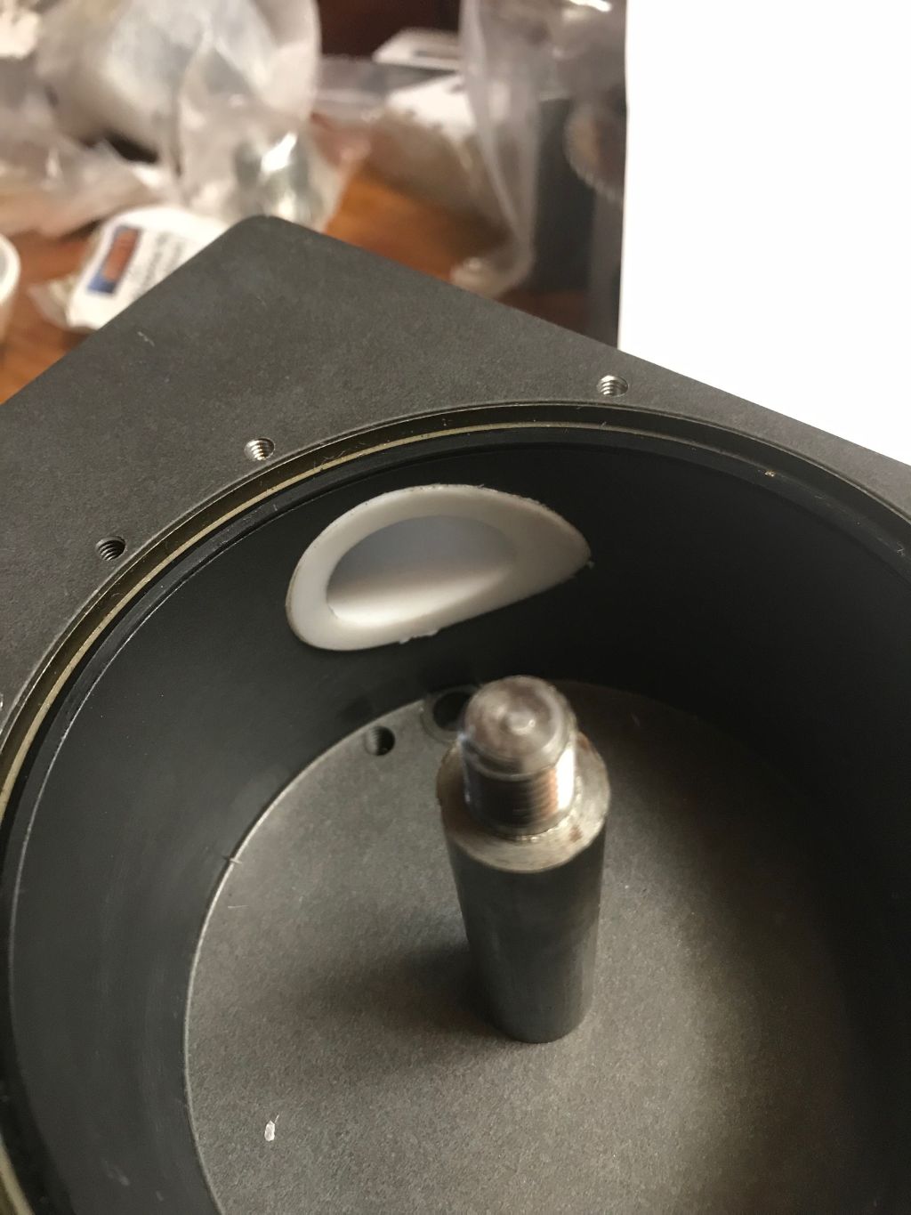

Hi I have a question about the plastic insert, should this be removed or filed down?

Re: Panther Blank Firer
Yves,
Thanks for the reply. But this plastic piece sticks out about about 1mm and prevents the barrel from sitting in the housing. I’m not sure if it’s glued in and I really don’t want to force it in unless I get the ok to do so. Did you have to push yours in? Your help is greatly appreciated.
Hello Weal,
For me it was no problem that the plastic white piece sticks a little bit out of the housing.
My drum turn ok in the housing.
If you are not sure you can use a bit of sand paper and sand it down a bit.
Hope this helps you.
Best regards Yves
the Teflon is not glued in and can be pushed out as i did on my tiger 1 i then used a fine sand paper wrapped it around the drum and shaped it to seal better its a seal from the drum to the gas port. I commercial found blank ammo here in the us that fits the system. I also made 6 brass shells that could be reused after firing.
