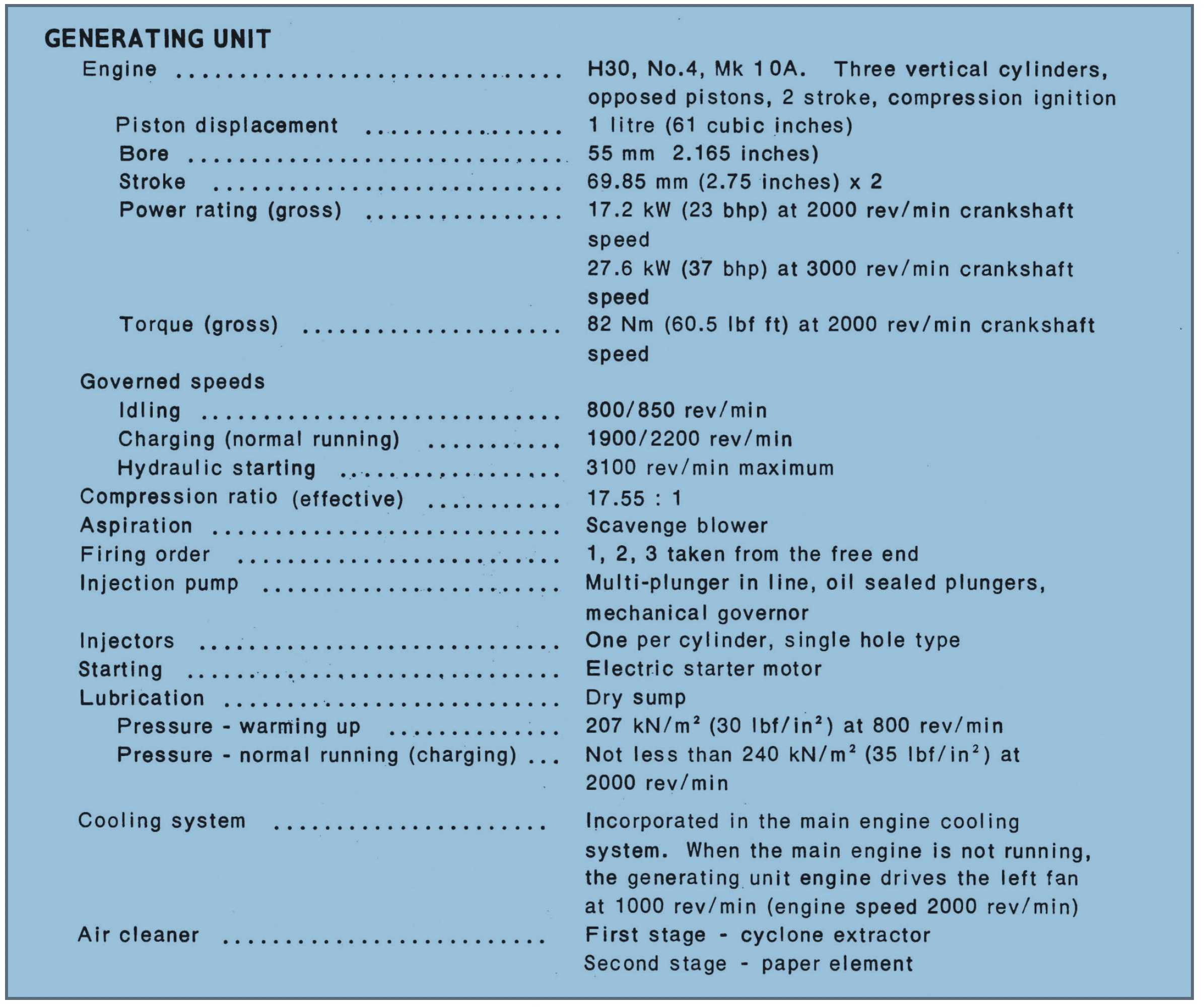

The Auxiliary Engine or "Donkey engine" as it was commonly termed was a diesel 2-stroke Coventry Climax H30 with 23 HP.
The speed was controlled by a hand operated lever. It was normal to give it a couple of minutes to warm up before moving the lever to full speed and then putting the generator under load.
The generator was rated at 150 Amps so helped assist the batteries when starting the main engine especially in cold conditions, and also was sufficient to supply the systems when in an overwatch situation and the main engine could be shut down to preserve fuel, or when static to run the BV or recharge the radio batteries.
The generator on the main engine was rated at 350 Amps. Normally the Aux Engine was left on when the Main Engine was running, just in emergency case of the Main Engine Generator stopping functioning.

More properly the "Generating Unit Engine" or GUE, sometimes called the "Genny". The H30 Mk 4 No 10A was introduced on the Mk3 and was one of the few major components on Chieftain which didn't require much modification throughout the life of the tank. There was a complicated and unreliable hydraulic start system for the main engine which was rarely used. The ME wasn't started on hull batteries, so the GUE was invariable started in order to provide ME start. Thereafter as Mark says, the electrical power generation was shared between the GUE and ME generator. The GUE exhaust was moved to the upper right of the exhaust box on the Mk 2 and it produced a very distinctive and separate sound to the ME exhaust. At idle, the GUE sounded like any other small diesel but under load, the exhaust note was a constant but raucous howl. I would like to see the Armortek model offer a separate special sound for GUE start but if it's not offered, I'll be looking to create a bespoke set of sound files as I did for the Centurion.

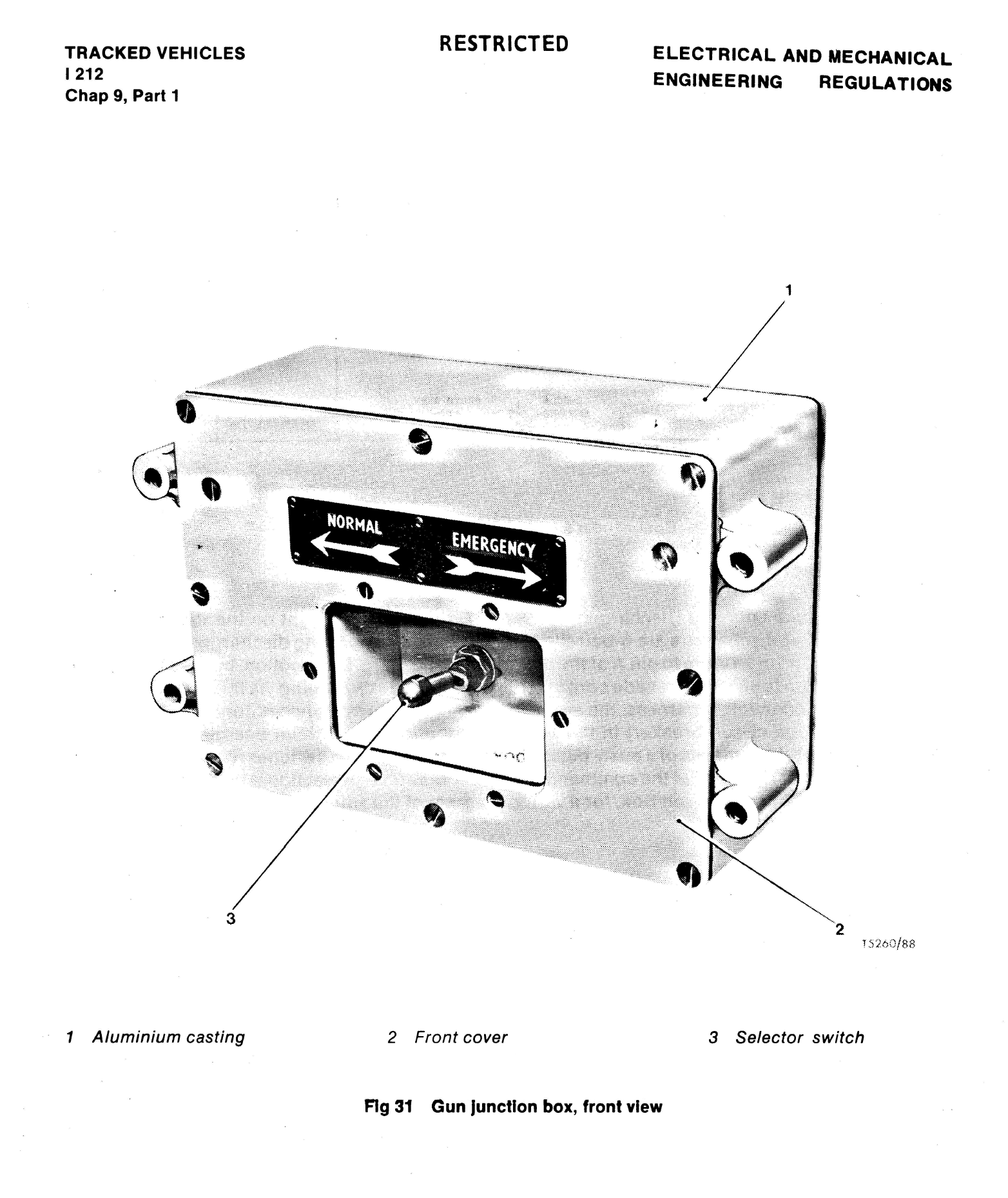

As a final resort, there was a lever on the Turret Junction Box, called the OMC (Overriding Master Control ) which when operated would physically connect the two sets of batteries, operate the relays and theoretically enable the crew to fire a few more rounds from the now disabled tank before abandoning it. We termed it the "Oh My Christ switch"

In a battle situation , the only thing that could completely stop the main gun from firing was insufficient voltage to trigger the vent tube. I cannot remember whether Chiefy had it, but Challenger 1 had an emergency battery under the gun which could be switched in and fed only the vent tube circuit to get a few more rounds down range even if all other battery power was lost.
