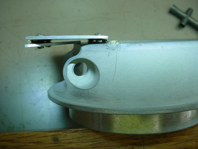

Well that was a bonehead move on my part. I cut the new hatches this morning with the mid break further back. I DIDN'T take in to account the thickness of the hatch when it goes to fold over then under the front hatch. The rear half moon hatch, when it's folded under the front hatch, makes 6mm together and that's too thick for the height of the hinge pivot point.
So, if I'm going to put a commander in that hatch, it'd just be best to use the original hatch and only fold the rear half moon hatch over the front one without having both open all the way. With only the rear open there'd be enough room for the commander (Ed Harris) to be in position comfortably.
OR I have a sheet of aluminum 1.60mm thick that would be closer in thickness to the hinges to be able to (maybe) fold the rear under to open all the way. I'll give that a try and let ya know how THAT turns out soon. (that 1.60 will be a lot easier to cut/trim than this 3mm!)
Mike (the King of the Boneheads in Kentucky!)

Looks like on the real ones, the hinges fold into each other, so the bolts don't clash.
Could it be the button heads which are hitting each other ? Could you swap them for CSK instead ?

I was thinking about using those CSK screws too. Those button heads are pretty tall and I'm going to look thru my surplus stock and see if I have any single slot screws. And tomorrow morning I'm going to go ahead and cut this thinner aluminum to see if those will work. I'm having fun building this M3 and do as much as I want to because I have all summer.

AND, this morning I cut the 1.60mm aluminum sheet in to the two hatches and they turned out PERFECT! I didn't have any tiny single slot CSK screws so I used Philips heads. The botton heads were too tall for the hatches to close but these flush ones clear everything.
I kept moving the crease toward the rear and now it folds great! Just to be sure I only used one screw (instead of the two) in the center of the hinge. I was just 'Eyeballing & Figuring' (SWAG) on where to put the final crease, checking on where the small hatch would fold under the larger and contact the hull, and I cut'em that size. The front hatch, front to back, is 42.92mm wide.
I still have cut the two hatch supports (look like little horns) that are on each side, then the folded hatch will fit more level but it don't look too bad now. But Commander 'Ed Harris' seems to like it!!
Mike

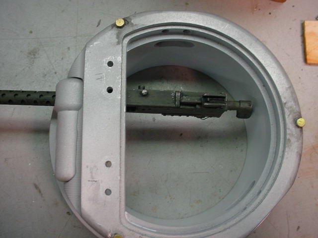

Looking good Mike. That cupola is tiny though. Where is the back end of the .30 cal MG going to go? Loks like it would have to be dismounted if the CDR is standing in the hatch?

When you see a commander in the cupola with the MG mounted, they're usually standing at an angle:

THANKS Bob & Adrian for being so 'observant' about how tight the MG turret is. Something I didn't think about... SO I legged it out to the garage and checked... and you're right. (Maybe Commander Ed Harris is just REALLY slim?)
The M1919A4, in the pivot mount, hits the rear of the little commanders turret even before the mount is all the way in. I initially thought about putting the turret in my LITTLE lathe and dishing it out 'half moon' in the middle because the sides are thick. But with MY extremely basic skill with my lathe I deduced THAT was a VERY BAD IDEA! I'd probably be ordering a new turret or going to the Emergency Room or BOTH!
So I figure I could cut a square notch (the width of the MG) in the back of the mount. I might try that. Also I thought about trying to redo the hatches again but that would take a lot to make ANOTHER set so I'll just stick with these.
Mike
