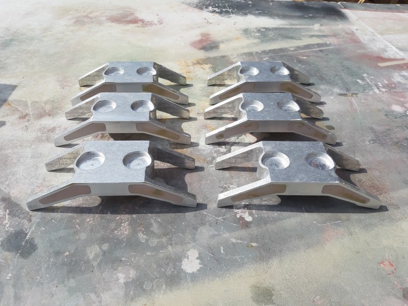

So far I've filled the suspension arms (M3 left the factory with solid arms rather than the pocketed ones on the M4):
They were filled with P38 car body filler, then topped off with Upol Glaze to get them absolutely smooth. I still need to re-profile the ends, flatten the underside of the spring pockets and add the bolt head for the slider pad.

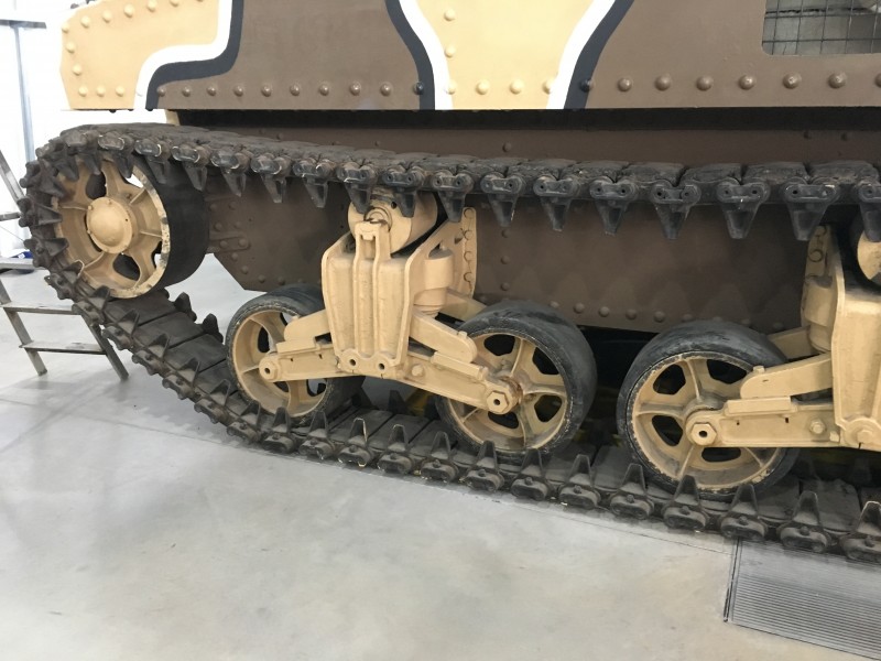

Disagree with you about the suspension arms Adrian

Hi Pete
Surly the part Adrian has filled is the part that goes on top of the slide pads
in which case he is correct no slots.
If its the actual moving arms then you are correct it has slots :oops:
As per your photo.

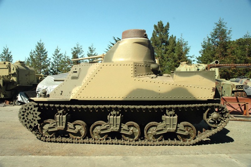

its one of those tanks that there seems to be a lot of parts sharing on the bogie/wheel set ups etc,
[attachment=3]9268312078_4b85f1e3a2_b.jpg[/attachment
Has liked: 1492 times
Been liked: 1699 times
Re: Adrian's Grant #2
Indeed, though restorations tend to scavenge more widely than would occur in WW2.

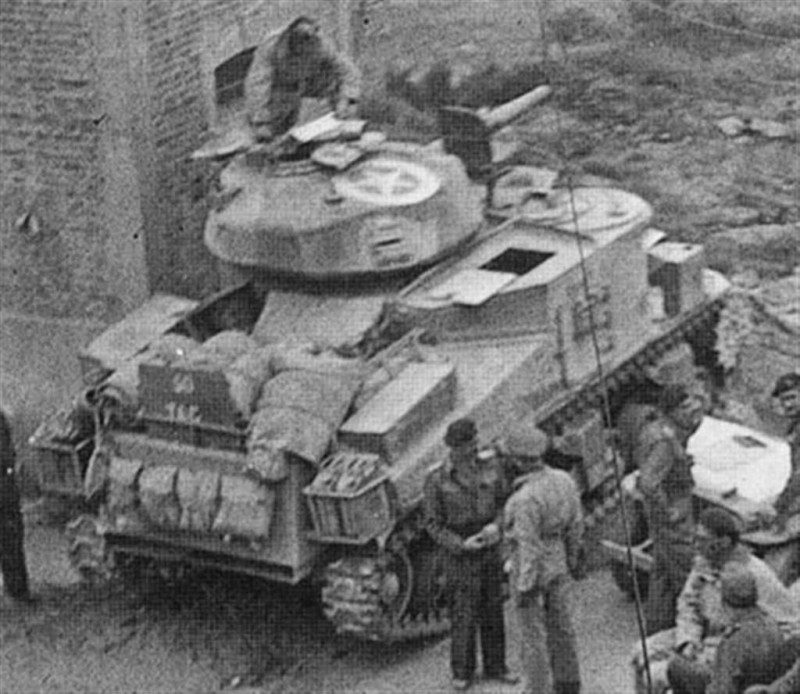

Another view of the same tank A Star on the turret roof to let American Pilots know it 'one of ours'.
Otherwise.....No Star it not ours, shoot it up....
The image is said to have been taken in Sicily, which may account for the absence of Dust Shield and different tracks Also, it looks as if its German 'Jerry cans' in add-on racks over the idlers, as well as a smaller stowage locker on the right side.
And, is that a totally different exhaust arrangement?
Another thing I've noticed.....There is what appears to be a rolled up canvas on the rear deck over where the grill for the engine cooling air intake would be. If so the normal modified aircraft radial engine would overheat. It suggests that this tank is one of those fitted with the General Motors Diesel Engine and is an M3A5/Grant II?

The flat rear plate with the slot at the bottom is certainly indicative of it being a diesel powered tank.
M3A3 and M3A5 had vented access panels in the centre of the engine desk, the same as the Sherman, so it would be behind that canvas.
Maybe the rear stowage has just been dumped there after a night under canvas ?
The radial engined M3/M4 had a bad reputation for generating such a vacuum in the engine bay that they sucked air in from the crew compartment. Handy in the summer, fatal in the winter.
Also, because they vented the cooling air out under the rear hull plate overhang, they created their own ghibli from the dust stirred up by the tracks.

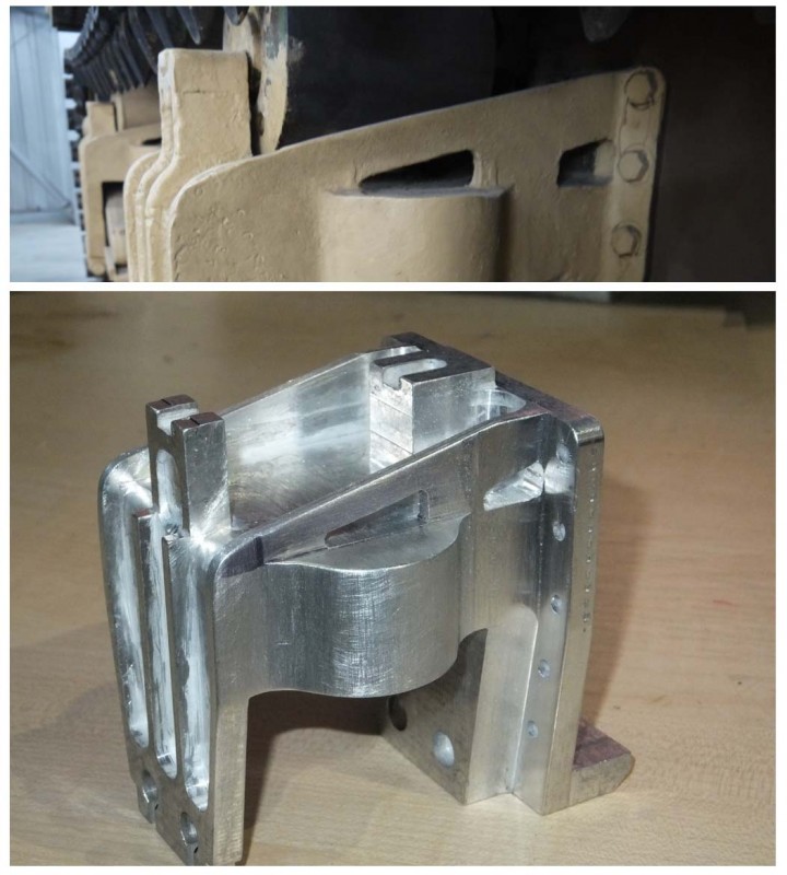

Whilst at Bovington yesterday, I dropped in to see their M3 Grant, and take some measurements of fasteners etc. Having seen the tank close up again, I decided I had to attempt the cutouts in the ribs on top of the bogies, as it's quite an important detail and will be visible between the tracks, especially in a Light Stone colour scheme.
Having marked out the shapes by hand, I chain drilled the main parts of the holes, then used needle files to link the holes and open out the cutouts.
The one at the back is the hardest, due to the material left behind in the radius from the main machining. I think it needs to be a couple of millimetres higher, to bring the profile more in line with the original.
I've found a Dremel on high speed and with a gentle touch will remove more material than the needle files, so will give that a go on the next one.
1 down, 11 to go :roll:

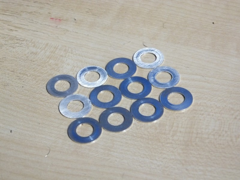

A couple more sets of parts off the lathe. Lucky I saved the CNC programs from working on Shermans :lol:
12 replacement axles, including a better representation of the outer bolt head, plus the central hole. I did ponder threading this but the ones in the Grant didn't appear to be threaded, unless they're just covered with years of successive paint jobs.
And a set of 16.2mm diameter by 0.75mm thick washers. Purpose to be revealed later :wink:
