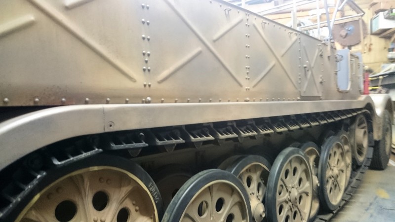

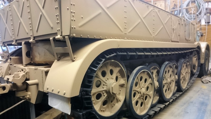

Top coat on the body and the wheels, weathering process started.
Starting to rub it back
Top coat still tacky
There's a long way to go yet

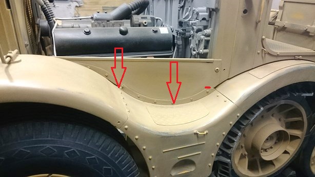

Is the curved stripe plastic or metal?
Re: Phils Famo build
Hi Chang, well spotted. It's plasticard you could use very thing brass and cut with scissors but .7mm plasticard is very convenient, it being translucent so you can trace the outline. The original 1/1 had it to cover the discrepancy gap between the fender and the lower engine cover, and I had a big gap left over from fitting the removable side engine covers up a tad to fit the bonnet correctly.
A good expedient would be to draw around the lower side cover profiles on a piece of paper (use your build manual spare page so that you keep it safe with the vehicle as every one will be different) and use that accurate profile to make the fillet piece later on when you have assembled your fenders.
Some vehicles also had a rubber (split tube) capping that was fitted between the upper hull lower joint between the long rear fenders but I have not added that as yet.

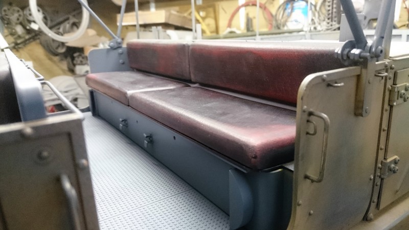

Thank you gentlemen much appreciated, There's light at the end of the tunnel for this build. Got quite a lot done today, after the gym tomorrow I will finish the dash and weather the crew areas.
Still working on the dash

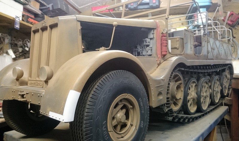

That's the extent of my weathering so far , chips and scratches next, then shading.
