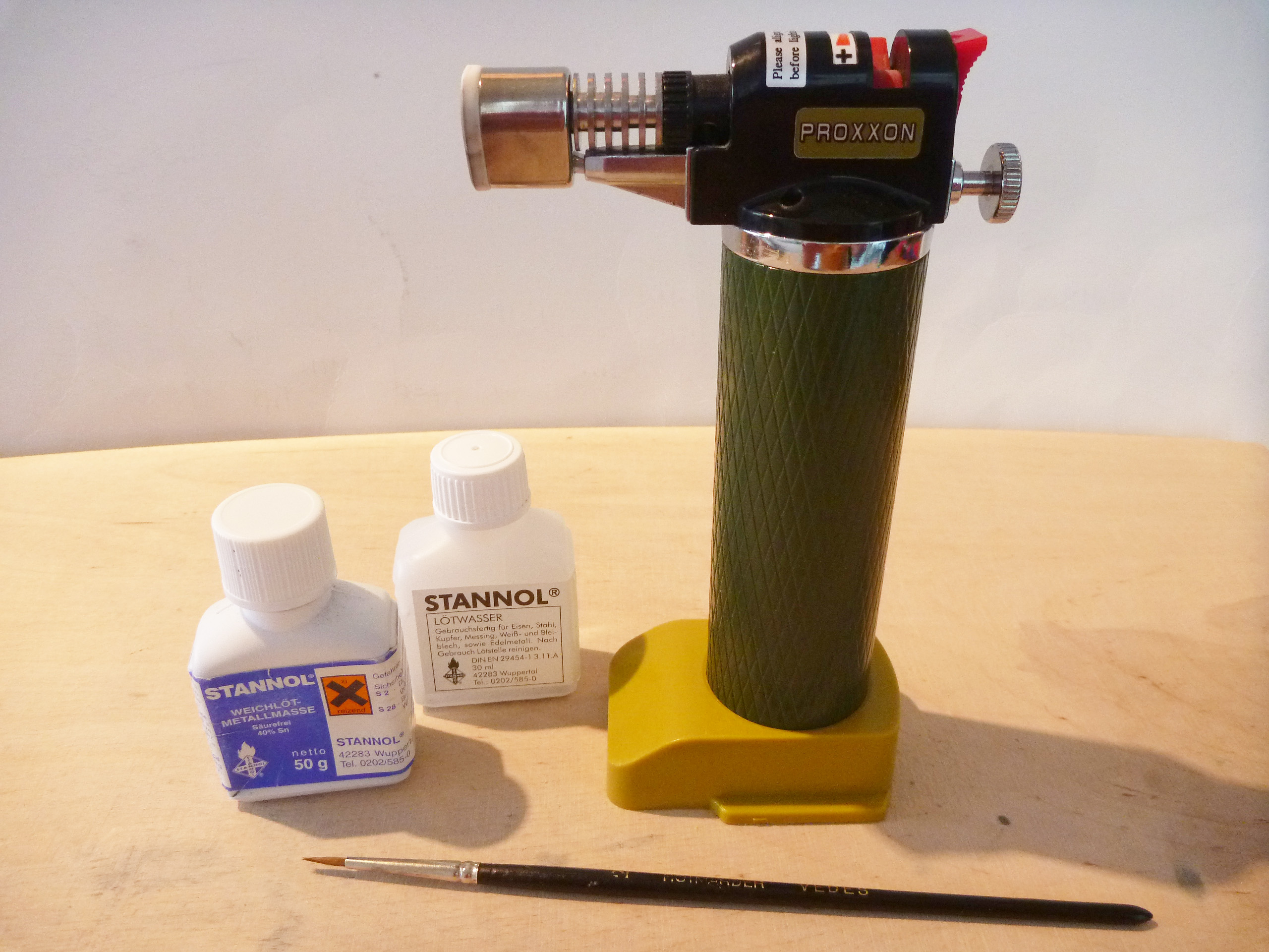

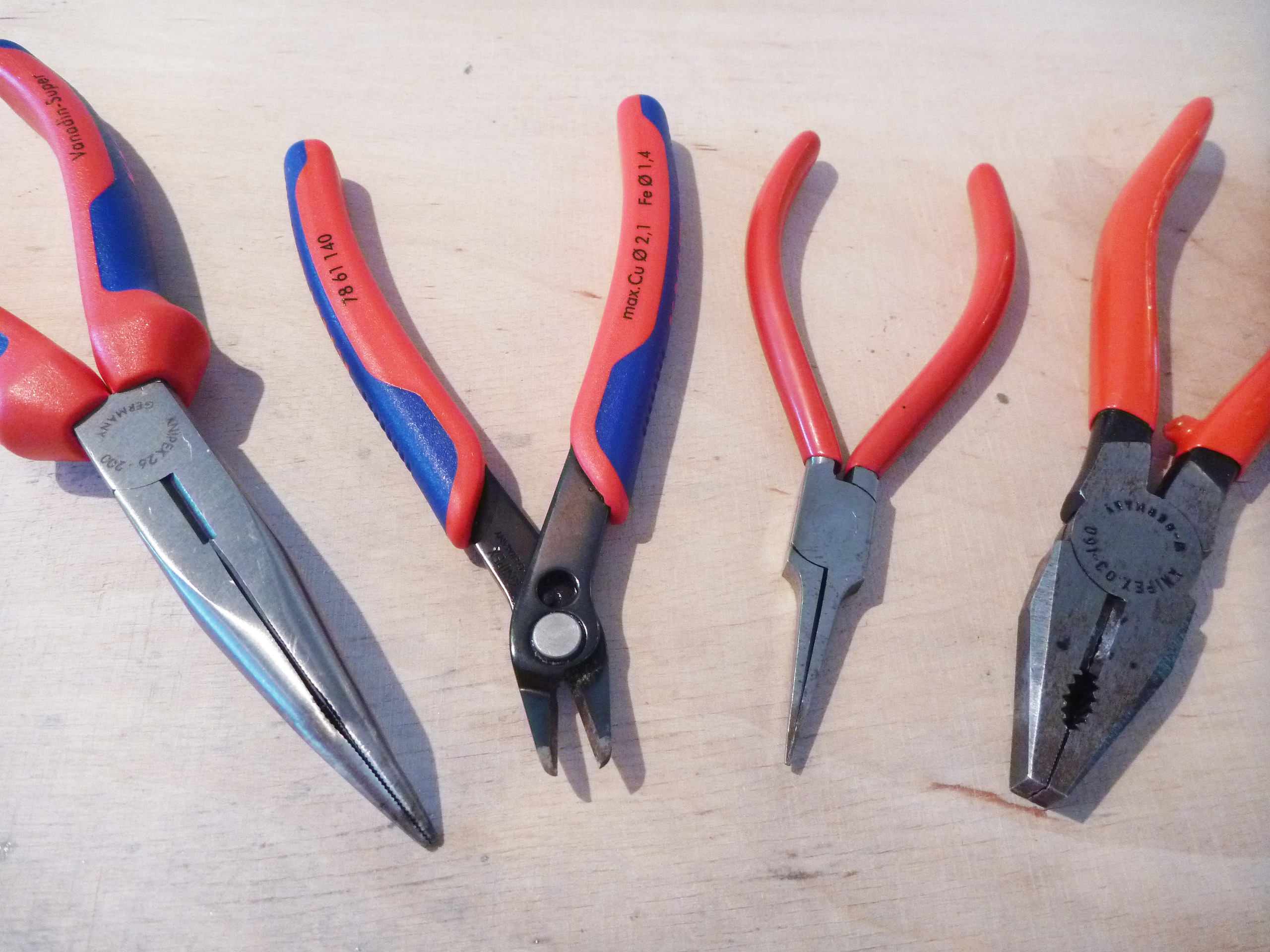

Here is the tool I use:

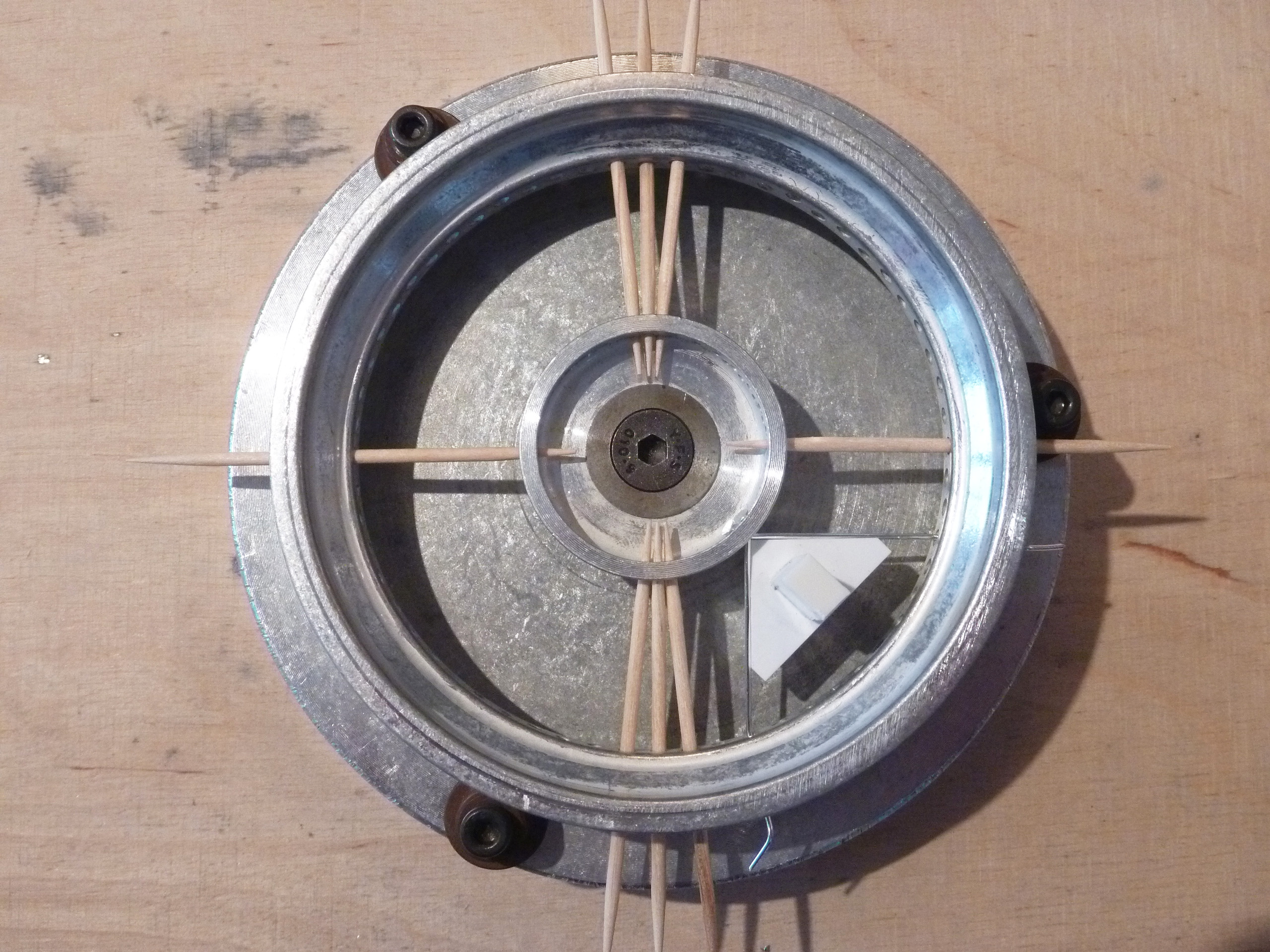

I build the single wheels first.
I start every wheel build by adjusting the wheel hub and rim. The rims are not the same as the outer hole row with respect to the inner row of holes. If you do not adjust all the stitches the same, the spoke pattern differentiates slightly for each wheel. I also gave each wheel side mirror images. So that on each side the wheels show the same spoke direction. To make the adjustment, I use ordinary wooden toothpicks. With the different holes wheel hub / rim, upper and lower row of holes, there are various possibilities. The results in the spoke image are slightly different. I am in favor of the wheel hub / rim adjustment seen in the pictures - lower / upper
When everything is adjusted, all screws of the mounting plate are tightened. I start with the inside. This must be properly tightened. It may be, it moves again with the outer ring. That does not matter. The provisional "wooden spokes" take the rim in the right position. Tighten the middle screw. If the wheel moves during assembly, it can not be retracted and the already mounted spokes loosen.
I attach a few wire test spokes and measure with a small self-made angle level if the adjustment wheel hub / rim is right. If everything fits, the assembly can start.
Greetings Michael

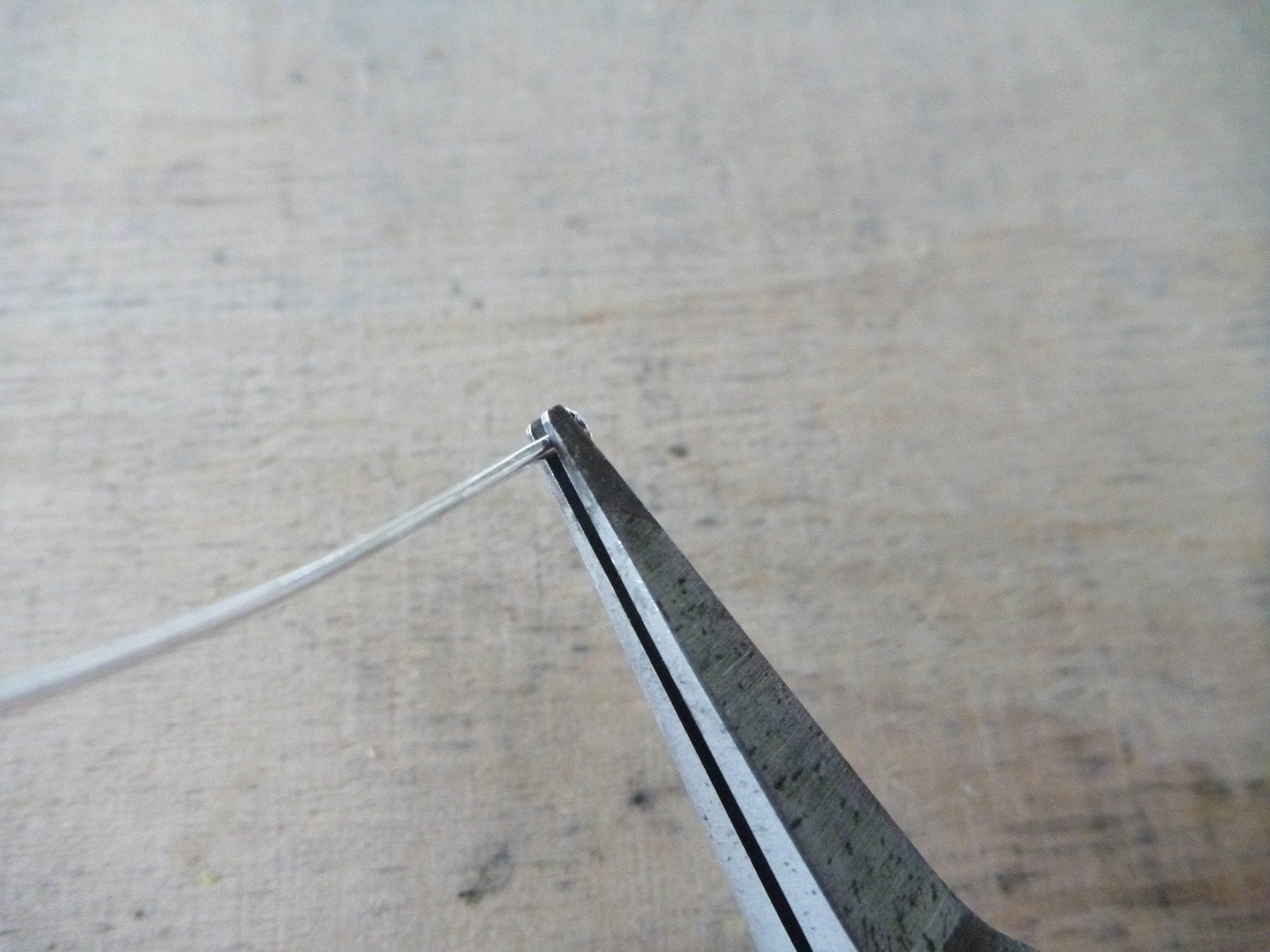

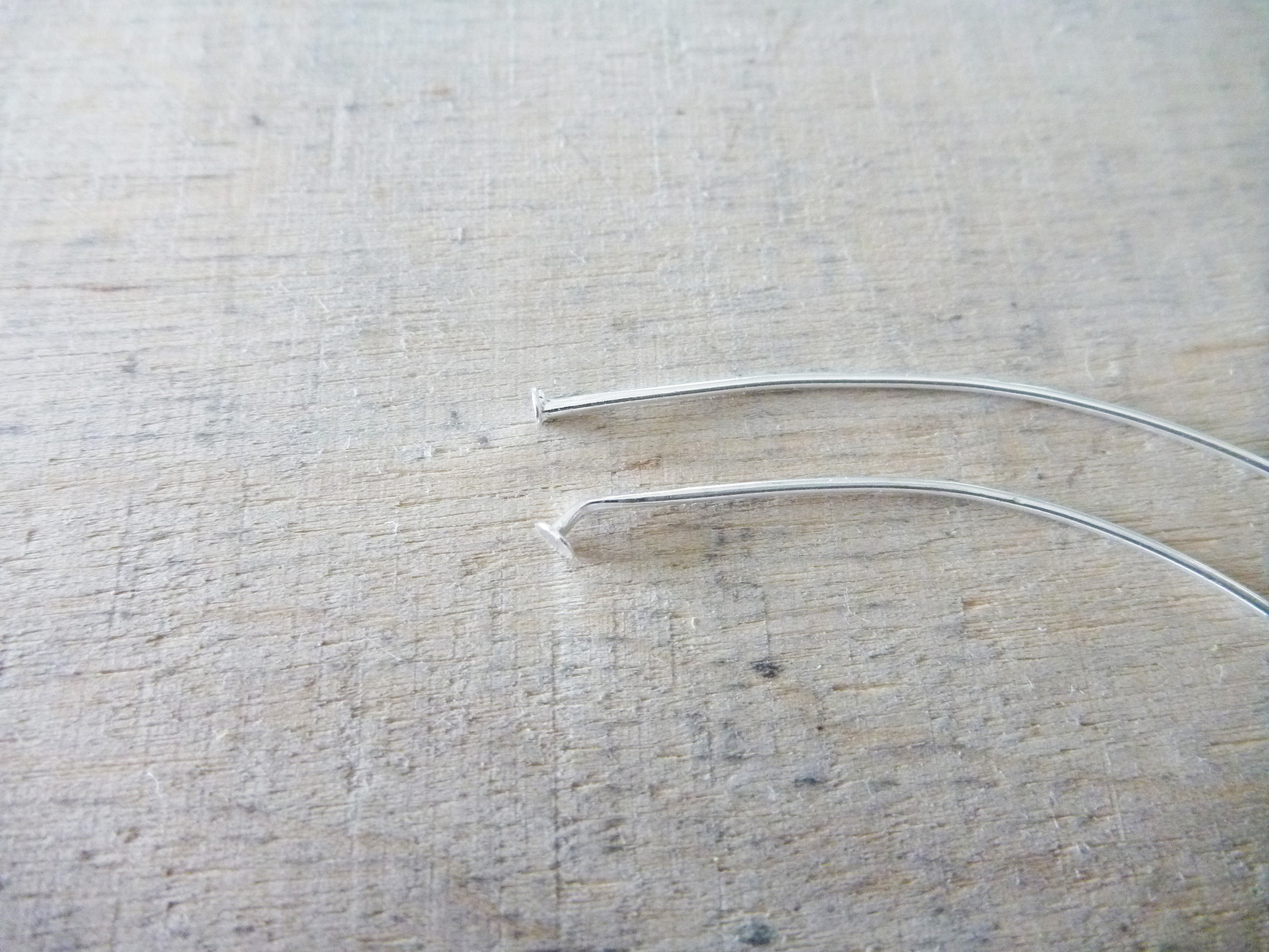

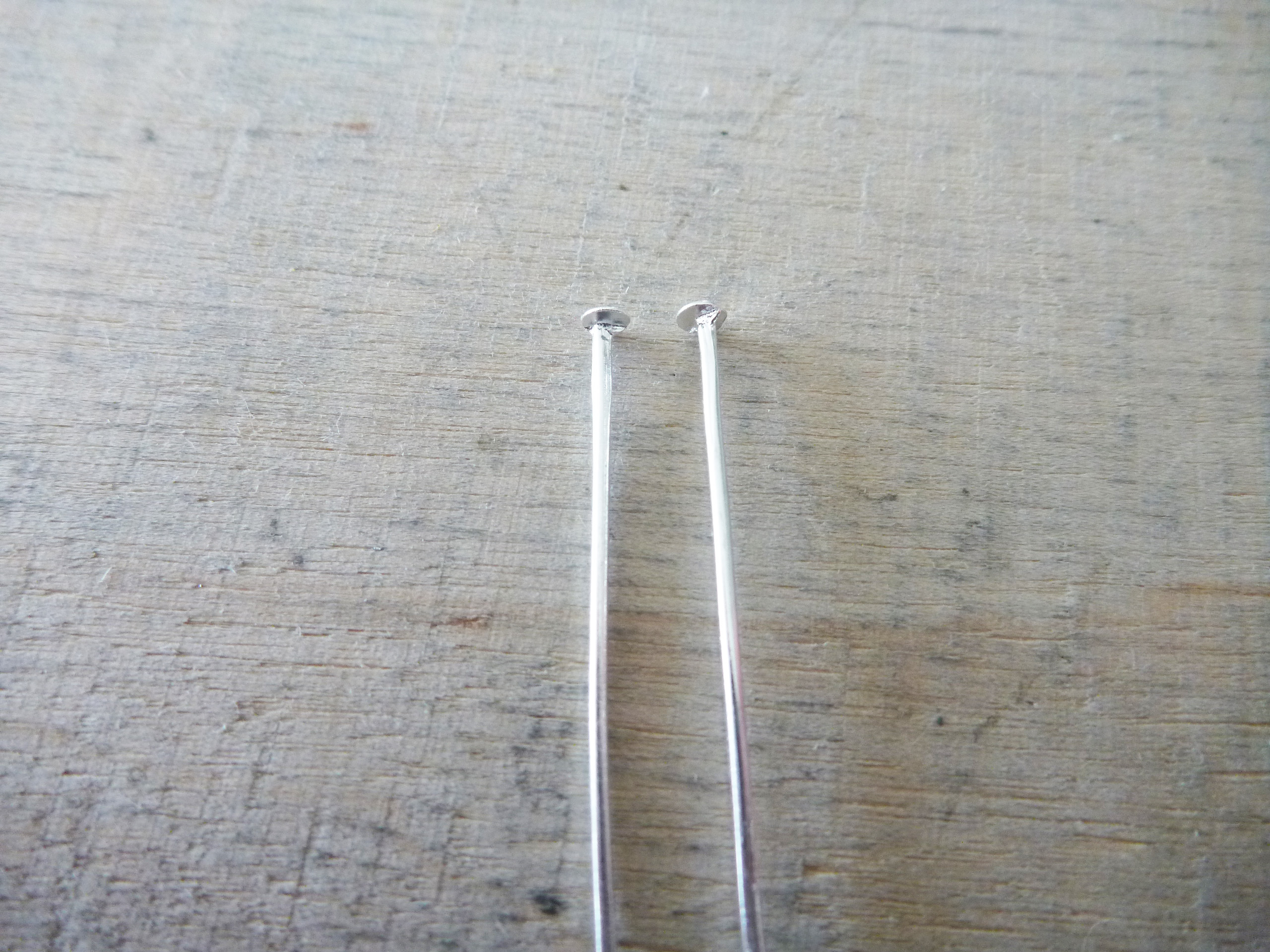

I prepare the spokes for installation. I bring all the wires into a uniformly curved shape so that there are no kinks in the wires. The head of the wire I bend with a needle-nose forceps about 45 degrees in a line with the curved shape.
Best regards Michael

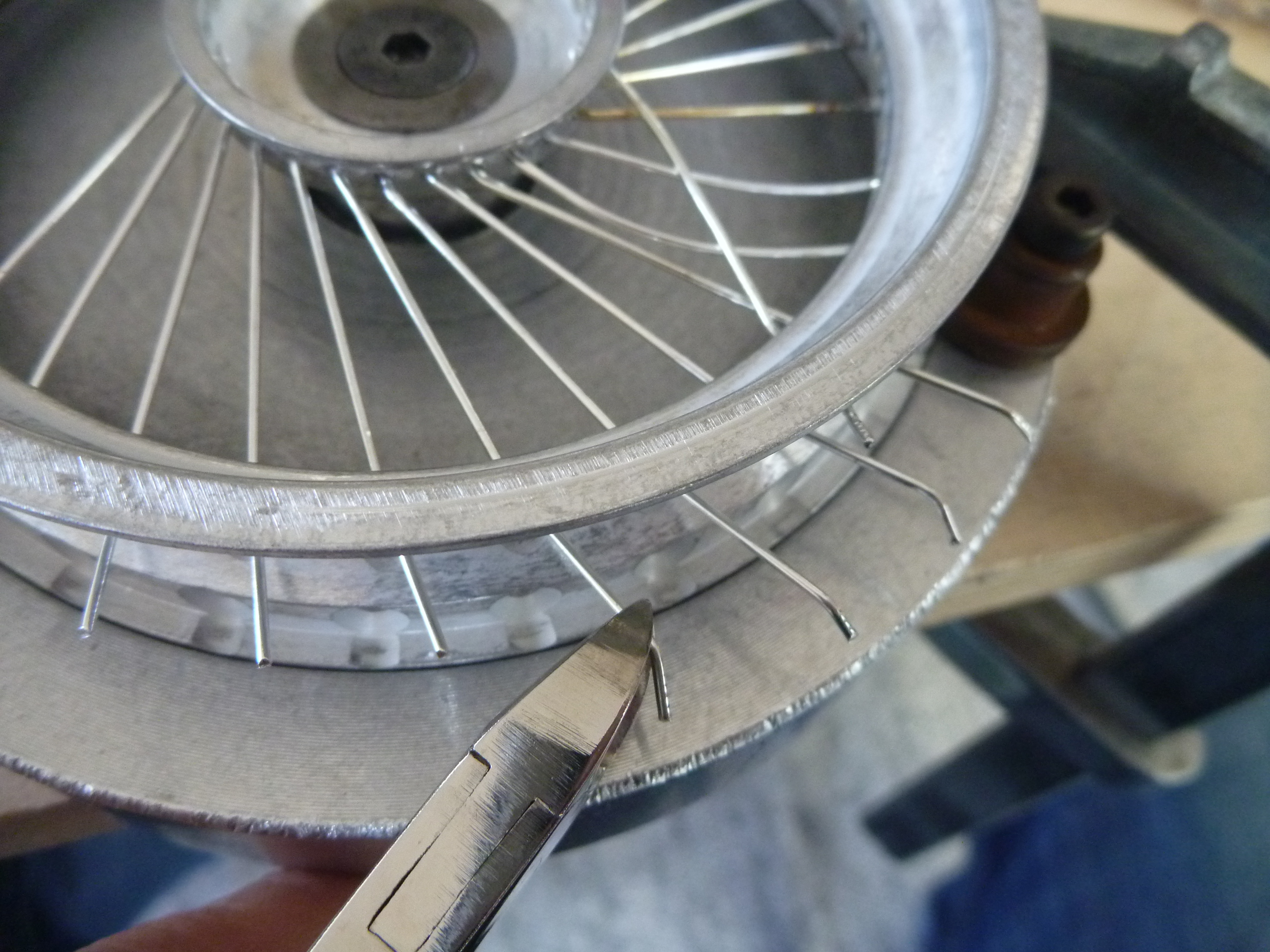

the view on the building continues ...

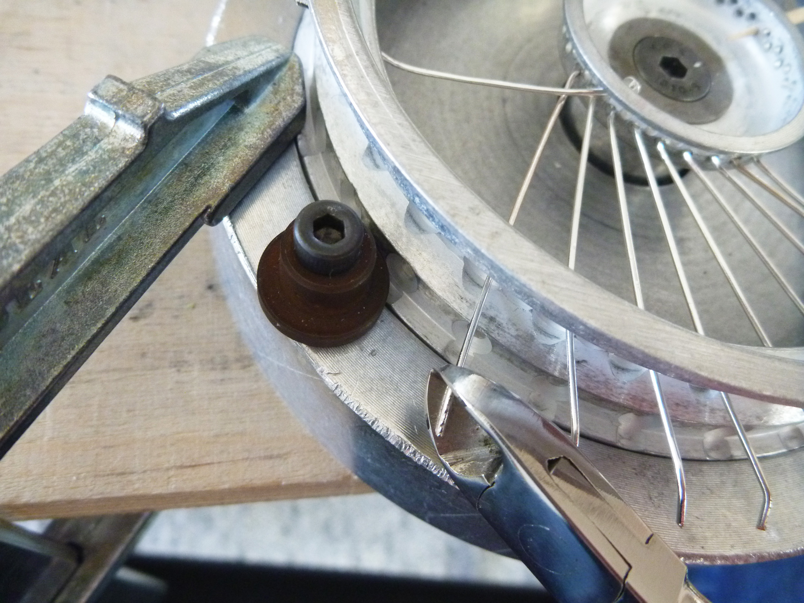

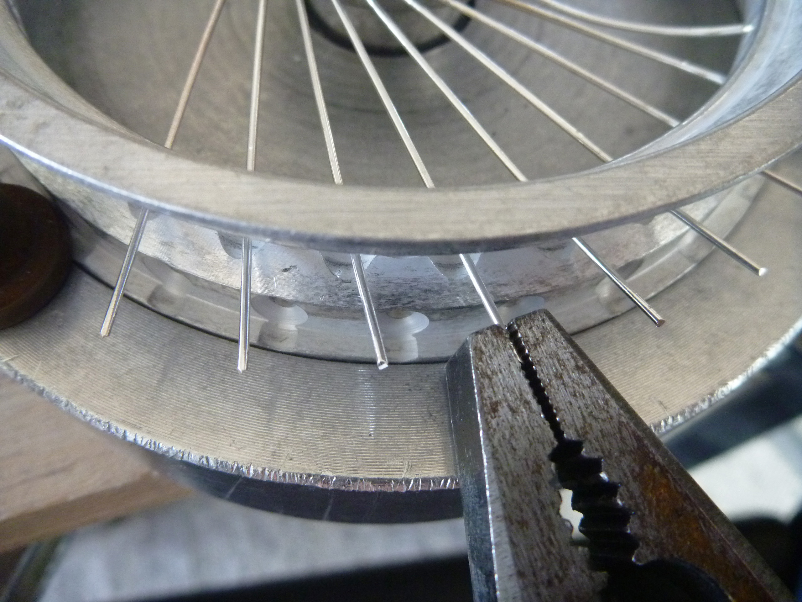

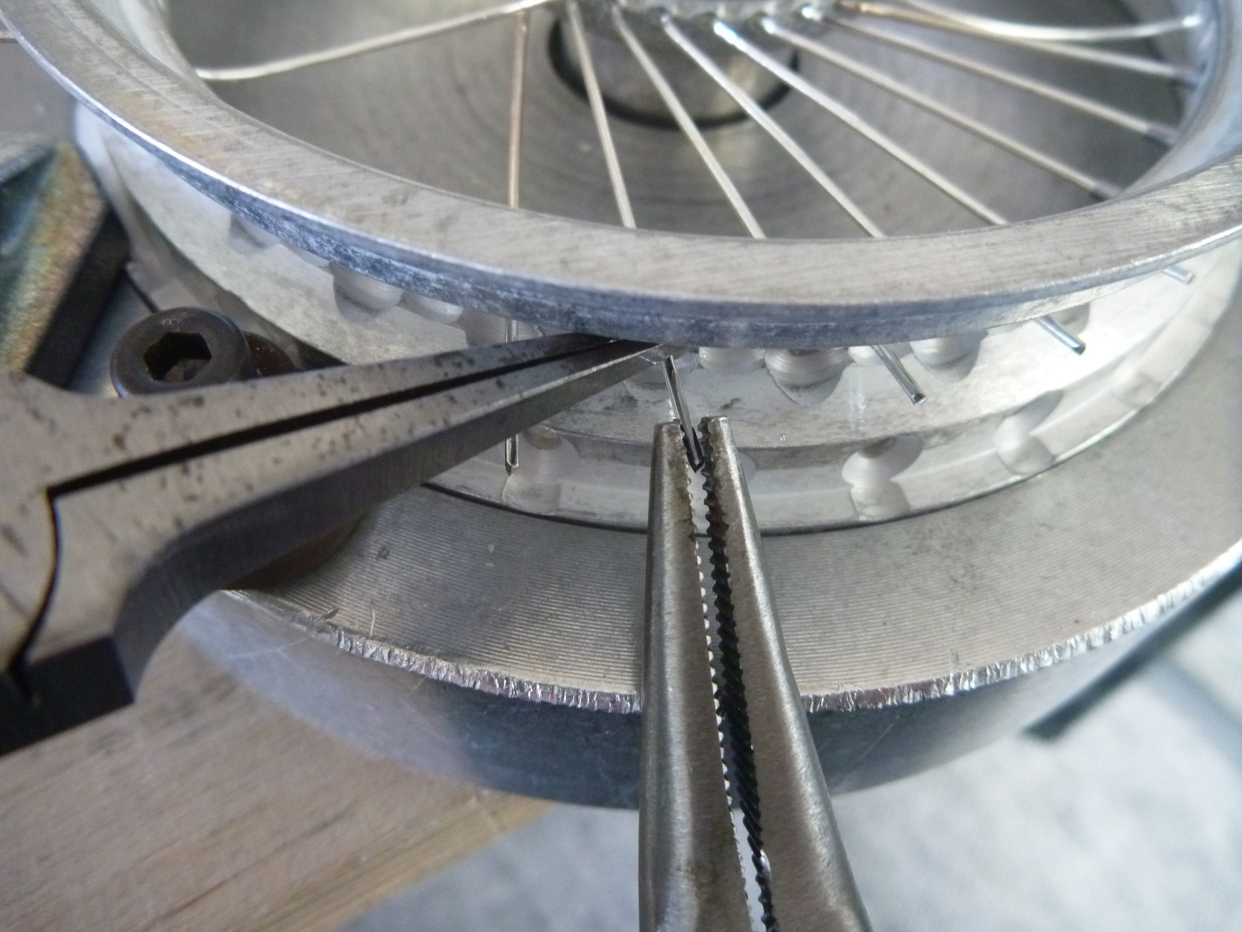

Wheel hub and rim are mounted on the mounting device. All screws are tight. The mounting device I attach with a screw clamp left and right at the table.
I put the prepared wires into the wheel hub and rim. This is easy with the pre-bent spokes and there are no new kinks or bends. I make 8-10 wires in one direction.

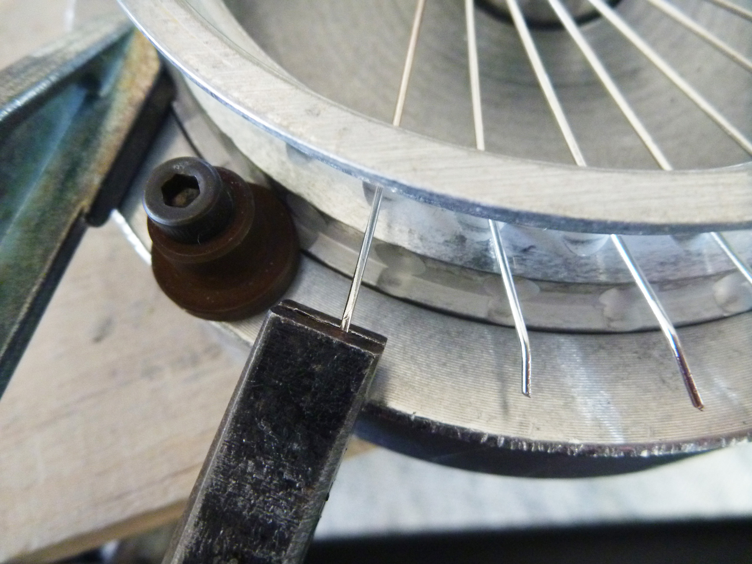

Now I take a pair of pliers and go straight the wires. Right tight and firm. This tightening I do over the edge of the mounting plate and thus use a lever effect. This allows the wires to be pulled really tight. The hereby created "corner piece" I remove with a side cutter.
I straighten the wire with a pliers one last time.

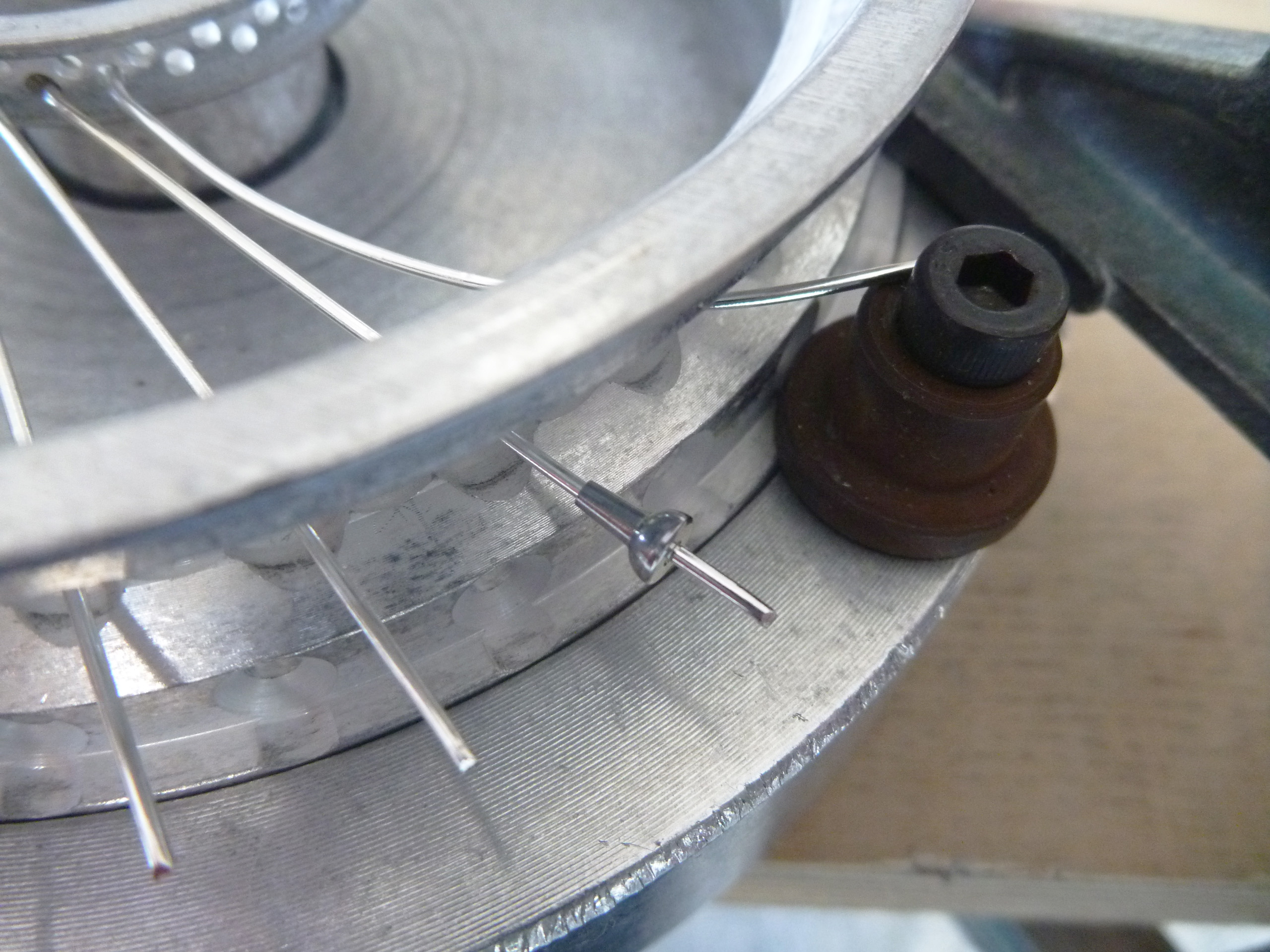

Then I put the "ferrule" on the wire.
After that, I take a second pair of pliers to hand and press the ferrule firmly on the wheel rim. At the same time I bend the wire over the ferrule. Both very close to each other.

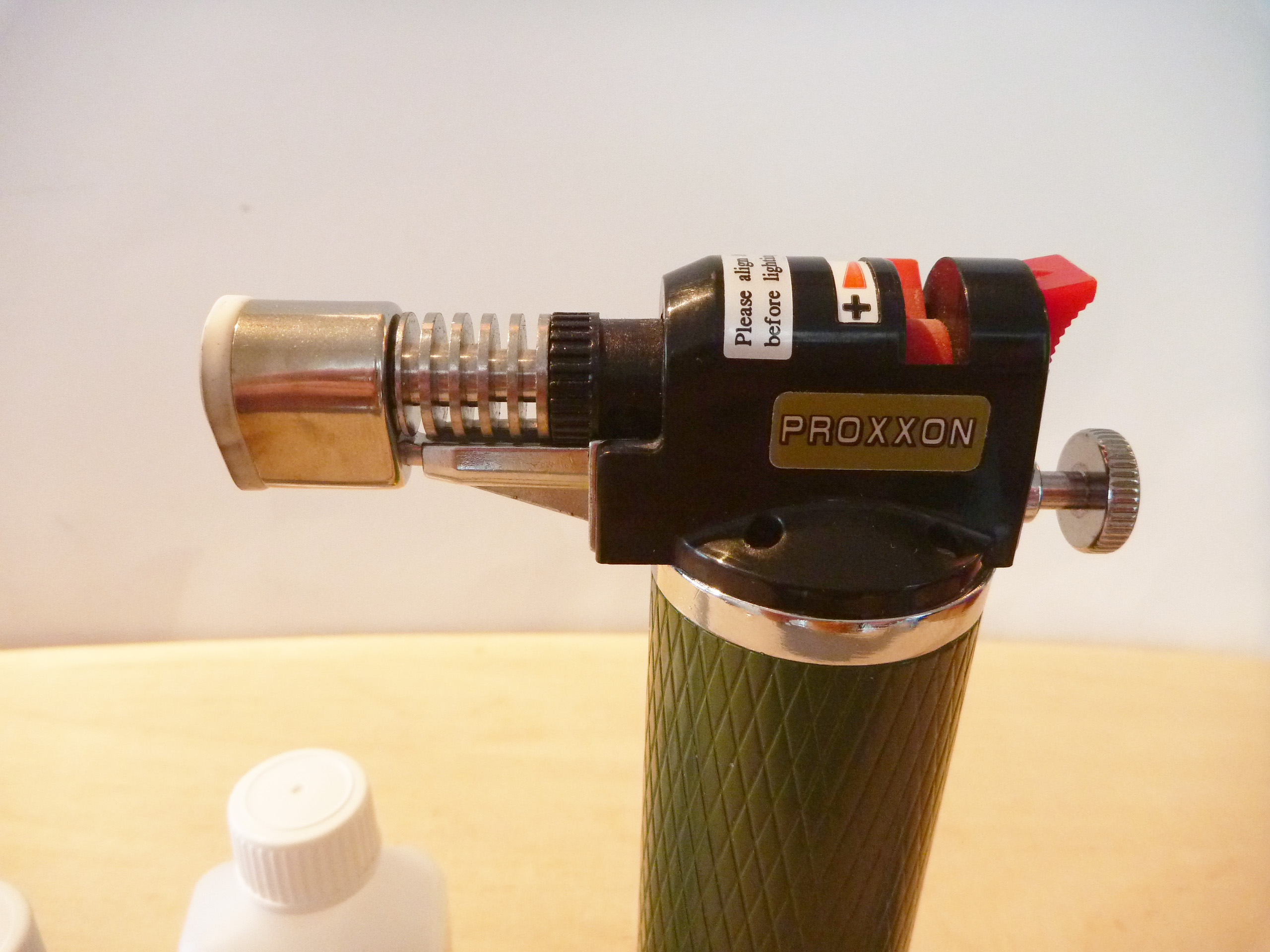

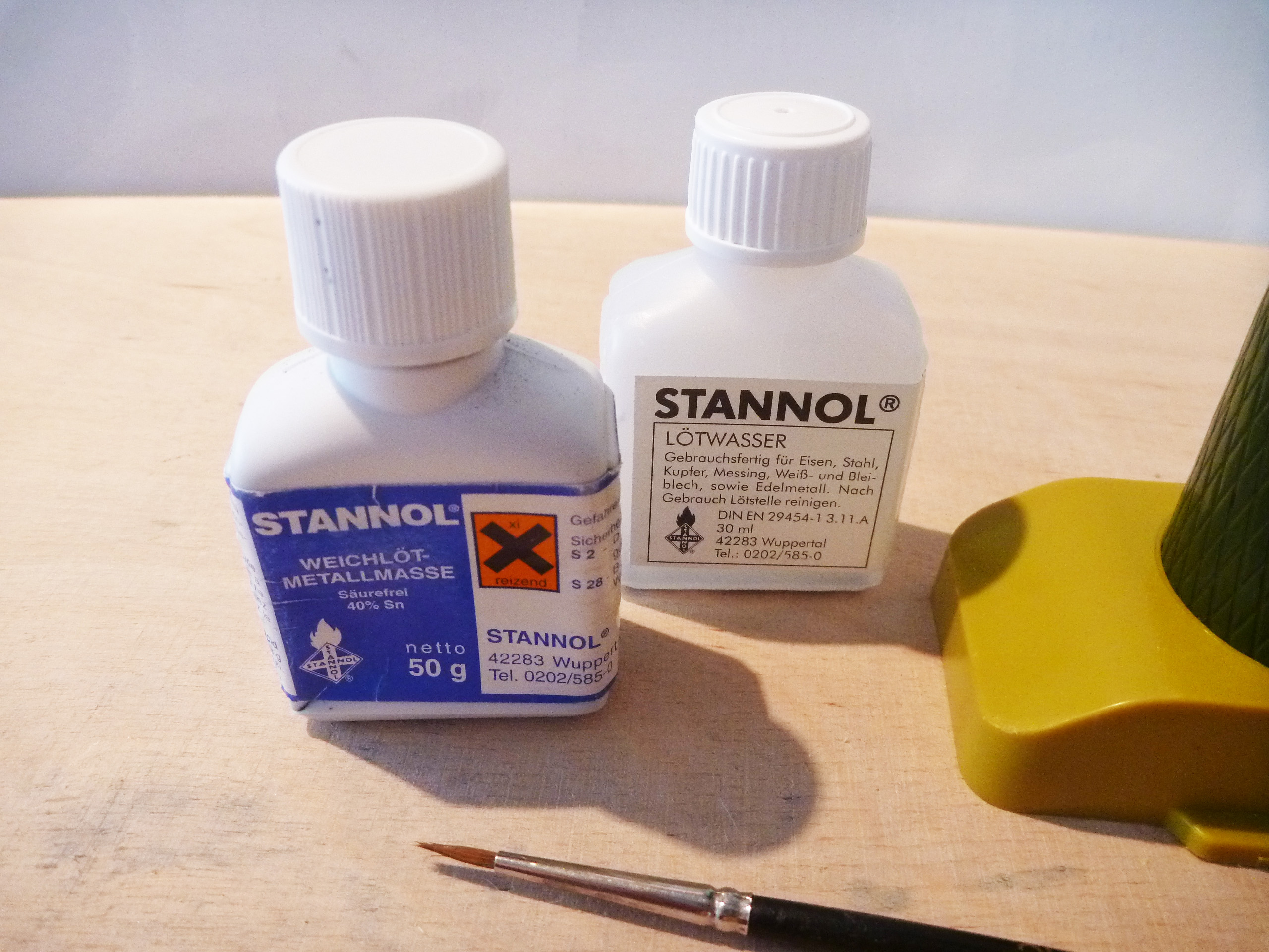

Now bring liquid solder with the brush outside and inside the ferrule and solder both parts with the Proxxon flame soldering device.

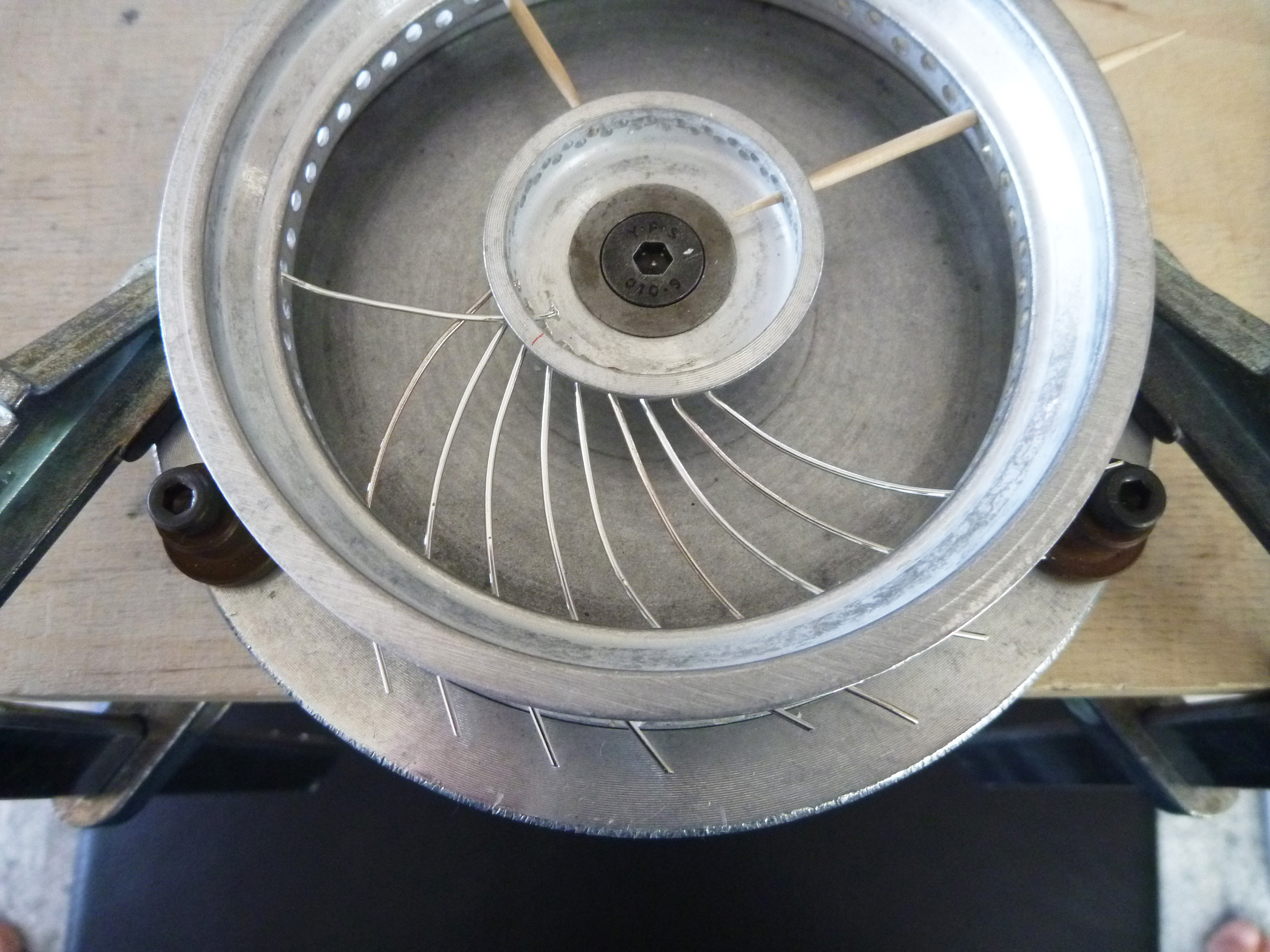

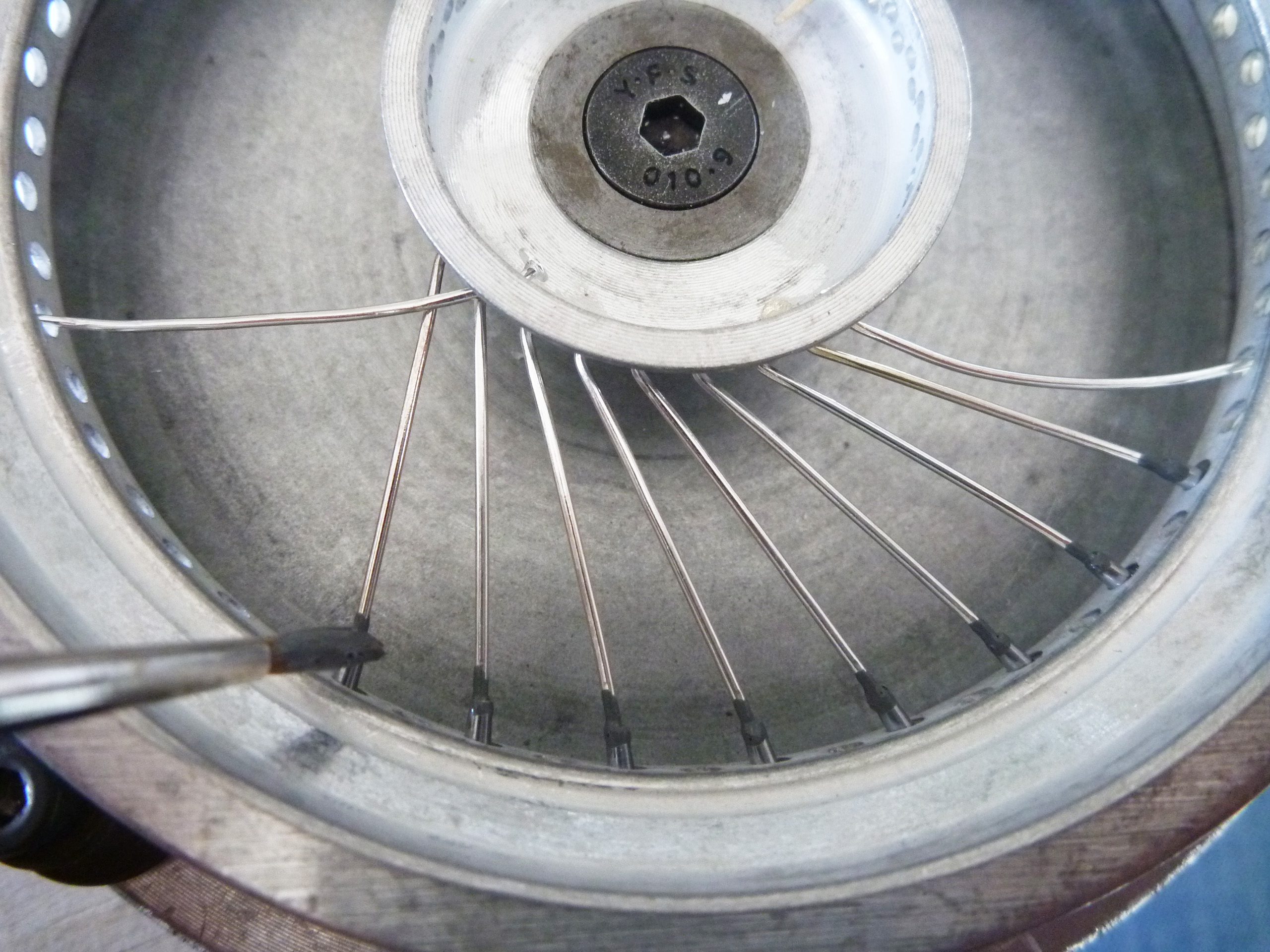

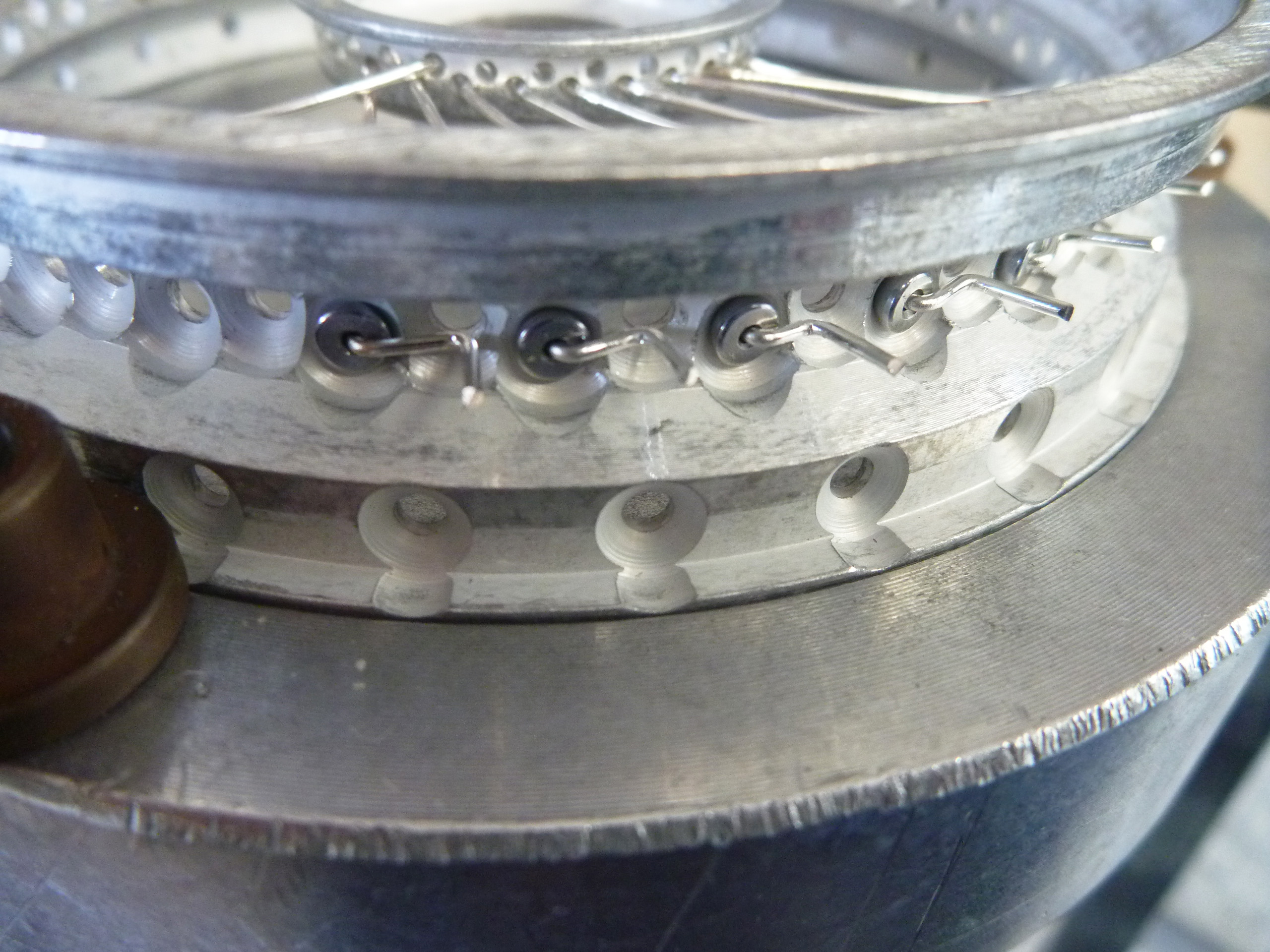

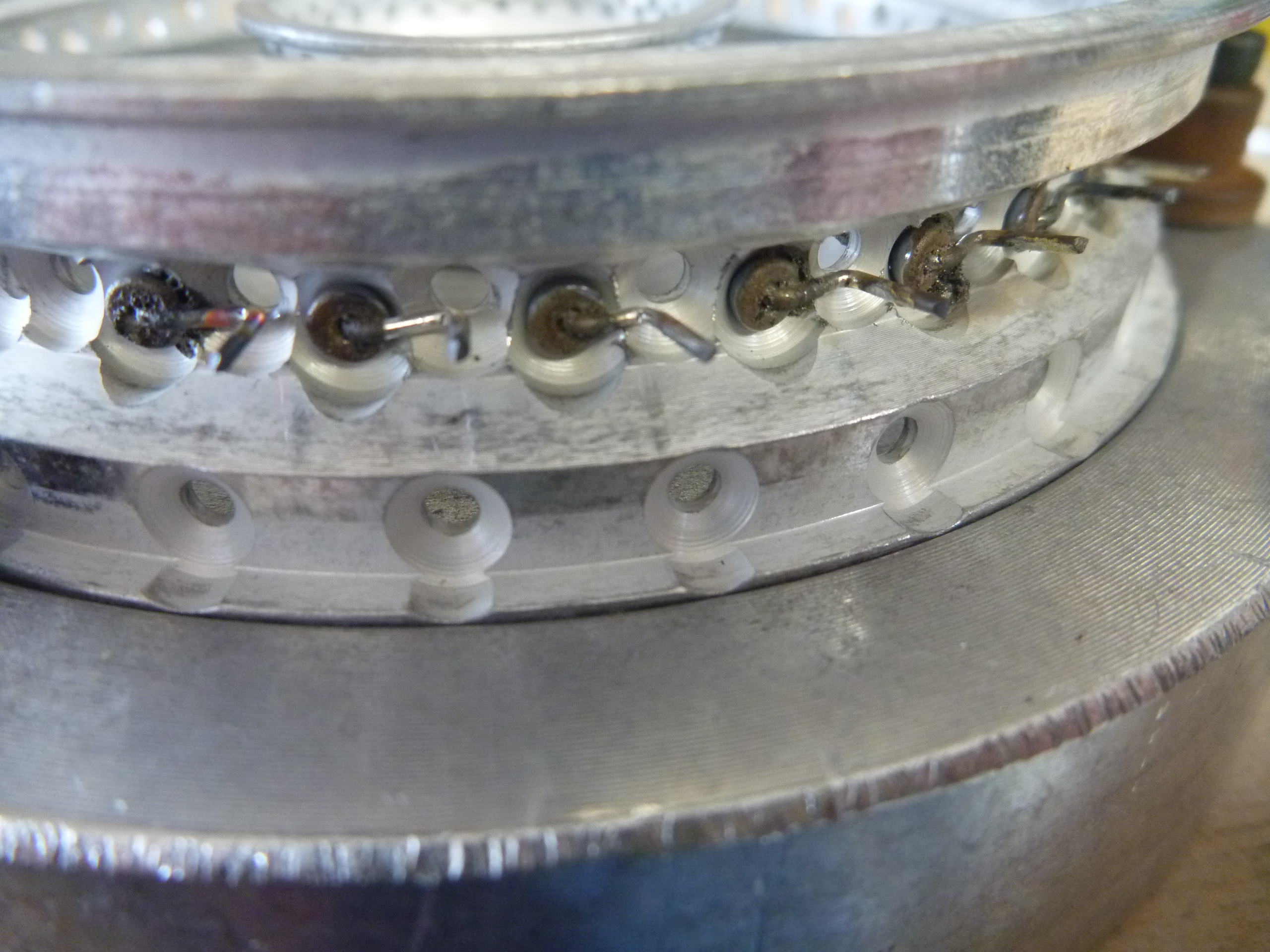

So the soldered spokes look at the rim inside
When the 8-10 spokes are done, the next 8-10 wires will come. All spokes of one direction will be fully assembled.
