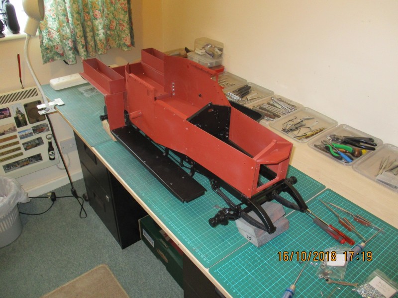

Good morning Ken, and thank you. Steady progress being made. Not surprisingly it takes time to adjust and concentrate the mind, enjoying the challenge though....Mick

Good evening everyone, the Roller build is moving along....to much time spent following the Famo's.
I have reached the point where I need to set up the ' Bench Test '. The armoured car bodywork is coming together nicely....still putting off building the wheels, for the time being....

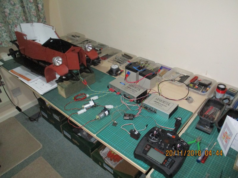

Thank you Phil and Robert for your comments. Finally completed the 'Bench Test', no real problems, and remember I soon lose track of where I am going with each radio control lead. The instruction booklet is a blessing. I am restricted to using my Spektrum DX6 for this setup. I have a Spektrum DX8 on order. The armoured car motion/sound requires at least seven Rx channels.
The Rolls Royce engine sounds 'clapped' :shock: ....and the 'voice' overs on the sound board are lifted from the Morris Quad voice sounds...I was expecting to hear a rather nice 'plummy' voice, it is a Rolls Royce after all :wink:.....Still following the Famo builds, too heavy for me Phil, I do like the 'Grant' though, may have to check the contents of my savings tin, hidden under the bed, :roll:. Keep on keeping on lads....Mick

That's a mile stone for your build, all that spaghetti everywhere nicely sorted :shock: , you are so very organised I must say, I'm never that organised! Why so many channels needed for the Armoured car Mick? Kind regards Phil.

Hello Phil, the seven channels are Main Drive, Steering, Radiator Fan and Lights, Turret Turn, Front Armour Door Open, Gun Elevation, Trigger for Sounds ...if I could work out how to assign the 'sounds' to a three way toggle switch, B or G located on the top of the DX6 it would free up the right hand stick, which I use presently.....I have the 'sounds' on the R/H stick at the moment by moving the stick left to right. I get confused with Rx port assignments and channel input configuration, so I set up with a layout I knew worked, aka my Panther....The instructions booklet is fine, it's how I configure my Spektrum Tx I can't work out, I have a mental block when it comes to the' port/channel assignments....I have never been comfortable with radio setups. My moto is....if all the systems work, we have lift off :) ... Mick

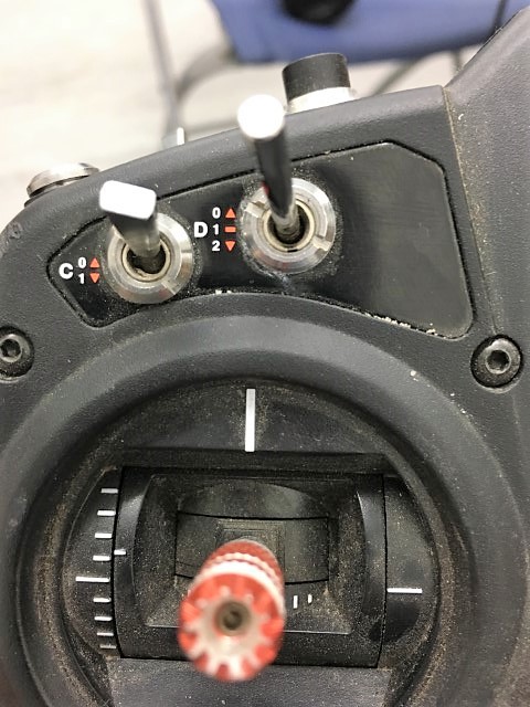

Mick, we have our sounds set up on "D" on our DX6 (was on "B", but that stick broke off!!)
Steps below show how we set do the setup:
we use 3 position switch "d" on our DX6

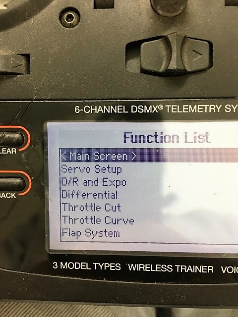

Go to the function list menu & scroll down to systems setup
Select systems setup

Bingo , now that's what I am talking about.....pictures speak a thousand words, or something like that. I will reprogram my DX6 forthwith. Thank you Mr Armortek. :) …..Mick
