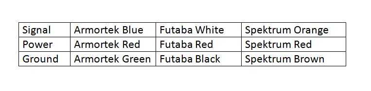

Sorry if this has been done to death elsewhere previously, a quick search didn’t reveal anything. Probably says more about my search capabilities :oops:
I just need to check the order of the red green and blue wiring please (+,-, signal).
Thanks in advance
Kevin
Wiring Colours copy.jpg (42.28 KiB) Viewed 1739 times
Check the black plugs on the ends of the Armortek leads. If they aren't chamfered, you can break the case of a Spektrum receiver when inserting them. It's easy enough to file a profile on the plug.

Thanks Adrian. Star as always :D

I have that printed out and stuck to the wall in my workshop, as I can never remember which way round the Armortek plugs go.
It ought to be easy as the mains Earth in the UK is green, but then the Neutral is blue, so I always end up second guessing myself :roll: :oops: :roll:

Think i’ll Stick a copy inside the tank too.

You're a life saver Adrian. I was thinking about that same problem this week. I know I saw it somewhere else but could not find it. Instead of fiddling with the plugs to make them fit a Spektrum receiver I was going to buy Spektrum cables which obviously have a different colour code.
