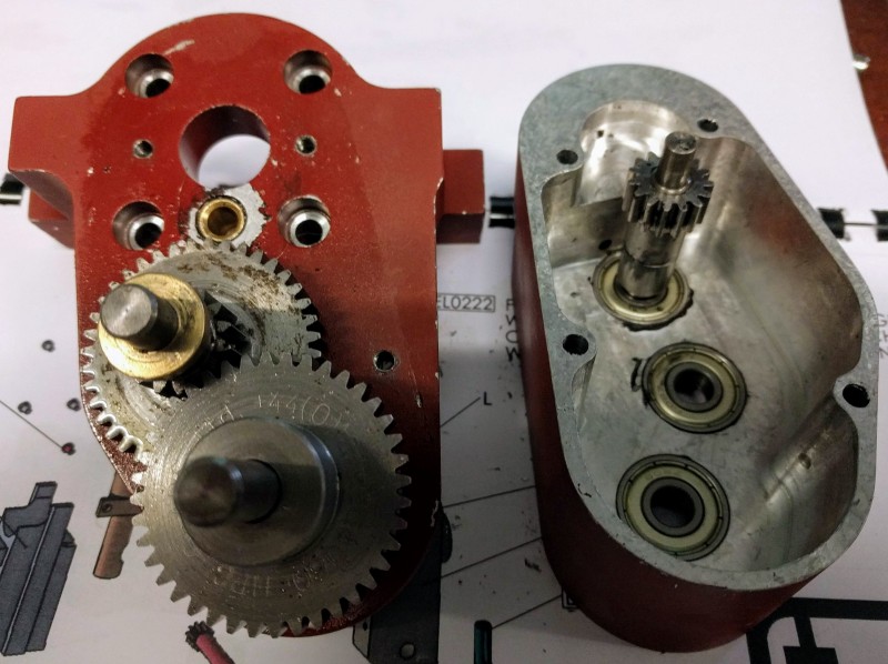

Having just assembled the gearbox for my Quad I am left with a quandry. All the shafts, gears and bearings went together with no issue and turned freely, the housing went on with no sign of binding.
However once all the bolts were tightened up I could not turn the bottom drive shaft at all. I have taken the box apart a few times and can find no evidence of anything grinding so my question is, is the lack of movement normal? Is it just the resistance of the motor or do I have a problem?

Re: Quad gearbox
Well I took the motor off and found that it was still binding up as soon as the case went on so that ruled that out as the cause. Taking it apart it seems the issue is with the top shaft as it was still stuck to the bearing. Freeing the bearing I tested it turns freely, as does the shaft resting in its bushing so I put it all back together and once again it jams as soon as the case goes on. The rubbed off paint suggests the gear is pressing against it but that might have been from my testing with the case off so still not sure what to do.

Re: Quad gearbox
I had a discussion with Mark about this, and his response about EM0503 was:
"This bush should be 1mm proud of the face of the gearbox when fitted, preventing the gear
from rubbing on the face. You can fit a thin washer if this is not case on your build."
I think I found an M6 brass washer was the ideal size. You will probably need a "Form B" type, which should be 0.8mm thick for an M6 one.

Re: Quad gearbox
Thanks Adrian, I will get the appropriate washer and give it a try. It does explain what might be happening as I push the case down.

Re: Quad gearbox
<fingers crossed>
Are all the bearings flush with the gearbox face ? If they are proud then you may not have enough clearance from that end.
