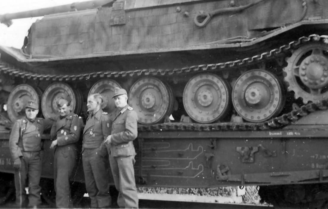

For those builders planning to add Zim to their Elefants, which I suspect is most of us, I've just come across this rather interesting photograph which clearly shows the Zim applied in a pattern with the texture running vertically and not horizontally as one would expect to see. The photo claims the vehicle to be from sPzJagAbt 653 sometime during 1944. Whether there were variations in application at the factory or if this was a field re-application I don't know. It's interesting either way.
